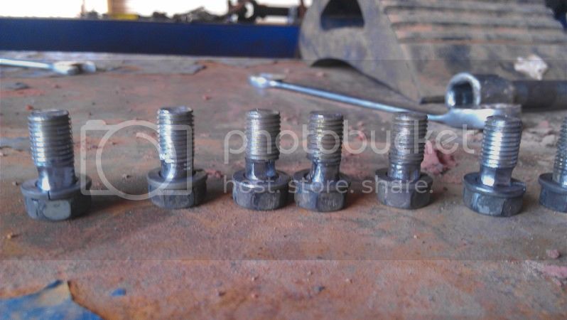

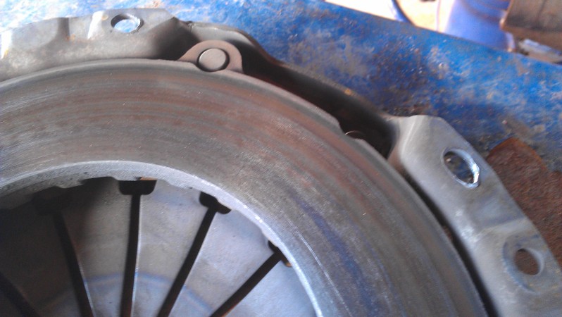

Just a update on this, turned out to be all the bolts holding my clutch on were loose, giving the impression it was running rough, due to the vibrations.
Note the flogged out holes.
Lucky these little guys didn't let go.
Is the disc in the correct direction? There is a front and back side, if reversed, clutch won't disengage.
Just an idea.
