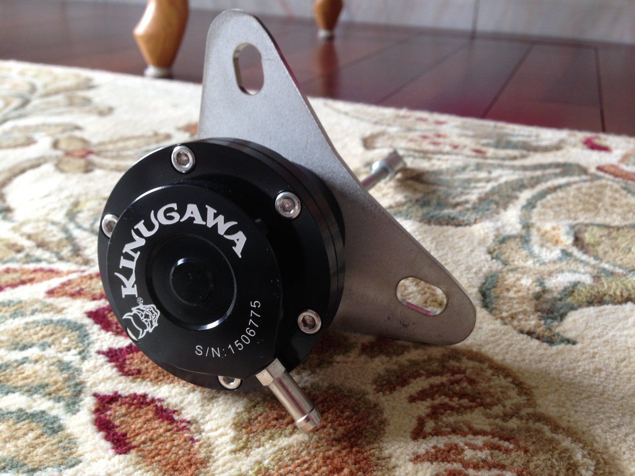

Yes turbo needs to be removed, the only reason why I went this route was I needed to remove the turbo anyway to swap in the supra upgrade and on the advise of a few friends eho have used this before. If you put a 22 pound spring in there it will be 22 pounds, or if you put a 15 pound spring that's what you will get. I preloaded the actuator by fighting up the adjustment but under hard acceleration she stops at 15 psi right on the money.
So it's adjustable only by way of changing the spring? If you run a 14.5psi spring, you can't set it for 16psi for example? And I assume it would have to come off to change springs as well?
Yes, no, yes :)
Whatever spring you put in there that will be the minimum boost pressure you will see. You can still hook up a boost controller to increase the boost just like with the stock wastegate. Third yes is a bit of a guess, but it's like an external wastegate where you will need to take apart the wastegate to change out the spring. Not sure if you can do that in place with the one @BCR4619 has posted.

When I 1st saw it I assumed it was a 2in1 sort of deal, I can't see how this would really be of use with a stock turbo compared to a regular manual boost controller. Maybe if you were running 28psi on an aftermarket unit, a stiffer wastegate spring could help with boost creep, and this allows you to tune that spring easily.
I think there is enough room to change the spring on the truck as the hex bolts are all on the cover. I can try and get shots tomorrow.
I just like less things that can go wrong which is also why I went with it, I don't need to change my boost to higher or lower, my next one will have a 22 psi spring for Karters turbo

This came yesterday with a 22pound spring
That is the same I have with the same spring.
Check it carefully before you install it though...Mine was ordered with the 22 pound spring, but unknown to me, the wrong spring was installed. They used a 10 pound spring and I could not figure why I low boost.
The springs are color coded. I would take the cover off, see what color it is, then call Kinugawa to confirm. Do it once and be done.
Other than the spring, the unit works great.
Yup I have one currently in my truck and works like a charm. The 22pound spring came in a seperate bag so I need to change it. But I would have thought it would have come with it installed.
