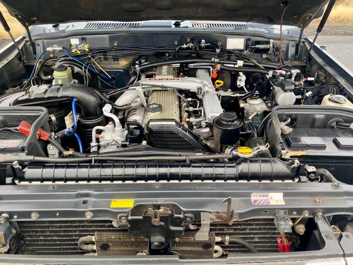

Following this thread as I am currently researching a compressor location in my HDJ81.
This is my engine. I just removed the coolant heater setup (upper right hand coroner) that is bolted to the fuel filter bracket. The previous owner fabbed up a really solid mount that i think i can re-use and mount a compressor there. Luckily I do not have ABS, so that space is now completely open except for the small oem vaccuum tank.
Yeah that's where I would install it too, if I didn't have the ABS module right there
