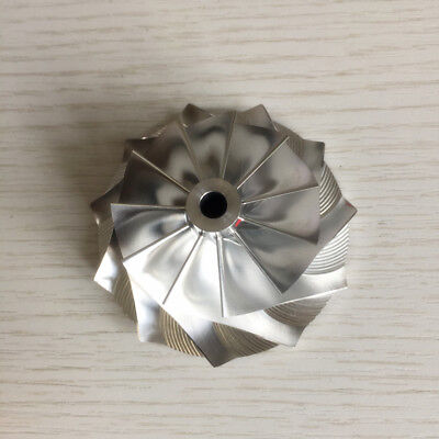

Hi, looking for a mild low budget upgrade for my 1hdt I decided to go with the 17204-170401hdfte turbo. Picked up one cheap on gumtree. Had a damaged compressor wheel, but otherwise it is in great shape (no axial play, 75 microns radial, turbine Is in great shape, housings are also good with no cracks etc.).
I plan to purchase:
- melett major rebuild kit part number 1500–322–755 (129$ )
-KTS billet compressor wheel KTS p# 2603C (115$). 2603C
-compressor housing (either purchase a Supra 7mgte housing, mamba adapter housing or machine adapters for the 1hdfte housing or machine my current ct26 housing to fit the new compressor wheel)
-balance turbine shaft along with the new compressor wheel
I just wanted to make sure that I was on the right track before I went forward. Specifically is the kts wheel appropriate or should I consider another option given that I need to modify or buy a custom compressor housing either way? KTS, mamba and kinugawa make some alternate wheels that would fit with customization but i am not interested in testing out unproven configurations.
I have access to a machine shop, so that is just time/materials for me. Mostly i want a proven configuration that will be reliable, build boost earlier and maintain it at somewhat higher rpm's than the stock CT26. I do realize now that all the parts end up adding up (atleast i picked up the 1hdfte turbo for only 50$ + shipping).
KTS also makes a 10+0 with 50/67 inducer/exducer p#2646c. this would be closer to a TD05 18G. Would require machining the compressor housing, but i will probably be doing this anyway. Also an 11+0 in the OE dimensions is shown as well.

I really could use some advice on the compressor wheel selection. Has any one here hybridized a 1hdfte turbo? Should I go with the stock billet replacement or something larger?

Here is a 69$ billet compressor wheel OEM fit (45.9/64.89 with extended tips and 11+0 blade configuration)
Similar one from Mamba for 95$
And from kinugawa for 99$
I suspect that the mamba and kinugawa wheels both are manufactured by KTS (others who have purchased mamba billet wheels have suggested this as well). they both say "balanced by schenck germany" and the kinugawa p# ends in 2613, which is the equivalent KTS p#.

Thanks for letting me know. Btw, was your 1hdfte turbo a 6+6 or 11+0 compressor wheel? I am leaning towards the standard size compressor wheel as I won’t run high enough boost to take utilize the larger wheel. Still wondering if I should go with the original 6+6 or the 11+0 which from what I have read with boost earlier but fall off at higher rpms comparatively.
I got busy with work and didn’t pull the trigger yet. Leaning towards either the stock dimension 6+6, 11+0 or the custom kts p#26F1 (49/65 point milled). I am unsure how to calculate the contour profile of the custom wheel as needed in order to modify the compressor housing to fit.
Can it be calculated using the dimensions kts provides or will kts provide the contour shape directly? I need some help from someone who has modified a compressor housing to fit a custom wheel before I proceed.
