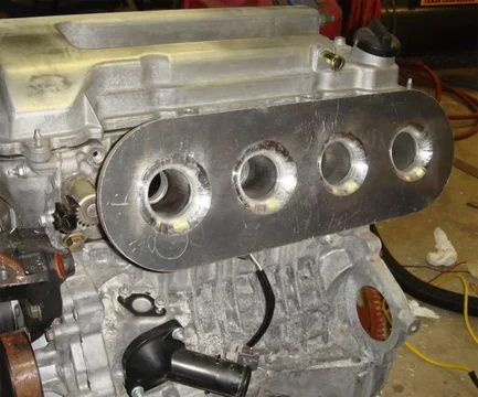

So would a simple flair transition on the floor of the manifold be enough, or is the full raised bell mouth such an improvement that it would be worthwhile? They look neat, but would be alot more difficult to fabricate. I do remember reading that air flow slows down and stagnates the closer it gets to a surface. Perhaps that is why they raise the trumpets. Would something like this be enough?
Thanks Doug for explaining that. From some flow models ive seen it looked like straight pipe has low pressure areas imediately around the inner edge of the pipe (eddies?), where as the flaired ones are stable across the whole diameter.
Yes, that's exactly it. You'll end up with eddies like a swirling donut in that area on a sharp edged pipe. Anything radiused like the picture you've shown will help. The bigger the radius, the smoother it'll be. I remember something like 1/6th of the pipe diameter is the mimimum radius to work effectively. Bell-mouths with their varying radius are better still, but much harder to make.
