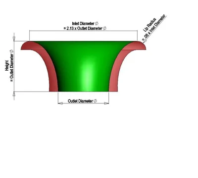

I am interested in using a duel plenum design to aid in cylinder filling, but keep the volume to a doable size. Something like this. Although I think this fellow raised his trumpets a little far off the floor:

Ahh yes I did read it wrong, but that makes it all the better. And good to hear your package it working Doug. Even though the runner would be short, I wonder if you could still do some tapering on it for increased velocity as well as a bell mouth. I was reading an article of a fella comparing straight intakes with flared bell mouths and full radized bell mouths and the simple flared ones flowed 25% more than straight pipe. The full radized ones did about 2% more than the flaired ones. So not a huge amount. The pic I put up a few posts ago is a good example of a simple flared bell mouth. I dont know how acurate this is, but perhaps an engineer could verify these measurments?
When I was younger and into drag racing. A friend of my father was ex aircraft engineer. Had a flow bench with a fluid level. The trumpet pipe vs straight made an extra 100hp for no other mods. But I think your still missing a few things. You can improve the intake efficiency by this plenum mod. But it can still only flow as much as the head will let it (next restriction in the line). Boost is a factor of restriction. Having a large volume of chilled air charge right there in the plenum. Means you don't really need to bell the intake. It's right there (shortest distance to engine as possible) = least resistance. So it's really a case of instead of the trumpet intake, but the intake mod helps it flow better much higher in boost/volume. Low boost-large plenum = lag. High boost with Inefficient intercooler=lag. You either reduce the plenum size, or chill the air as much as possible as low in the rpm as possible. The more air mass, and added fuel. The more gasses-turbo spool. This will allow you to have minimum lag and no compromise for high end flow.
