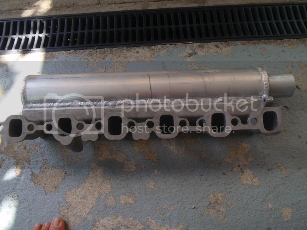

Have to disagree. The lag is noticeable! When I drop my plenum size back to stock - 200rpm(ish) drop in spool up.
Which suggests there is something wrong with your plenum design. It does not start and end with the volume alone.
I also think that there is a limit too. I've had a few different volume sizes and shapes of intakes,and think my current 3" one is best for my setup,although I feel I could use a smaller inter cooler. Where I really feel the intake mod benifits is is in the higher revs. If your running stock pump specs and still governed to 4200 rpm I doubt you would notice either way with size,as any lag would be most likely turbo related. Also unless your into cutting your firewall its pretty tight to extend your plenium past.
Yeah it looked like a tight fit wrongway. What gear was that delay in spool up biggie? I could see it being noticeable in 1st and 2nd, but 3, 4th and 5th would be good. I dont know autos sorry. Keep in mind that static spool up might actually improve, but the acceleration lag is more noticeable to most people. Myself, I am usually more concerned with static spool rpms as its tough towing on hills when you reach for another gear.
I picked up noticable turbo lag between a 52mm and 60mm compressor wheel. Better flowing pipe-work has decreased lag.
Can only speak for my set up. From all my results. It points to 3" volume being the optimum for allround. Mine is huge. I have LOADS of power up top though.

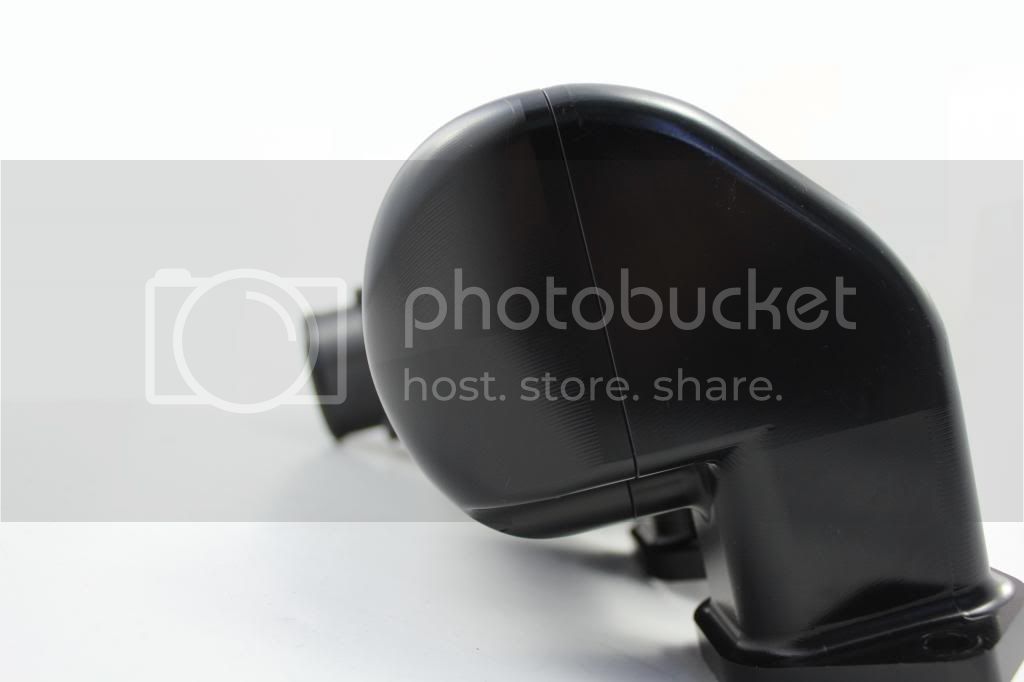

ok so this is what i ended up coming up with. still a couple of things to do on it but it is all together.
I'm just getting into Toyota diesels but this is what can be done. This particular manifold is for a Nissan td42, most similar i guess to a 1hz but much stronger internals. 50% larger plenum volume and spot on distribution between ports
Holy :censor: that thing is gorgeous work of art. I would love some shiny billet like that but 1500 smackeroos might be better spent on another Bad Boy (for now).
Did you notice much of a performance gain after bolting that on?
Would you recommend it as an upgrade?
I have not had the car running yet since install so can't comment on any performance gain. Will hopefully be finished in a couple of weeks. I'm running a United Fuel Injection 20g td05, that's all I can tell you, If you want more specifications you'll have to ask Matt Craig
If that intake is $1500, then it's extremely good value.
Since it bolts together, are there any photos of it apart?
