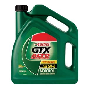

I believe so .. I whish we could have access to any full synth Diesel ( specifically designed for our old diesels ) 5W-50 or 10W-60 oil .. but that's just a dream down here ..
The best I cant found and use it's the castrol hyporum semi synth 15W-40 .. but there is an mineral Castrol 25W-60 that I'm evaluating for my future ..

Just stick with 15W-40 or for you guys near the equator 20W -50
I forgot to mention ..that IMOP the 25W-60 it's good for any old engine that it's mainly used to drive ( run ) long distances without town stop and go ..
To me was too thick to my daily basics .. I love pretty close to my office and my 80 it's my DD so bunch traffic ligths, stop and go ..
Thanks Tapage, I have seen and used the Castrol Hypuron oil in other vehicles. Esta muy caro, verdad! But this other oil of 20-60w I have never heard of.

here ..
Castrol México - Castrol RX Viscus
