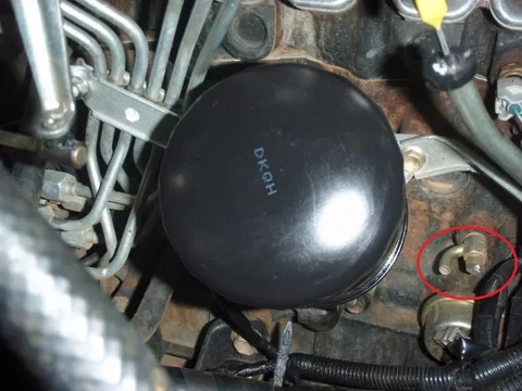

where is this block plug located. I know its on the block but where.
BUMP!
So, where is this block drain? And, if I don't have access to a new T-Stat, what would you do?
I am thinking if you guys help me find the block drain, and I drain it there, and the rad draincock. Then refill the rad, start the engine and let it get hot until the T-Stat opens and top up like that?
Any help is appreciated!
Doug
Doug, here is on my old HDJ80. This is the 1HD-FT, but i assume the 1HD-T is the same. It was located just above the oil pressure sender and had a neat little spout that i could attach a tube to, making it a clean job. :)
