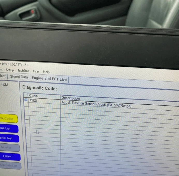

Anyone here had 19(2) fault code & limp mode? Restarting the car doesn't fix it, but clearing the code from the ECU does (for who knows how long?)

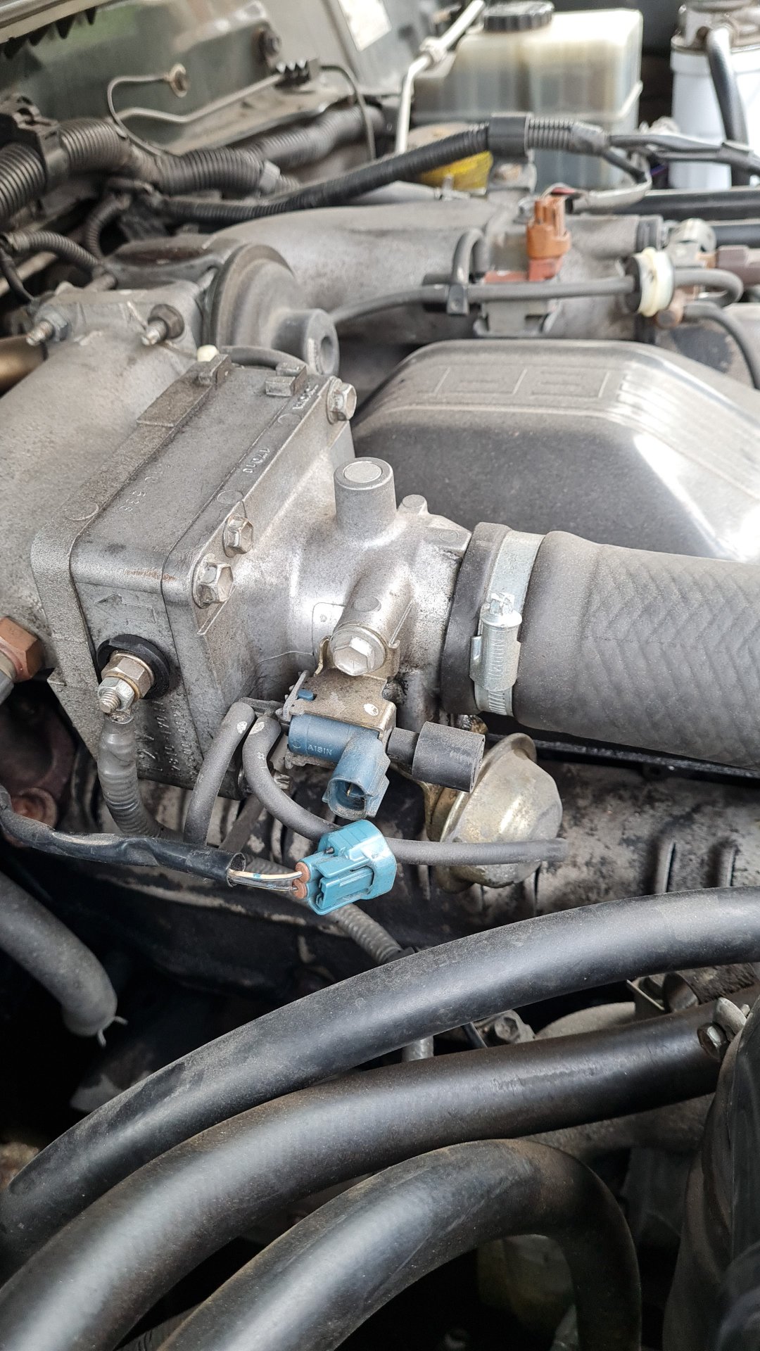

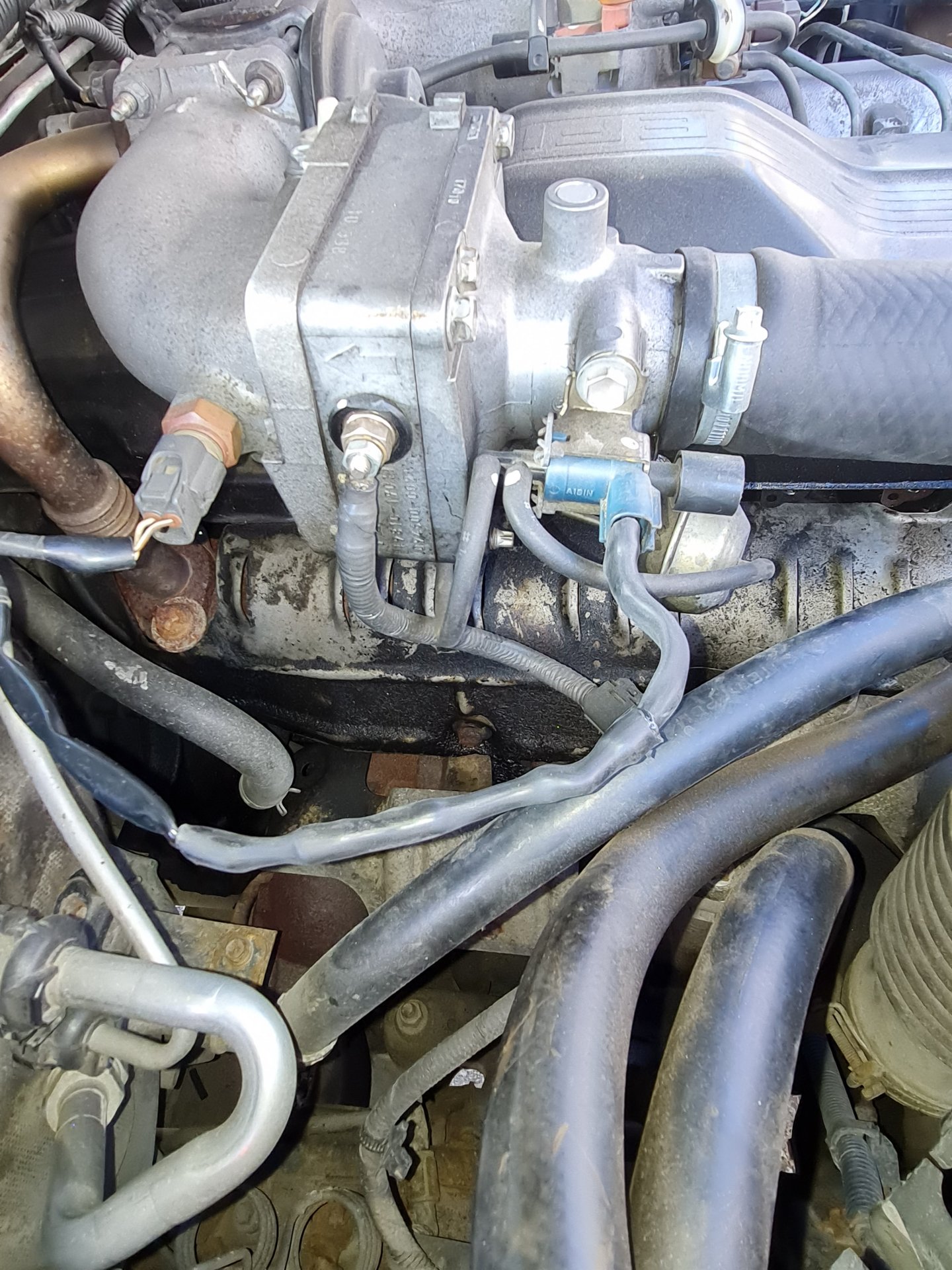

I had few times DTC 19(2). There is small on-off switch on the gas pedal assembly,cleaned that one. Also one wire was almost broken in the engine, throttle body. Fixed that with new abiko(small 2,8 mm) connectors. Now Land Cruiser starts really easy, better than ever! But...still not happy with acceleration so planning to open and clean the Position Sensor. Anyone had luck with cleaning? Or do I have to buy new one anyway?

Hi..we have same problem yesterday and was electric motor tps in throttle body..we fit a corolla one....and everything working perfect

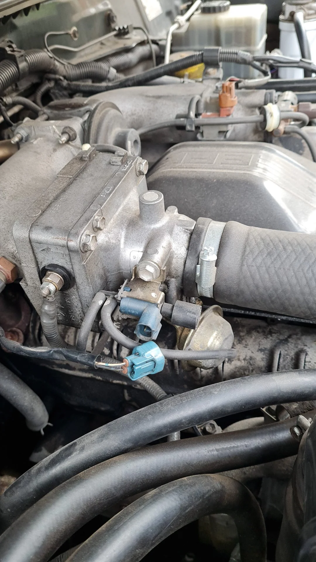

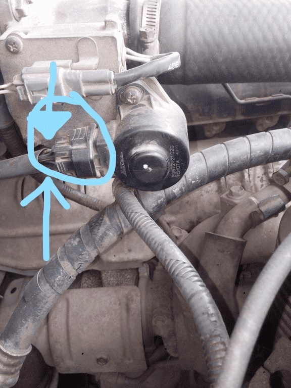

I have had what sounds like the same problem on my 100 series diesel. I have had it twice and I know at least one other who I met at West Wyalong who had had the same.
The problem is a wire associated with the throttle. I can send a picture of it in the morning if you are interested. It gets hot from being near the manifold and then gets brittle and then breaks. It is very easy to fix if you know what you are looking for.
The first time it happened to me was at Coonabarabran and was intermittent for a while. We got to West Wyalong after a fashion. The Toyota dealer at WW was very helpful and soldered it together in no time. It subsequently happened again and this time I replaced the wire....not a big issue.
The engine goes into "limp mode" and the service light comes on. The engine runs smoothly but is totally gutless. Apparently this is to protect the engine but doesn't help much when towing.
Anyway, if you need more help I can send a pic.

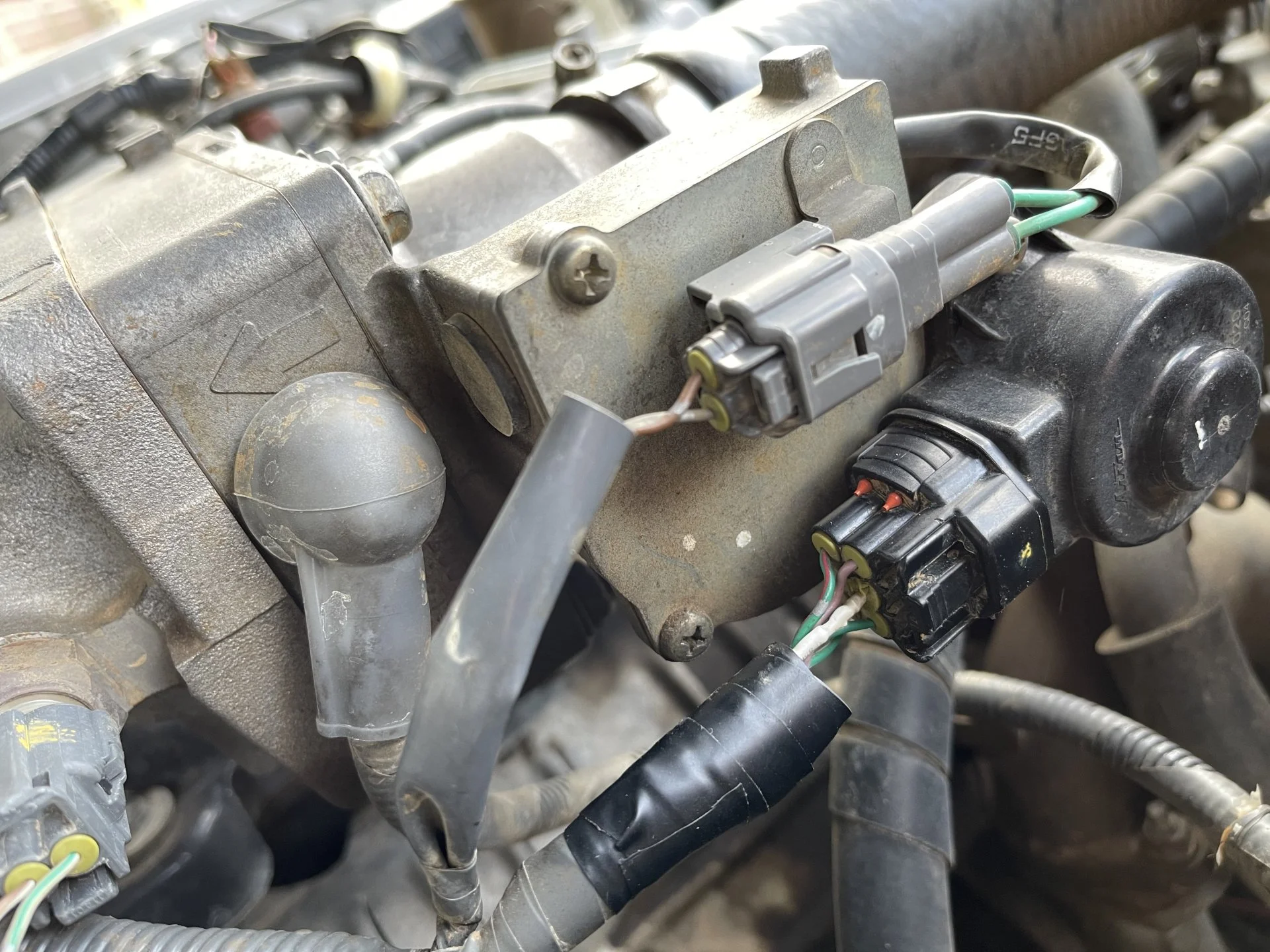

Hi all, just a quick note to let you all know the problem is solved. It indeed was a broken wire inside the throttle air control motor wiring plug. the broken wire was found, a new piece soldered on to the pin and reassembled back into the plug and she should all be good now. We had done quite a lot of corrugated roads this trip as well as most trips we go on we wind up on the dirt. We have been to Birdsville and Innaminka numerous times in this vehicle so I guess the corrogations caught up with us. thank you for the replies.
cheers Mark

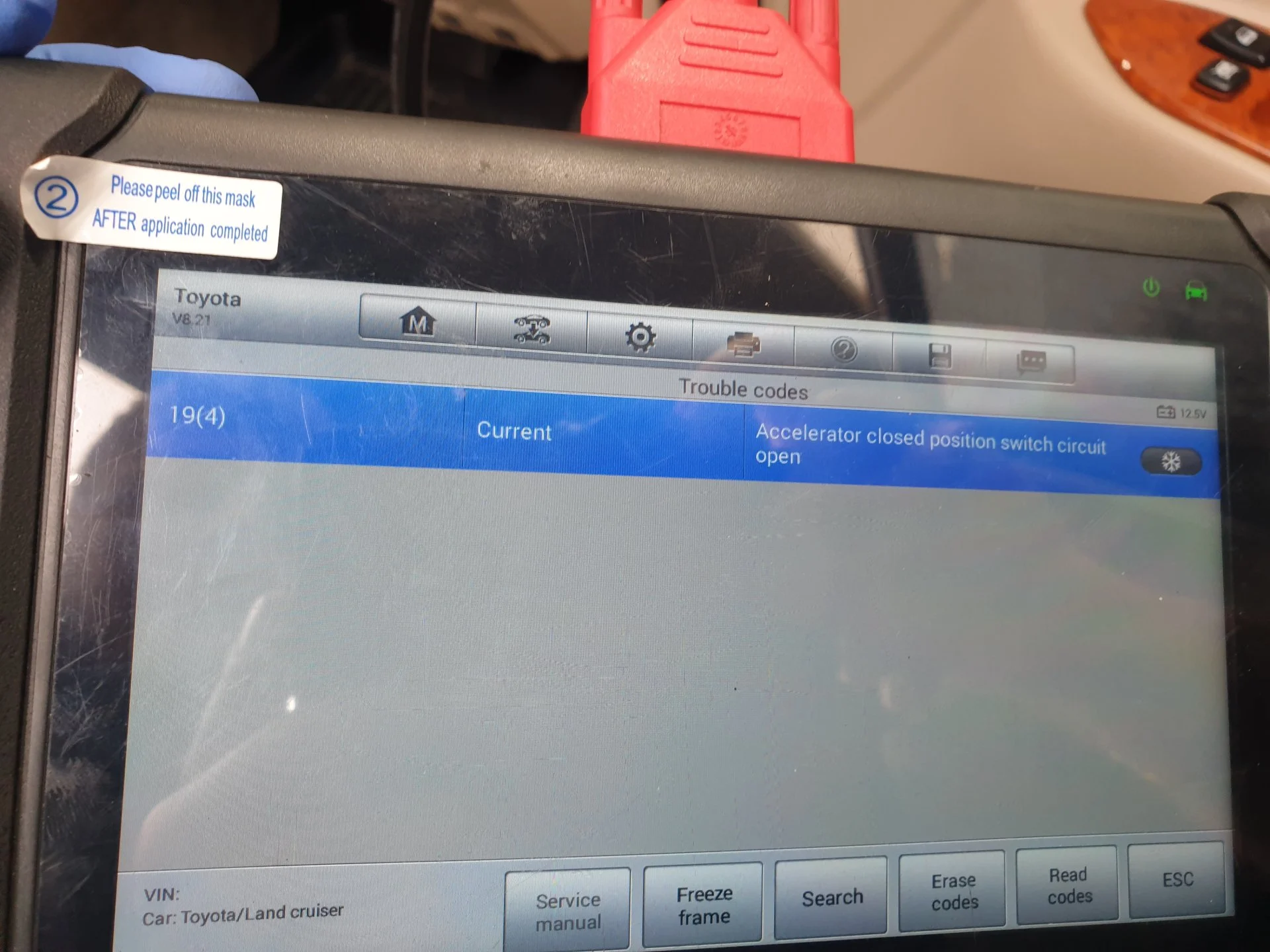

hello, My LC 98 model diesel version is also showing this same issue and its been going on for almost a year now. we have narrowed it down to the 19(4) accel closed circuit open error code. Could you please help in getting this issue sorted out. Thanks

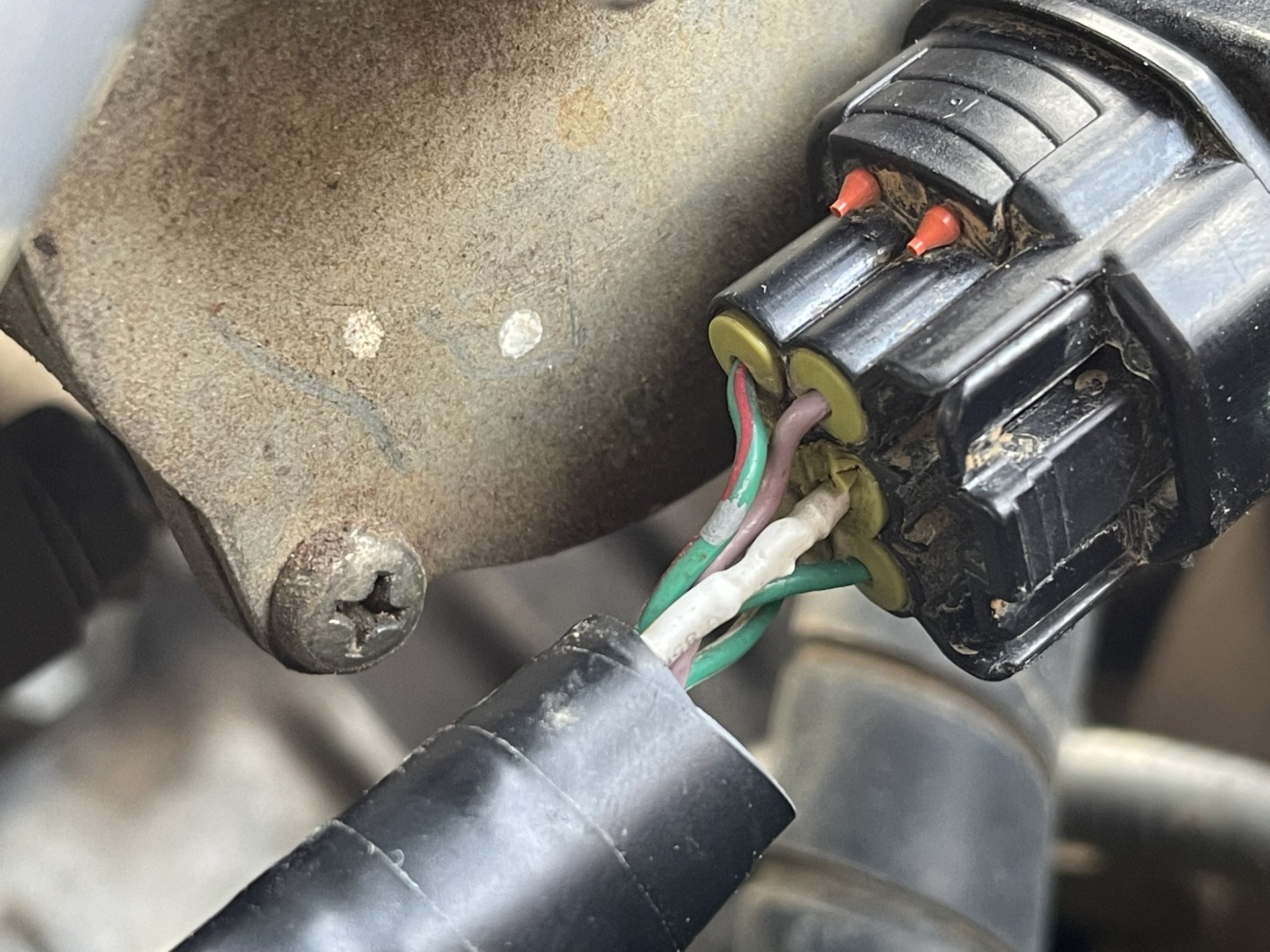

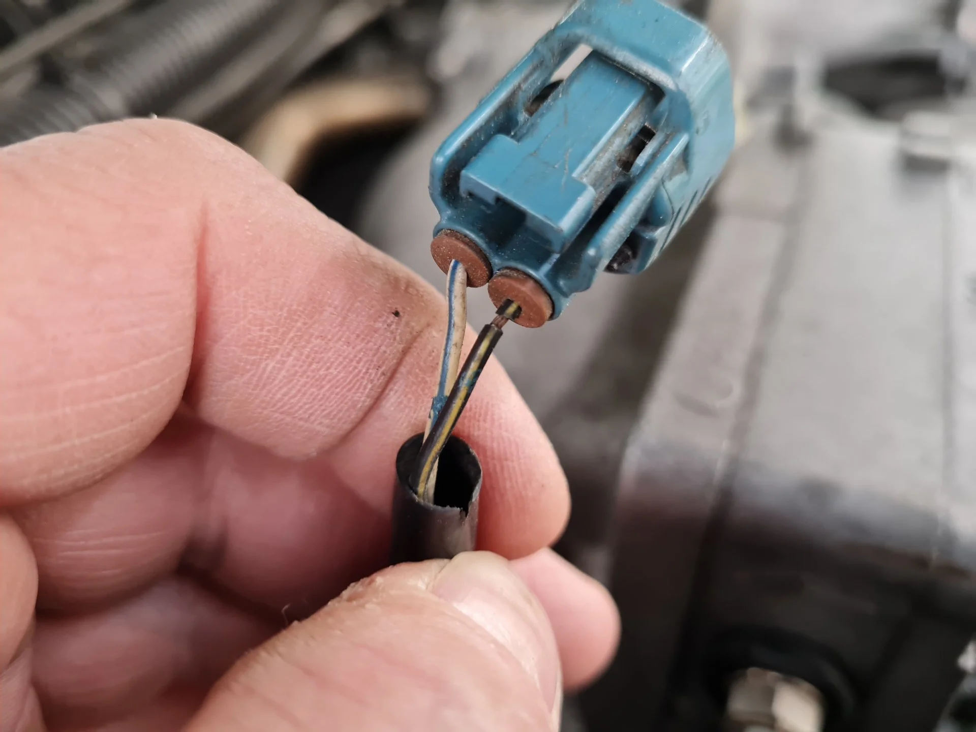

I just had exactly the same problem, I’ve had intermittent limp mode with the accelerator open switch fault 19(4) for a while now and had tried just about everything.
I just checked this connector and noticed the broken wire… Soldered it back up and put some heat shrink over it. Good as new!
See the white heat shrink for a reference as the wire that had broken.

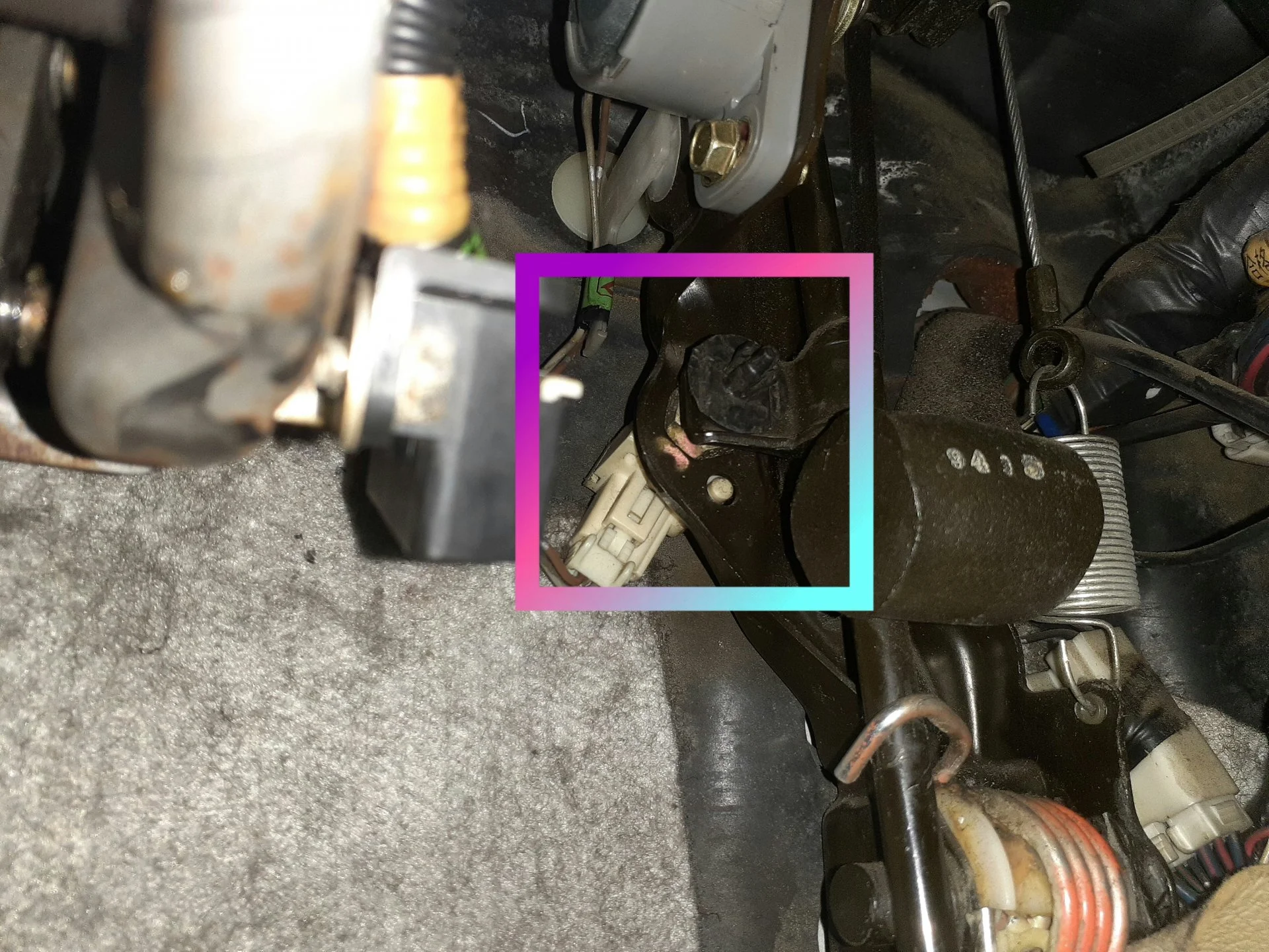

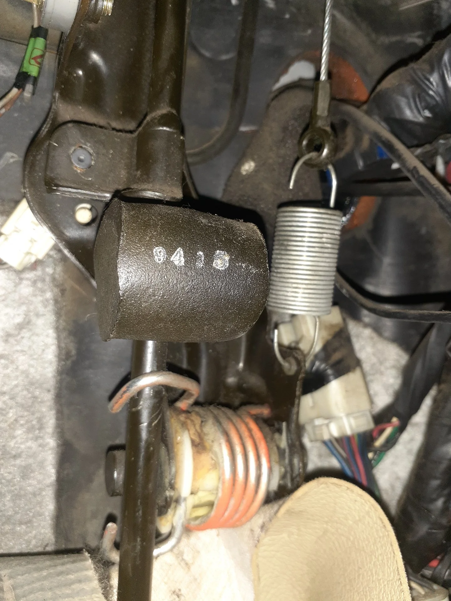

just ordered a new pedal will also be going through all the wires and plugs whilst im at it

So changed the peddle and found that 1 of the plugs was all green with corrosion inside, so all cleaned up and now back on the road
the hard part is now waiting with fingers crossed that it is cured, this might take a while as it didn't happen every time it was used but will monitor and let you all know, but it will be hard to work out was it the peddle or the connectors i will never know either way all i want is for it to be error free
So you examined the pedal assembly and cleaned up the wires at the connection? Glad you found a possible cure. Keep us posted.
as my hands aint the best and its not the easiest of jobs to get the top bolt on i ordered a replacement so changed it anyway but also cleaned up the plugs and connectors
