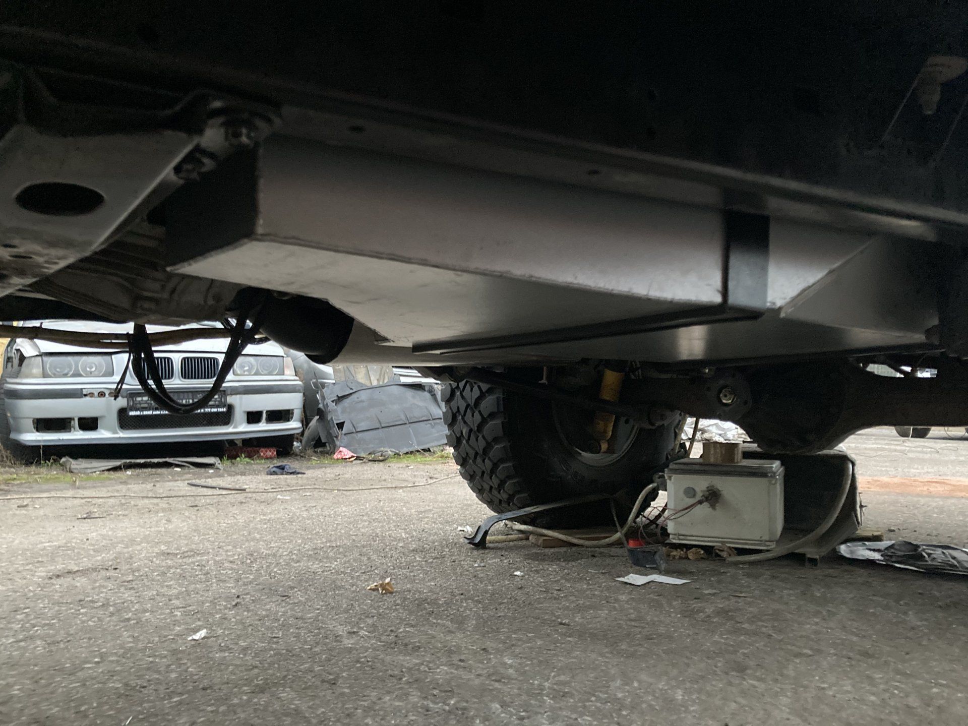

Also installed the lra long range tank and can tell you that this was pain in the ass to put.

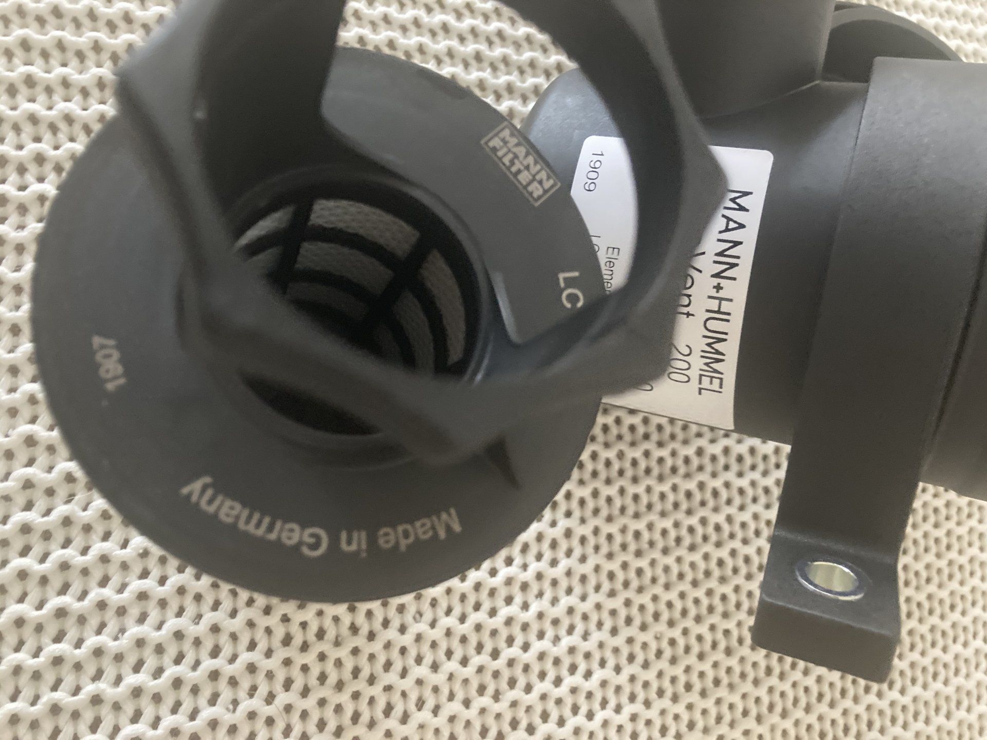

Received provent 200 from Germany, also waiting for the female obd plug so I can get the obd info

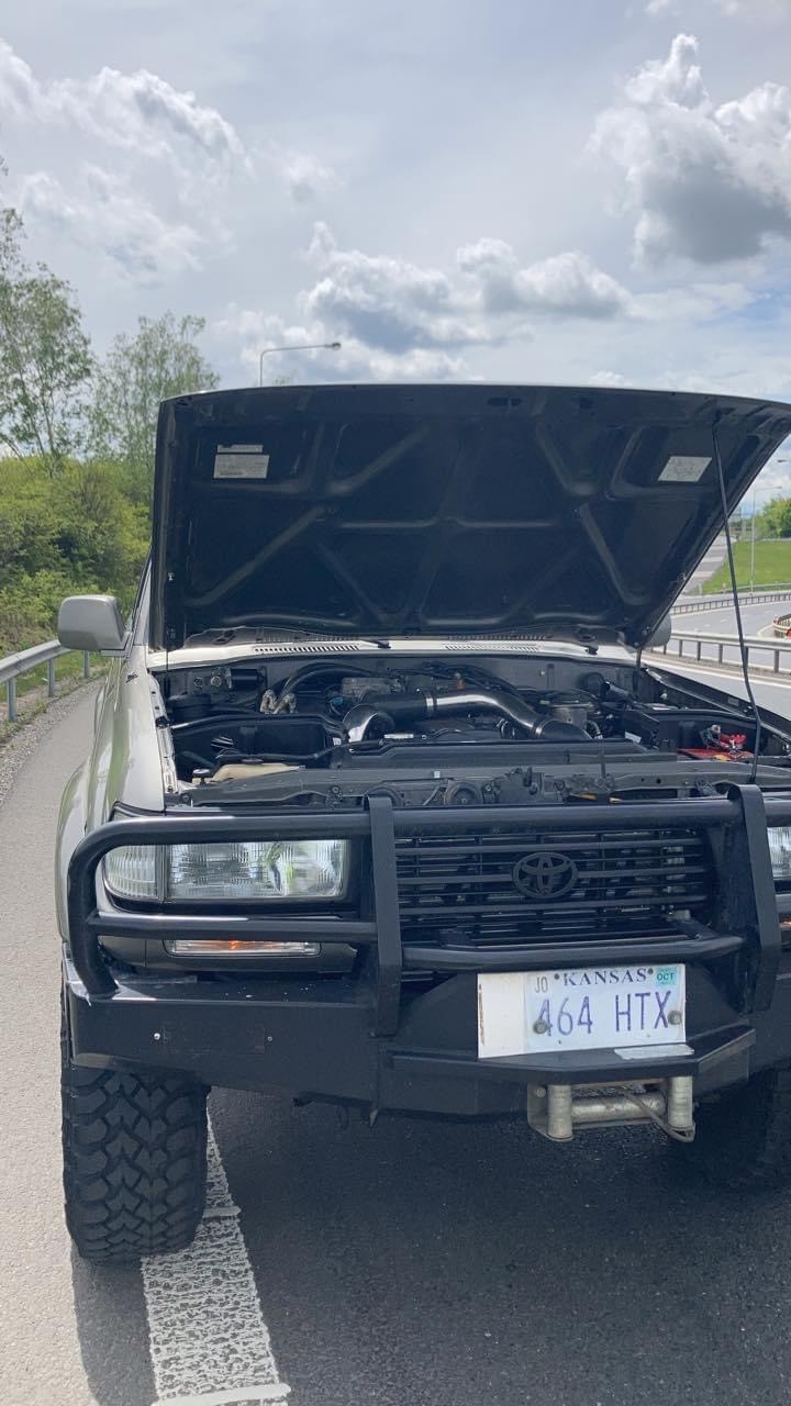

Hi! . . From the engine bay photo it appears your J100 is LHD.
If possible, could you please share details of how the auto ECU mounts under the dashboard?
