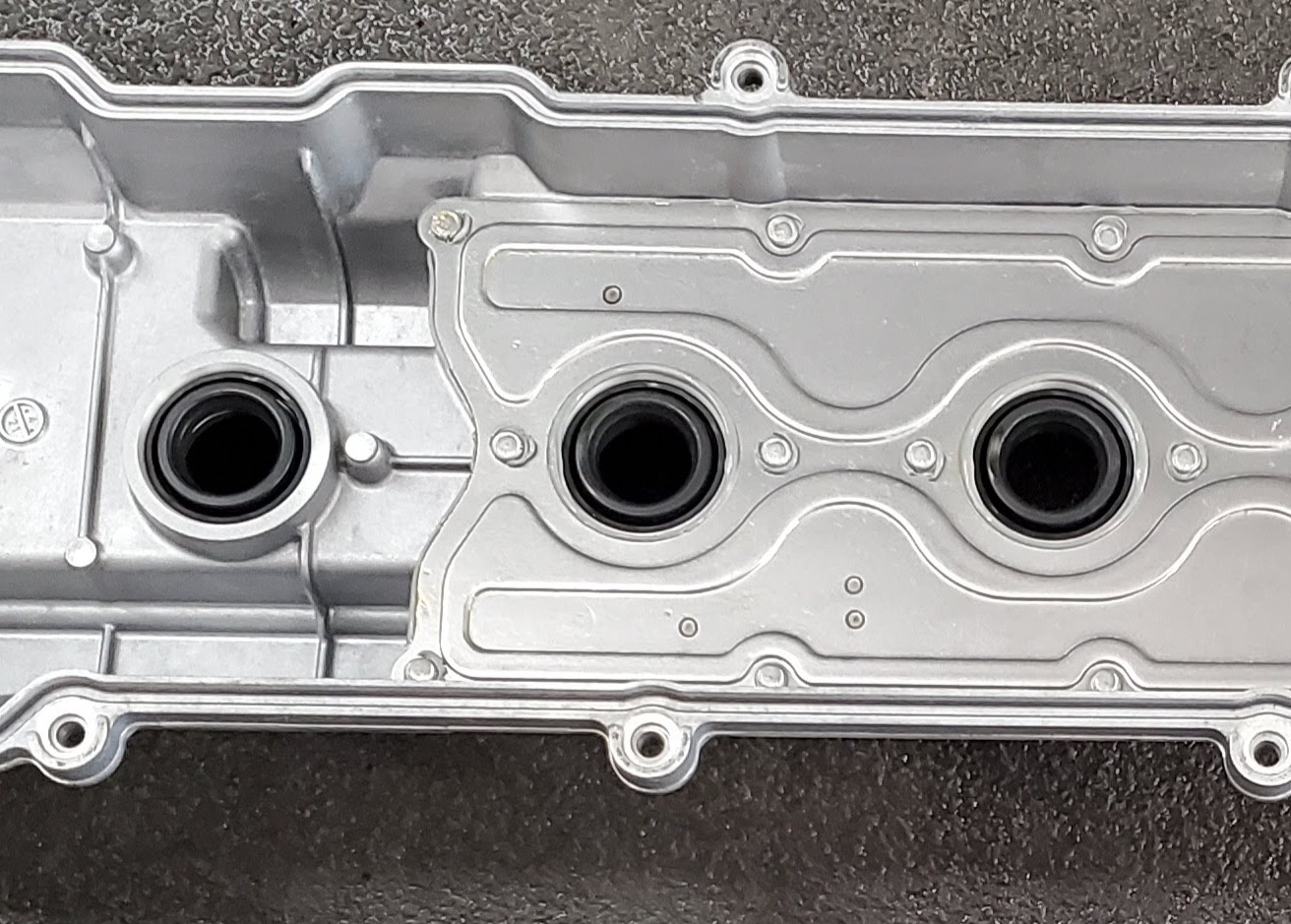

Here are some photos, the top photo is from TYM4FUN's build thread which shows a new valve cover (? most recent design) with a silver colored baffle, and an earlier version with the gold colored baffle.
Note the addition of a large rectangular ? drain hole in the newer valve cover (click on photo twice to magnify). But also note the squarish shields
over the vent (?IN) holes:
And here's a photo of a valve cover from an early 96 model US Spec FZJ80/1FZFE.
Compare this valve cover to the baffle design to the others above.
There are apparent differences in the design of the shields for some of the vent holes along with smaller open flaps for the drain slots compared to
the larger rectangular open hole in the top photo above:

Also note that the spark plug tube seals changed from the old design VC to the new design. Somewhere late 97 or to 98. The OD of the seal is smaller on the new ones.
One thing I did not mention, Toyota uses an adhesive around the parameter of the spark plug tube seals on the new valve cover.
Edit: Factory sealant apparently is applied when the baffle plate is attached to the inside top of the valve cover (I've found it turned brown and cracking off around the edges of the baffle plate). FWIW
So the new smaller OD seals installed into a new style valve cover from the factory used sealant/adhesive around the perimeter of each seal ie: during installation? Anyone have a photo of that?
When replacing those smaller OD seals, if sealant/adhesive is required,
anyone have a TSB for that?
Interesting
So I thought. Looking closer, it is sealer for the baffle plate.
OK, I've found that on two original valve covers but it had turned dark and was cracking off. When I recently cleaned out the inside of the baffle box a bunch of chips of that old sealant came out.
Interesting

So I did a little experiment: put the garden hose nozzle into the breather hose port on the valve cover, the water comes out of the open flap at the rear of the plate, same side. Putting water into the PCV valve port, the water comes out on the other side (same side as the PCV valve port), also at the rear of the plate.
Also when blowing air into either port it seems like most of that air
comes out the bent flap hole in the plate on the same corresponding side as the air went in, but there also may be some flow out the other ports?? Hard to tell, maybe someone can do a colored smoke flow test. ;)
So assuming the breather hose/port airflow direction is IN to one side
of the baffle box, and the PCV valve flow direction is OUT the other side,
then there must be a connection for air/gases (and some oil mist) to flow between the left and right chambers of the baffle box. And subsequently the design of the baffle plate/box will determine the amount of oil mist that gets pulled from one side to the other. IMHO.
The question is, for those with the earlier style baffle box, could people adjust those bent tabs to the open holes, cut a new hole, or ??
Looks like the with the new design they added shields to holes on both side of the baffle plate/box, most likely to decrease the amount of mist sucked IN to the baffle box. But they also added a large open rectangular hole on the breather side of the baffle plate/box. So is that for better airflow IN, or was it put there for better drainage of accumulated oil OUT (or both)??
IIRC someone has removed that baffle box/plate but I don't recall seeing
a photo of the guts of a baffle box/plate, anyone have such a photo?
Or (if your head hurts after reading this) forget about it and install an oil catch can. :)
Sealant? Sooo...when you tank (jet spray, actually) this at the shop, do you have to add sealant somewhere?
The gap where the sealant was originally, between the baffle plate edge and the valve cover, is very small so IDK how much it would change
the flow of gases or oil mist. Then add the fact that the baffle box has been redesigned it seems like it would be impossible to determine if the lack of sealant in that small gap would change the flow for the better, or worse?? I would assume any change would likely be minuscule.
IMHO I would not try to add sealant for that reason but also the sealant appears to have been applied before the baffle box was riveted down so the only way to get it back to spec would be to drill out the rivets, clean everything up, reapply sealant, then reattach the baffle box. Too much work for little (unknown) gain. If there was a visible gap then maybe you could push a small amount of a high heat oil resistant sealant into the gap and clean off any extra??
IMHO I wouldn't mess with it.
Main thing I focused on while the valve cover was off was to clean out any varnish, sludge, and the (small) pieces of old sealant from inside the baffle box. Any pieces that got missed, if they moved, would eventually flow down to the oil pan and either sit on the bottom, be washed out when the oil was changed, or get caught by the oil pick-up screen or the oil filter.
