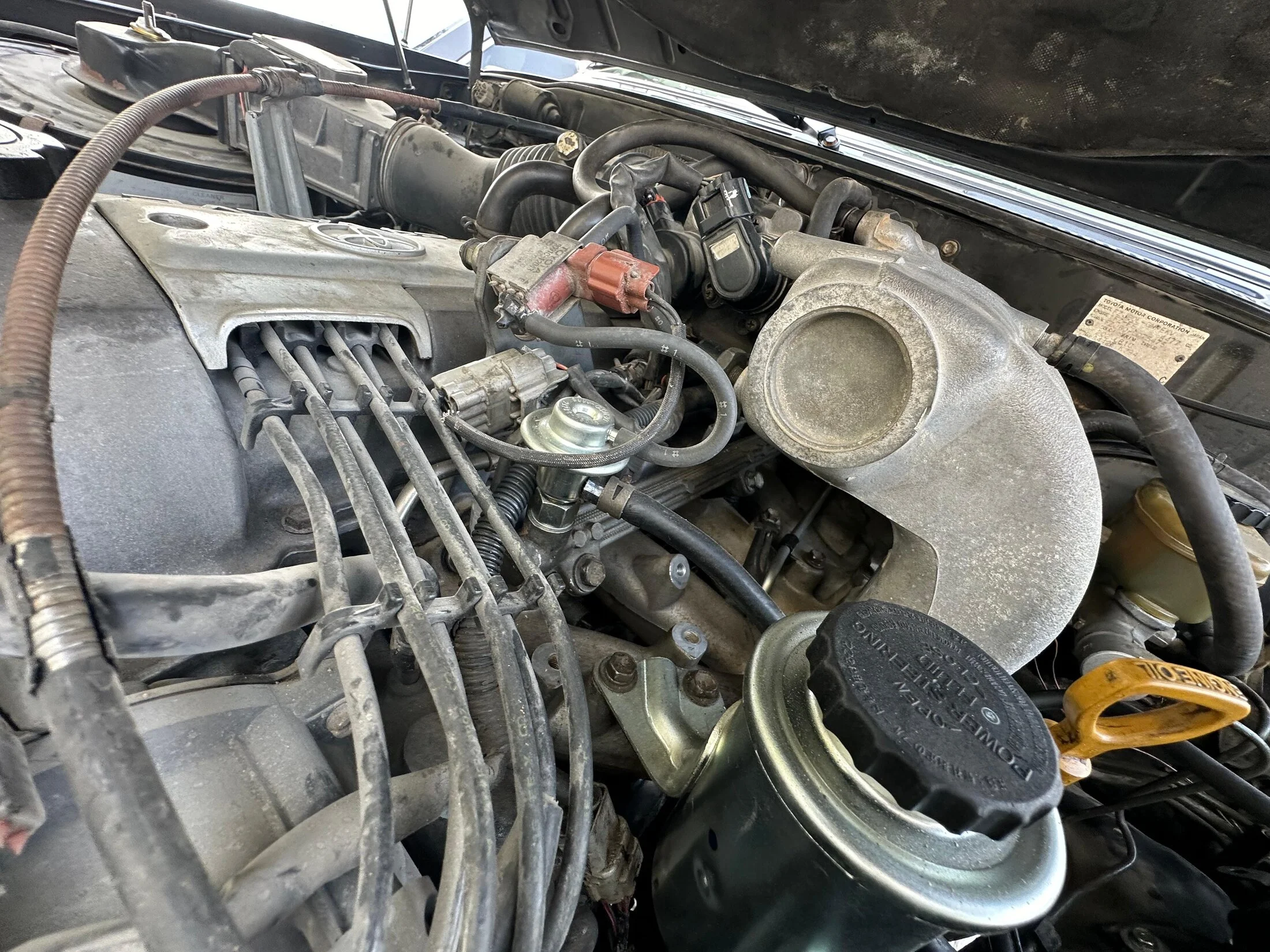

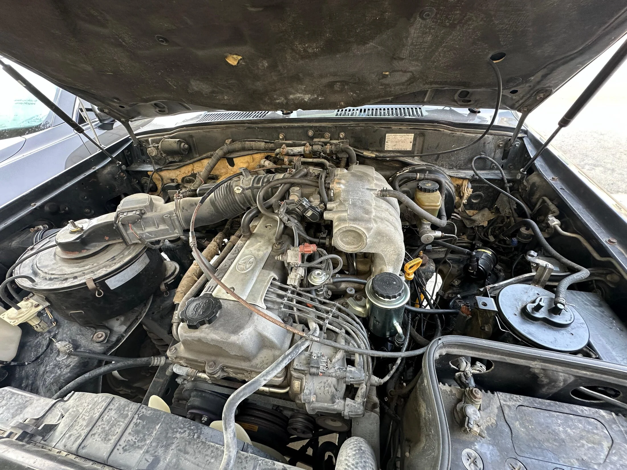

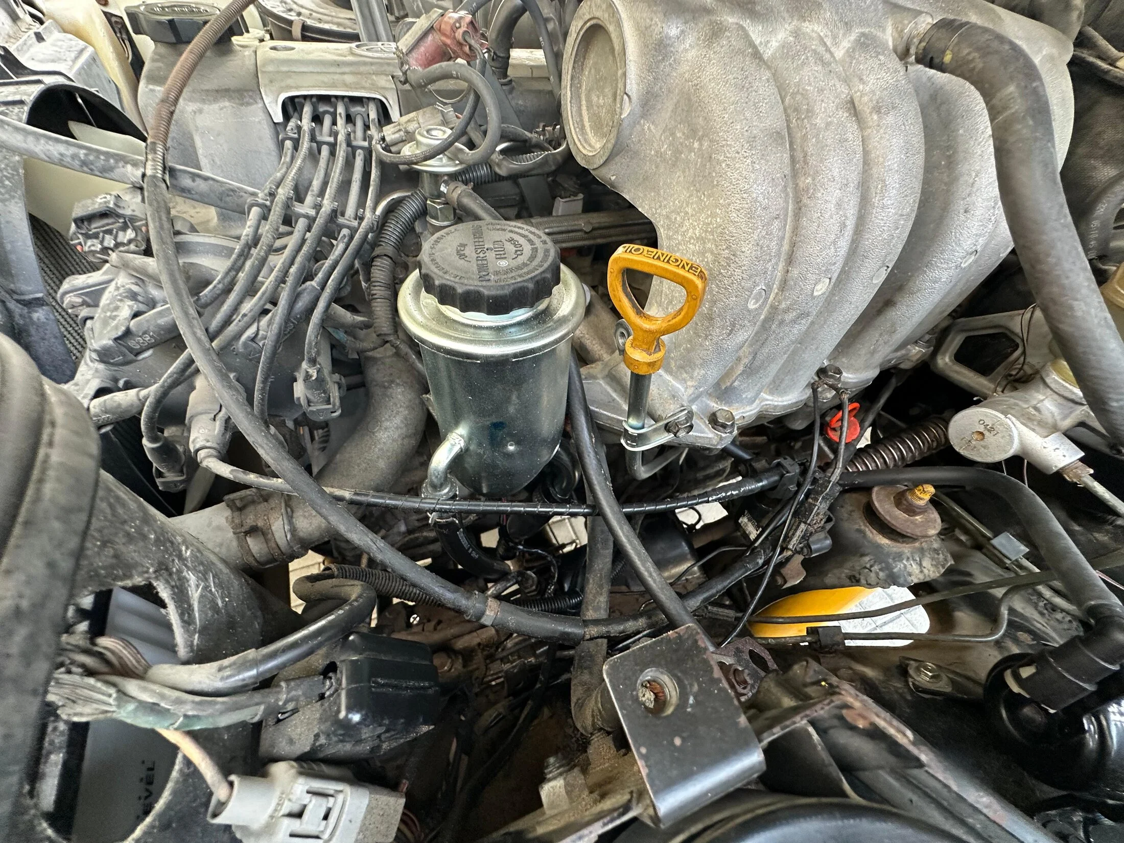

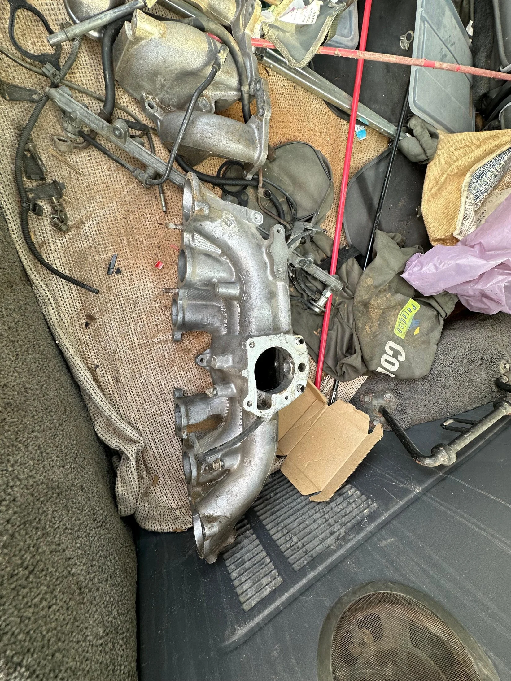

Back form the dead thread, I installed 2006 intake manifold on 94 LC 80
Nice upgrade, the car feels more crisp to drive, calibrated butt dyno
  • TANK, INTAKE AIR SURGE (17109-66030), traced TB gasket (22271-66010) on new intake TB opening
  • MANIFOLD, INTAKE (17111-66040)
Additional upgrades (all OEM) while in there
  • PIPE SUB-ASSY, FUEL, NO.1 (23801-66030)
  • Updated power steering reservoir (44360-60200)
  • Updated fuel Rail (23807-66030)
  • Updated Injectors (23209-66010)
  • Updated fuel filter (23300-50110)
  • New Fuel Dampers (23207-46010 + 23280-75010)
  • New oil dip stick (11409-66020 + 15301-66020)
  • TB, manifolds gaskets
