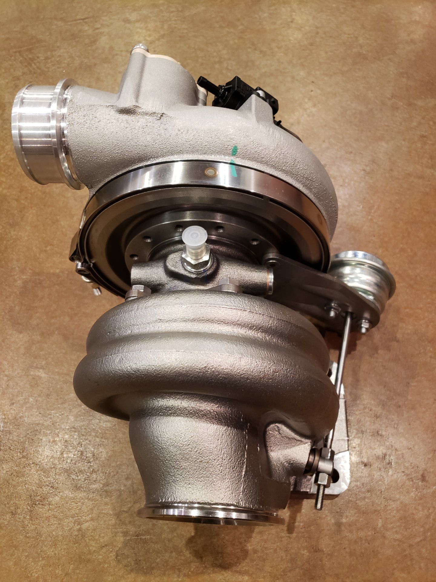

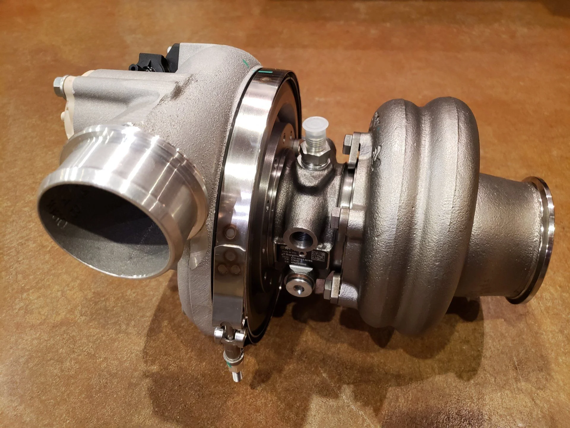

In the spirit of "pics or it didn't happen "
Here's the heart of the setup-
8374 efr twin scroll goodness.

I don't think it can either. That turbo looks pretty awesome. What boost are you targeting?

Great turbo, I run the EFR 9180 and 9174 on my Subaru (switch between them depending on track config)
