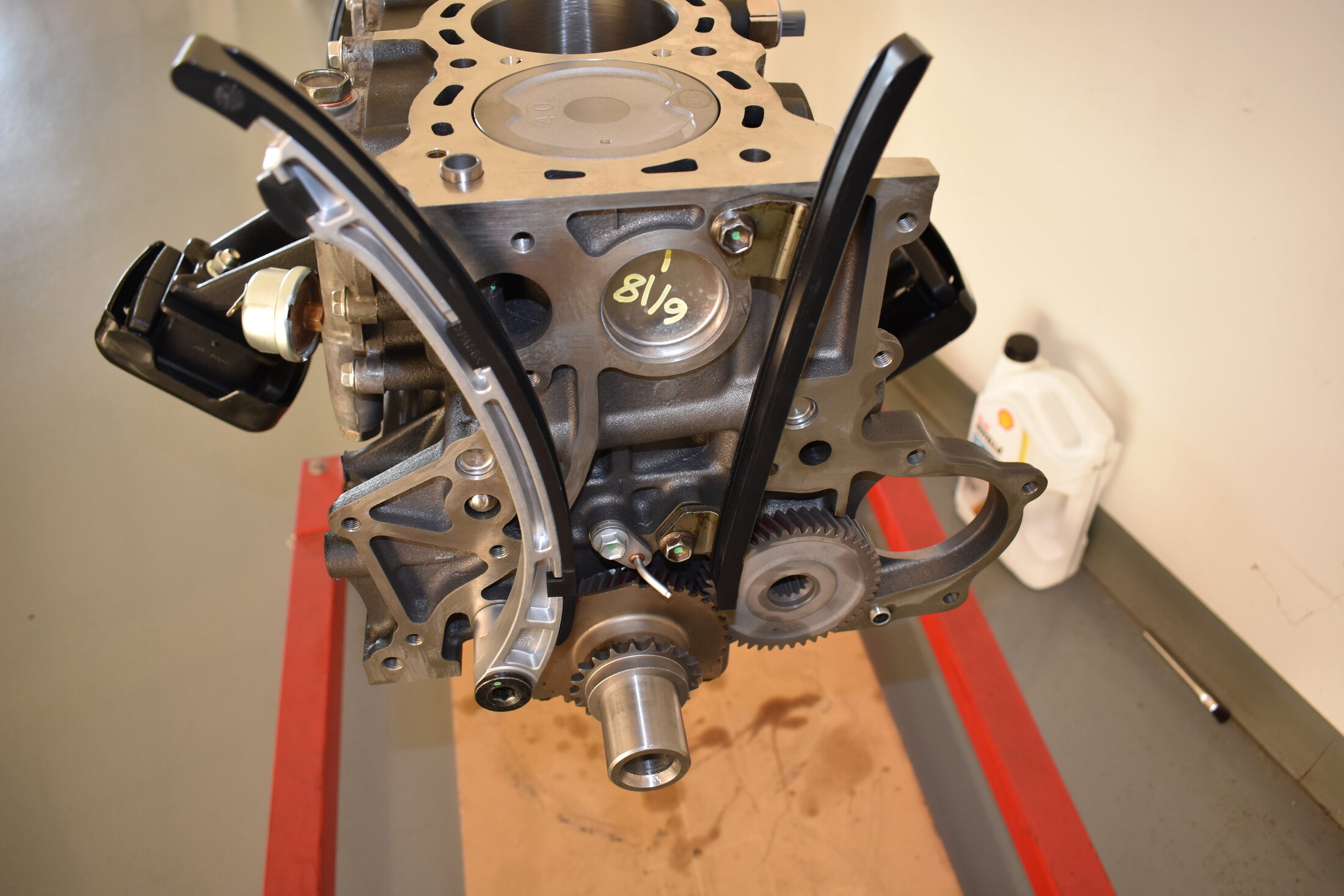

Installed new oil jet (13516-66011) and oil jet bolt (13516-66011). FSM specifies to torque to 14 ft-lb. I used a small amount of loctite 242 here like the damper because, again, I have trust issues behind the timing cover 😁
Installed used OEM crankshaft rotor, ensuring the flat face goes toward the block. I didn’t see any reason to replace my used one since it fit tight, was straight, and it’s not really a wear item.
Installed new crankshaft timing sprocket (13521-66020) by lining up with the keyway and gently tapping on either side with a brass drift until fully seated. It really doesn’t take much force at all.

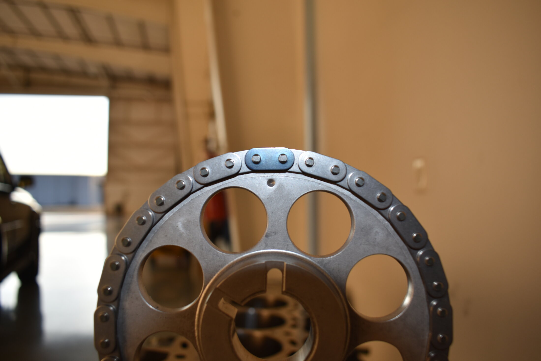

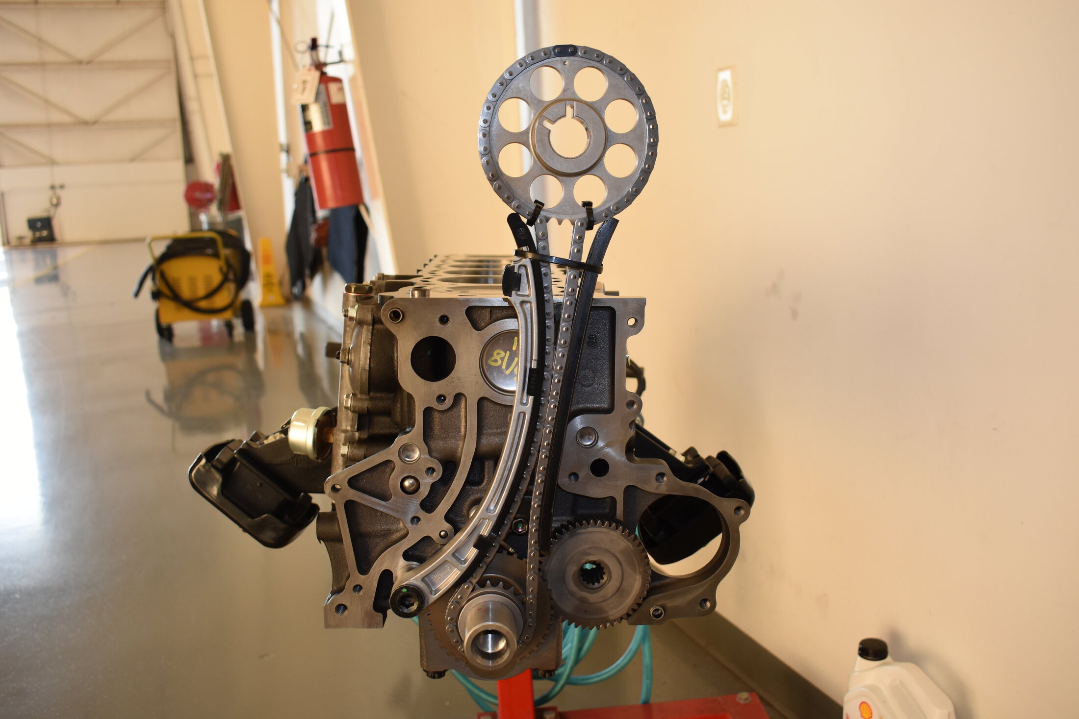

On my work table, I placed the new camshaft timing sprocket (13523-66020) inside the new timing chain (13506-66010), aligning the timing mark on the gear with one of the black/“blight” links on the chain. Then, I carefully put two zip ties on the camshaft sprocket to hold the chain in place while I placed the other black link on the crankshaft timing sprocket inline with its timing mark. Then, I added another zip tie around the slipper/damper to try to keep things together—the combination of these three zip ties keeps the chain tight around the crankshaft timing sprocket. It’d be a bad day if the chain jumped a tooth behind the timing cover while assembling the rest of the engine.
