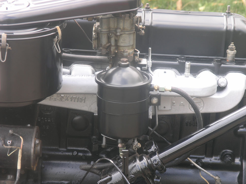

mine is like this:
Your going to have to source a different top to your air filter in order to fit mine. As well my carb is 5.85 inches tall. The mouth of the carb is just a tick over 3" at 3.08.
About the only thing that will bolt right up to mine. Is your fuel line and the manifold. You will have to get creative with the air cleaner and throttle attachment. Your going in uncharted territory.
I also include a spacer for the air cleaner but its only .5" high.
I can try and figure out an adapter to go from your early air cleaner to my carb. But I have no idea how this will effect the airflow going over the venturis.
And for future reference. My carb is 149mm tall not taking into account the lip for the air cleaner. The spacer adds 10mm when added. The mouth of the carb is 78.4mm
And it looks like the linkage might bolt right up since there is already a hole for it on my carb. Just have make sure you have clearance at wot.
