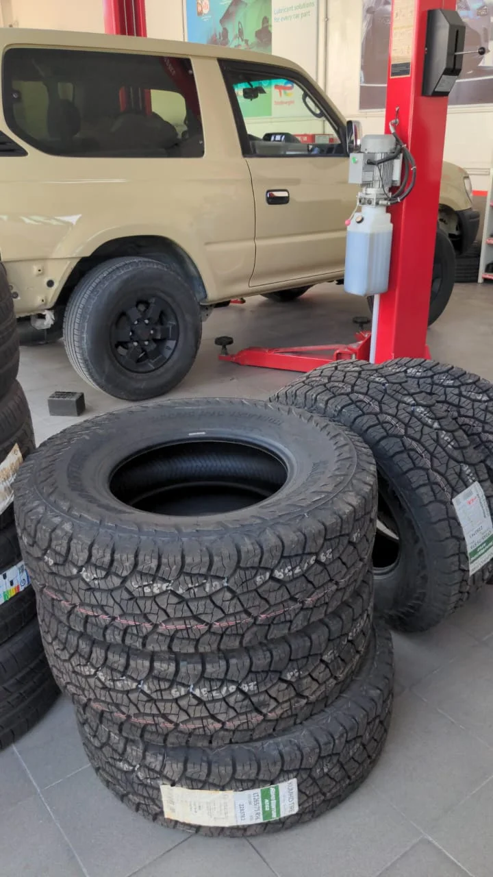

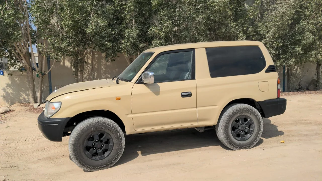

The Prado has been a bit on the back burner but one thing I could not delay is a tire change. The ones on the truck were starting to herniate. Just a matter of time before a blowout.
Kumho - Road Venture AT52 (Qty 5)
265/75 R16

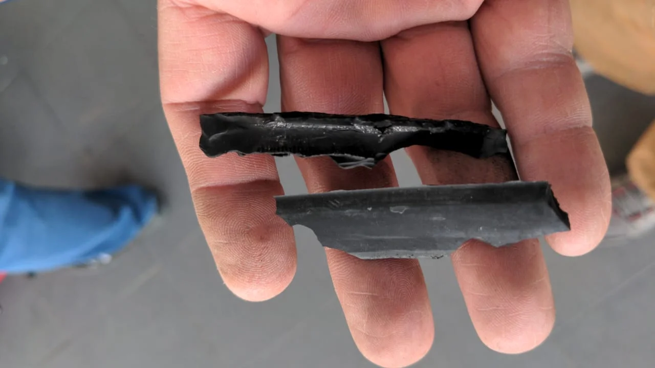

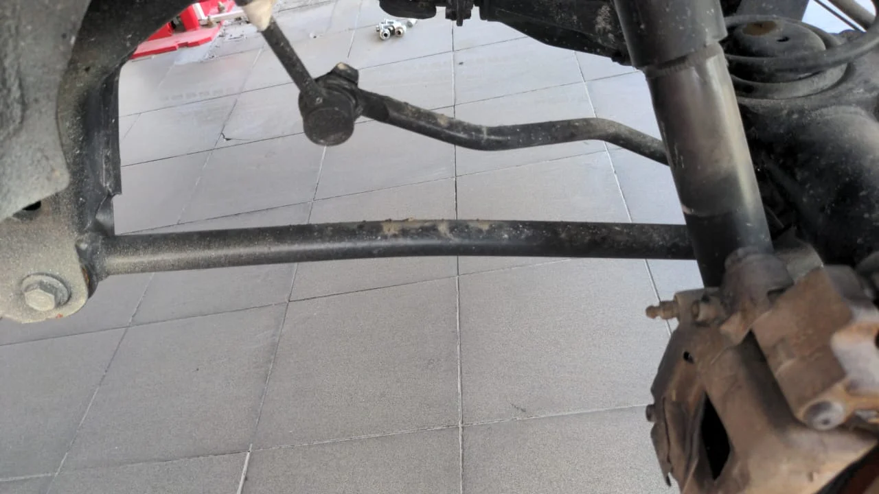

I also found bent rear suspension elements while the tire work was going on:
I'm going to have to replace these.
And when the old tires were coming off the TRD rims the beads disintegrated. Clearly the old tires were about to blow.

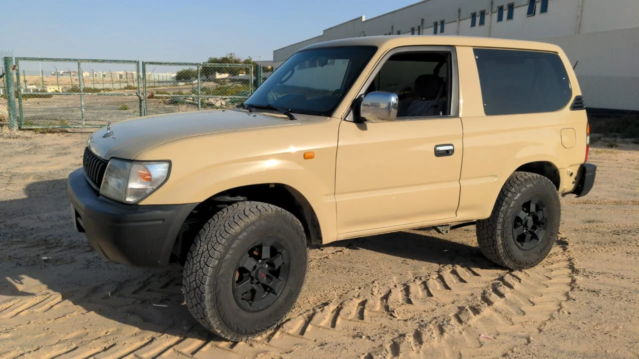

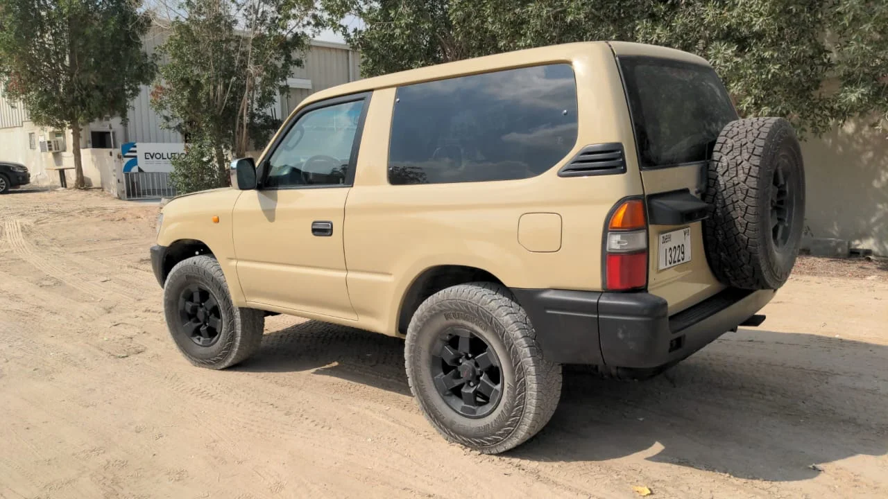

Today was a red letter day! The Little Prado finally has the missing trim from the rear wheel to the rear bumper installed!
A big thank you to @t00manyuserz, my friend in Japan with a Middle East 80 he imported there at great trouble and expense, who helped me source the rear trim pieces when nobody else could find them!

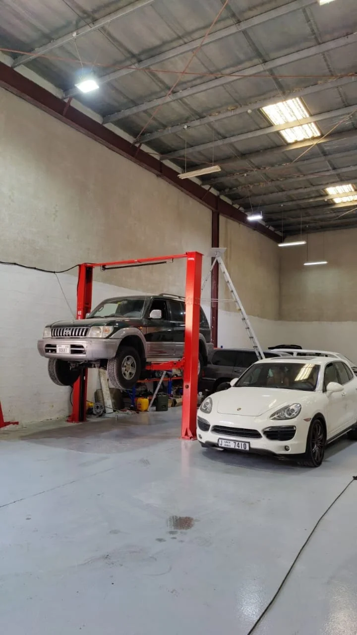

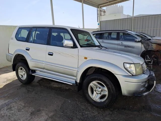

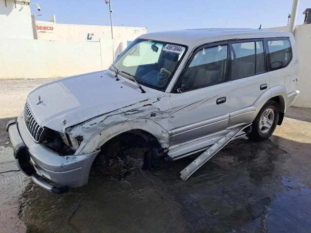

So I am way behind on posting on this thread. A lot has been going on. It was running ok but the idle was too fast and the guys were saying it was something to do with the throttle body. I also was not overly happy with the transmission so I took the opportunity to buy a copart 4 door from Oman that had the same engine and transmission and not so many miles. It had been dumped because it had lost the upper control ball joint and the front driver's wheel had fallen off.
The plan was to pull all the driveline components and swap them in but when the guys at the shop got into it they concluded that the heads on both engines were kinda toast.

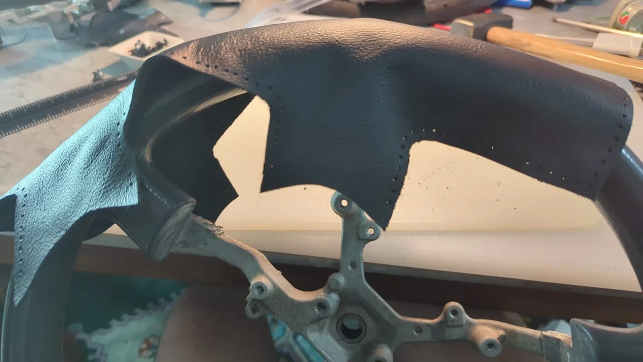

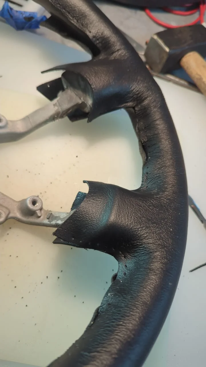

I've been kind of bad in keeping up this thread. A lot has been going on actually. Crazy stuff too. But I want to cover that in chronological order. I will immediately add here that I am helping a friend with a 95 acquisition and refurb and as part of that I am recovering the steering wheel with .... camel leather.
This is Mr. Khar

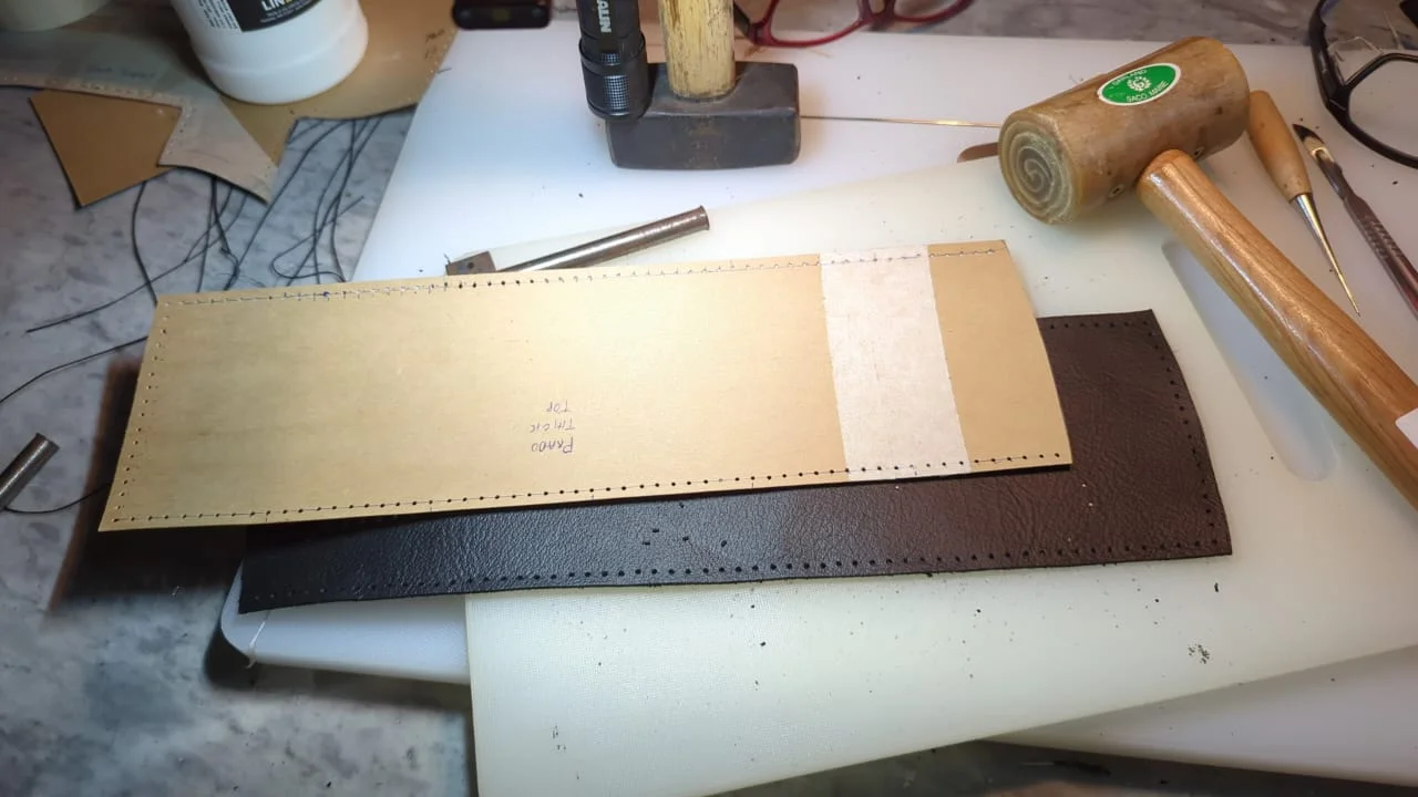

I make my own patterns

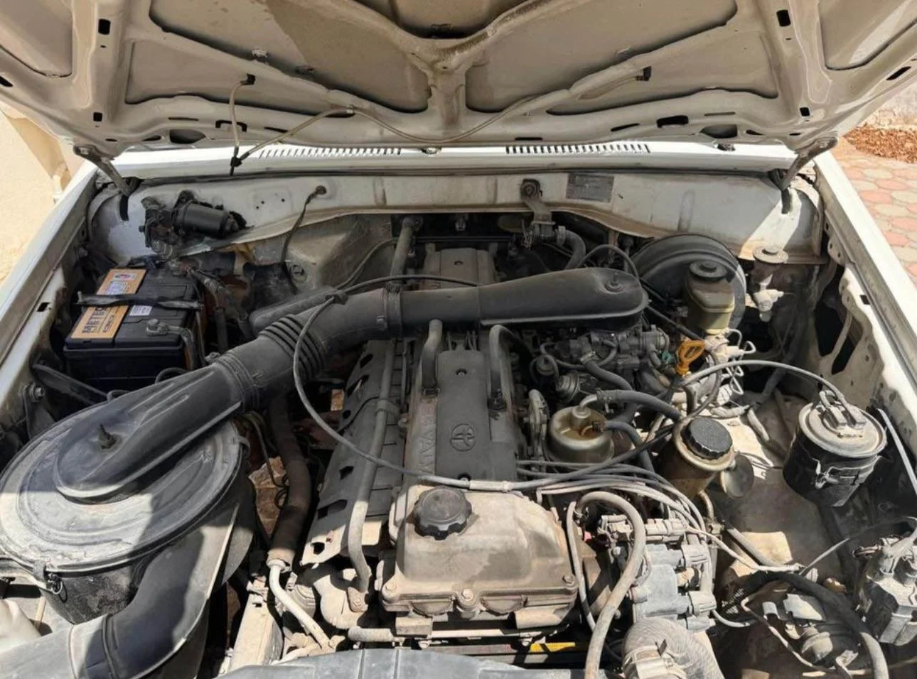

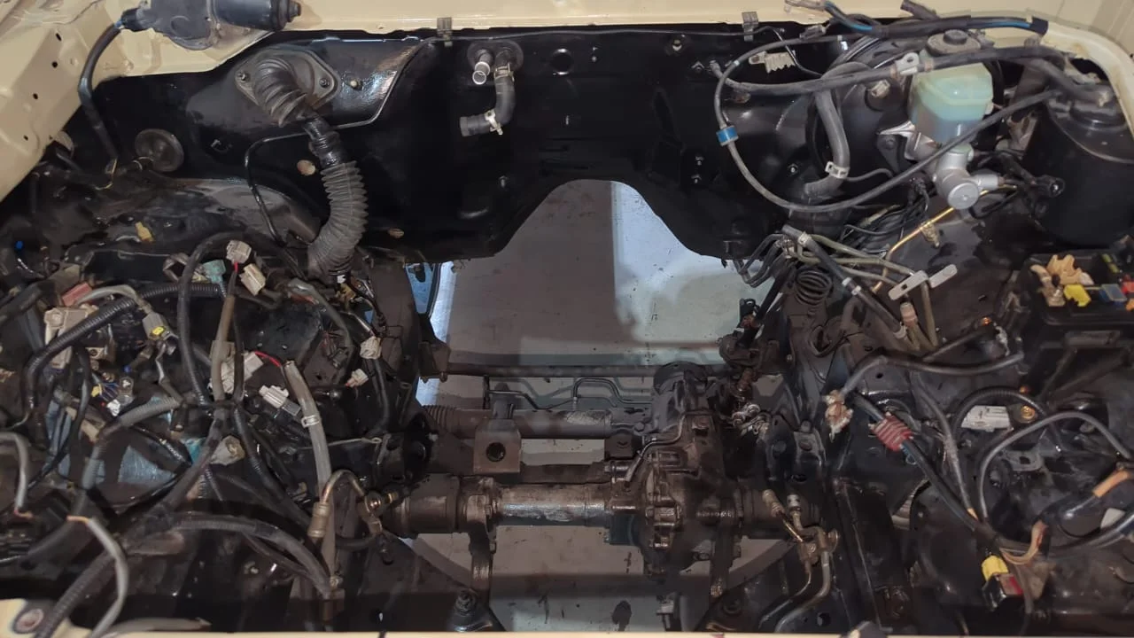

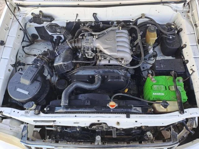

The engine is out of the Little Prado and has been for some time. We've taken the opportunity to clean up the engine bay.

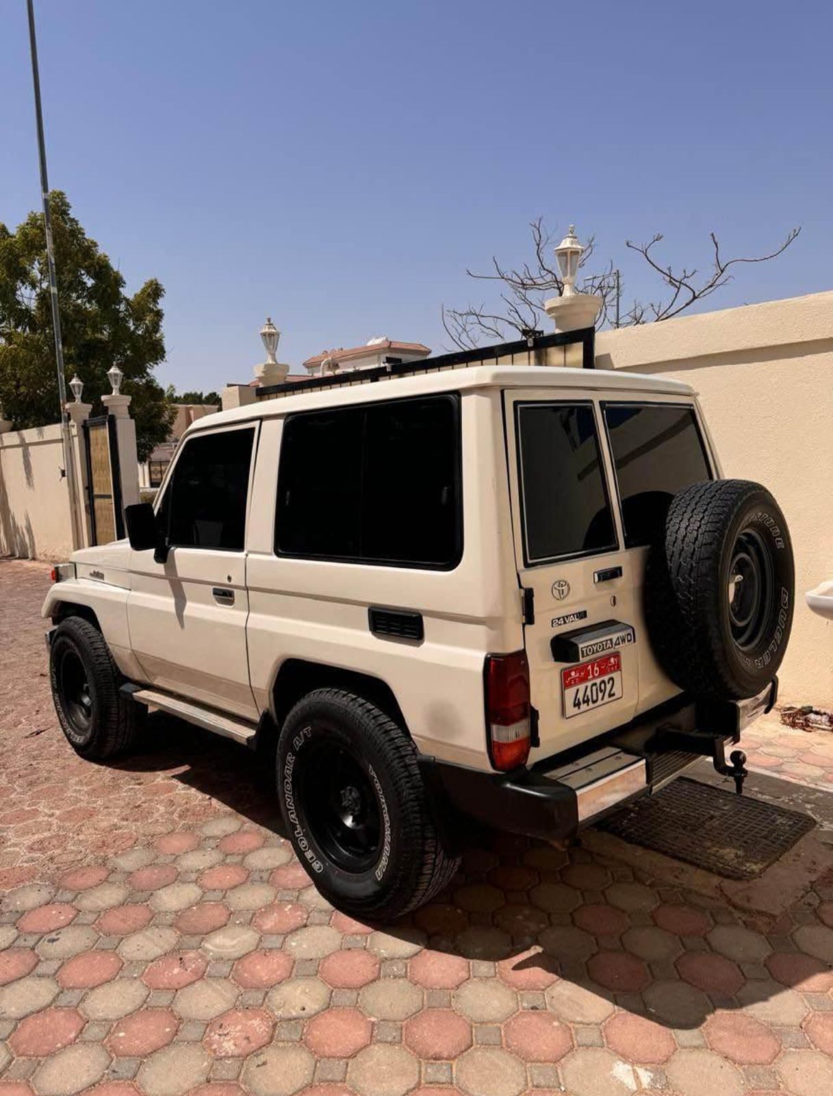

And I've fallen down the rabbit hole again and bought a little "prado" 70 series
I am contemplating a color change to Toyota 'sand' to more or less match the Little Prado.

That is not a Prado. It is an FZJ70. It should really scoot.
You are, of course, correct. I was under the false impression that Toyota used 'Prado' for the 2-door 70 in some places. But now that I looked it up, I see that it was just used for the J70 with the small motors.

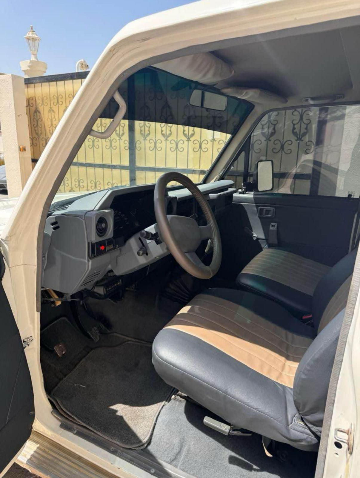

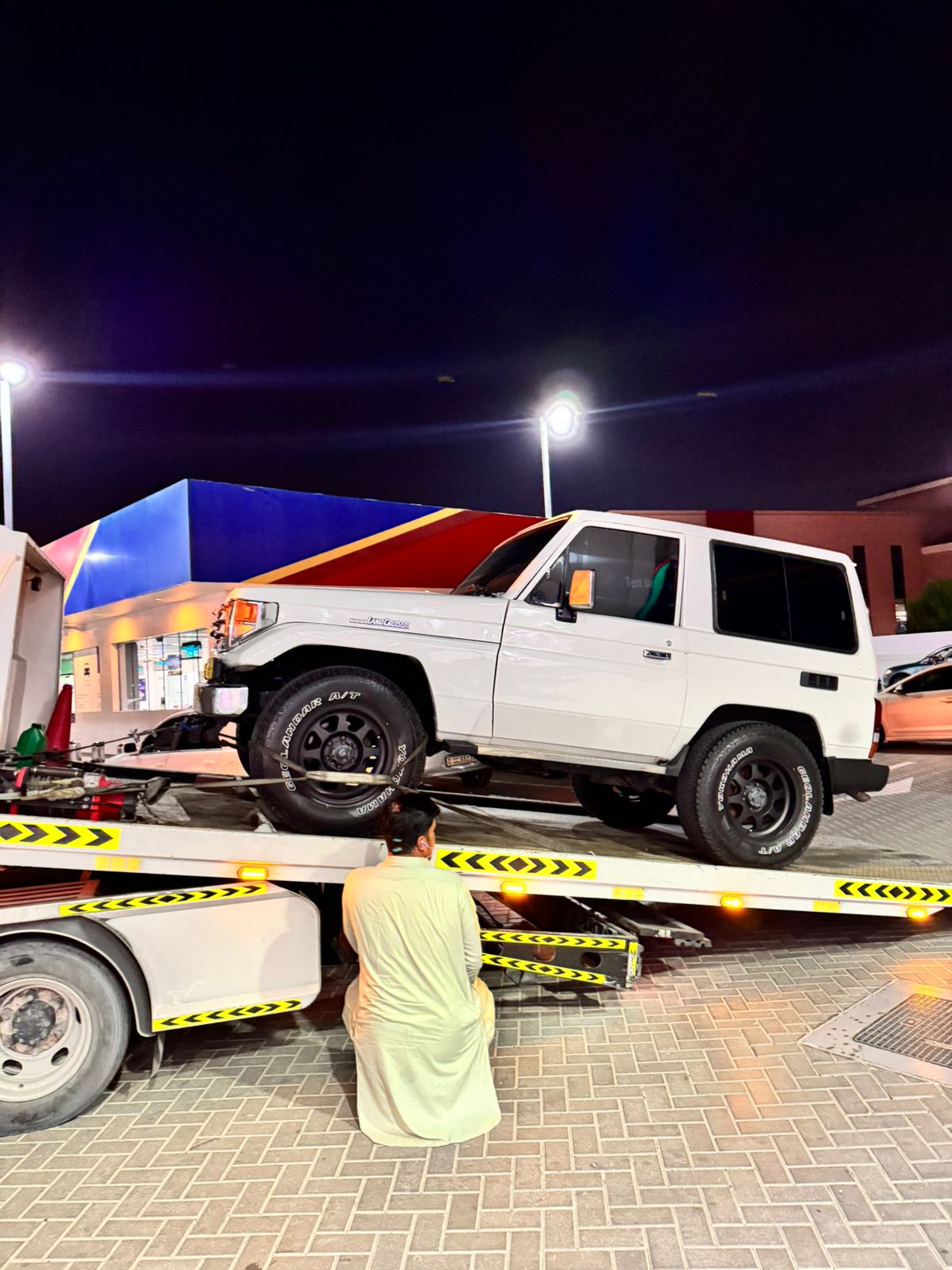

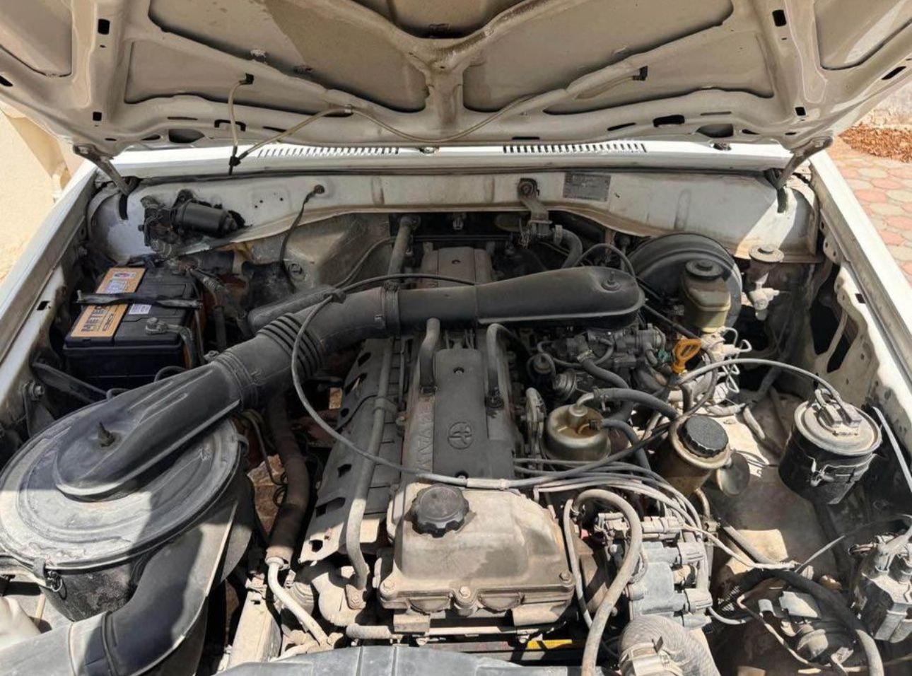

I hope to drive it tomorrow if I can wrangle the insurance and registration. Everything on it is a bit rough. The body has plenty of plastic filler--really badly applied--and then painted with shiny paint, but the price was good and the bones look good with no apparent major mechanical issues. Fairly high mileage at 470k km. But I kind of live for bringing these things back to respectable condition. I would not have bought it if had frame issues or the drivetrain had been monkeyed with.

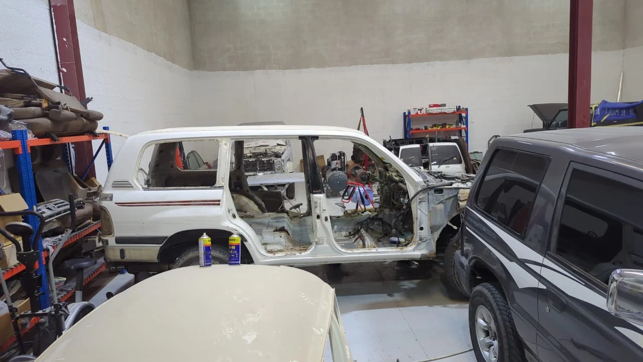

I am my most worst enemy. I've now got three rescue missions: the Little Prado, Schrodinger's Truck (the 600k km diesel 105 mystery machine from Yemen by way of KSA):
It is getting body-off treatment and it is eligible for importation to the US. And the third is now this FZJ70. BTW, you can see the nose of a early 2000's 70 series shorty if you look through the rear doors of Schrodinger. (BTW I was driven in a tuned FZJ70 with the 1FZ-FE. It was a rocket! Scary even. This one, being carbed, will be a bit more tame but plenty for me.)
Here is a better view of the other shorty in the shop:

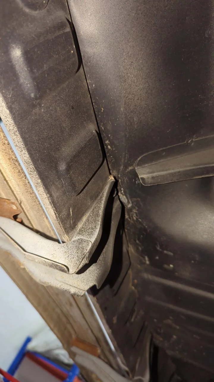

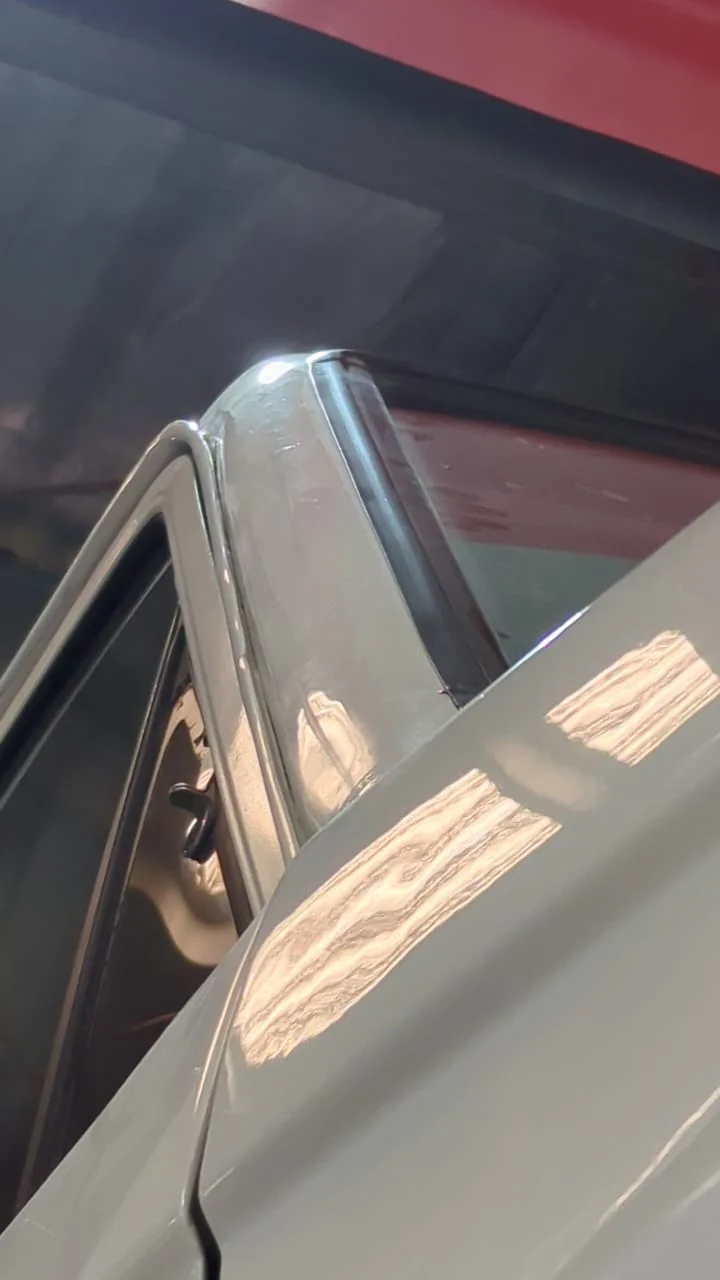

We are going to do the same thing with my Shorty. However my body is in much worse shape. I think it rolled over onto its left side. and maybe the A pillars got crunched. We will see when we get down to the metal.
Here is a close up of the passenger A pillar:
There is a good 1/4 inch of bondo on that thing. It pains me to see fancy shiny paint on top of a really bad repair.
There is damage on the B pillar on the inside suggesting the roll-over, but when looking from the underside on the left side it looks fine with no repair.
And there is no evidence of front end damage.
Normally I would not have bought a high-mileage roll-over. But a friend suggested I take a look and this one looks worth saving, and doing properly, and the price was right. It will be VERY interesting to see what is under the paint.

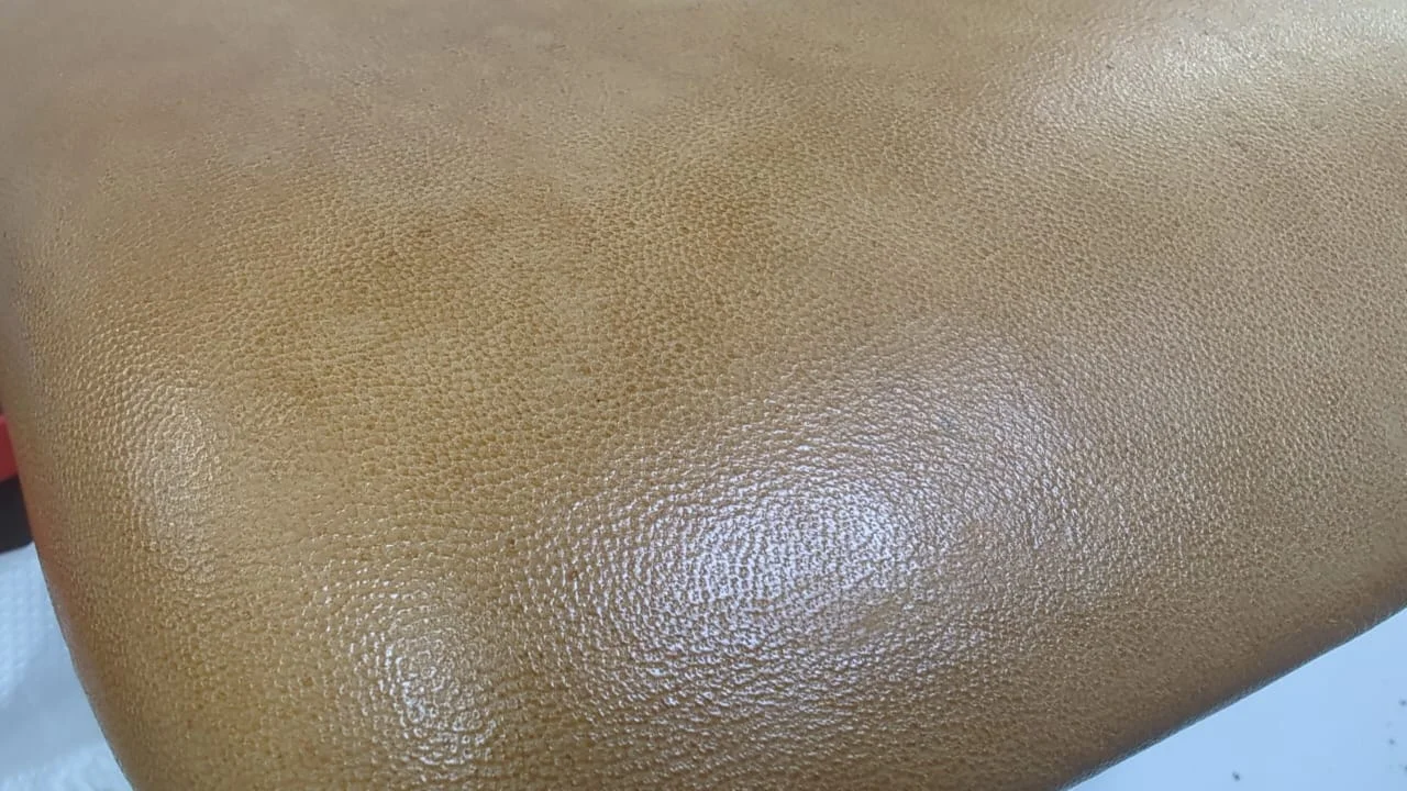

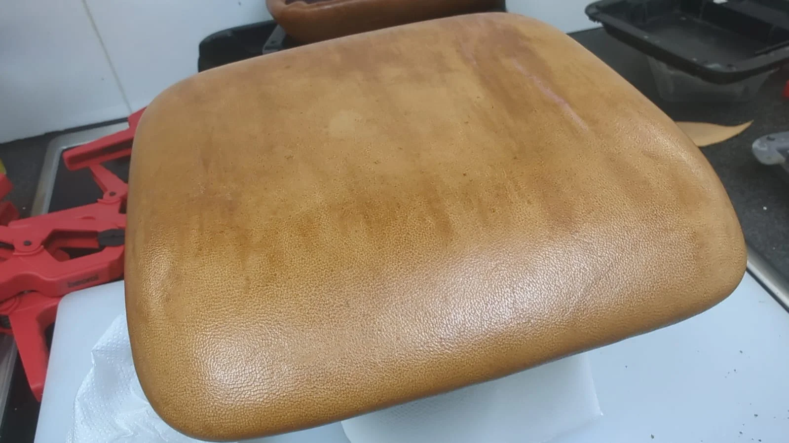

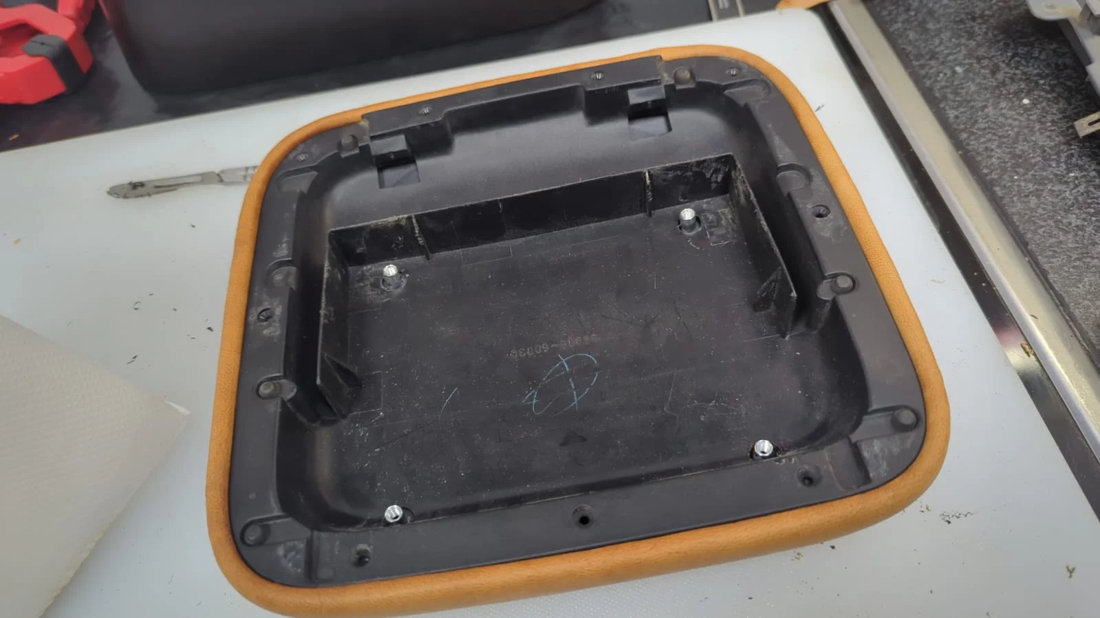

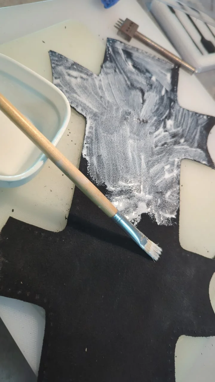

I've repaired and painted the plastic but now I need to complete the pad for the top. I like to cover bits of these cruisers with camel leather that I source in the UAE, and this pad will be no exception.

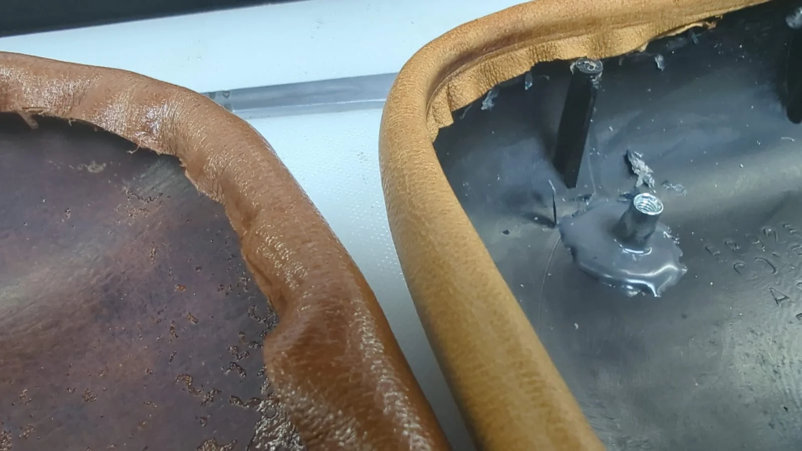

The test article is the darker one on the right.
To get the leather to really stretch I actually put the leather in boiling water for a moment. Makes it really stretch, but it also causes it to shrink and thicken. I found that I could not get the plastic cover in after I had covered the test article because of this:
For my second go at it I just used hot tap water and it did much better. Even allowed the leather to thin out when I pressed in the plastic cover.

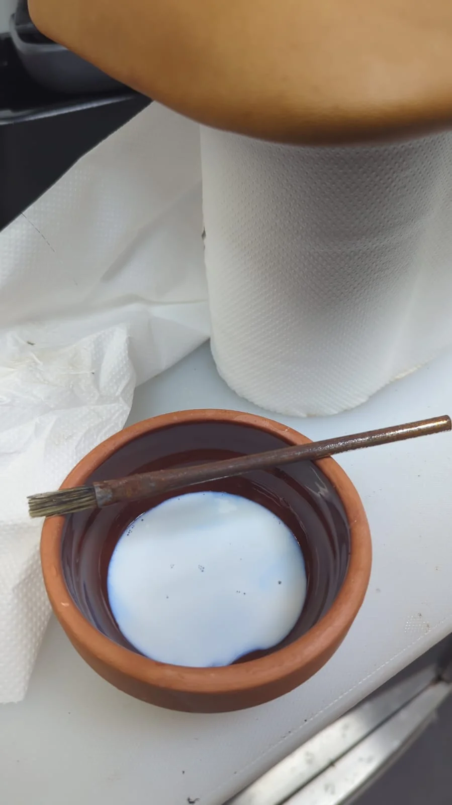

Although the leather does have a type of finish on it, it still absorbs anything liquid, do I seal with a special acrylic leather sealer:
Also deepens the color:
Here is one more photo:
I just love this leather! You can tell it came from a real animal and it has really nice flaws and imperfections.
