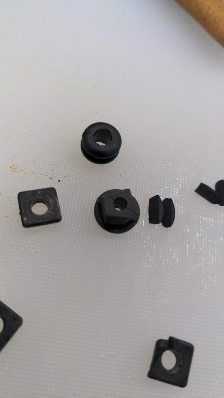

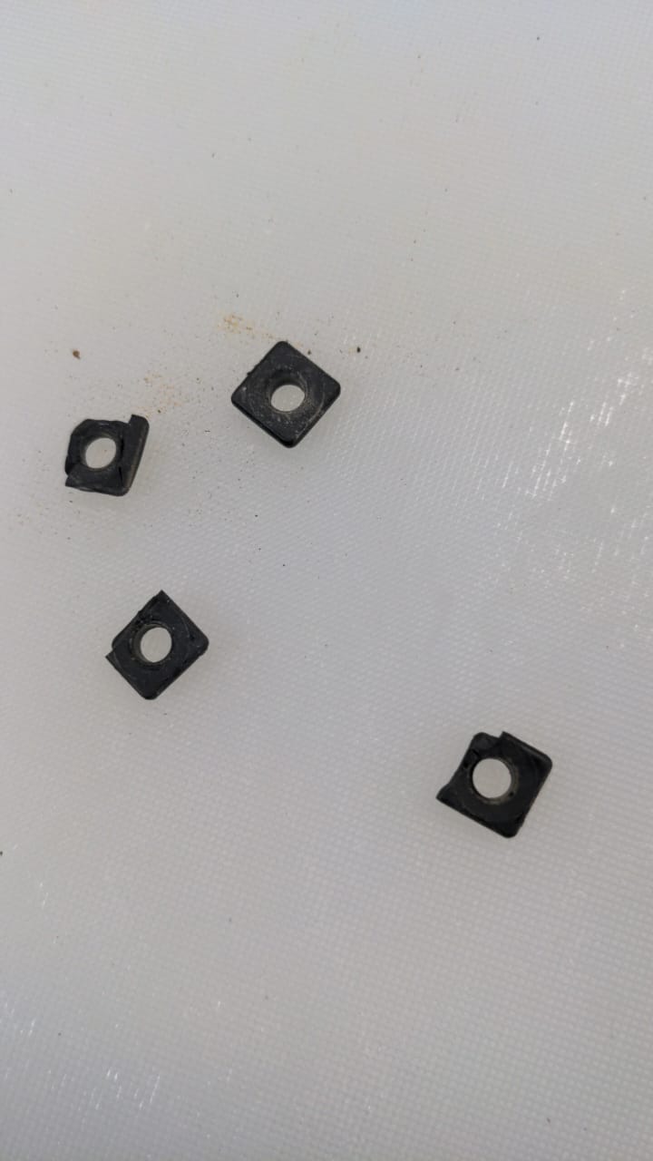

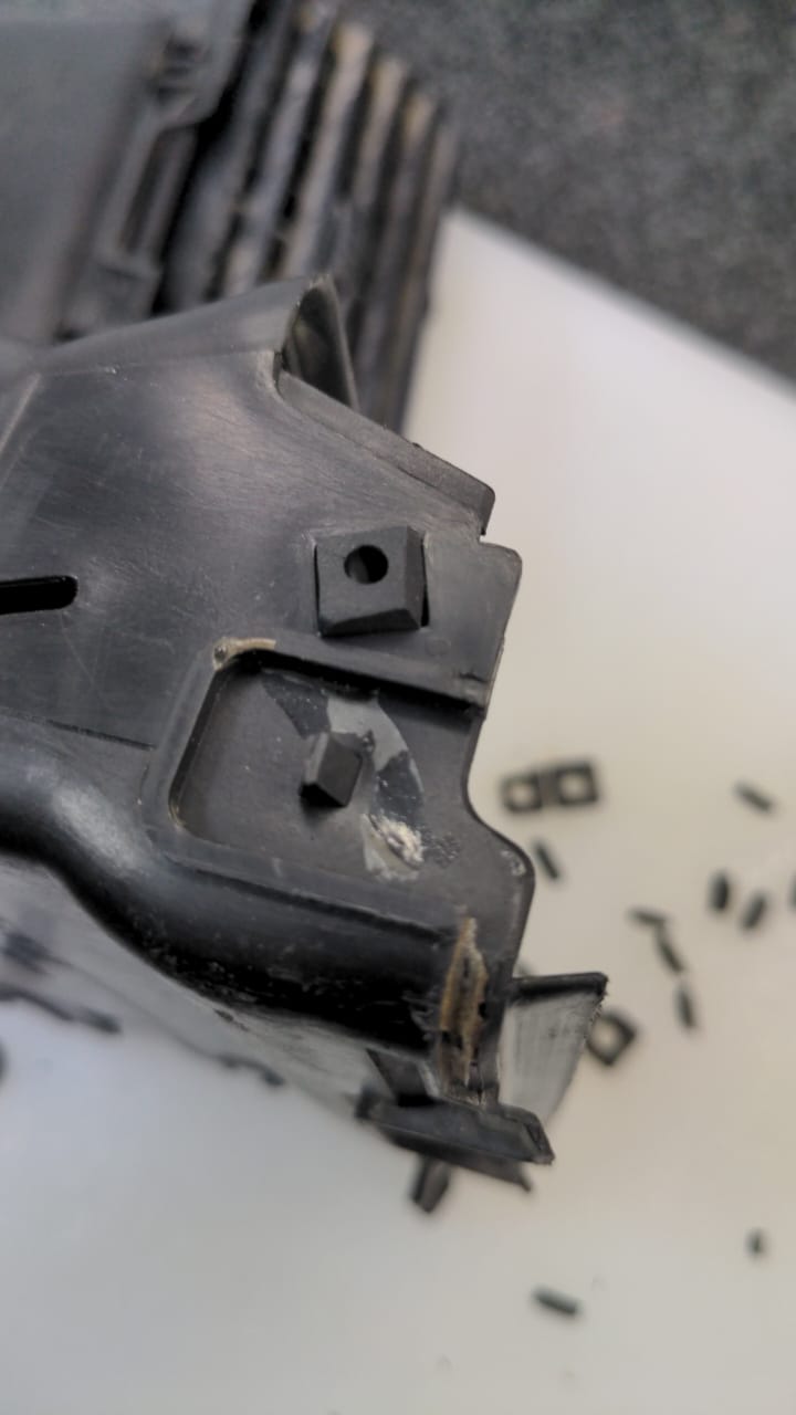

The culprit was these little black bearing points:
They were rubber at one point, but 25 years in the Middle East heat turned them into useless and brittle and incapable of arresting the register.
My solution was to start with common rubber grommets and carve them into something with approximately the same function.
Yes, I know this is pretty sloppy but I was trying to see if the idea works, and it seems to work pretty well:

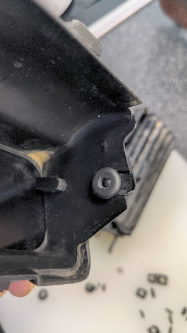

Here is what the little buggers look like installed
