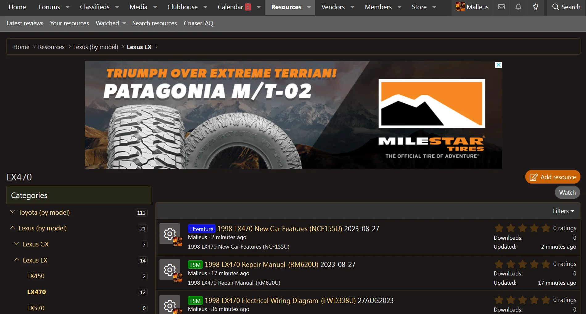

It's in the Resources section. I put a couple of additional docs in there for you. The EWD and New Car Features are nice to have. The Collision Repair Manual (CR02X) in that same area is valid for all 100/LX470 models.
Be aware the FSM is very large (2,244 pages, 20MB). Take a minute to look at the bookmarked sections; there is very useful information in there.
There is also a Wiring Harness Repair Manual, in the 80 series section that you can use for your truck.
LMK if you have trouble downloading the FSM; I can break it up for you. I didn't have the time to fully bookmark the FSM, but I have the bookmarks in a set that I can upload into an update, if you think that would be useful. The bookmarks aren't for every section of the manual, just for the major sections (engine, transmission, etc.) but it's a really big file and splitting the whole thing up into chapters was helpful for me.

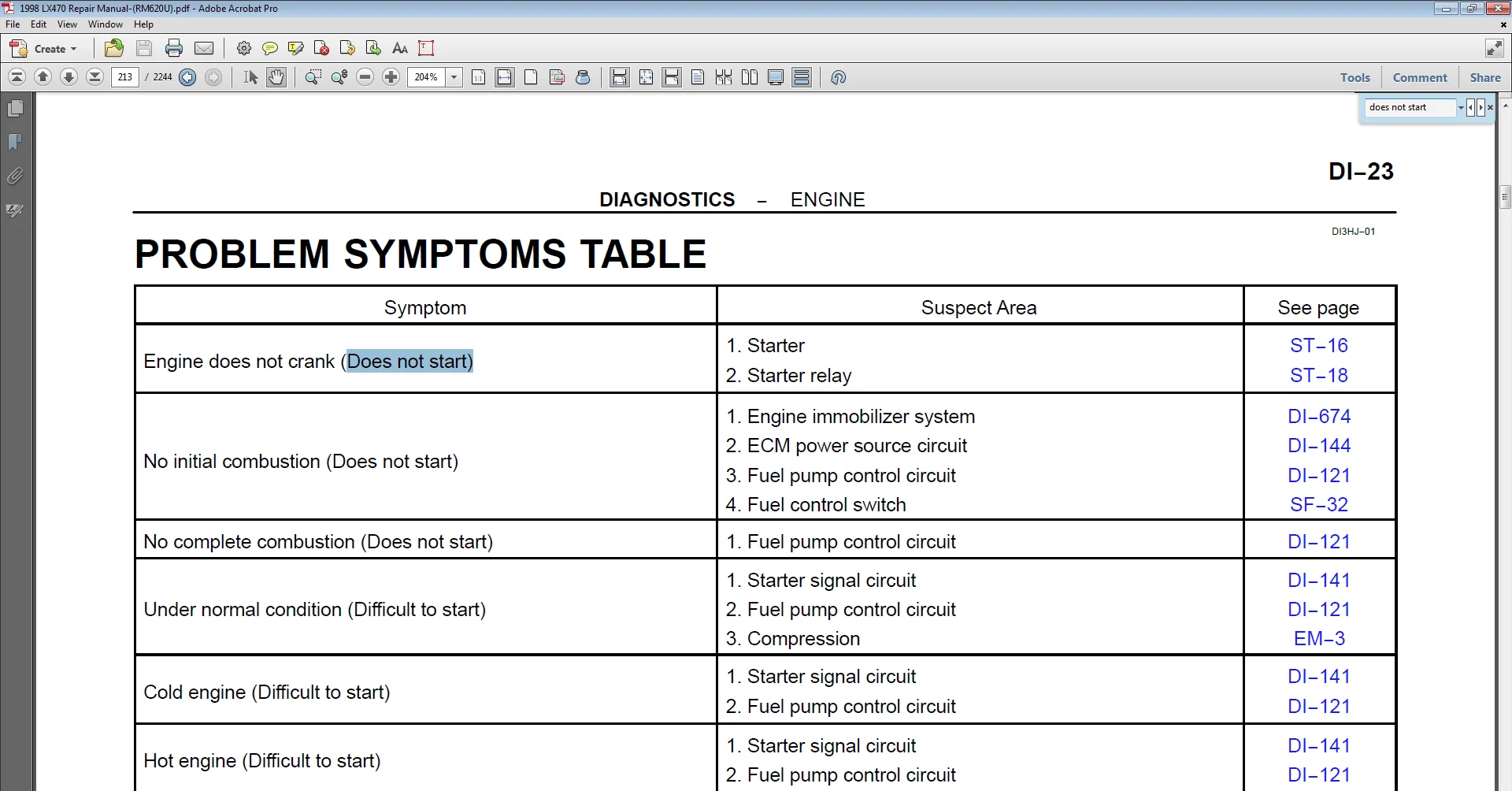

The best place to start is in the Diagnostics section (DI-1 through DI-829) (I said it was big; and that's only the troubleshooting section). The pdf is searchable; use CTRL+F to enter a keyword or phrase and walk through the file until you find what you want. If you have a generic problem, you may or may not find it, because the DI section is very specific. However, in your case, try searching for "does not start", and you'll get this:
If you're familiar with searching pdf files, you'll be off from there. If not, every time you hit enter, you'll go to the next occurrence of your search term.
Once you find a section describing your problem, search for pages DI-xxx and read through the flowchart. The original TIS file was hyperlinked, but the pdf didn't retain that. :(
