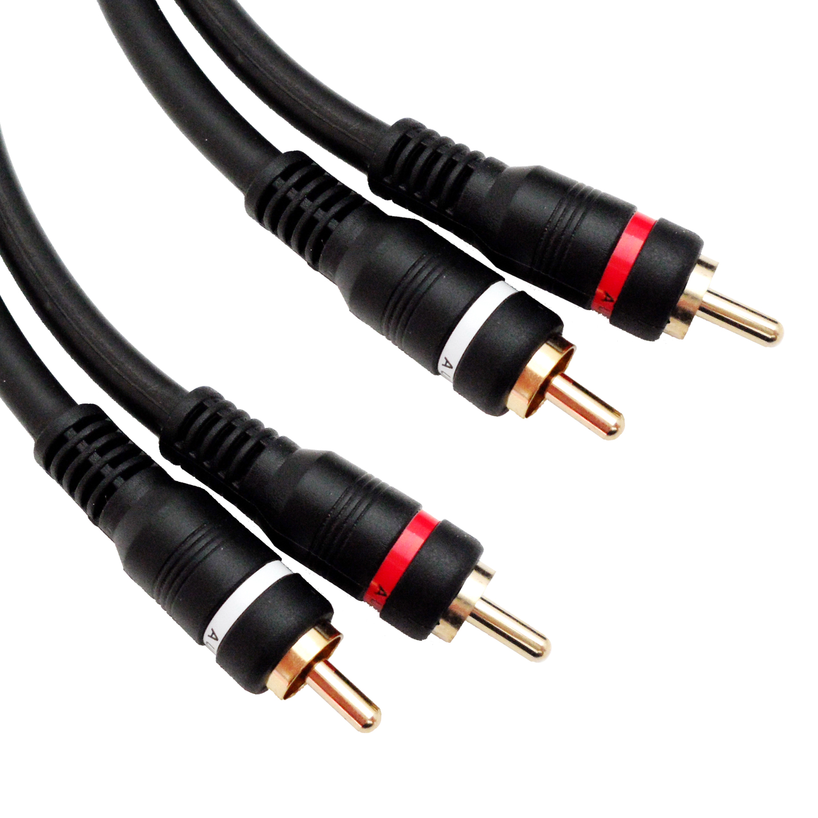

So, like these? I have a set that I can turn speaker wire with male end RCAs that might work. That way on the other end I can do +\- via bare wires or female RCAs.
Not sure where you're going with this, but you only need RCAs if you run an aftermarket 4 or 5 channel amp. Bypassing the factory amp requires 8 wires, about 6 feet in length. That will get your hi-level signals from the head unit to the passenger seat area where you can tie into the factory wiring that goes out to the speakers.
