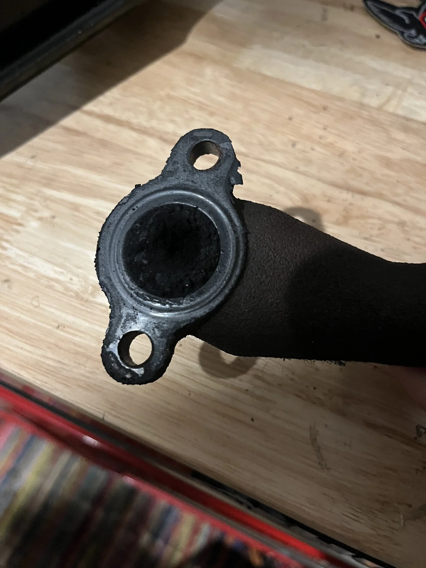

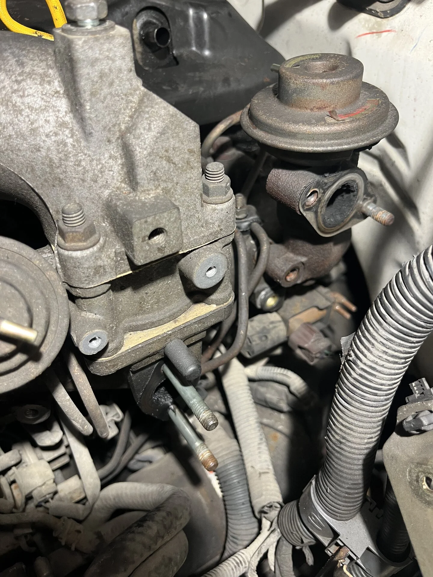

When I pulled the erg system it was full carbon. I’m working to see what blanking plates will work (3L?) or make my own.

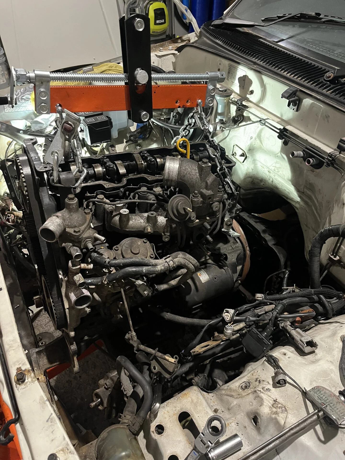

Engine hoist finally arrived. Vevor makes good diesel heaters so their engine hoist should be good, right? 😂
Despite some paint already falling off and one piece smells like cheap Chinese cigarettes 🚬 the hoist is ready to go

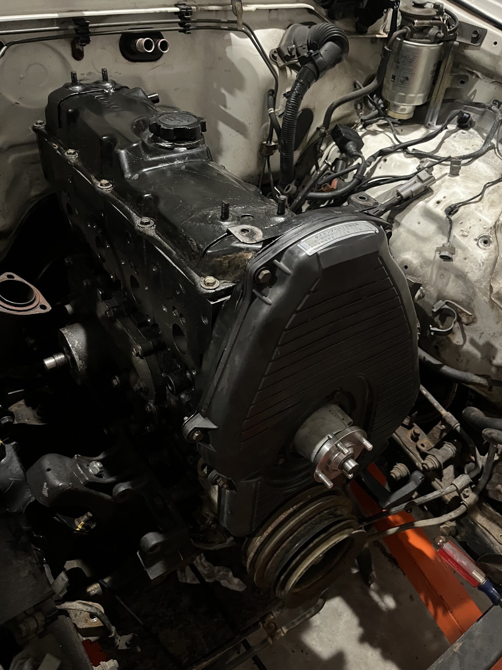

Got motor separated and out. Pretty straightforward pull. Two front facing bell housing bolts held me back at first.
Scratching my head on how to remove the injector pump without taking the whole front of the engine off.
Finally got the engine pulled and stripped and dropped off at machine shop.

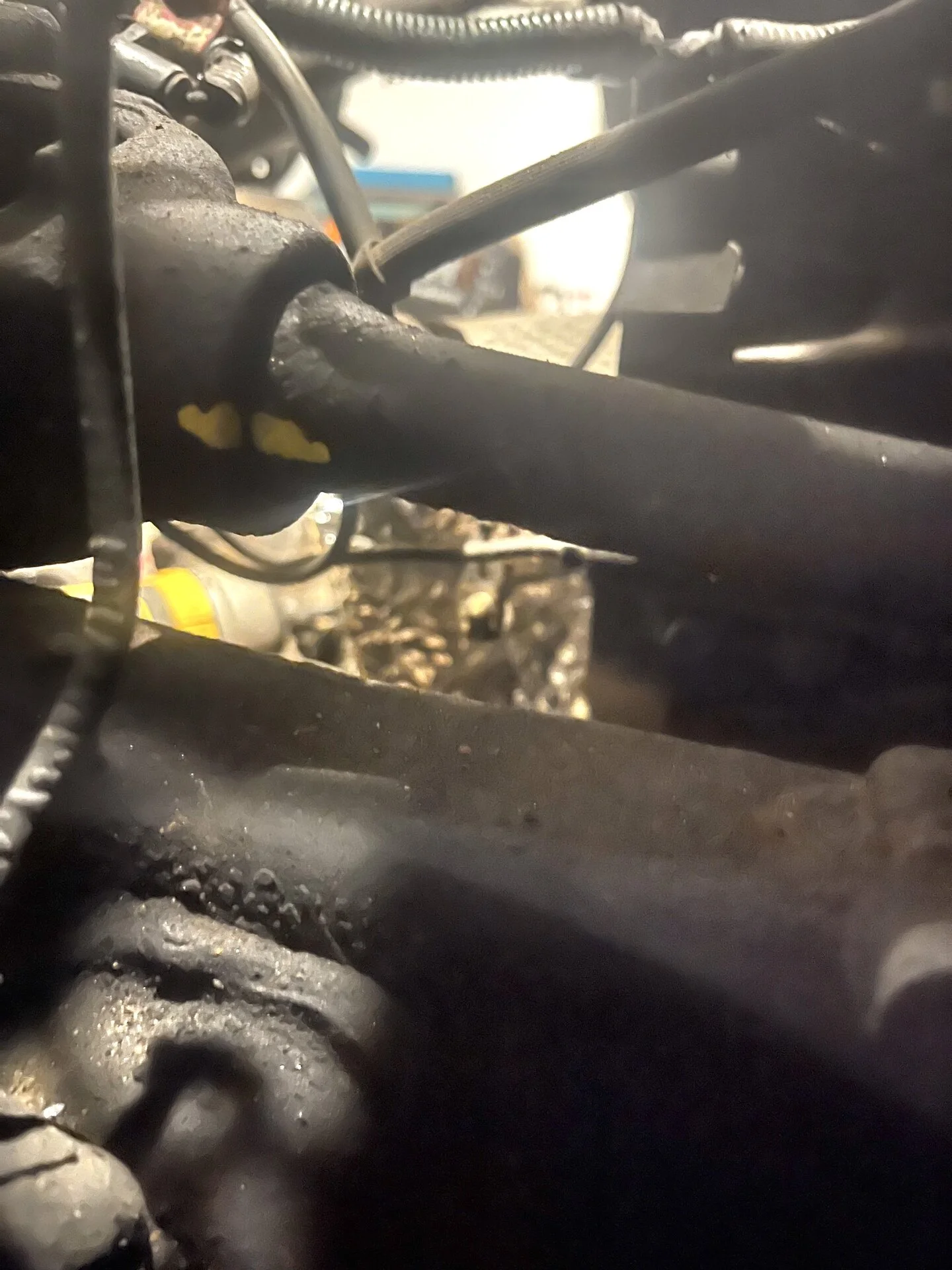

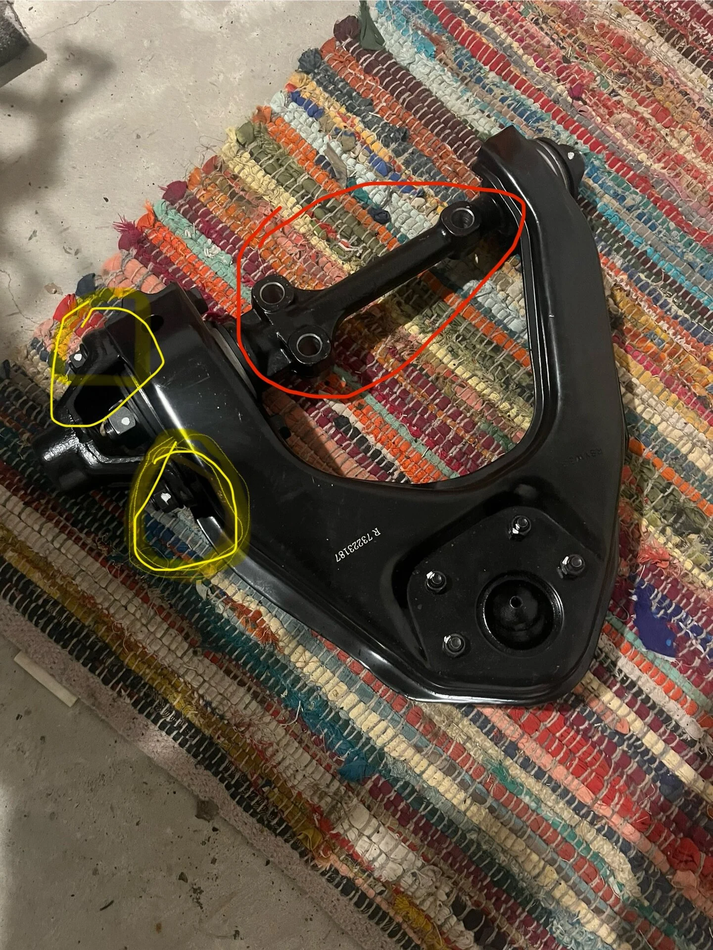

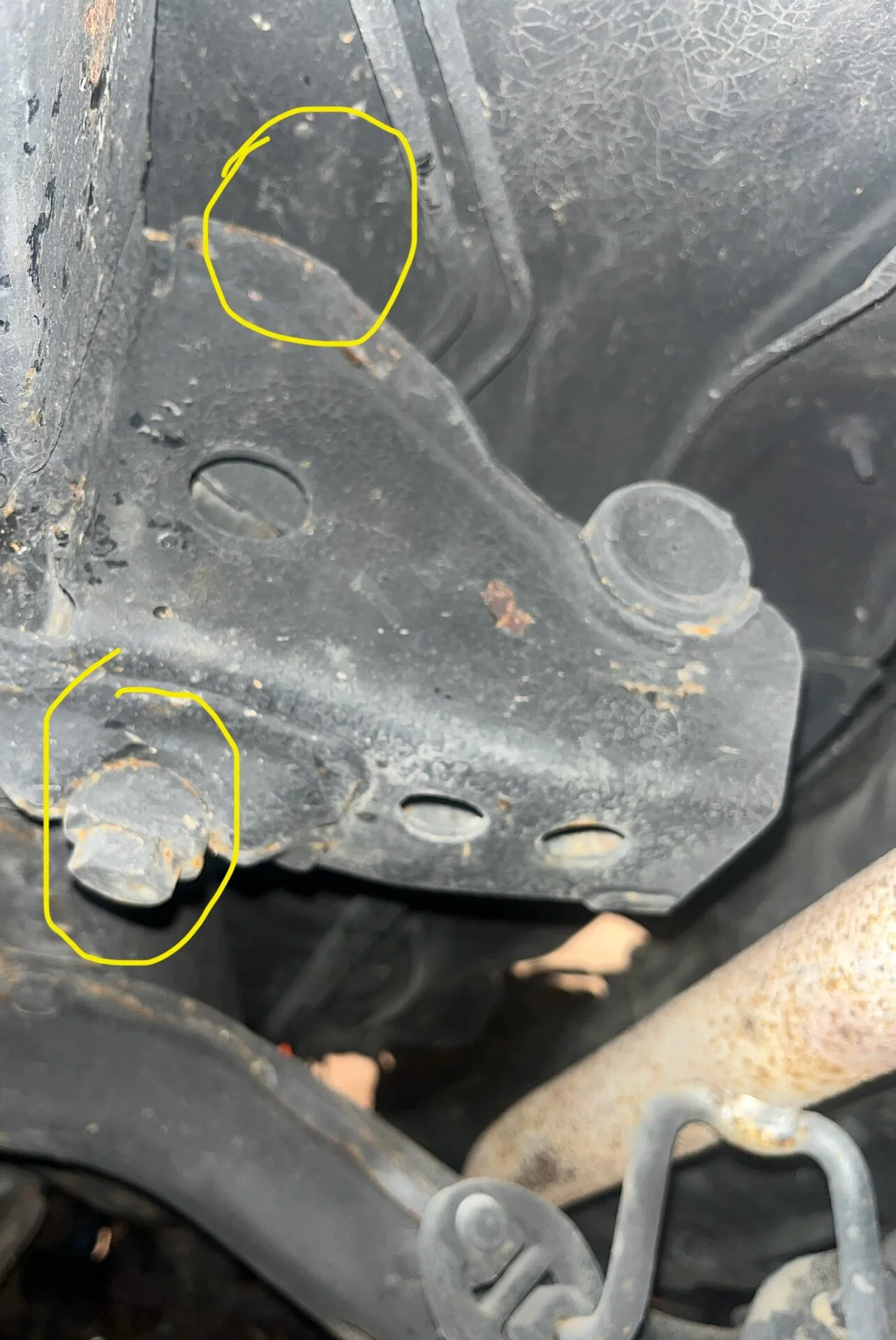

While waiting on parts. I decided to install new upper control arms, which involves removing the torsion bars as well.
Steps to removing after torsion bar and upper control arm an IFS Hilux / Toyota pickup goes as follows.
Find torsion adjuster clamp at the end pf
The torsion bar near the transfer case.
There is a 22mm nut up top and bolt head on bottom needs to be undone, located in yellow below.
Next mark the torsion bar with grease pencil
Or paint maker on the anchor point and the bar so you know how to reinstall bar. There is “master” spline so this matters.
Next undo the two 17mm nuts/bolts (circled in yellow) holding the torsion bar anchor to the upper control arm. Remove the locking castle nut holding the UCA to wheel assembly, then you can undo the three top bolts (circled in red) holding uca onto the frame.

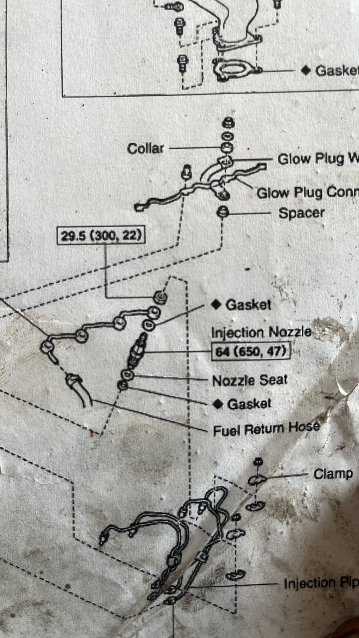

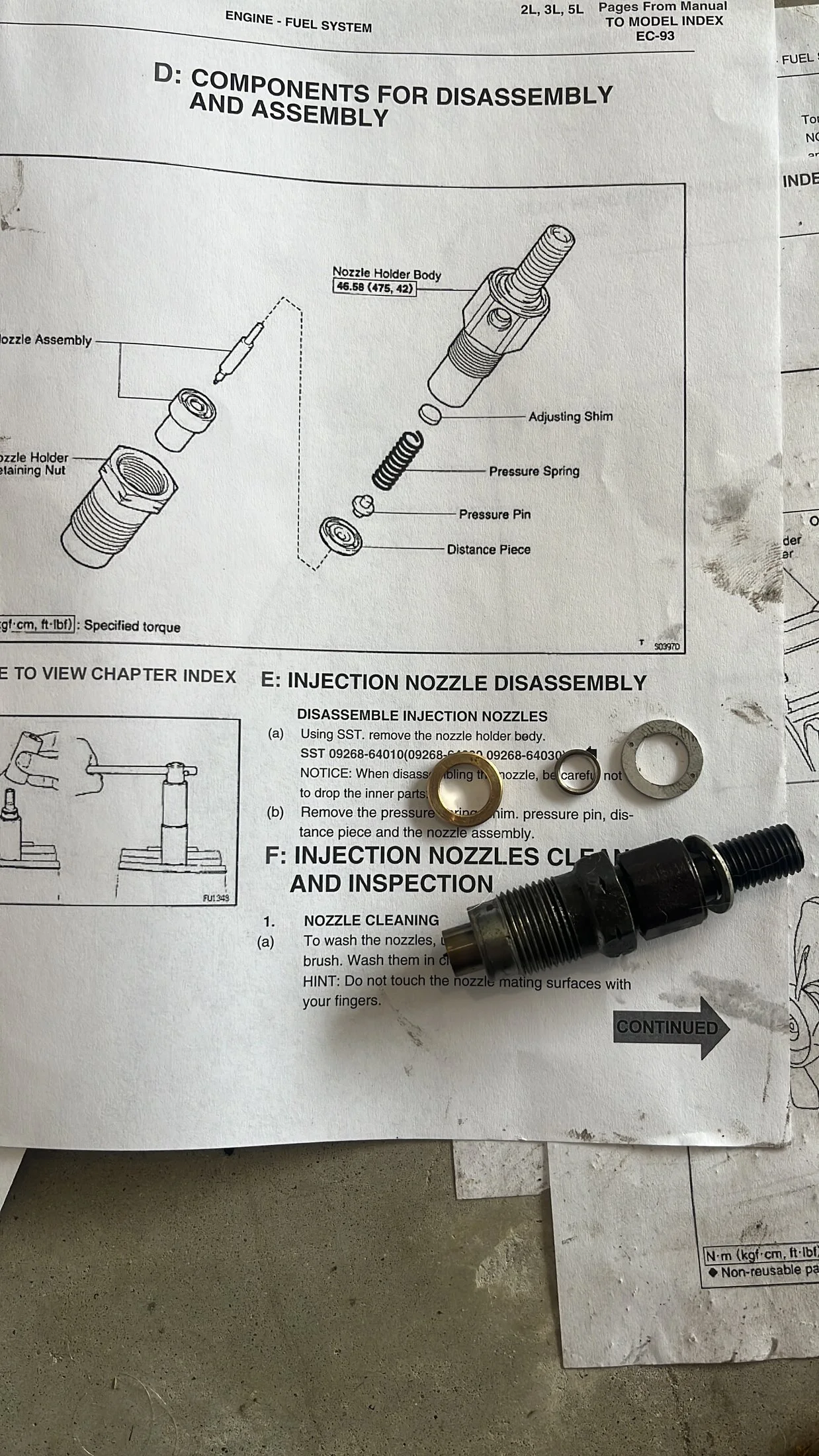

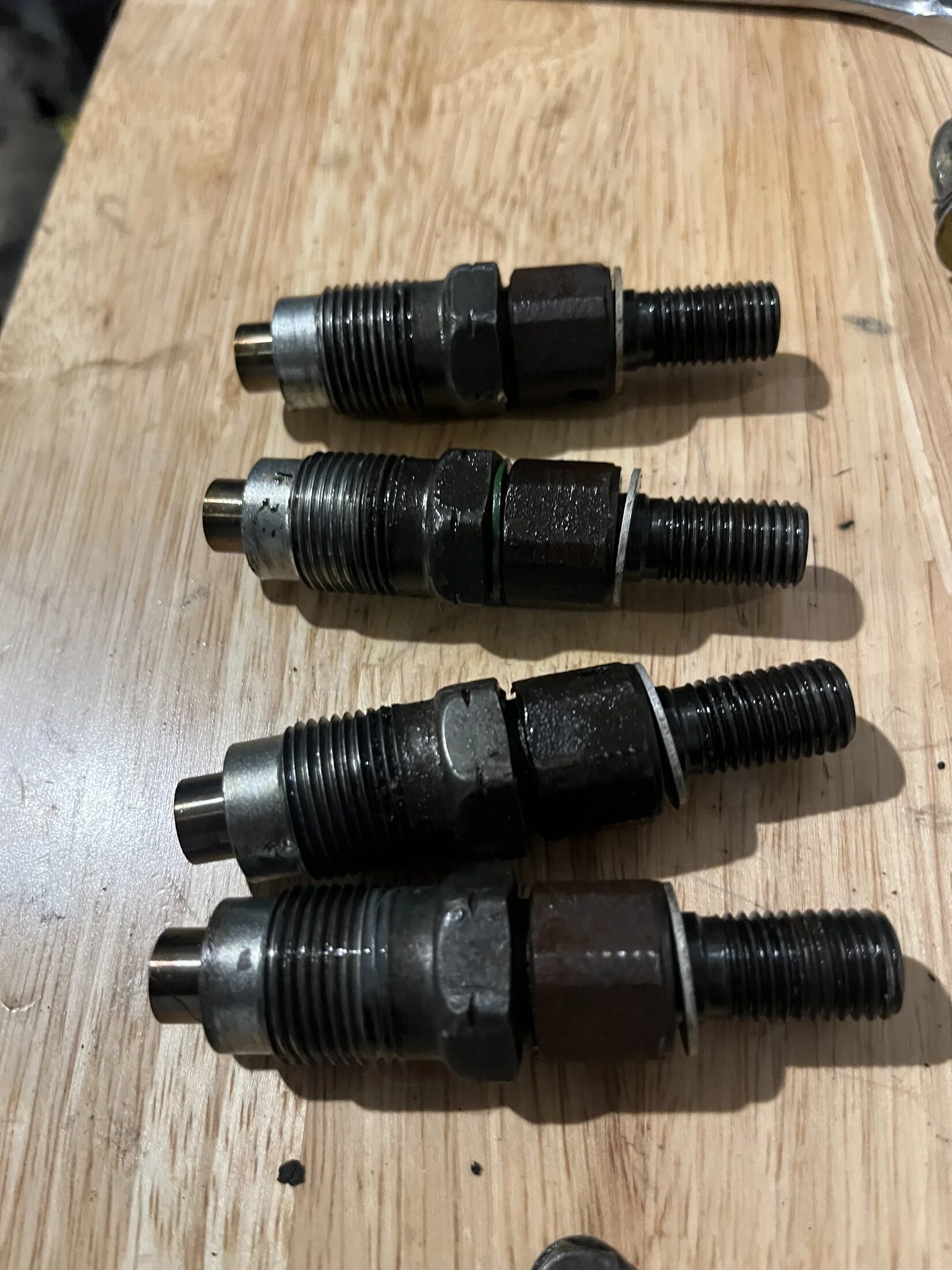

So it is important to not just go by memory and NOT install injectors in rush at 1am...
The seat, and gasket are important :bang:
Obviously engine did not start and soon realized why... pulled injectors and install them correctly. Then I bled the system with all 4 injectors fuel lines slackened. I cranked it until fuel come out of an injector and i tightened that injector. I repeated this 4 times and the injectors bled from front to back.
I also noticed the glow plug fusible 80A link was toast. With a 10mm I uninstalled the fuse box and on each side of the fusebox is an access point to put a 10mm and a 8mm socket in the fusebox to remove the ol fusible link.
The brass washer is the seat that the injector goes one an the little tiny ring goes at the bottom of the injector hole. the larger silver sits on top of the injector between it and the fuel rail.
I also got some fuel rated o-rings (not shown) and installed those on the injectors, as the old green ones were so brittle a gentle breeze could of broke them
