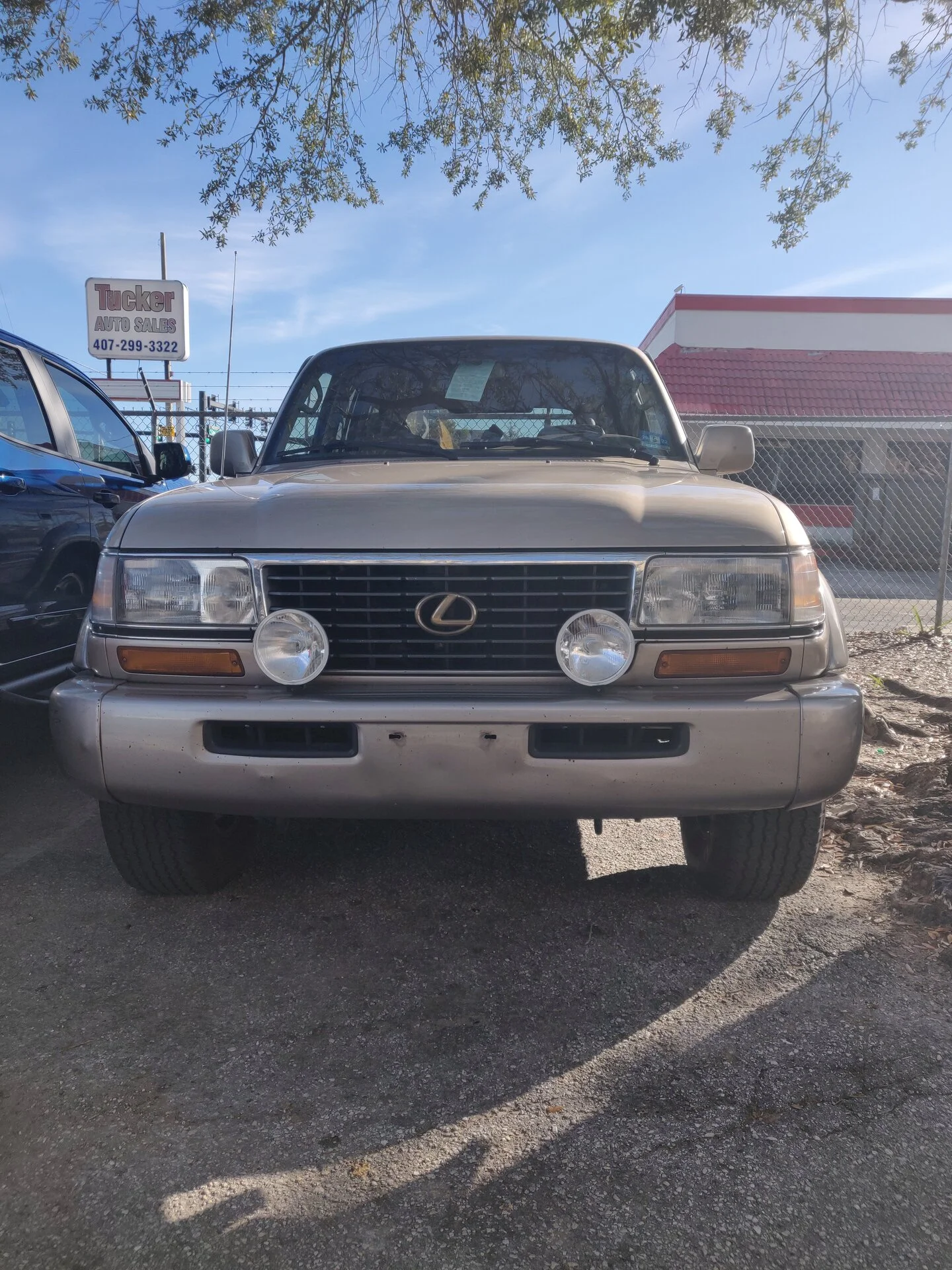

I purchased the vehicle from its only owner in late 2020. I reviewed the maintenance record and it suggested more maintenance needed to be performed. The vehicle was stock, other than lights above the front bumper. Most notably, it suffered from some surface rust as it was a vehicle from New Jersey that was used to drive up to upstate New York. Otherwise, everything worked as expected, including a D light that functions to this day!.

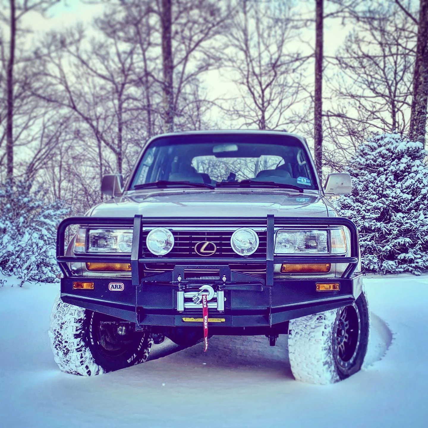

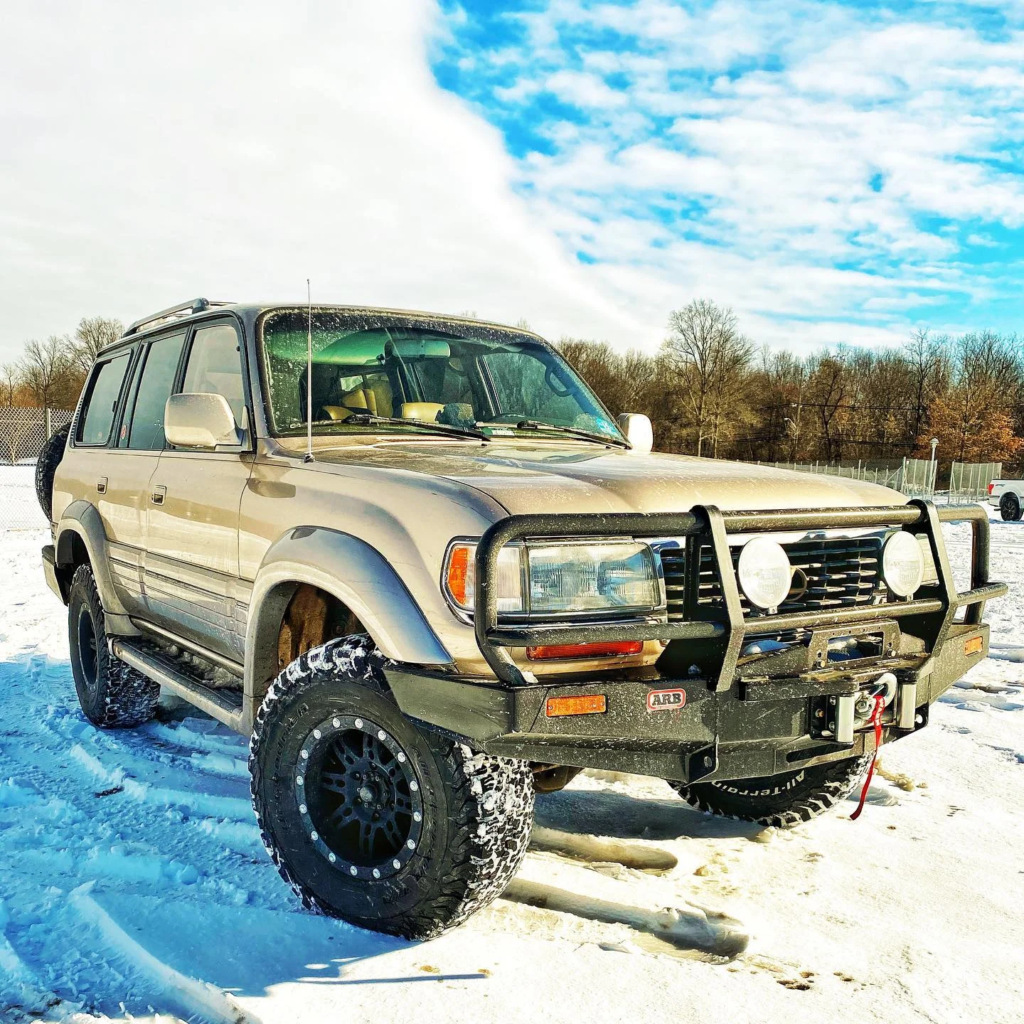

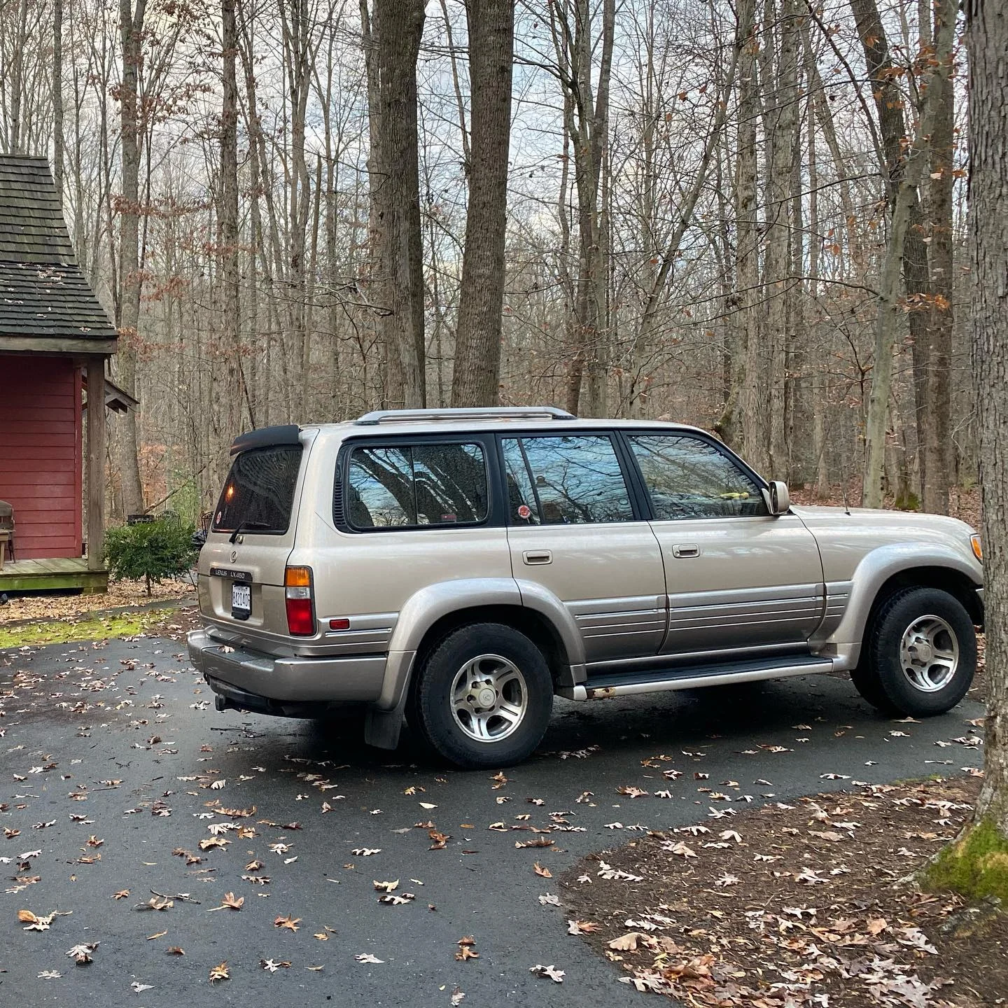

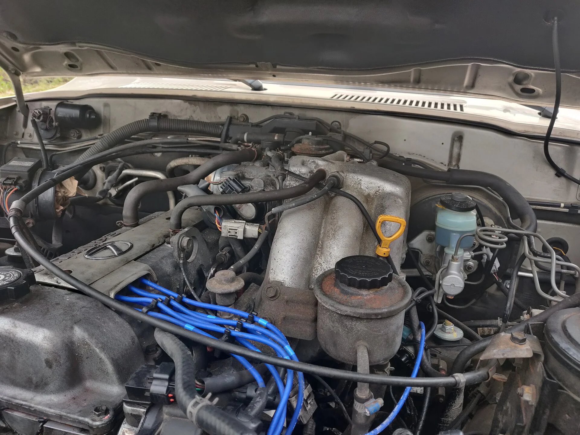

I immediately drove the truck from New Jersey down to Florida and it drove perfectly. Down in Florida, I had two shops work on the truck. First, one shop added ARB front and rear bumpers. The tires were changed 285/75/16 KO2s. The wheels were original and needed to go. In their place are Pro Comp Stryker wheels. Supporting all that is a 2.5in Old Man Emu suspension kit. In addition, a WARN winch was added. The other shop replaced the valve cover gasket, spark plug wires, air intake, radiator hoses, and added a Yellow Top battery.

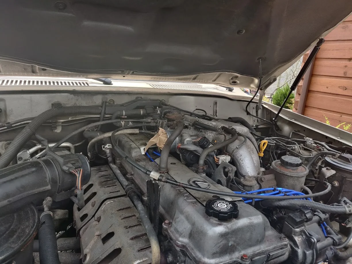

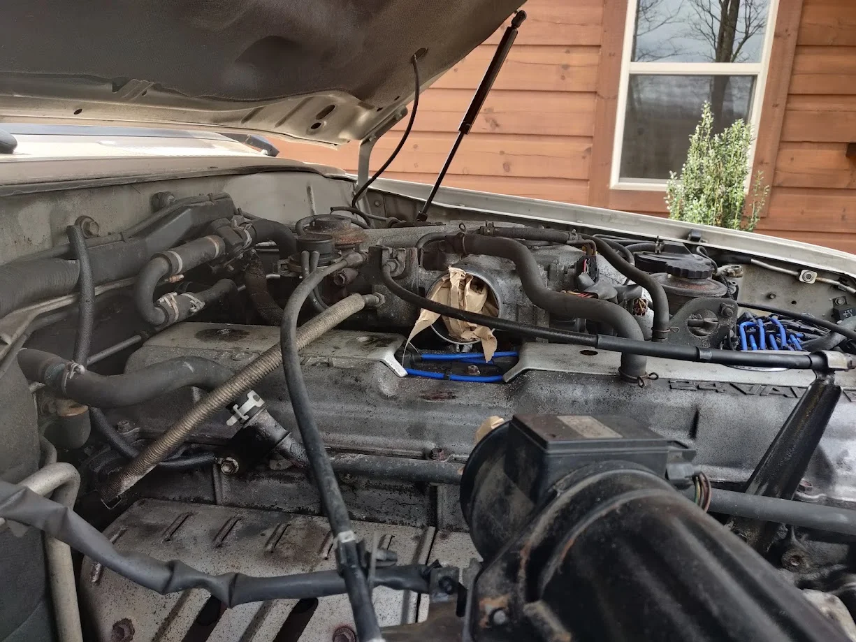

I was preparing to replace the rock sliders until one day, while driving up the steep mountain grades up 4,000 feet, I smelled a sweet odor entering the cabin. Then, steam began appearing from under the hood. I pulled the truck to the side. The radiator, still the original, had cracked and the pressure spewed coolant on the engine.

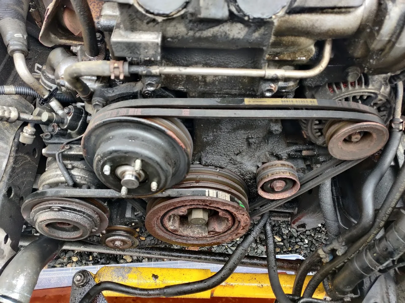

The truck made it to the top of the mountain but my immediate thought was a blown head gasket. I started by removing the front grill and taking out the old radiator and the fan clutch. I didn't like what I saw. In addition to the symptoms of a blown head gasket, the engine was also caked in grease.
It was time to start pulling the engine apart.
