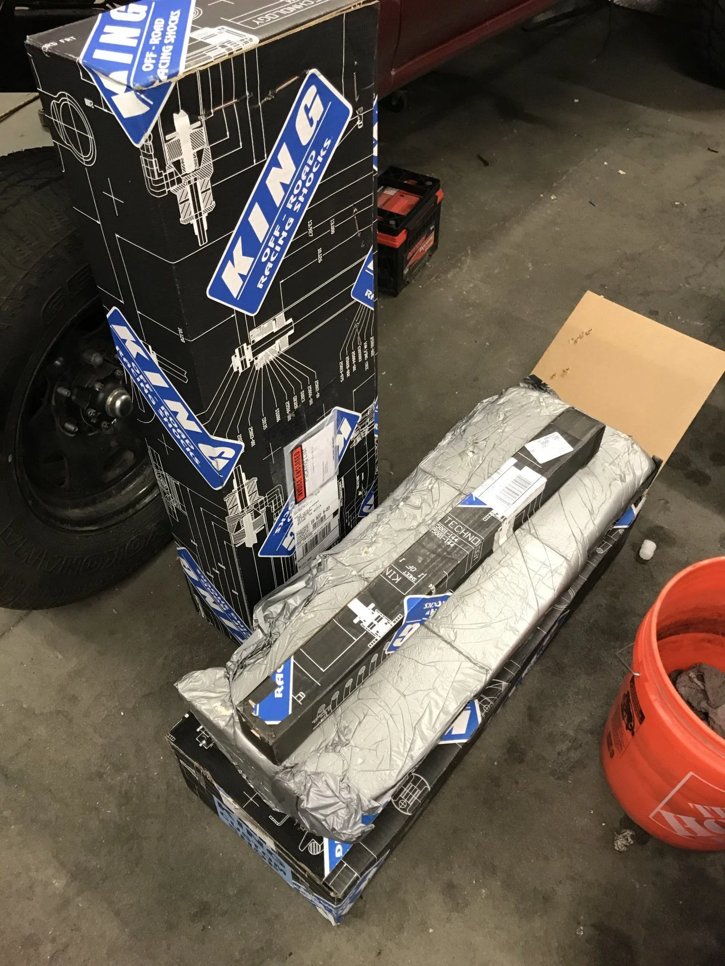

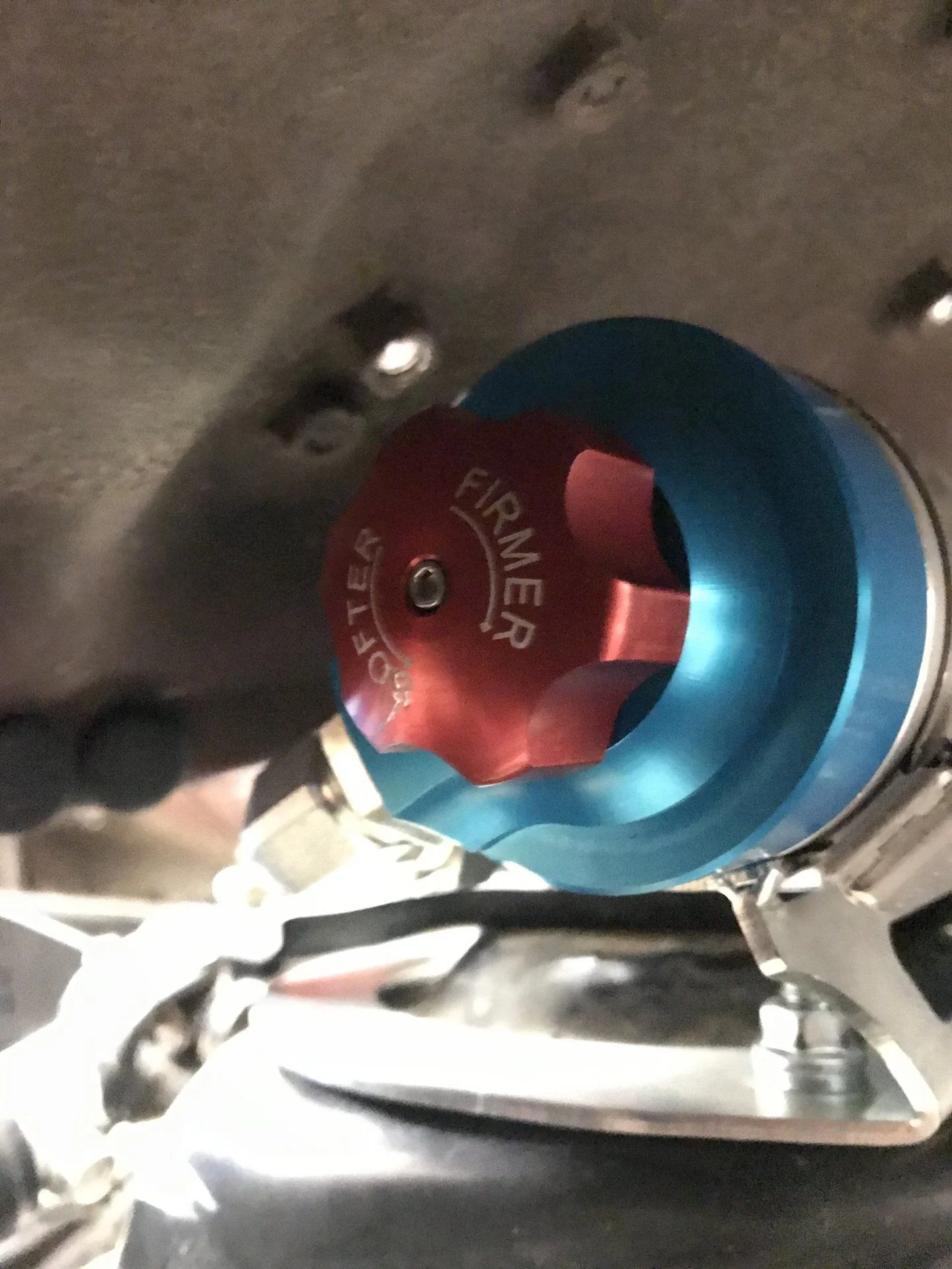

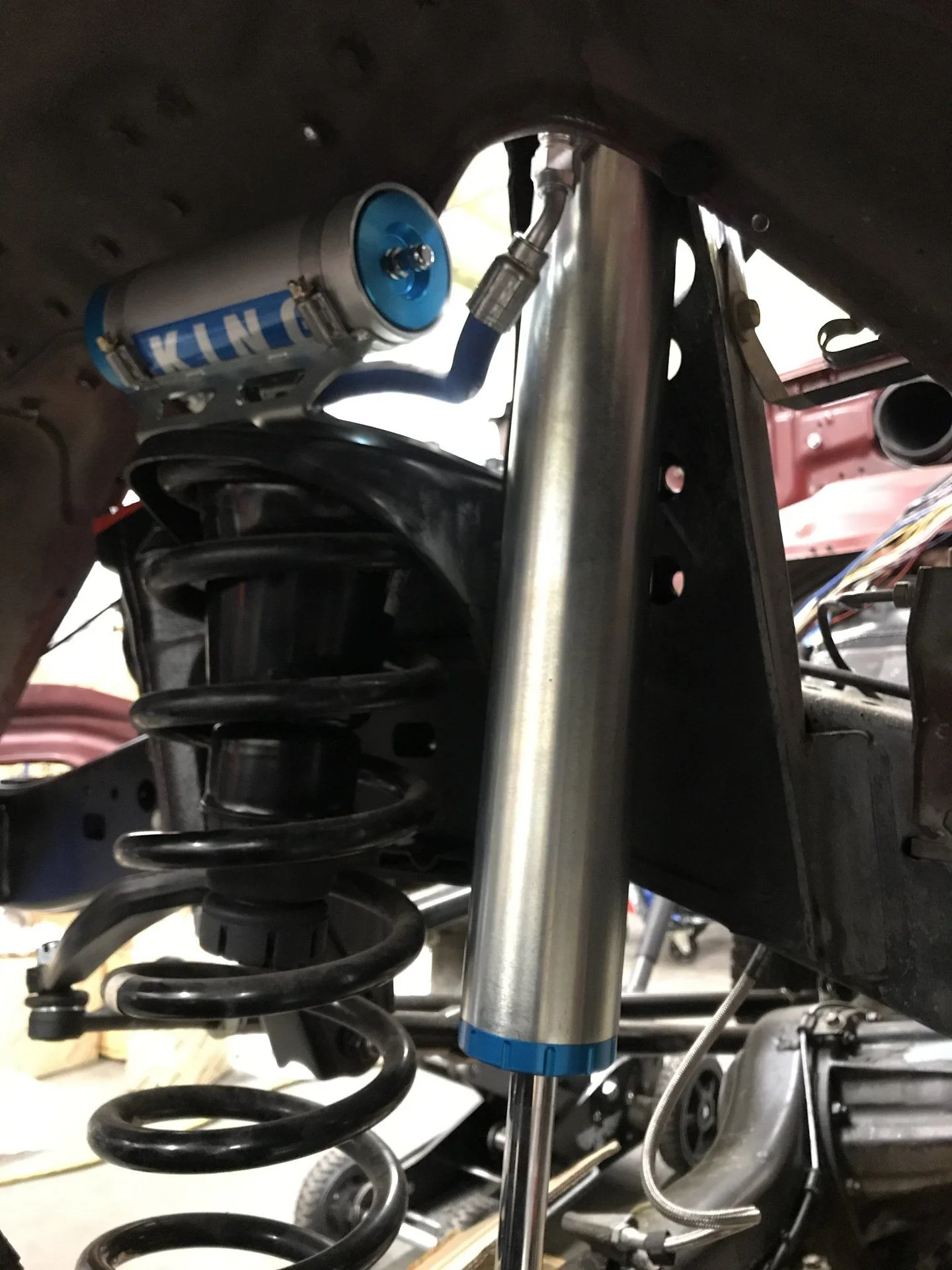

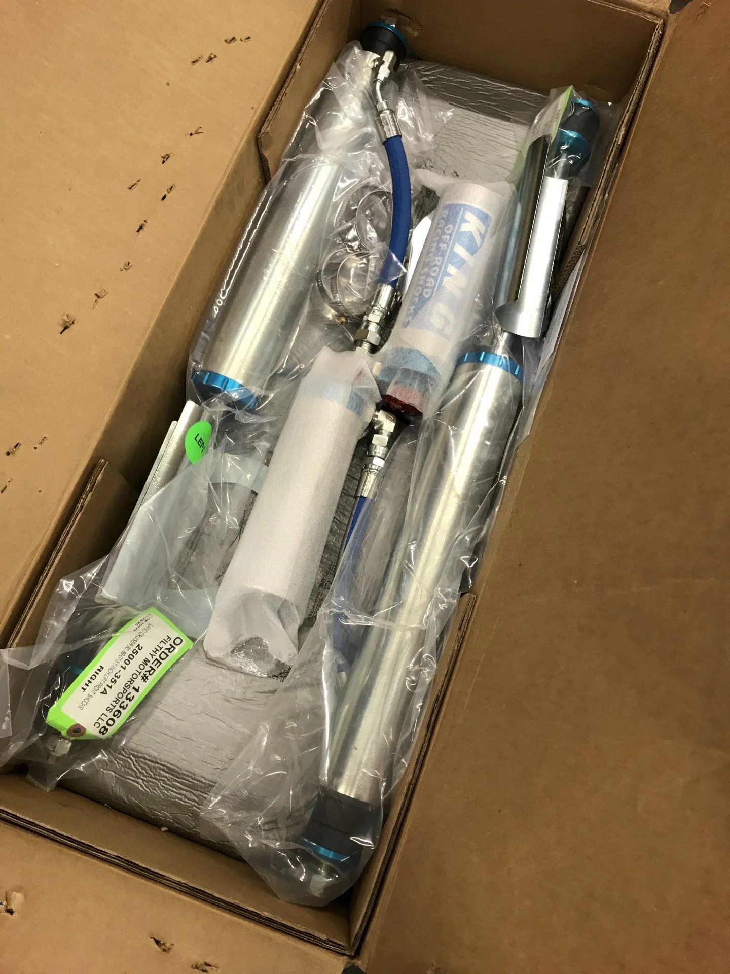

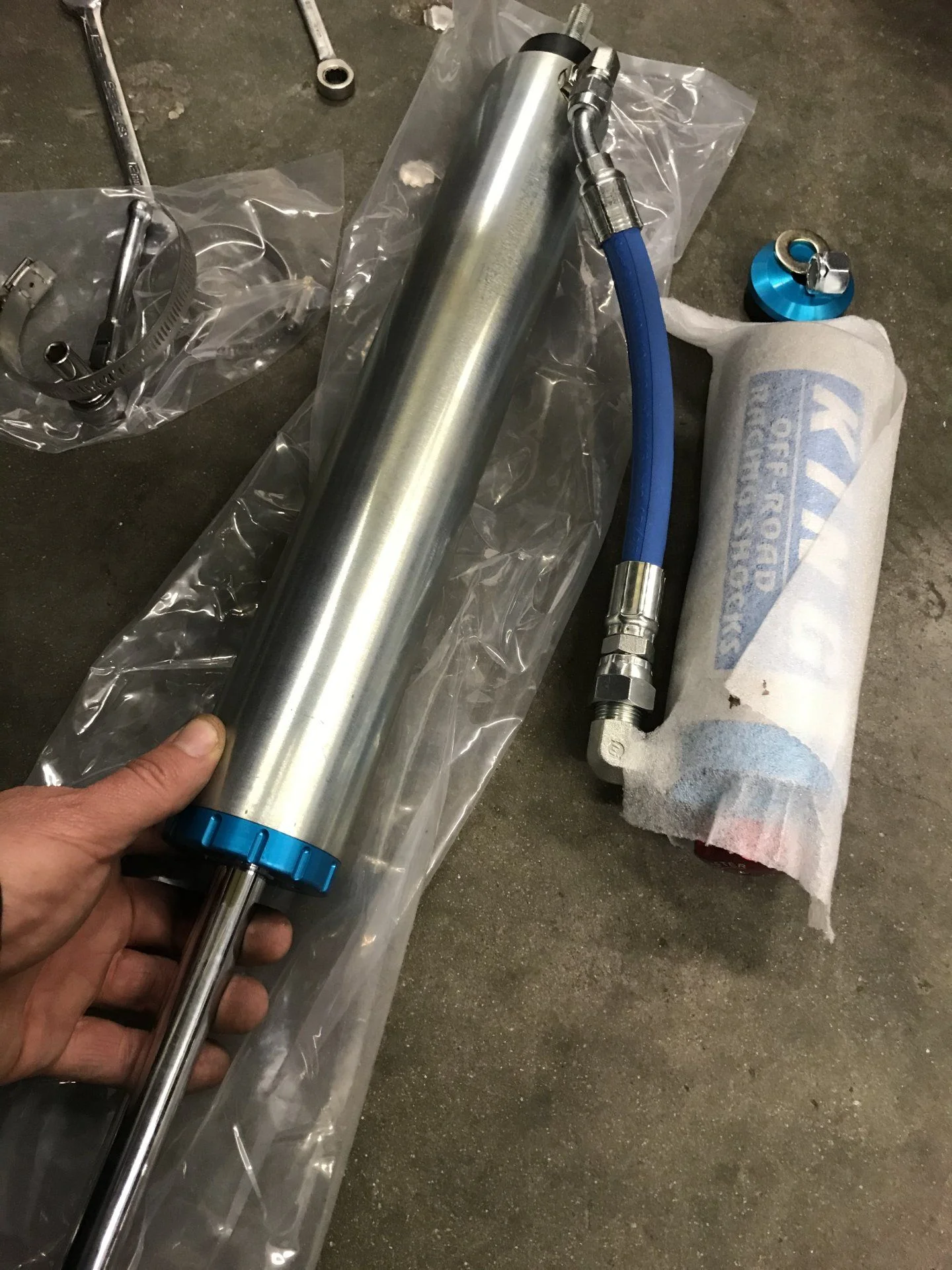

Damn. Those kings are so nice. Can I ask, are they custom made or off the shelf? And if they are custom made, how long did it take for them to come from the time of order? I'd love to know how they work out and ride ect...
Custom made. Took two months I think.
Call Filthy Motorsports, they rock for setting you up with Kings.

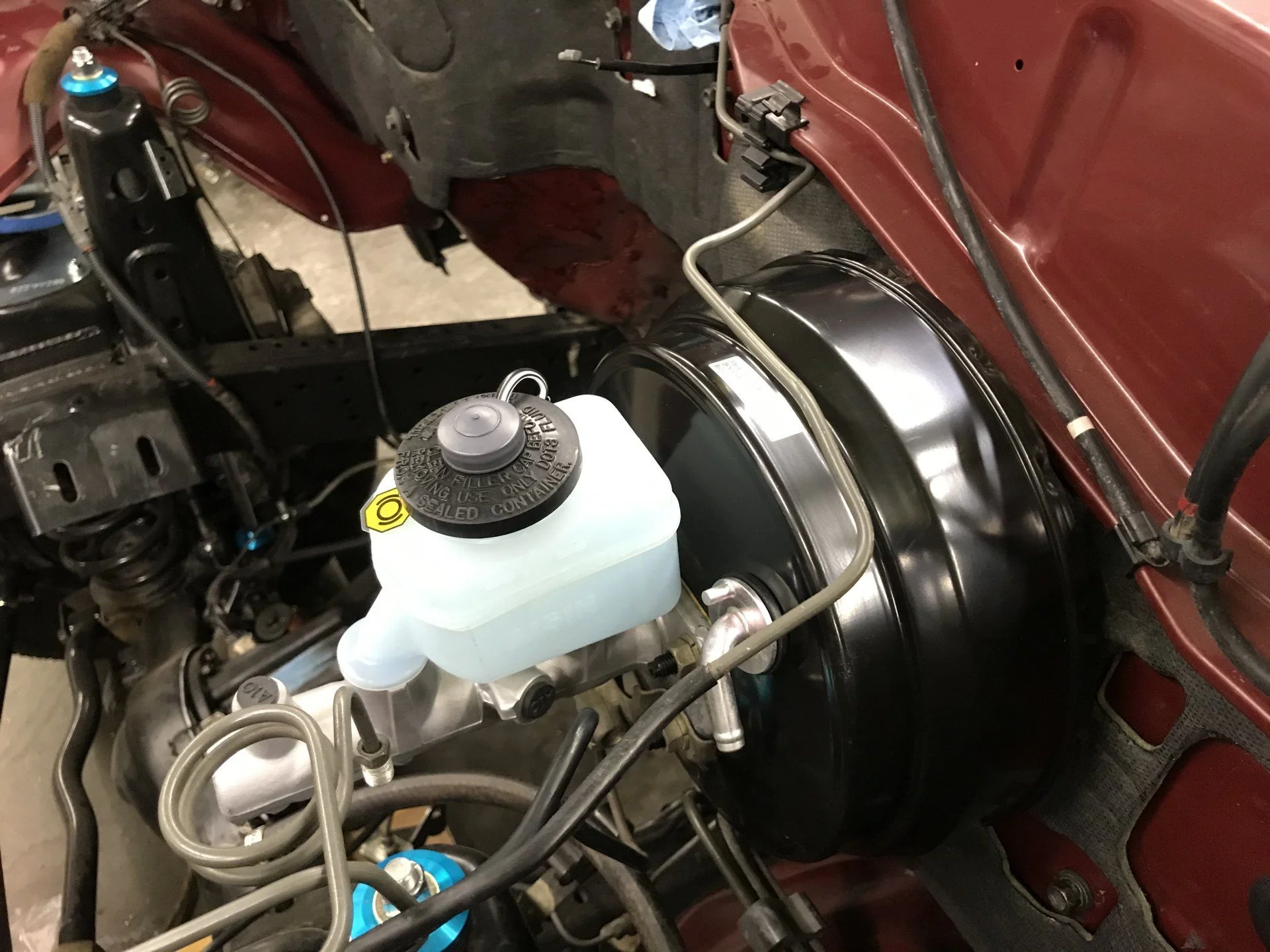

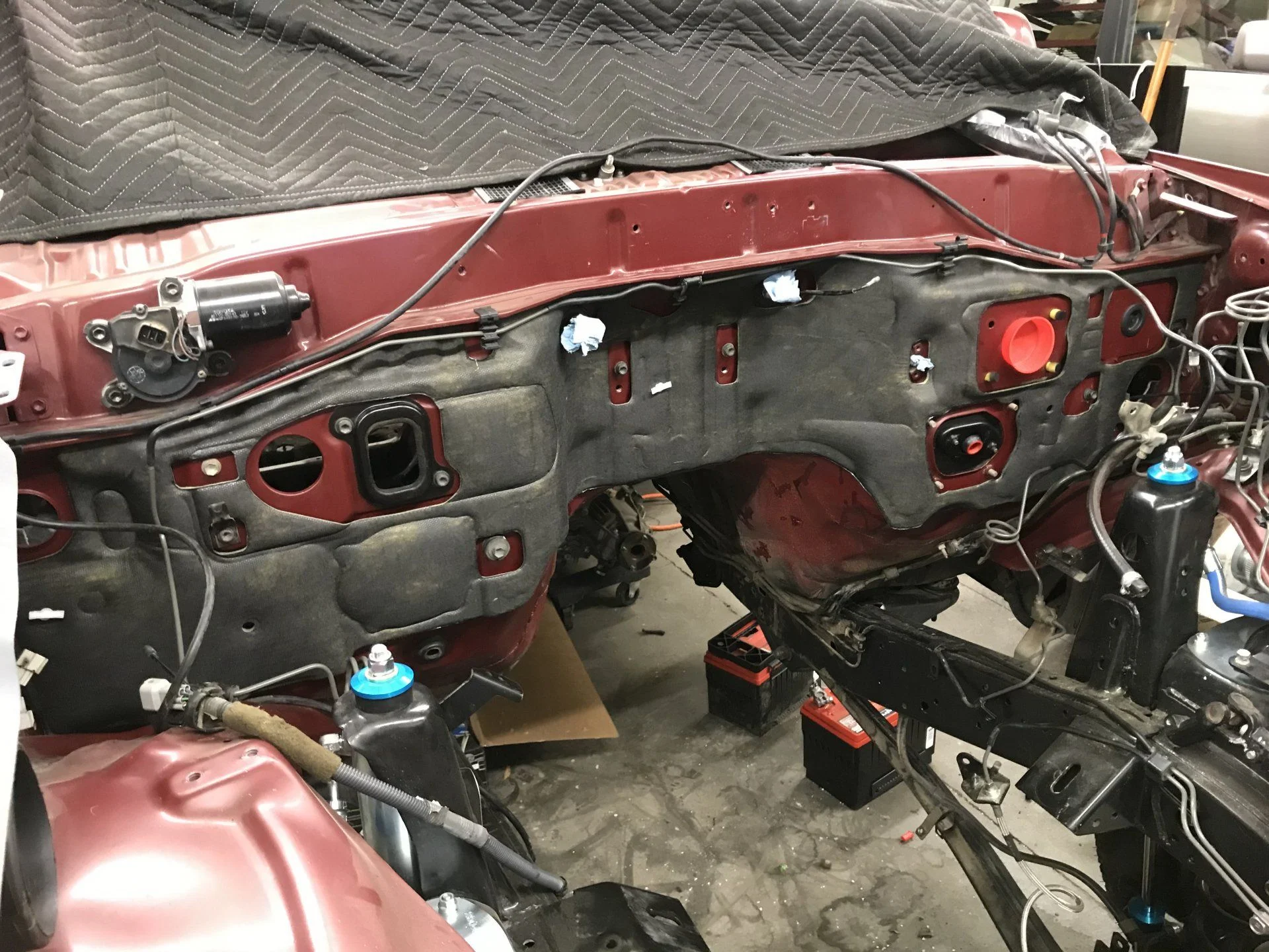

We got some color match touch up paint made since you can’t get OEM touch up anymore for a 3H4. We touched up some scratches and gouges in the firewall before installing this new insulator.

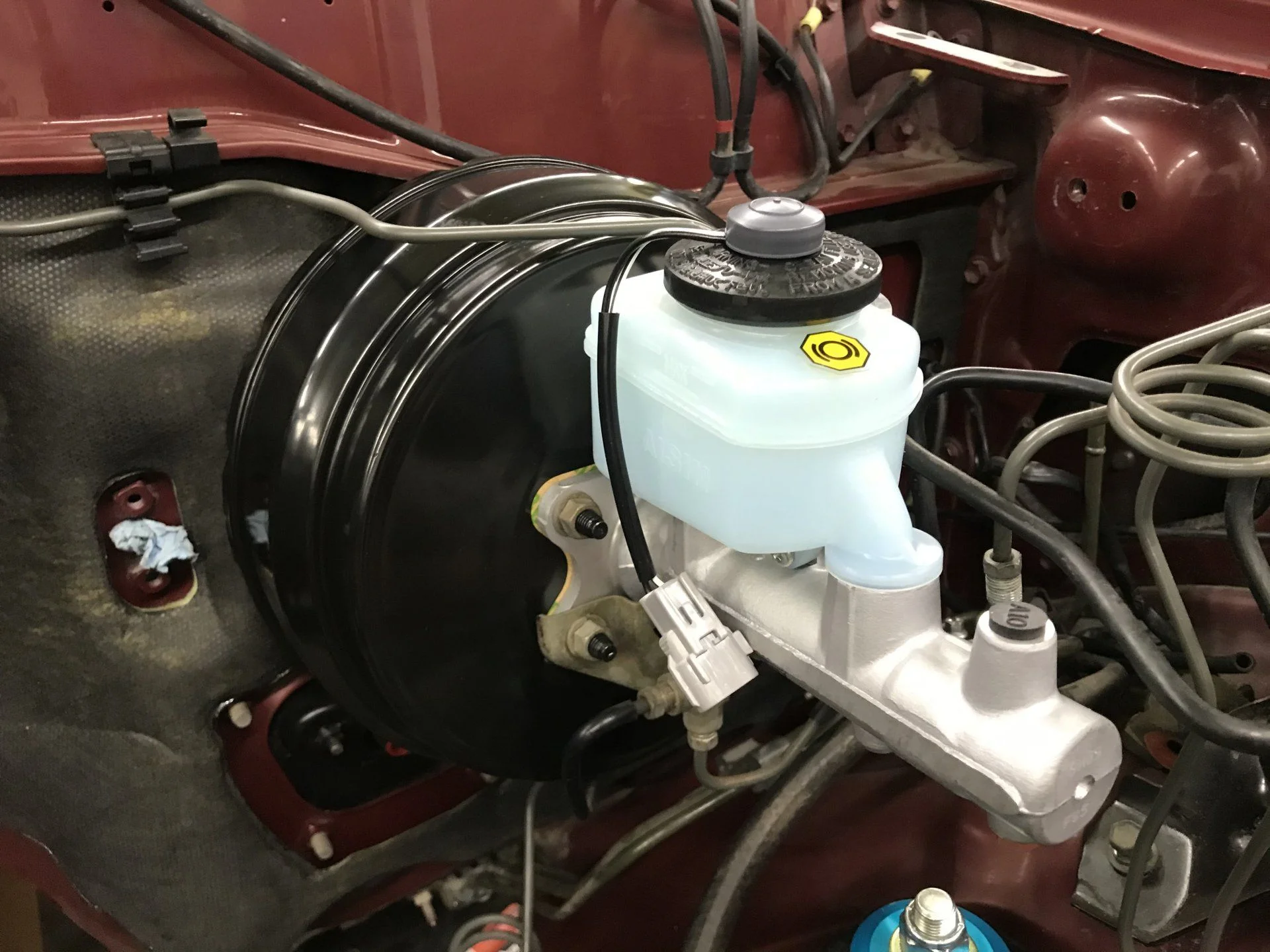

We then did a quickie (temp-place holder) install on this new master and booster. I say quickie because, well you will see next post.

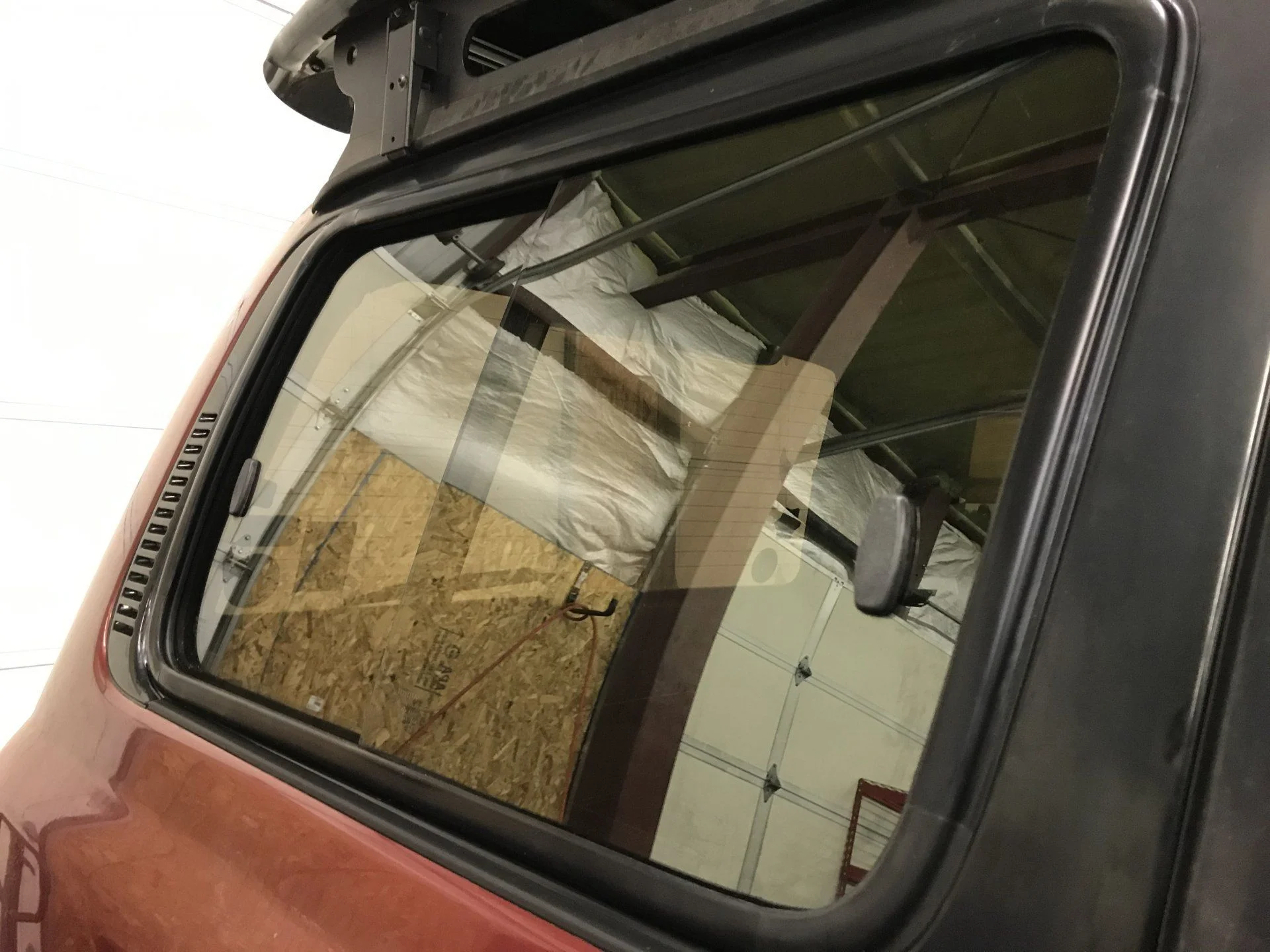

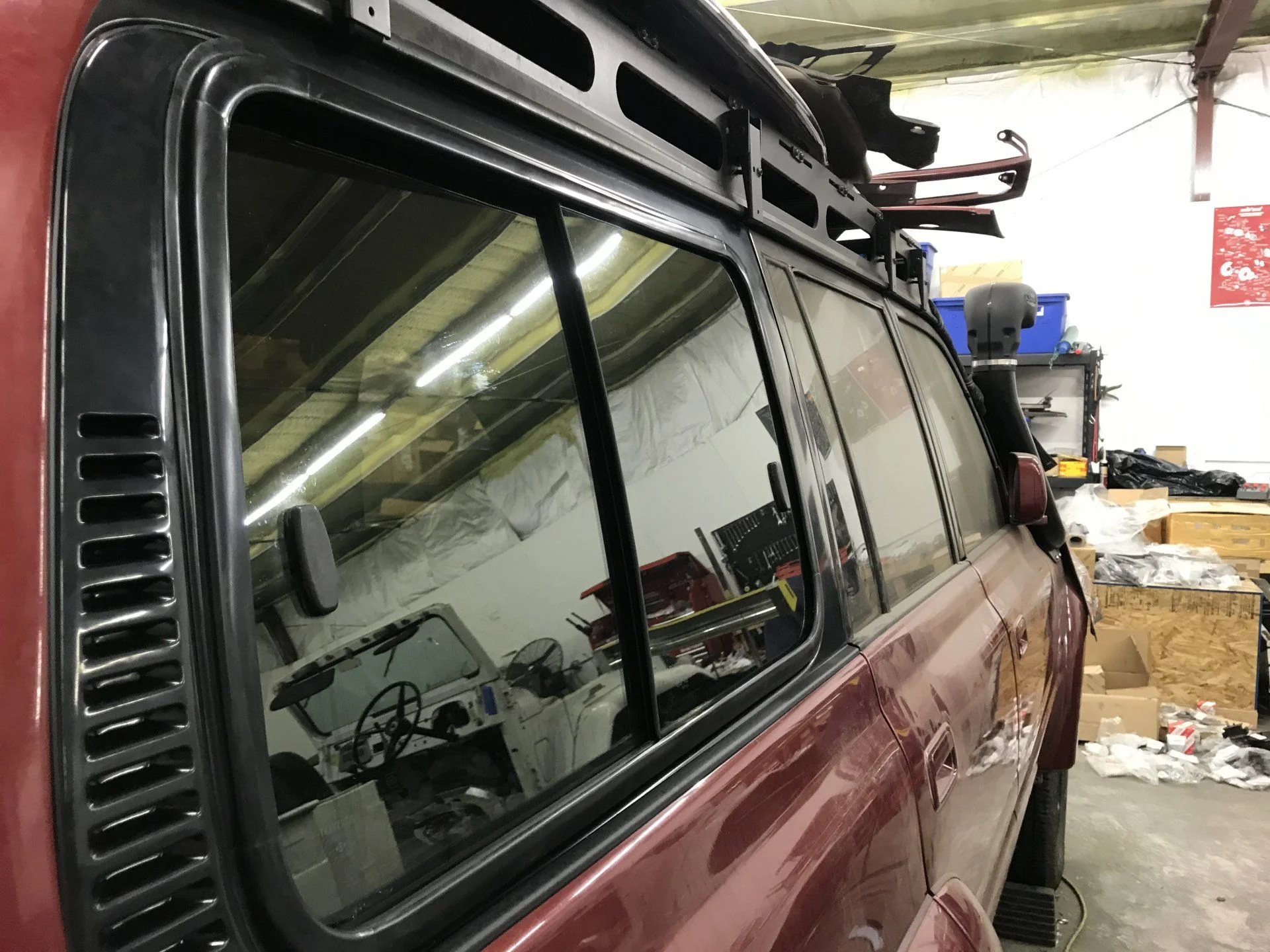

It’s been a couple weeks but we did a full refresh on the rear sliders, only parts not new here is the glass and aluminum frame.

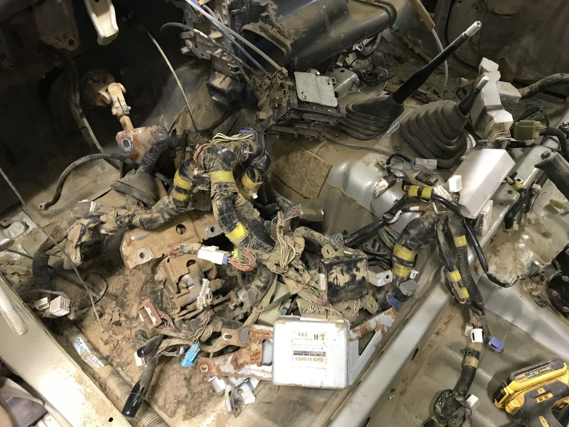

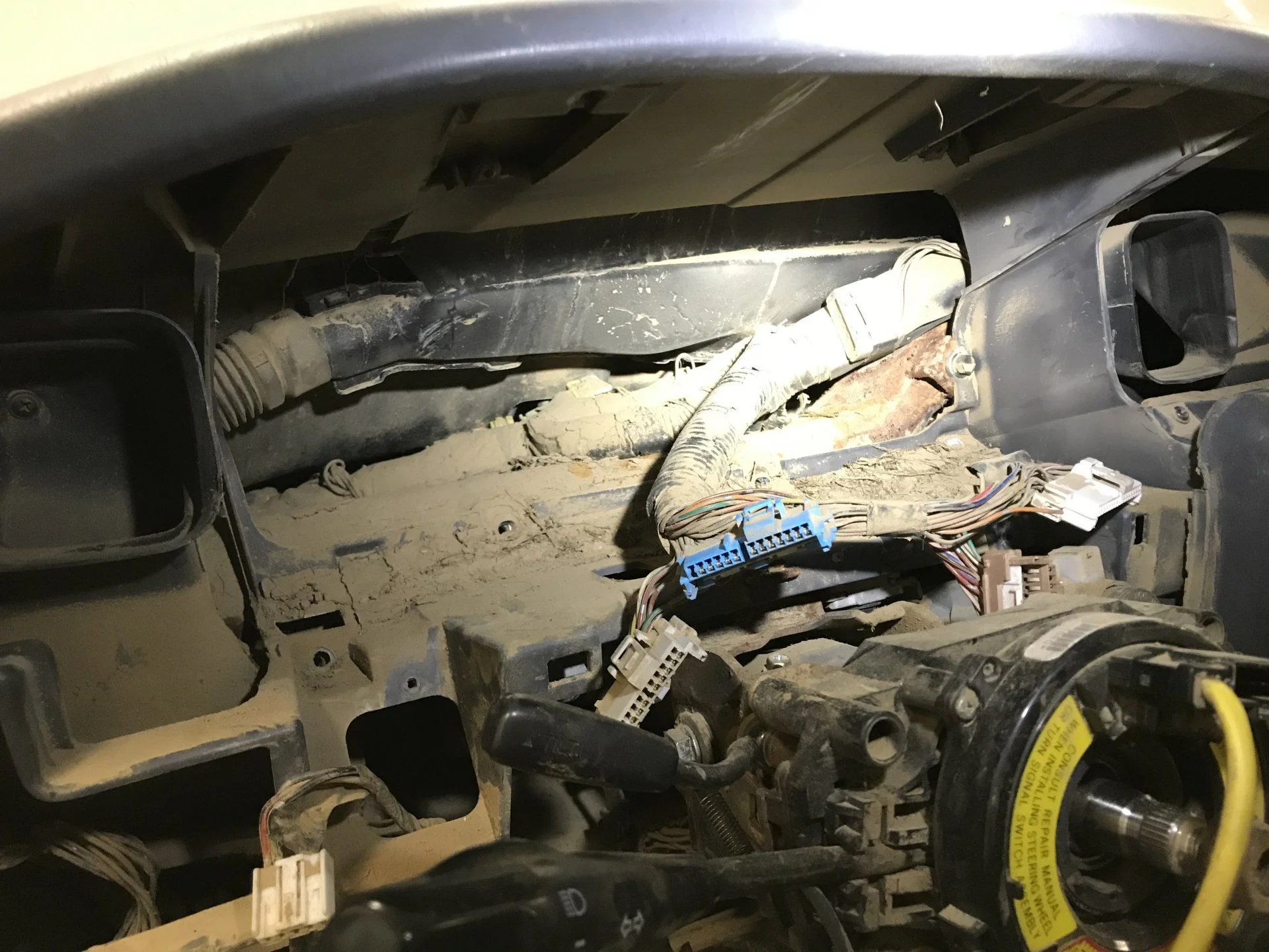

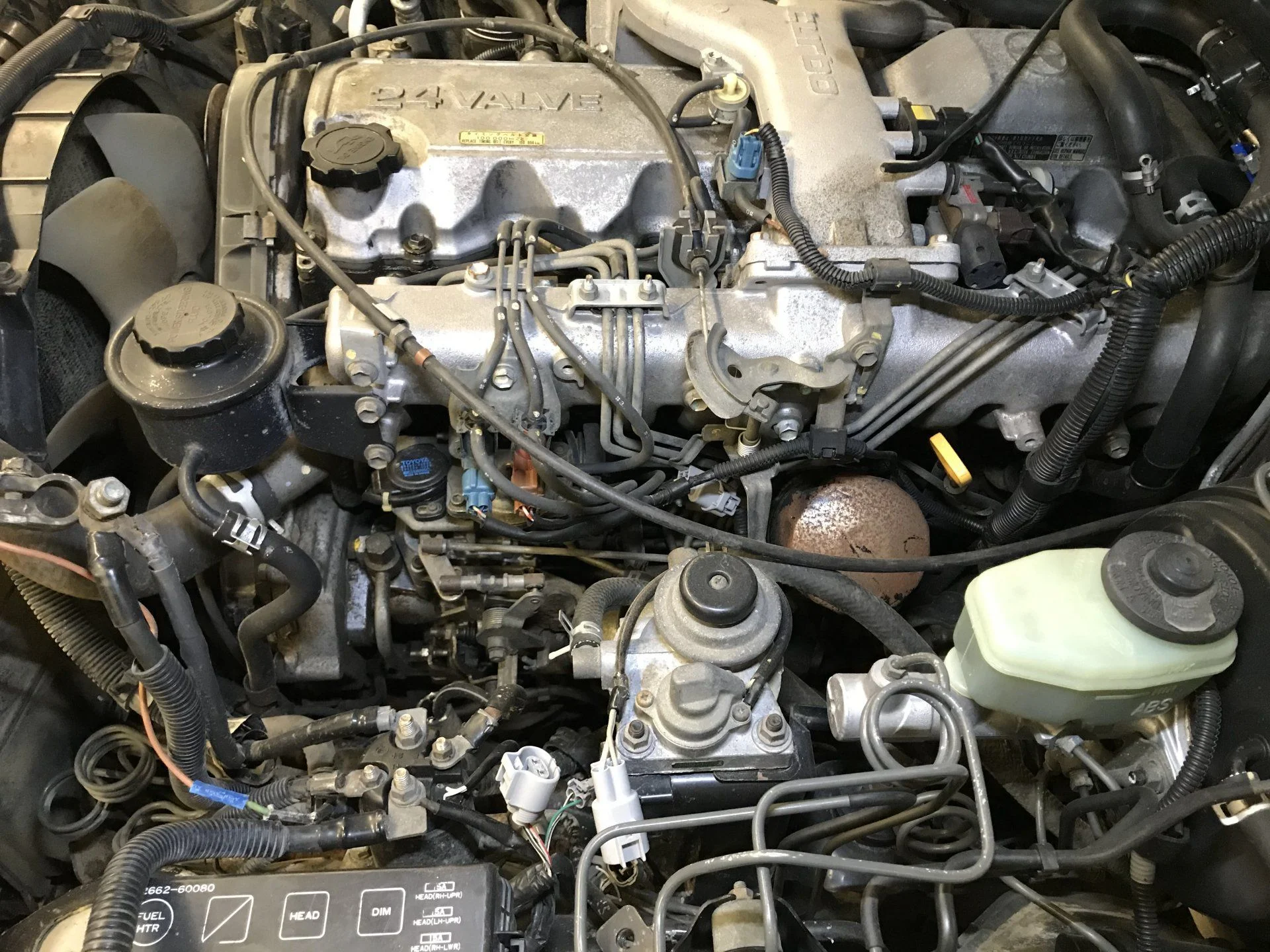

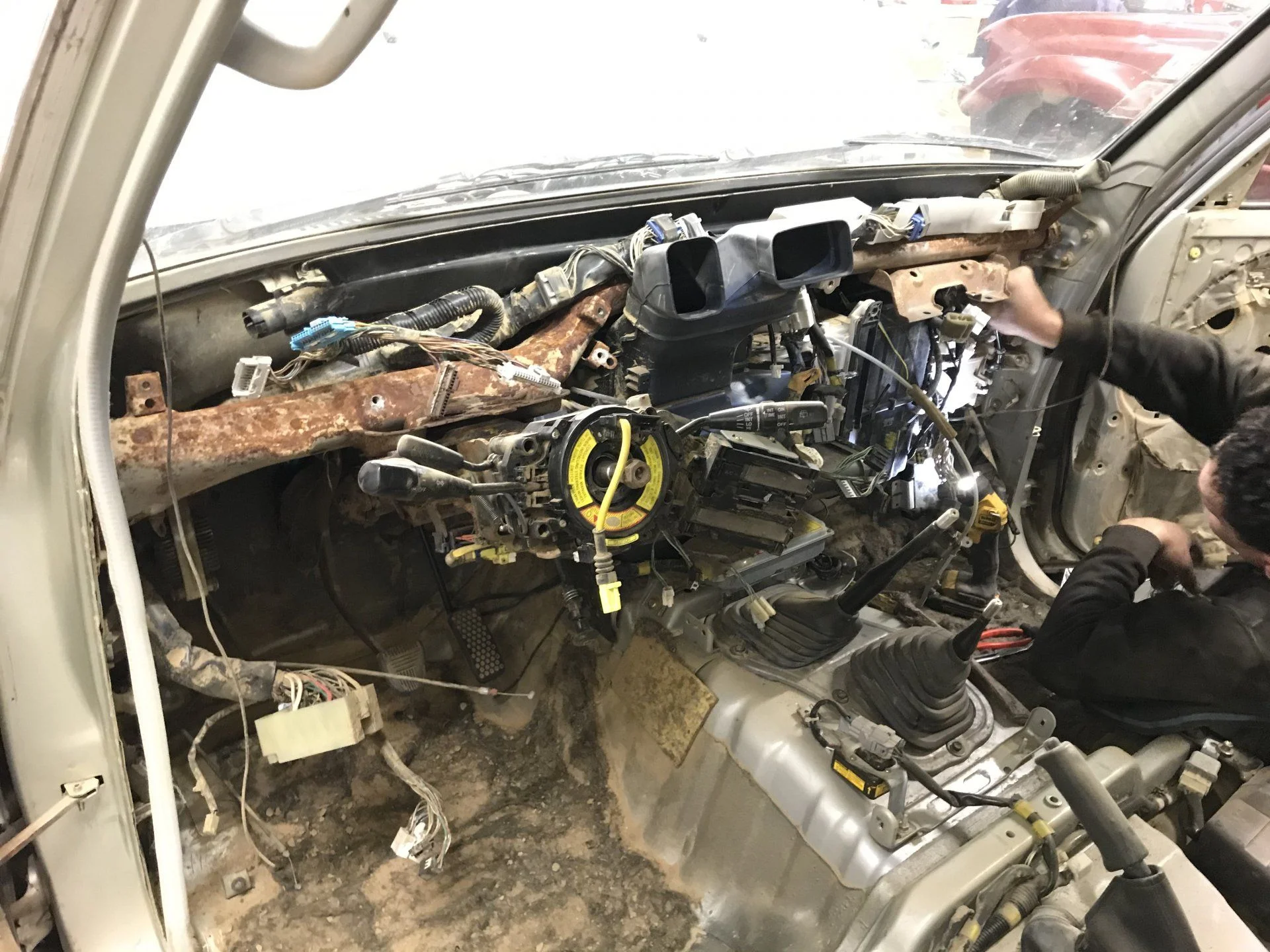

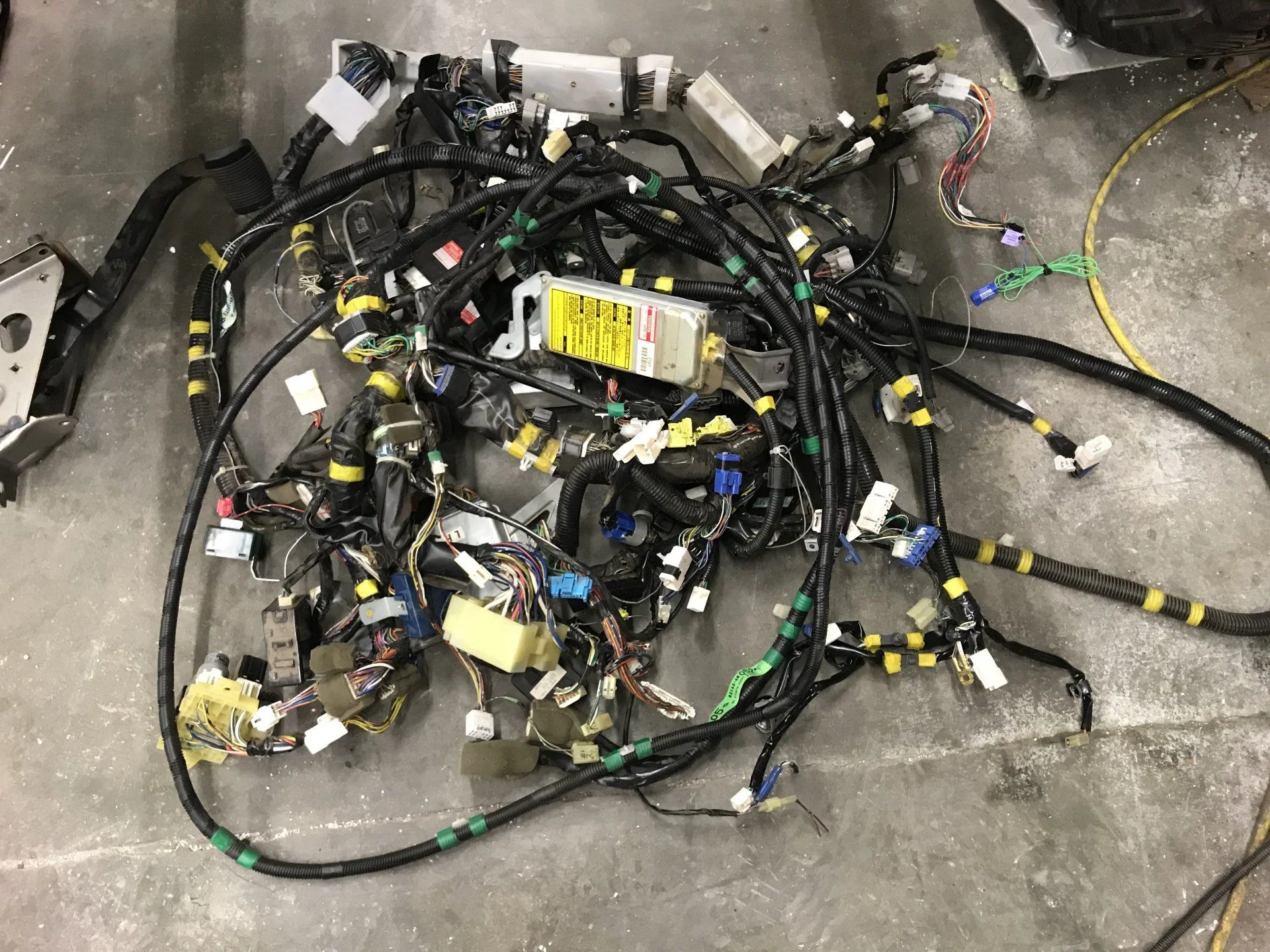

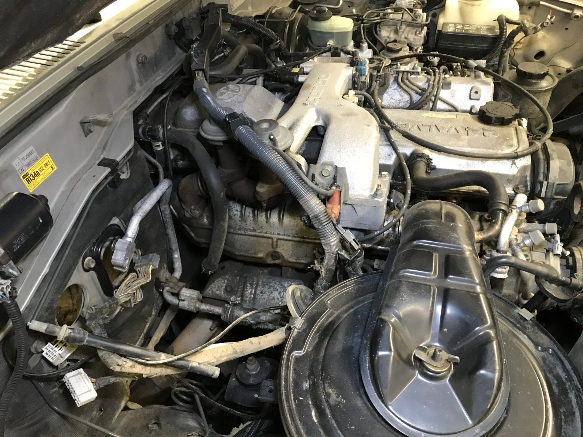

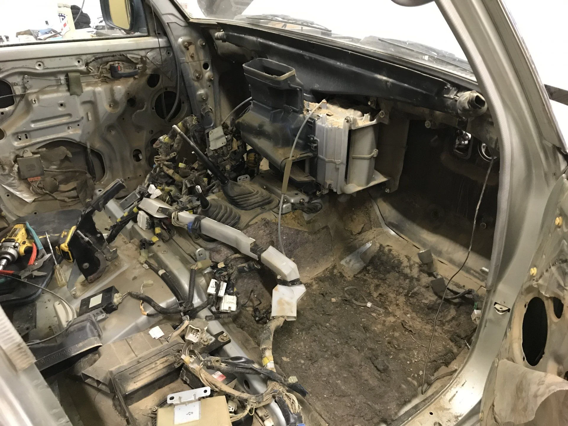

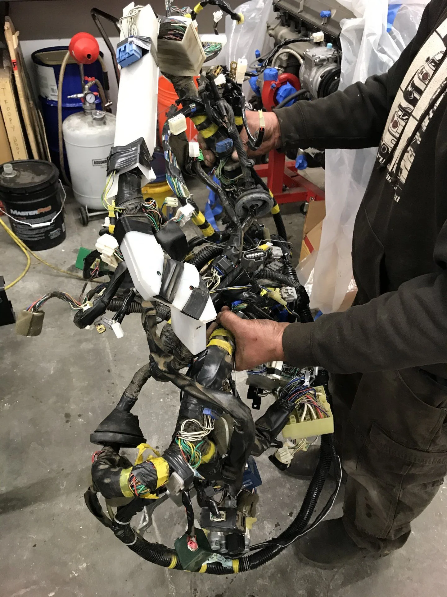

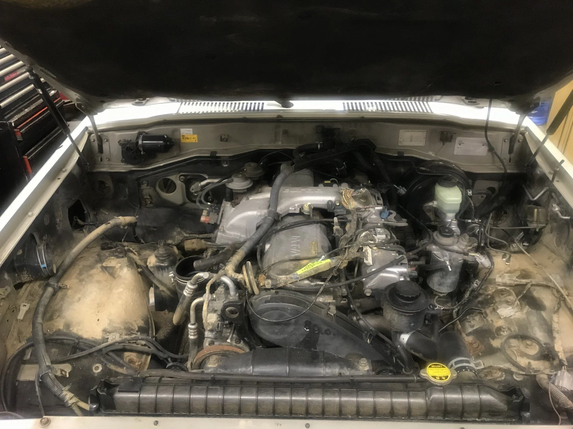

So we got that HDJ80 donor truck. It has everything Johns 1997 FZJ80 has besides a sunroof and front power seats. I mean everything, ABS, air bags, diff locks, manual trans, 1HDFT, a/c, ect ect. So, we swapping harnesses. Here is the FZJ80 coming out and out.

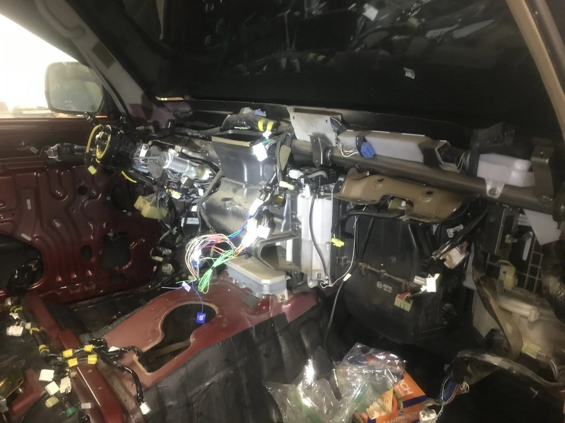

Gave the firewall and what’s left of the HVAC in here a clean.
Tomorrow, start tear down on the donor HDJ80. 🤠
