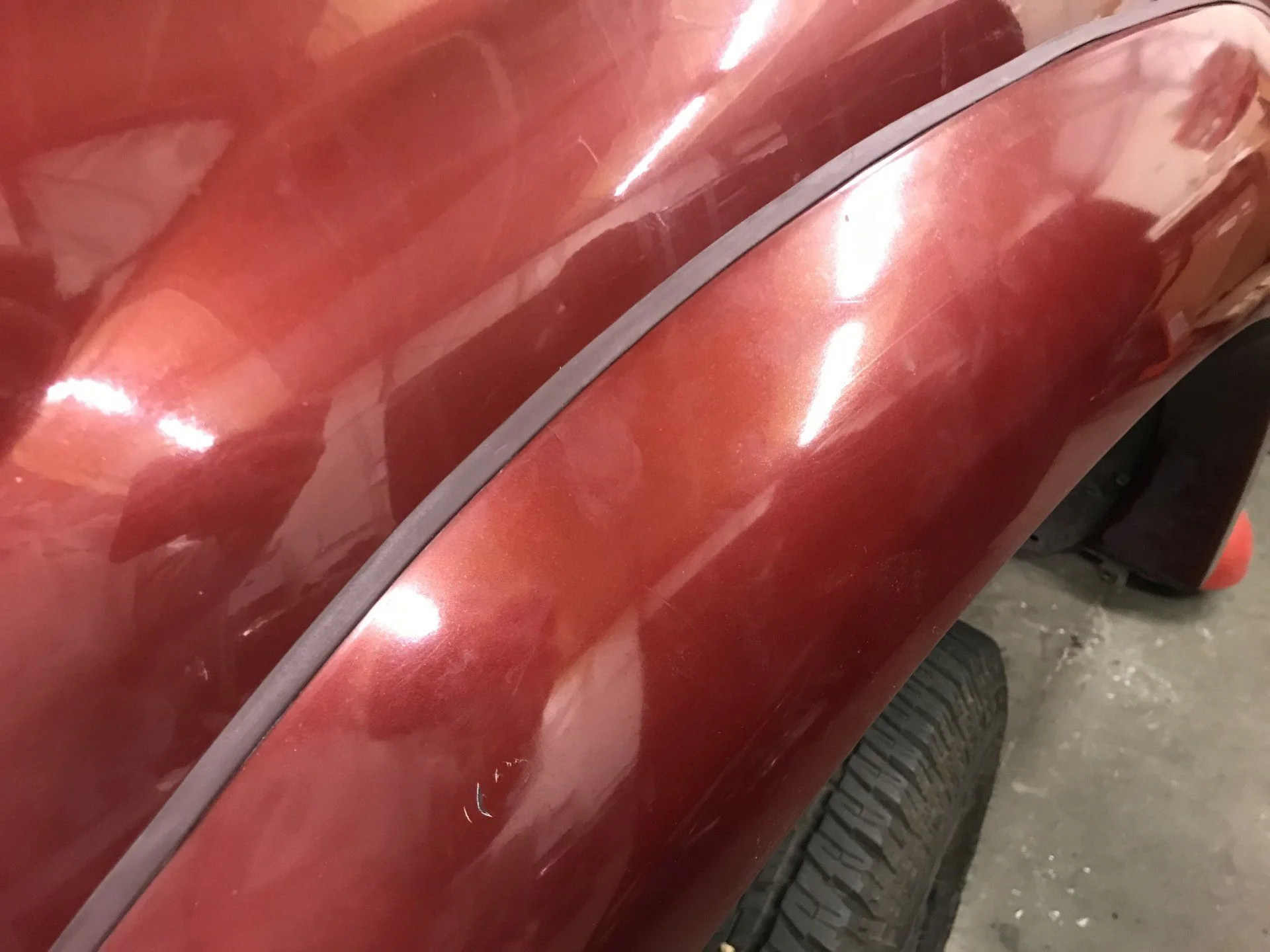

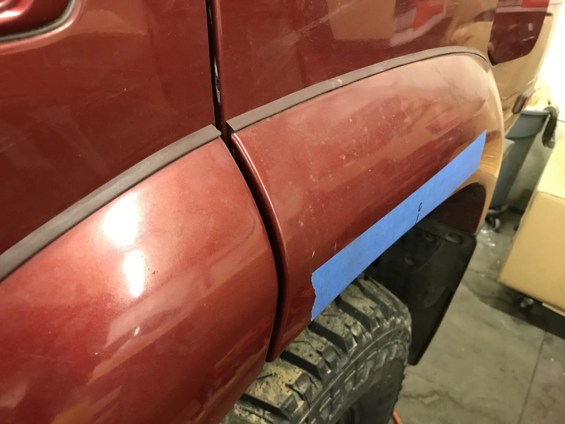

The Cruiser got new “maroon” fender flare gaskets and hardware.

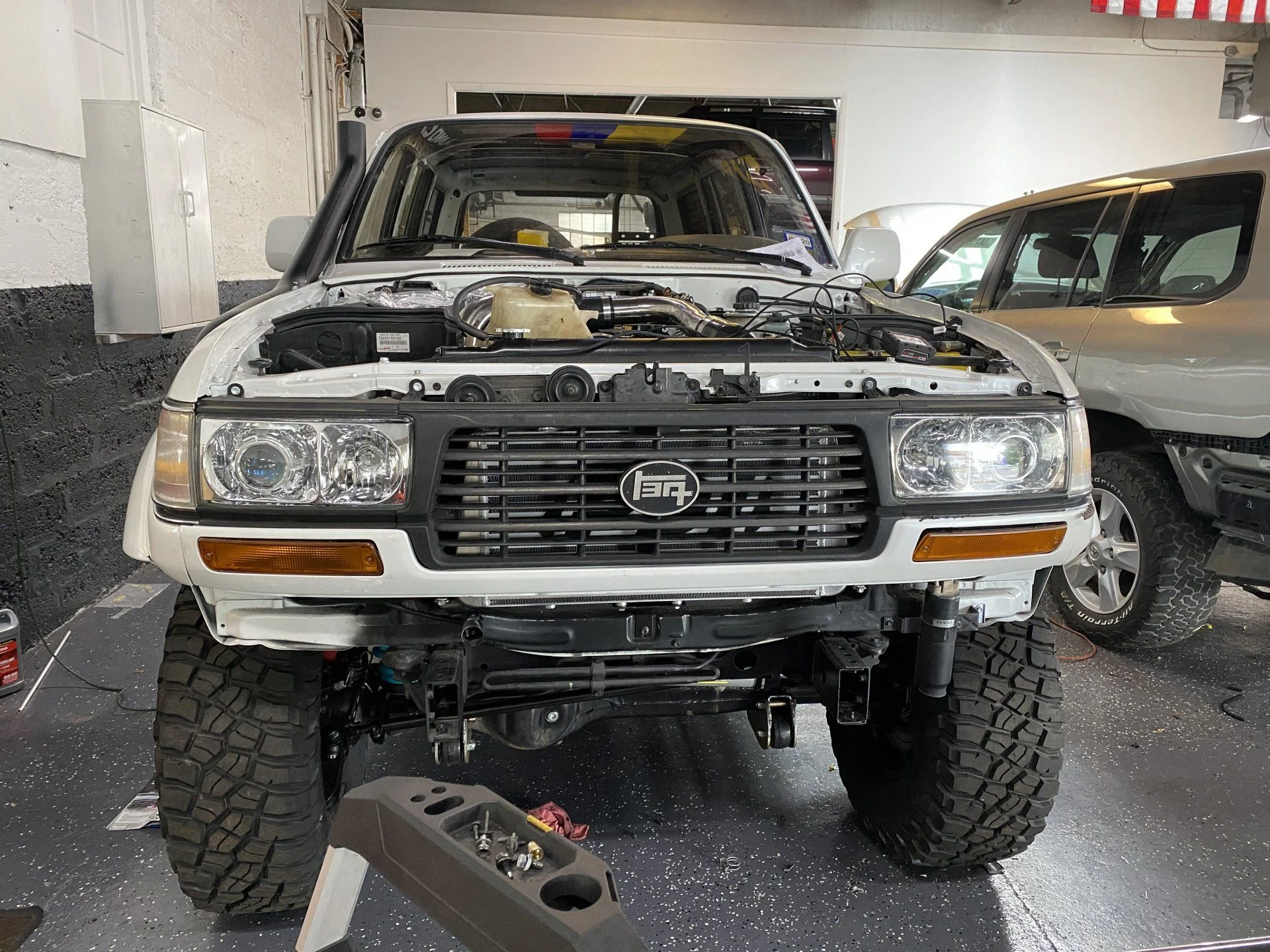

No FTE out today, I was doing to much Fab-dirty work in the shop for it.

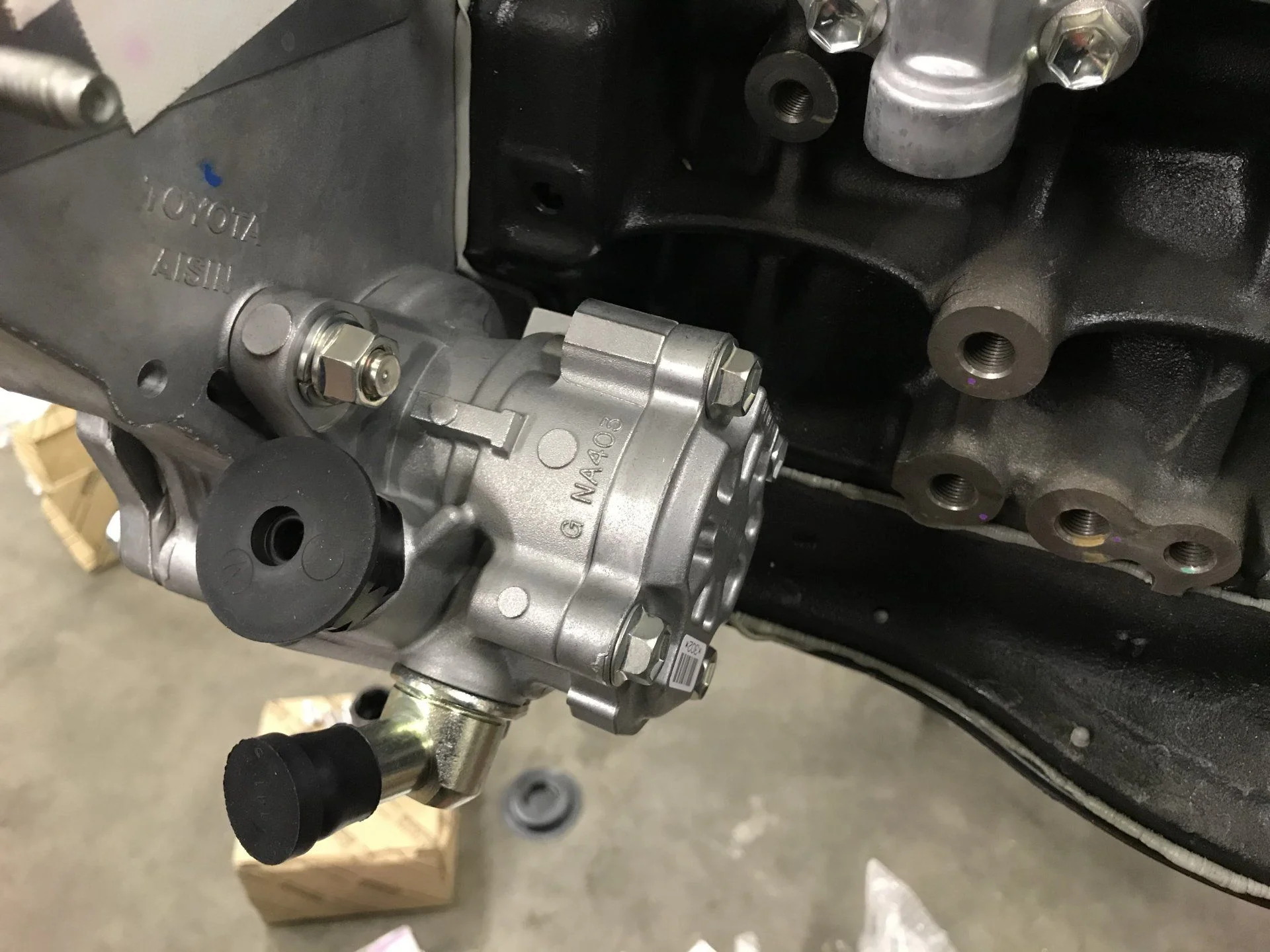

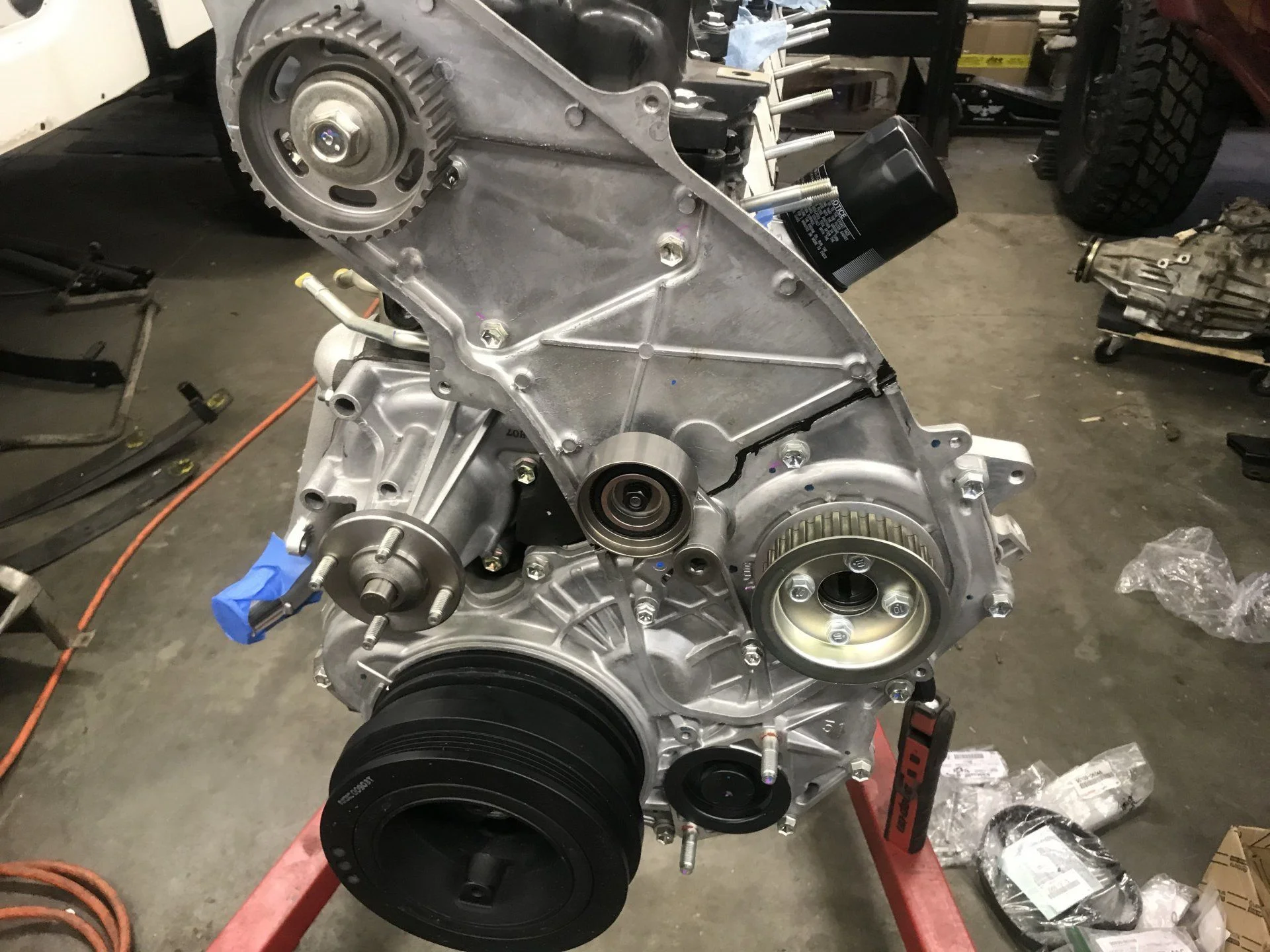

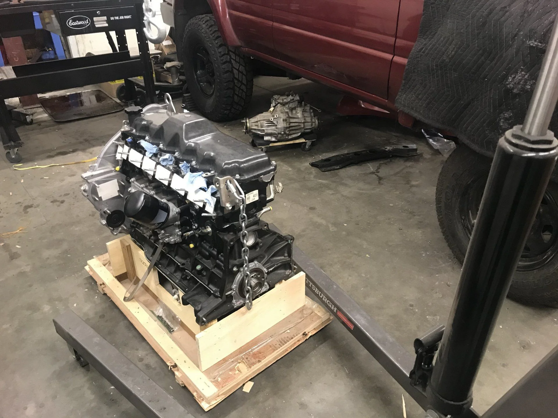

We got the FTE out, went through the hundreds of nuts, bolts and washers we have and labeled all the bags. Got it on a stand, set cam and crank to TDC. Pulled the water pump and replaced it’s gasket. Started installing timing belt and we still need a tensioner, that will be here Monday. Got the p/s pump on and also the water outlet and thermostat installed.

What is the plan with power steering? Some are saying that the steering with 100 pump on the 80 is very hard. Some put the pump and banjo from the 79 claiming it has better effect. I am actually going with the 100 pump, 80 banjo bolt and high pressure hose. The low pressure output on the 100 pump is hitting the steering box, so will need to cut and weld it to the other side.
Plan is to deal with it when we get there. Onur sent the pump, I don’t know if it is for an HDJ100 or the HDJ78/79.
As you mention there certainly could be a difference since the HDJ100 would have had a rack and pinion vs an actual steering box like the 78/79.
John, Onur and myself are all working on and through all this. None of us have done an FTE in an 80-series before not to mention the H152 so a lot of new ground here for all three of us. I have worked on the 1PZ and 1HZ a lot along with the 1HDT & FT. This is the first FTE I have had my hands on but they are all very similar.

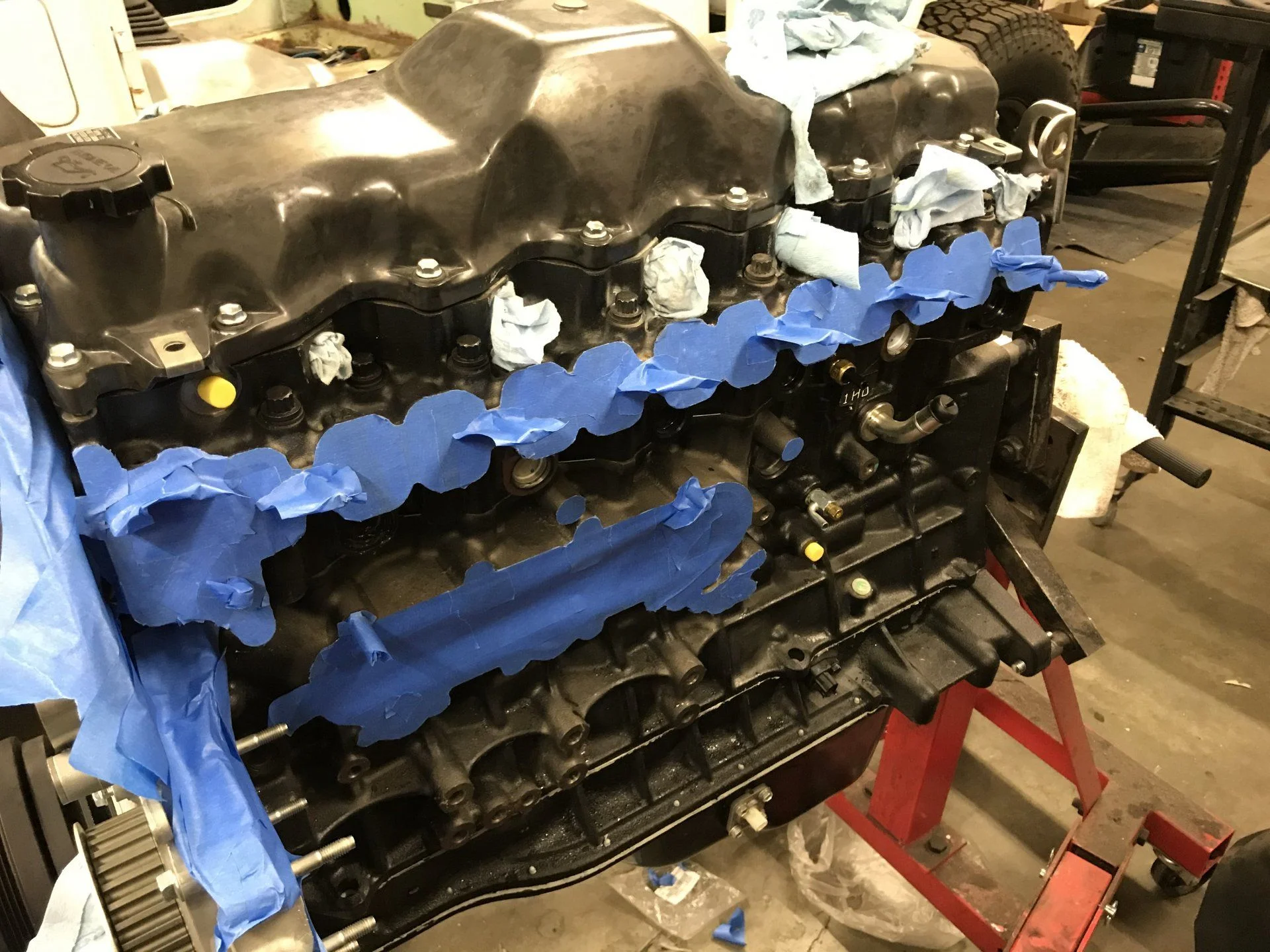

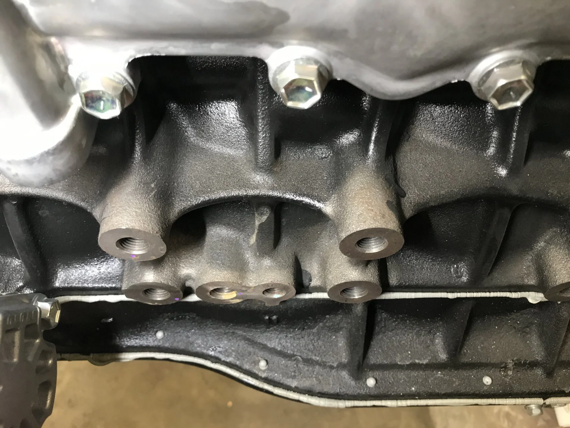

So we decided to give the FTE a good coat of paint before bolting anything else on.

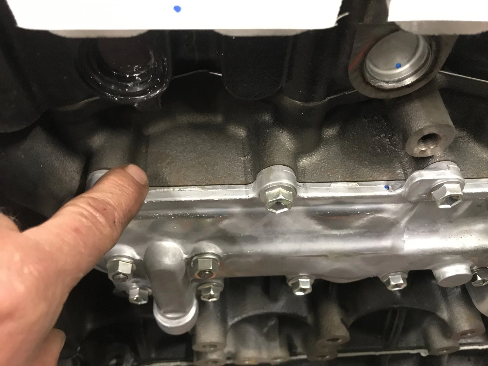

You can see the factory paint is a bit thin here and there or none at all.
So we are taping it off for a fresh coat.
I will be using this to give it a fresh coat once we are prepped.

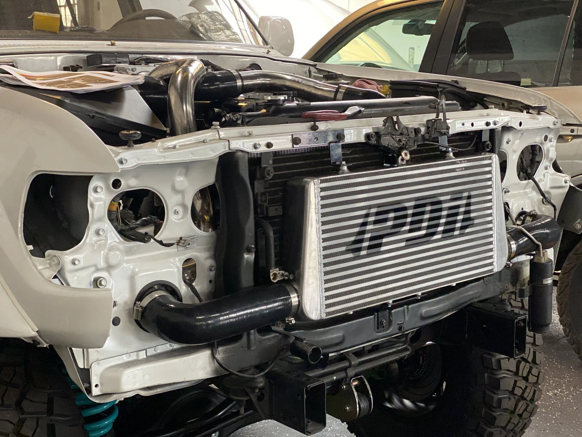

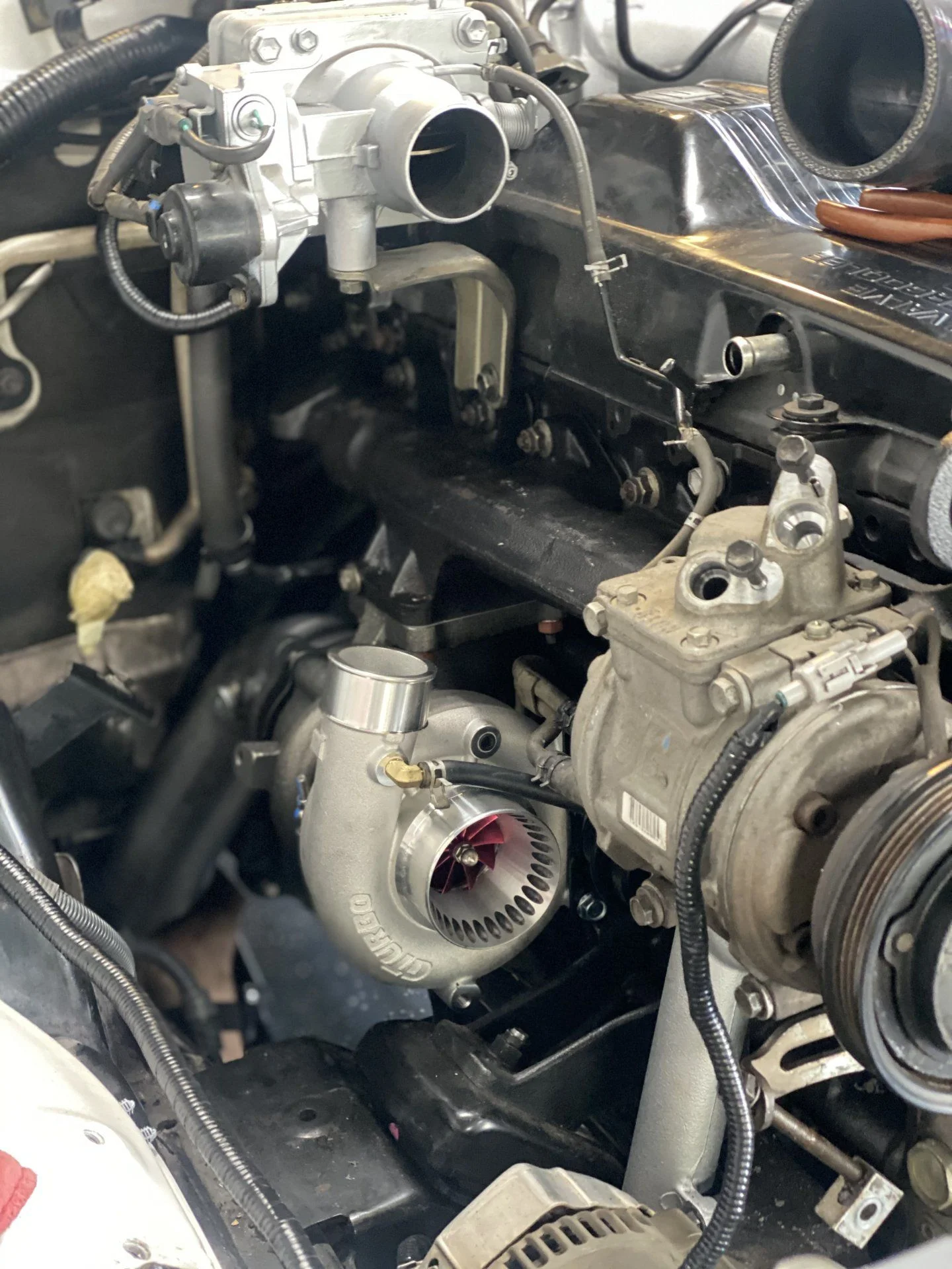

I have installed an FTE with a Gturbo module, Gturbo red wheel turbo and PDI Front mount intercooler on a 96 LX450.
would be happy to assist in anything as needed.
