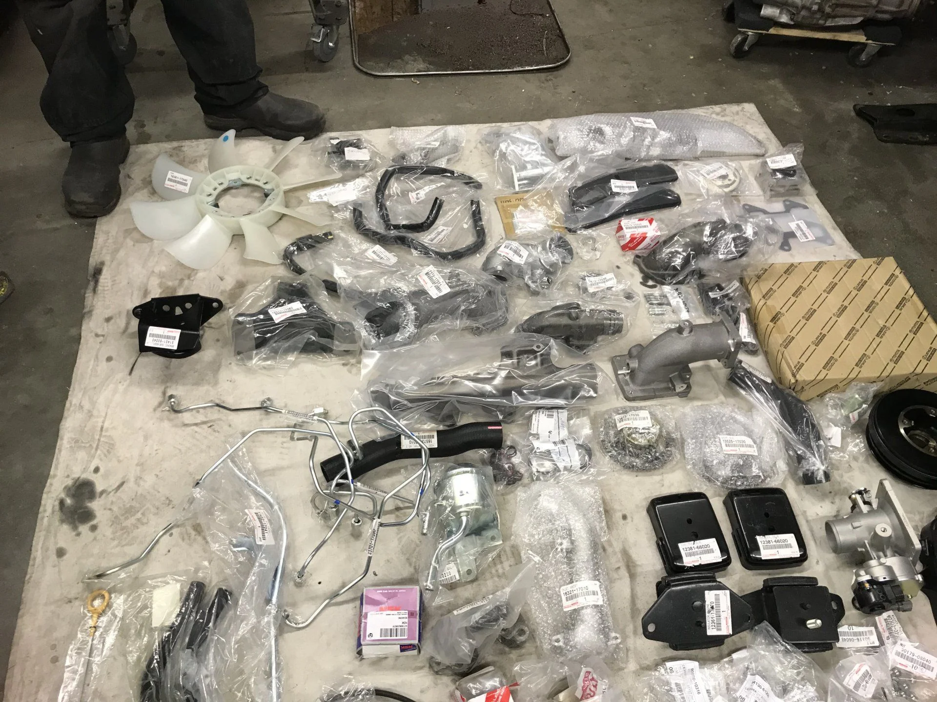

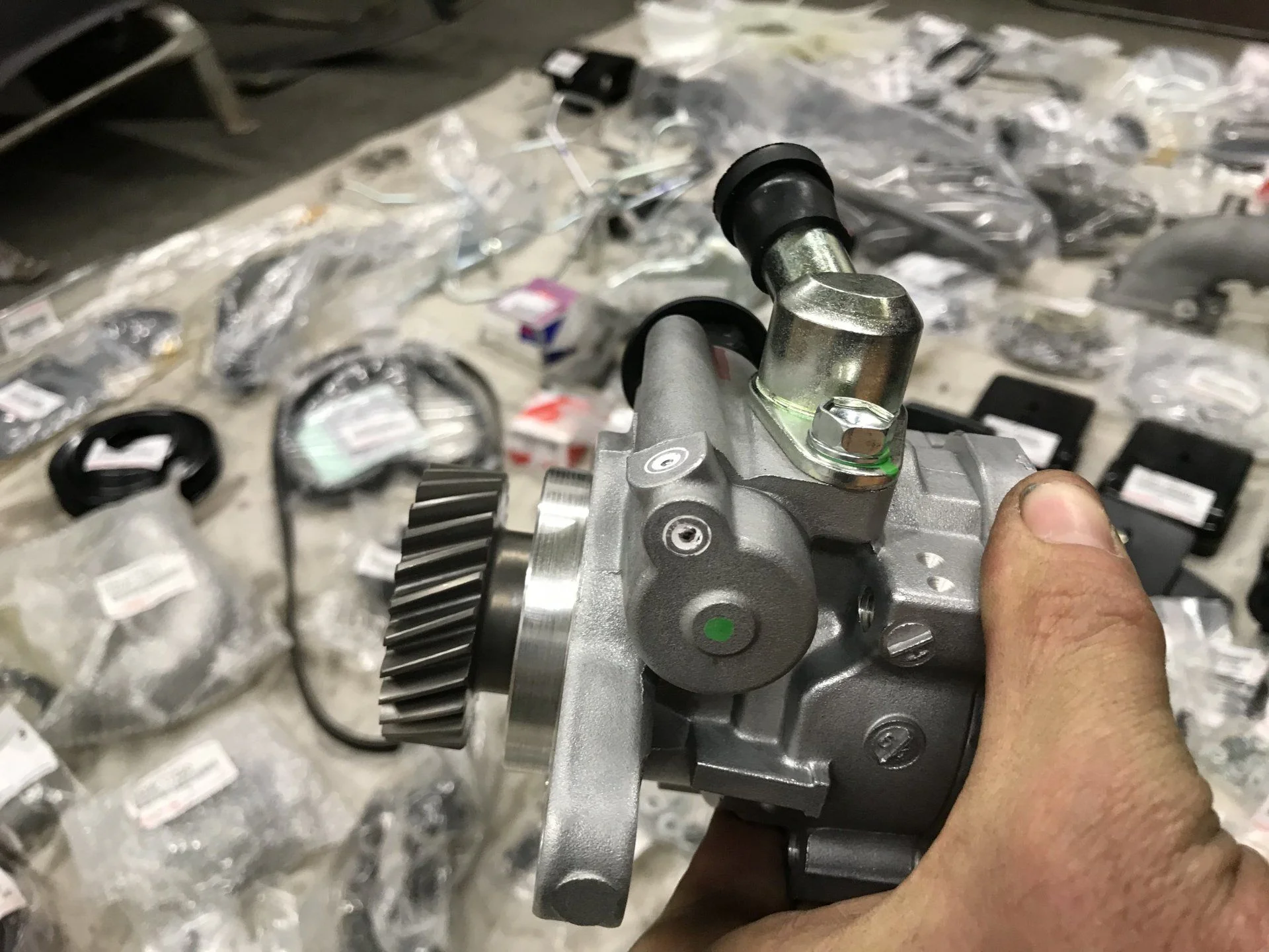

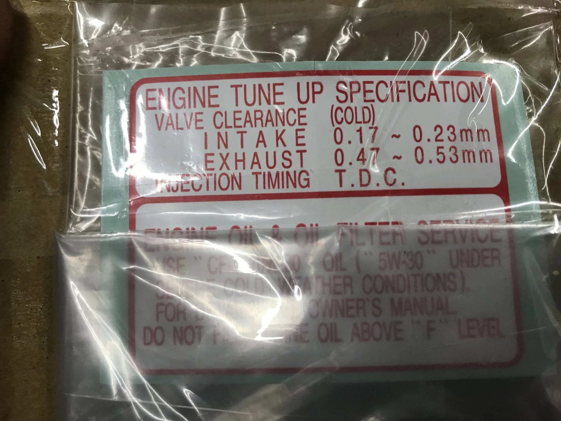

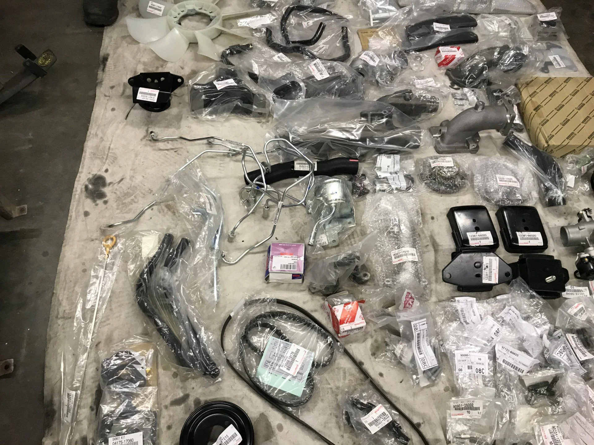

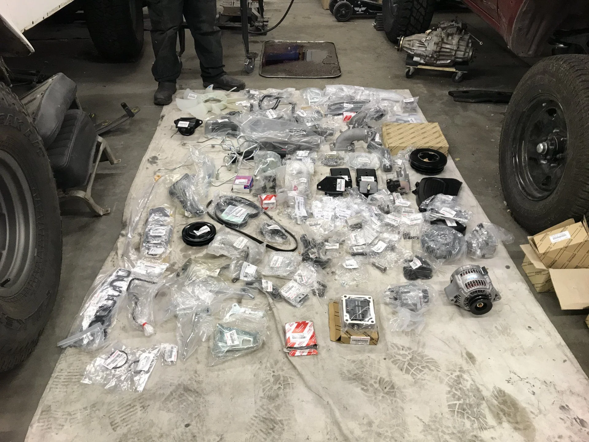

@Onur was supposed to post these but I guess he is to busy killing zombies so....
Cheers
FTE parts @Onur has sent us. And priorities my man, priorities. 😝
Tomorrow we will put the long block on a stand and start bolting on parts. Let’s hope Onur didn’t forget anything!! 😂😉
Cheers
There will inevitably be parts I missed and ones we are still waiting on from all points.
And even some that might be incorrect...
I’ve never worked with such a rare engine with a rare part like a NOS OEM long block. :)
It’s all good, just funning ya a bit.
We also going to get some of the cast iron bits ceramic coated. Still need goodies from GTurbo which will be awhile, ect ect. I feel like it is time though to get the FTE on a stand and start assembly. 😎

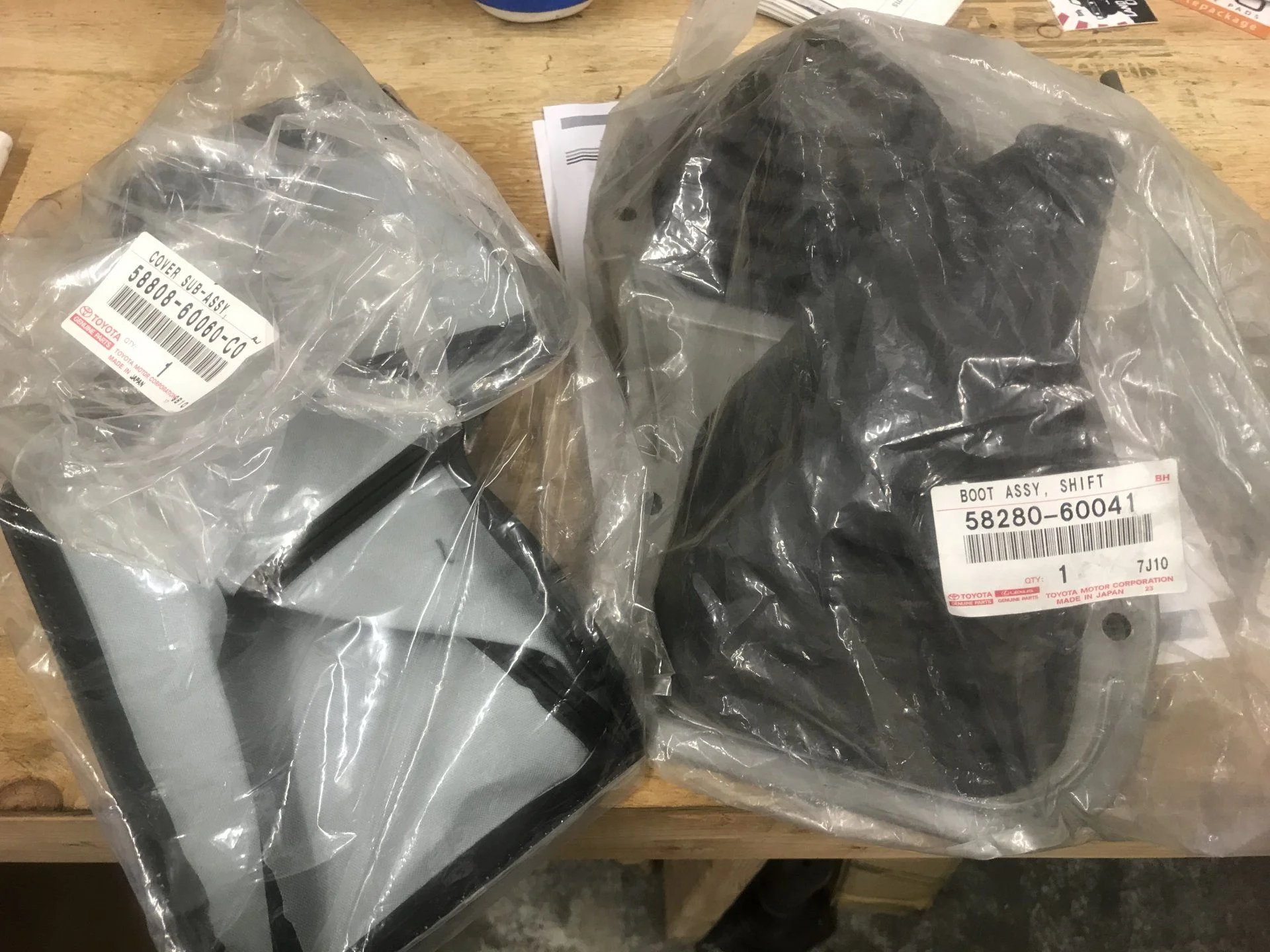

3D printed console is gonna look like crap.
If you cant locate an original one, you're going to be far better off taking the A/T console to a place that does fiberglass work and modifying it for the manual shifter boots. The only difference between the A/T and manual console is the top "plate" that the shifters go through. It's essentially a flat piece of plastic with a couple of big holes in it. I imagine it would be super easy to modify the A/T console into a manual one.
I am with ya on this. We got to have a template though to build off of. I have this...
But to have a template would be ideal. 😉
Cheers
Cheers
So I have a LHD manual consol that I got off of @joekatana .... I'm not willing to sell it but I can send you measurements. Or if you know of an interior shop that can make a copy of it I'd take it there for ya.
