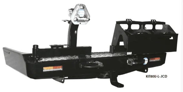

But I learned that @wardharris and @orangefj45 are now US dealers for Kaymar. I had been debating my rear bumper setup and really wanted to do something a little different. So now I’m the proud owner of a new dual swingout bumper and should take delivery by end of the year.

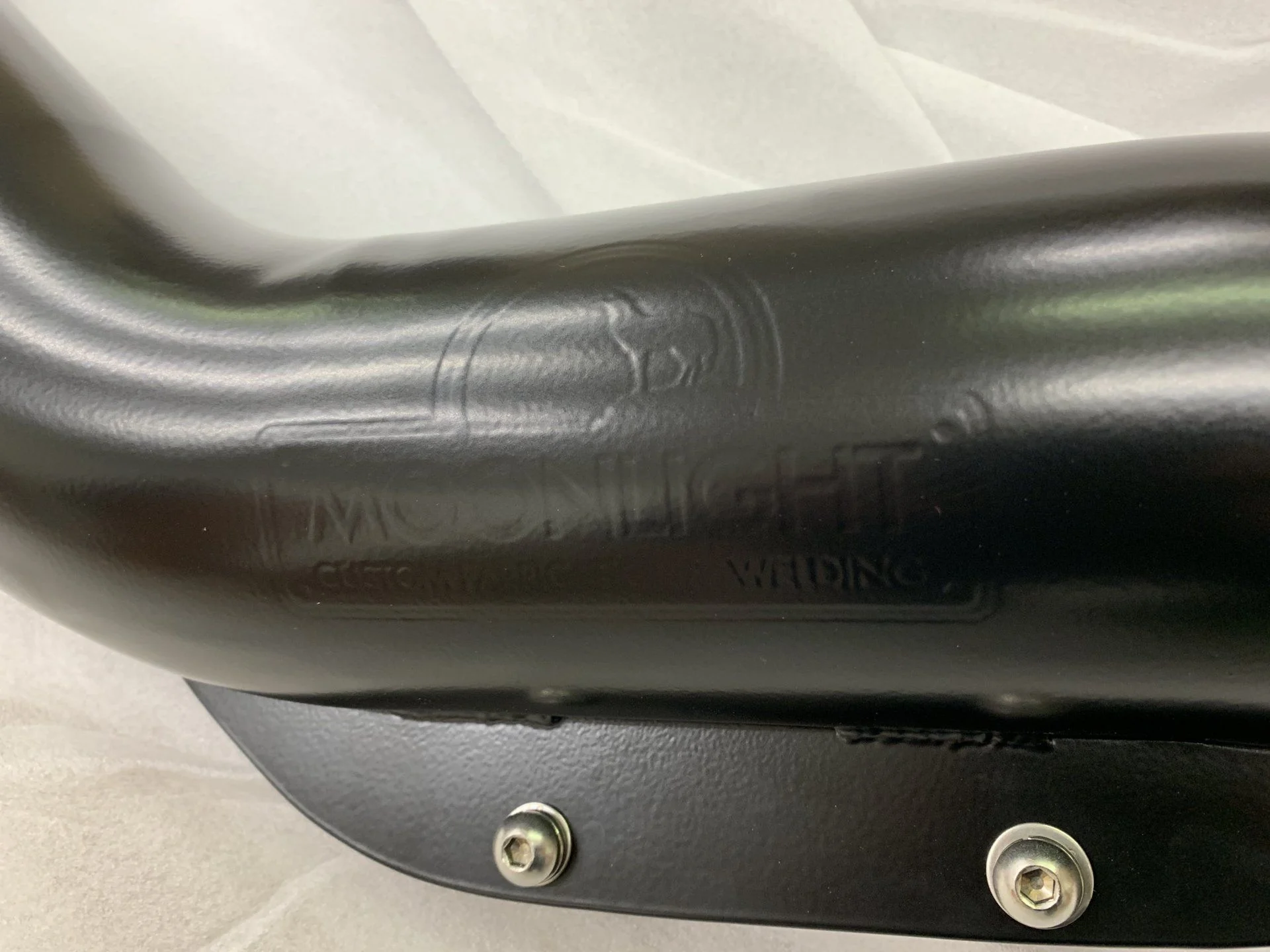

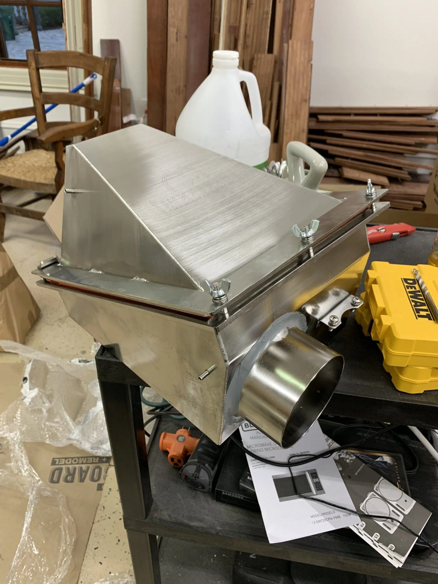

The 1HDFT diesel is going to need to breath some air so I wanted to find a high-end snorkel setup. Finally came across Moonlight Fabrication in Australia (Stainless Snorkel | Australia | Moonlight Custom Fabrication & Welding) and they have a killer 4" snorkel setup with a stainless steel airbox designed for the 1HDFT. I placed the order last night for the front facing snorkel and matching airbox and both should be en route to Florida the first week of December.

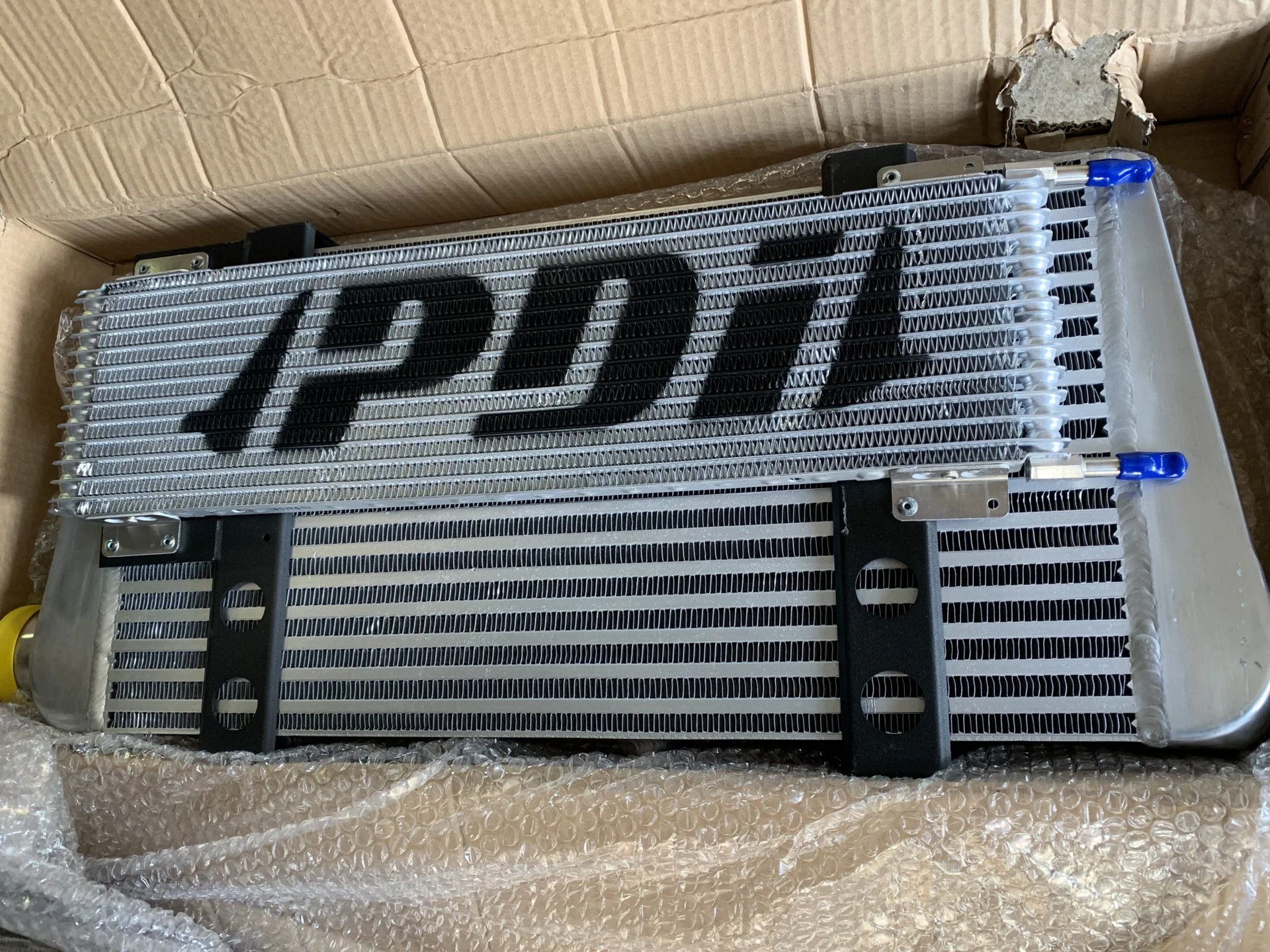

My next task was finding a suitable intercooler setup. I debate front v top mount intercoolers with a couple of different guys with similar conversions. Most pointed me in the direction of a front mount setup and eventually to another Australian company called Performance Diesel Intercoolers or PDI. PDI has a specific setup for the 1HDFT 80 series with automatic transmission (Landcruiser 80 Series Front Mount intercooler). For automatic vehicles, PDI builds in a transmission cooler. A few calls later and the purchase was made. Looking forward to seeing the intercooler setup in the shop in early December.

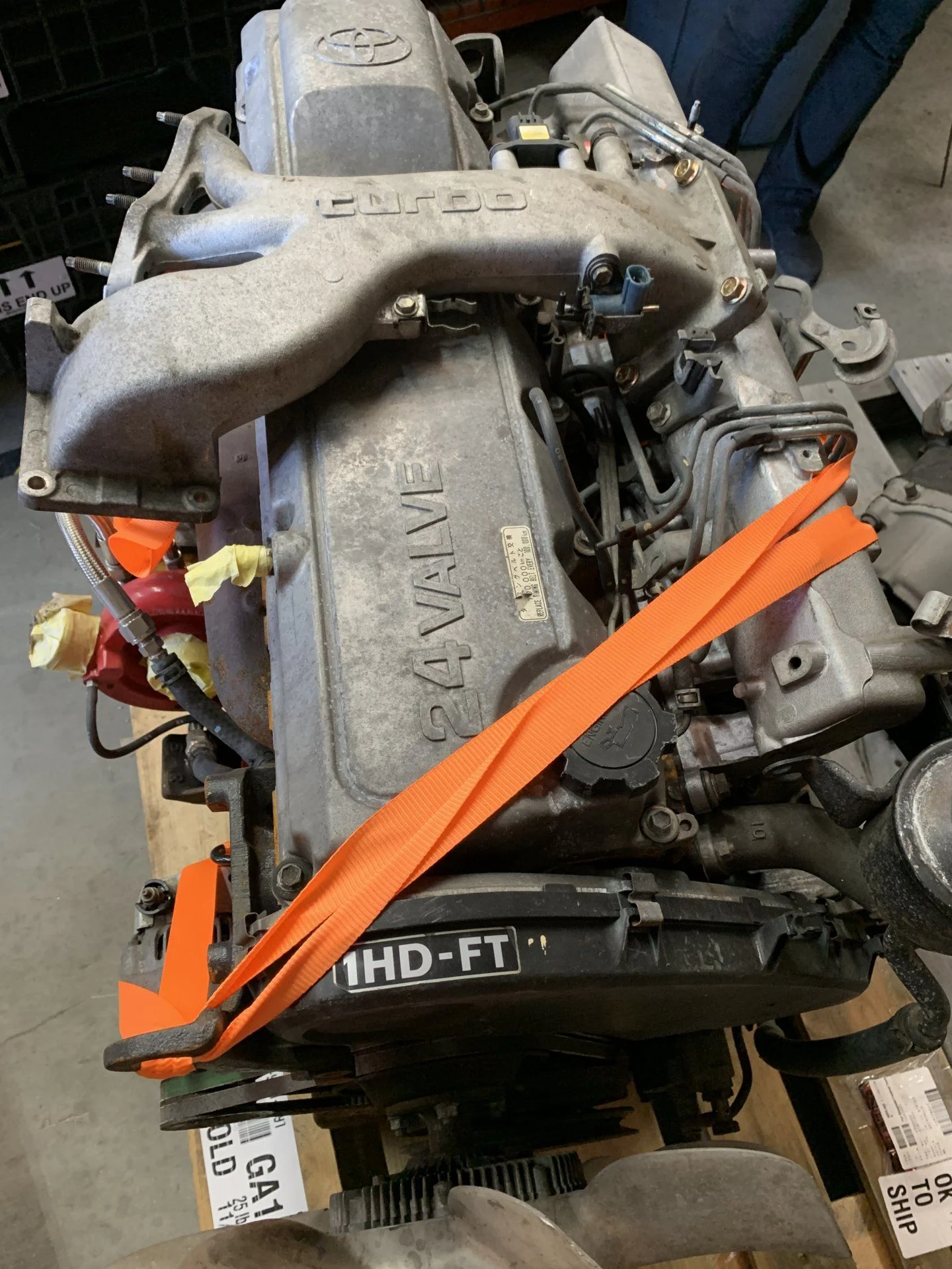

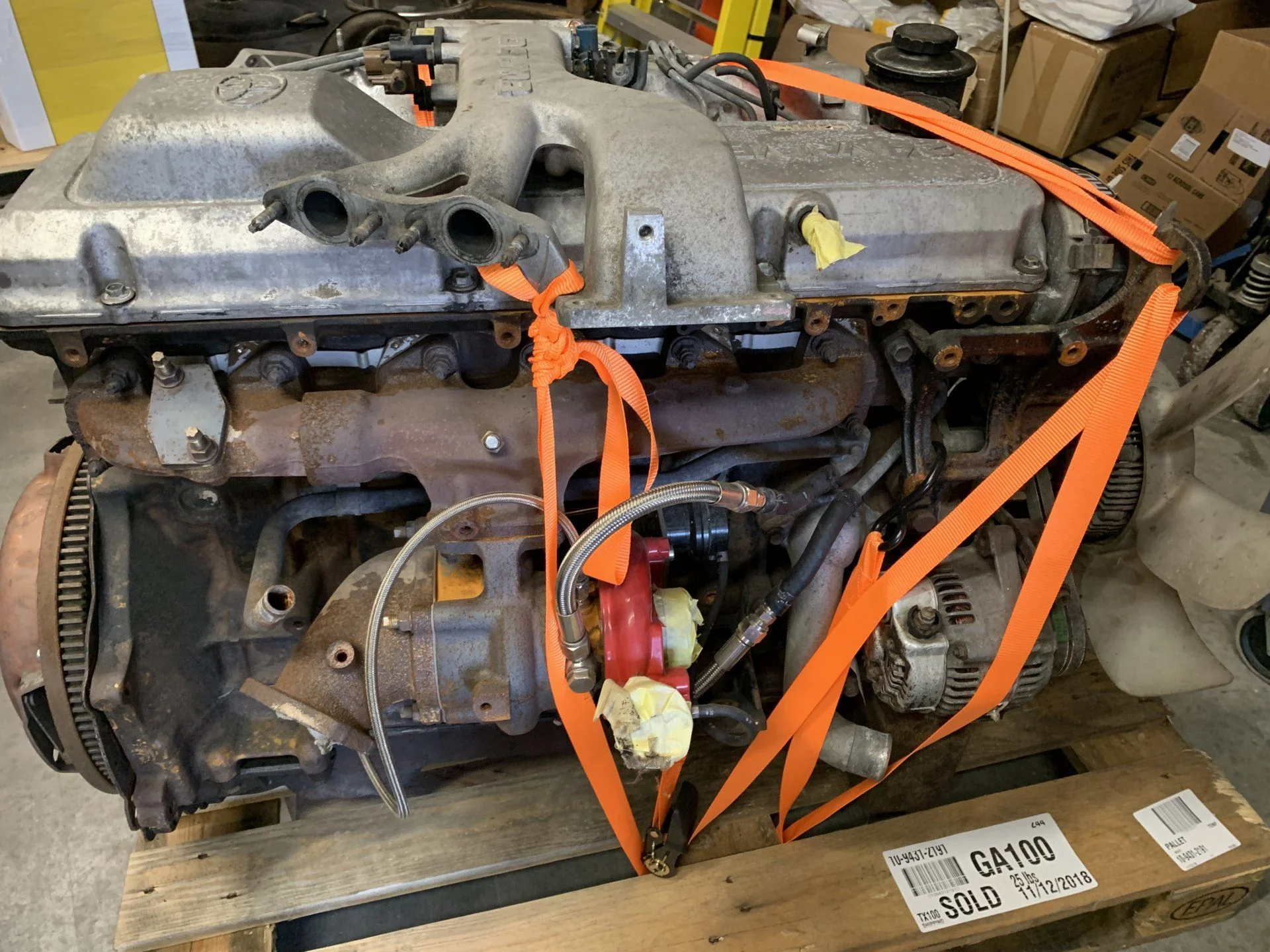

But I did receive a call that some parts I had ordered were now at the shipping terminal, including the 1HD-FT. Definitely like the look of 24-valve, turbo, mechanical goodness. This engine has an upgraded turbo from Winks 4x4 in the Netherlands (www.wink4x4com). Will get started soon on cleaning, sealing and painting it up so it will look better.
Even though not much work has started on the truck, I do get a lot of joy out of receiving parts. I came home today to see the PDI intercooler next to the front door! And, happy to hear from @wardharris that my Wholesale Automatics transmission is officially in the United States.

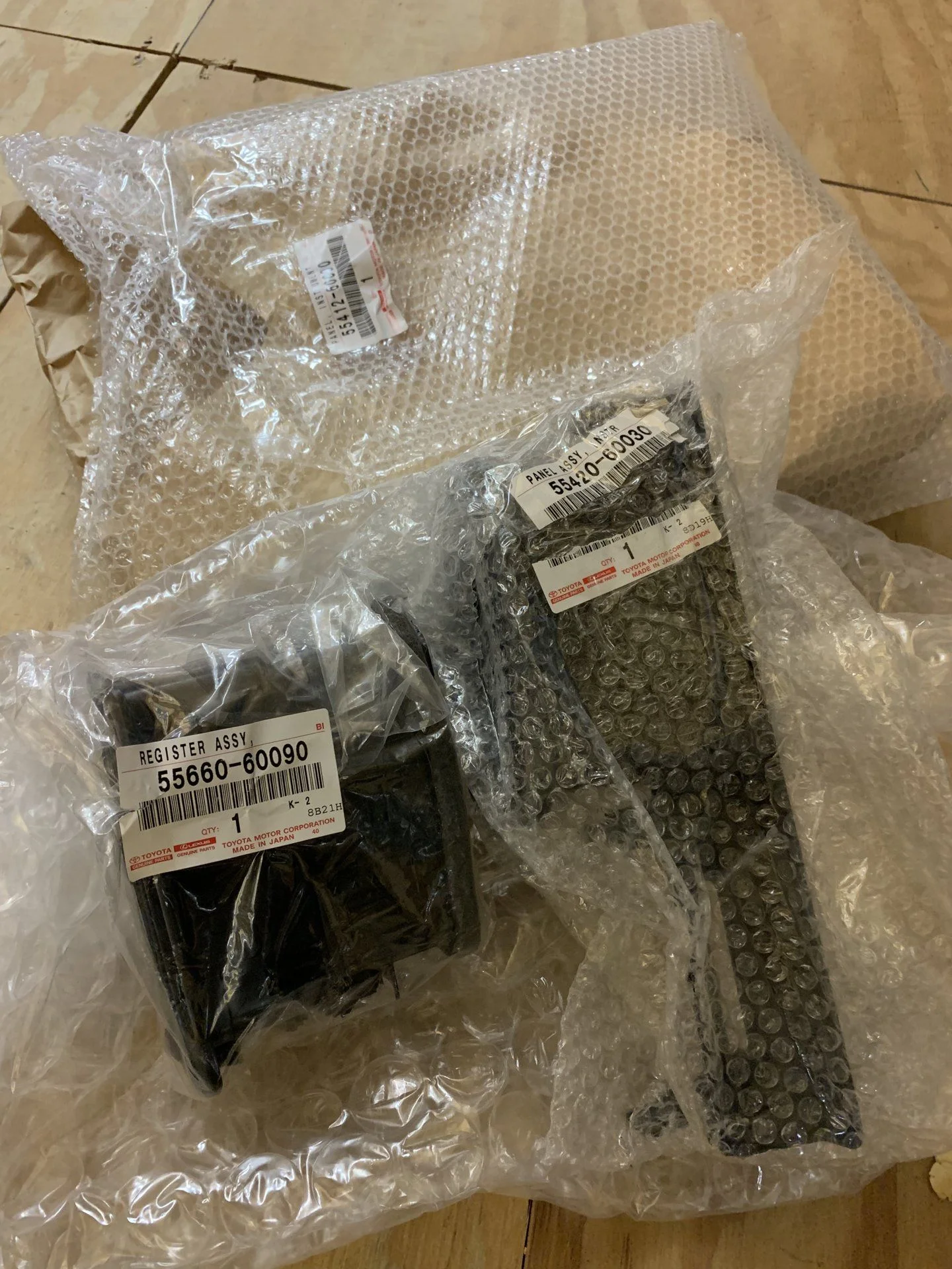

Special thanks to @beno for helping me rid the truck of woodgrain - after I spent all that time replacing the faded original batch. I kept finding myself being extremely jealous of the non-woodgrain look. My trim did not look so great after all those years of being beneath adhesive. Onur has been awesome with sourcing parts and otherwise listening to my crazy ideas. We are still waiting on a few items but this is a good start.
Alright! Now show us whats inside the box!
@Lumpskie here you go. There are a lot of pipes, hoses,clamps as well. The unit itself seems to be extremely well made. The packaging left a little to be desired but nothing appears to be damaged.
This is going to be stuffed inside the grill with very little room - confirmed with some measurements. Oh, and I got a sticker AND a hat!

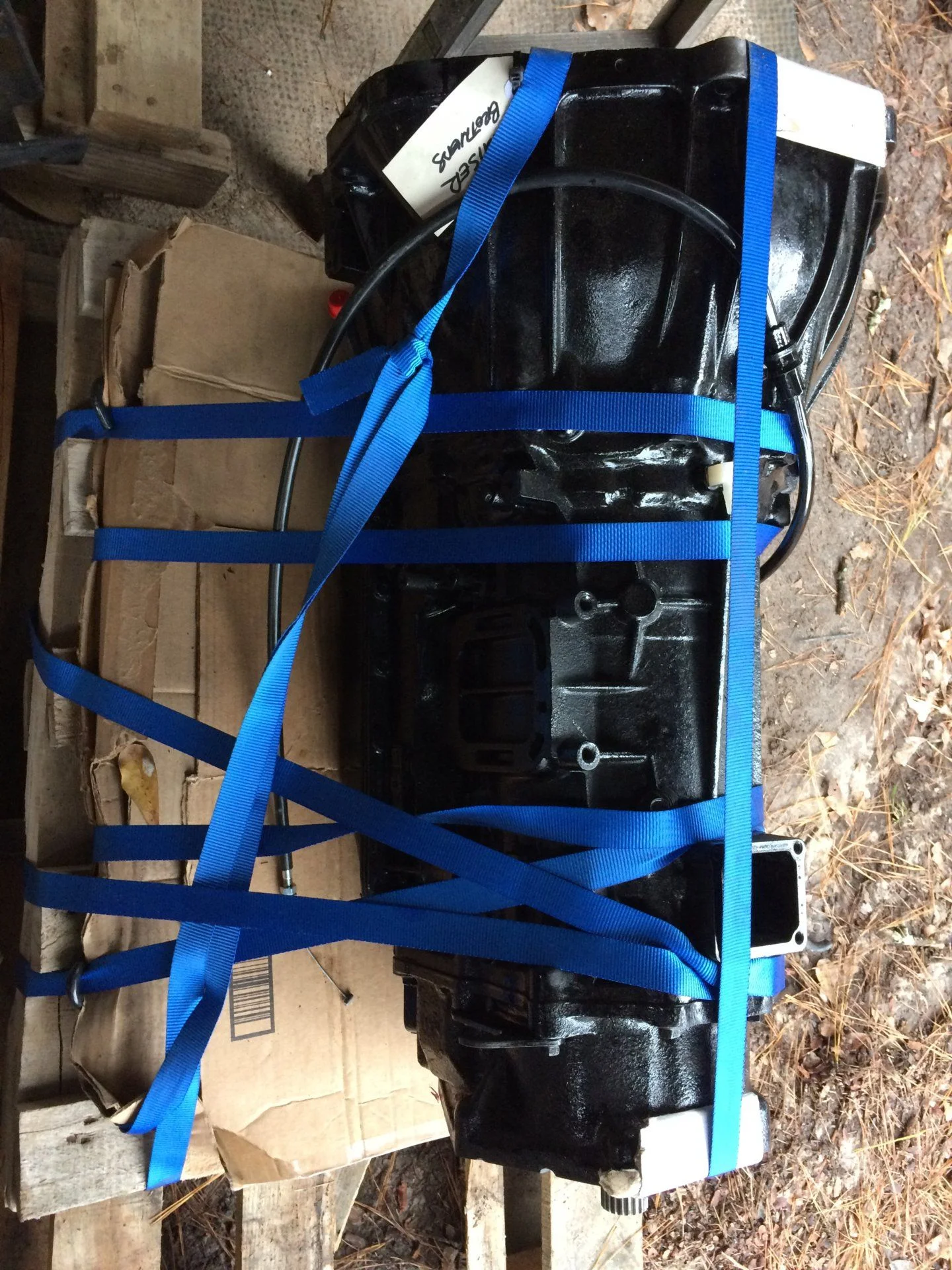

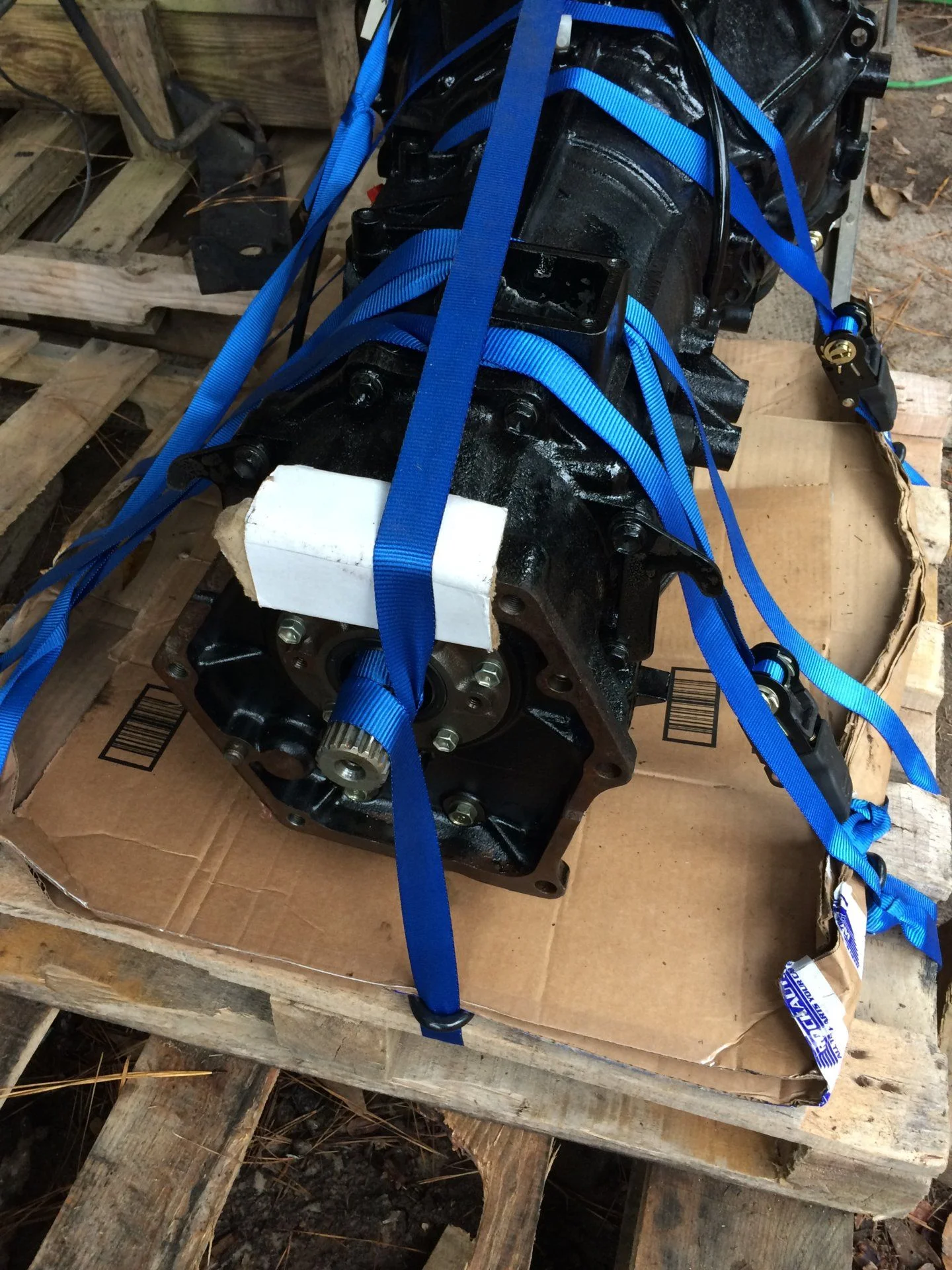

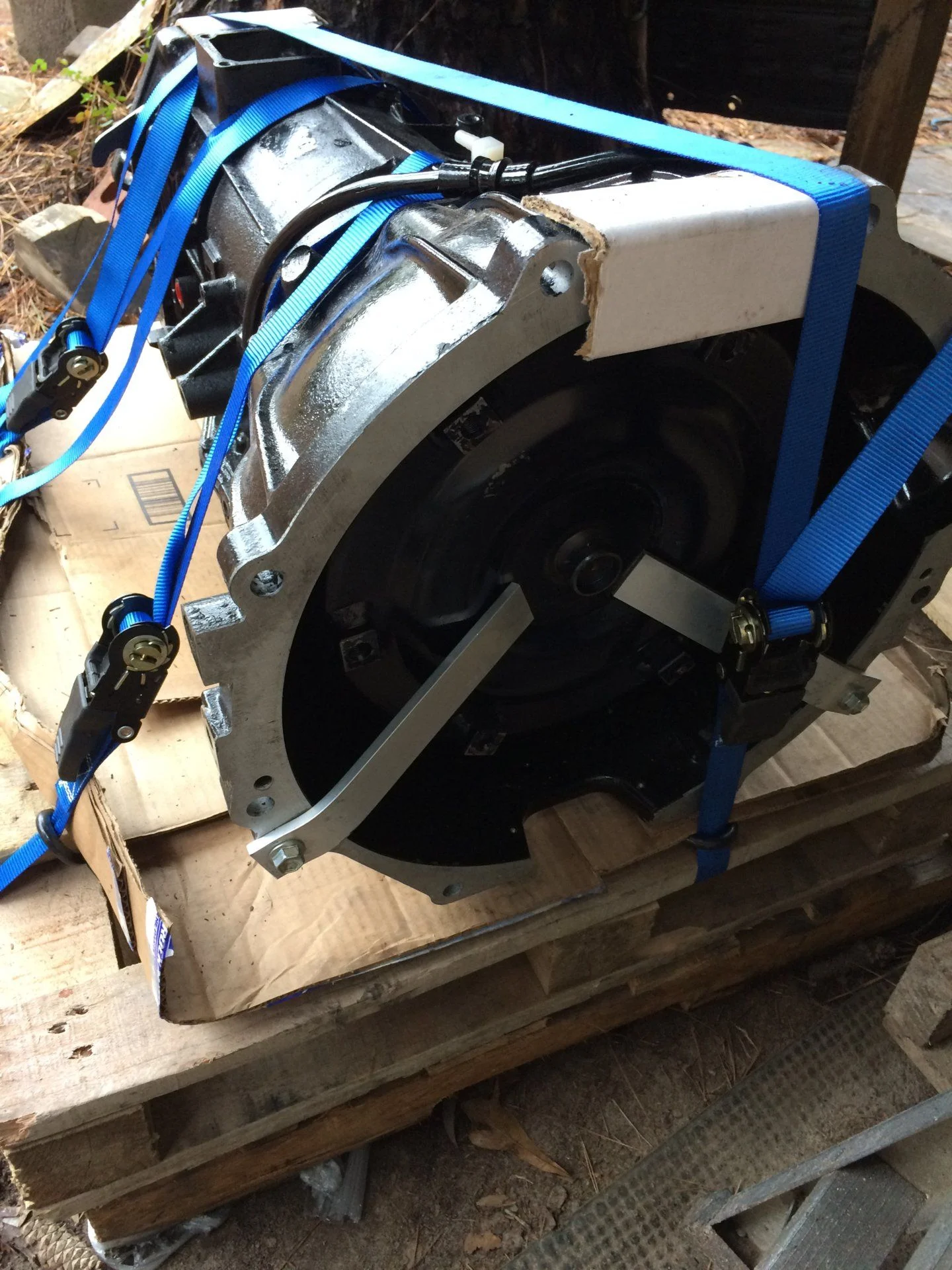

I was gone on a fishing trip for a couple of weeks and returned home to find some more parts have shown up. First on the list is the Wholesale Automatics Extreme A440 transmission! The transmission looks brand new. Cannot day enough good things about @wardharris and @orangefj45 for hooking this up!
Here is a pretty good write-up on the rebuild process for the A442 model. Extreme A442F Transmission Build Up - Wholesale Automatic Transmissions

I’ve also been slowly collecting parts to de-woodgrain the dash. I replaced all of the woodgrain but would rather just go back to the factory black. @beno has been helping me with all the available OEM parts. Still need the lower dash assembly around the locker and ignition switches. Missed a nice one on eBay while I was gone.
