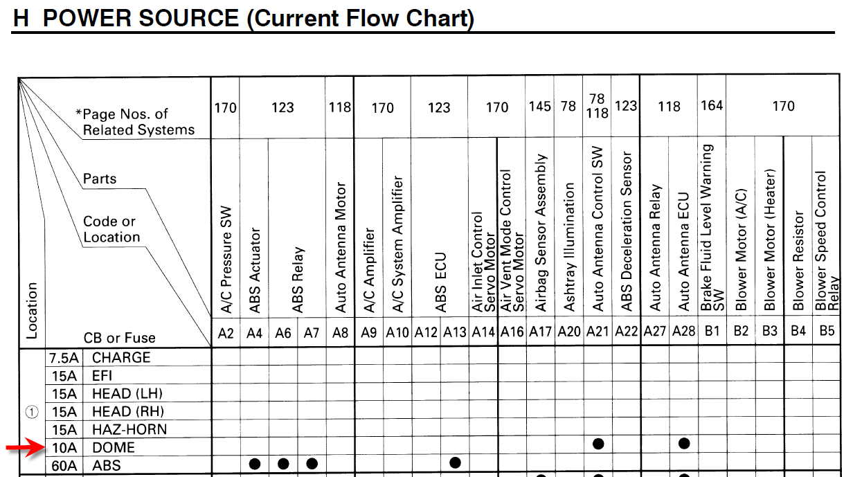

From the EWD:
Hi Malleus, I do have a copy of the factory service manual. I have owned this 80 for over 20 yrs and there is not much I haven't touched on it, but the electrical system is something I have not any troubles with until the engine reinstall. I have reviewed the FSM and it addresses trouble shooting specific electrical components but I believe this might be a bad connector that is causing all the above issues. Is there one connector coming from the 10A Dome fuse that connects these problem components? If so, do you know where it is?
This is a bit of a journey:

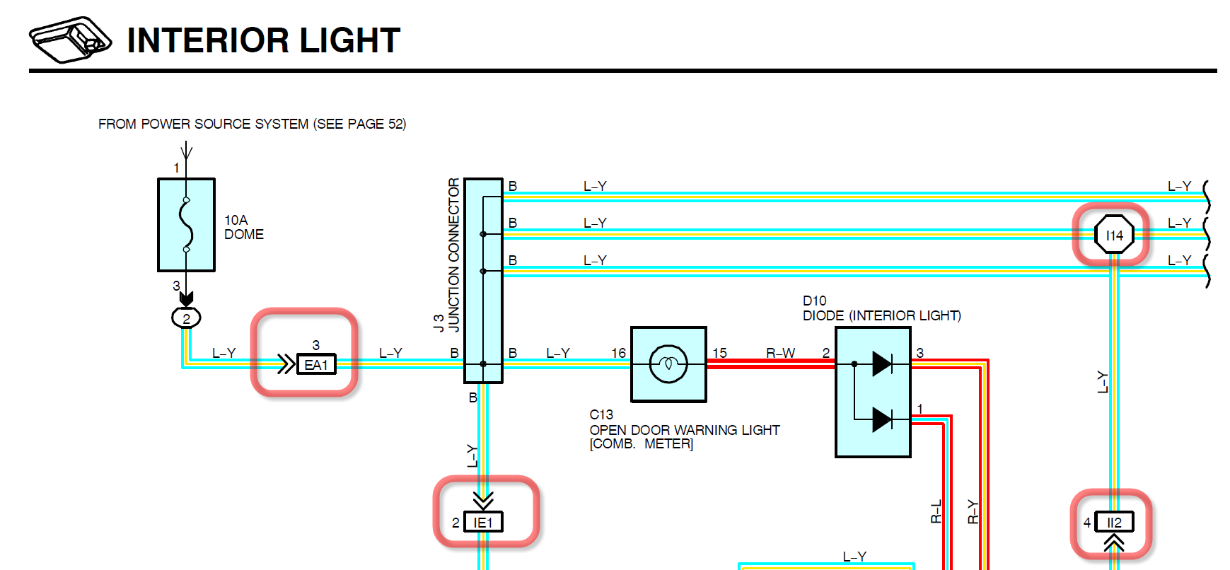

So for each and every one of those loads, you'll have to run down the harness connections from the location pages and then the specific connector housing, from the section containing that circuit. For example, from the chart, the first load is the Auto Antenna Control Switch (A21). pages 78 and 118. But you want to start with page 24, Electrical Wiring Routing, for the switch (A21):
then go to the circuit (page 78; it's actually on page 79 - this is a two page circuit diagram) :
Then you have to go to the junction pages to get those connector housing pinouts; start with the close connectors (I16 and IF1- page 32) and work outward from there:
Notice the splice points are listed in octagons and the joining connectors in rectangles. The grounds are inverted triangles; this format is continued in the circuit diagrams, too. Also, you need to look at the connectors housings at eh end of the circuit diagrams for that information, before you leave that section:

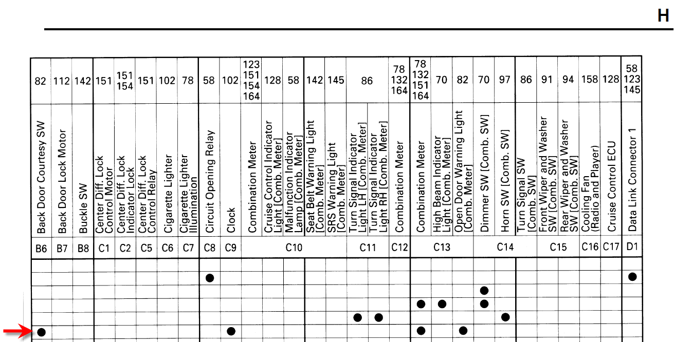

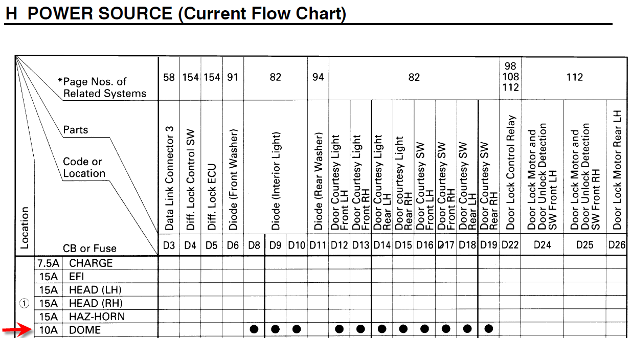

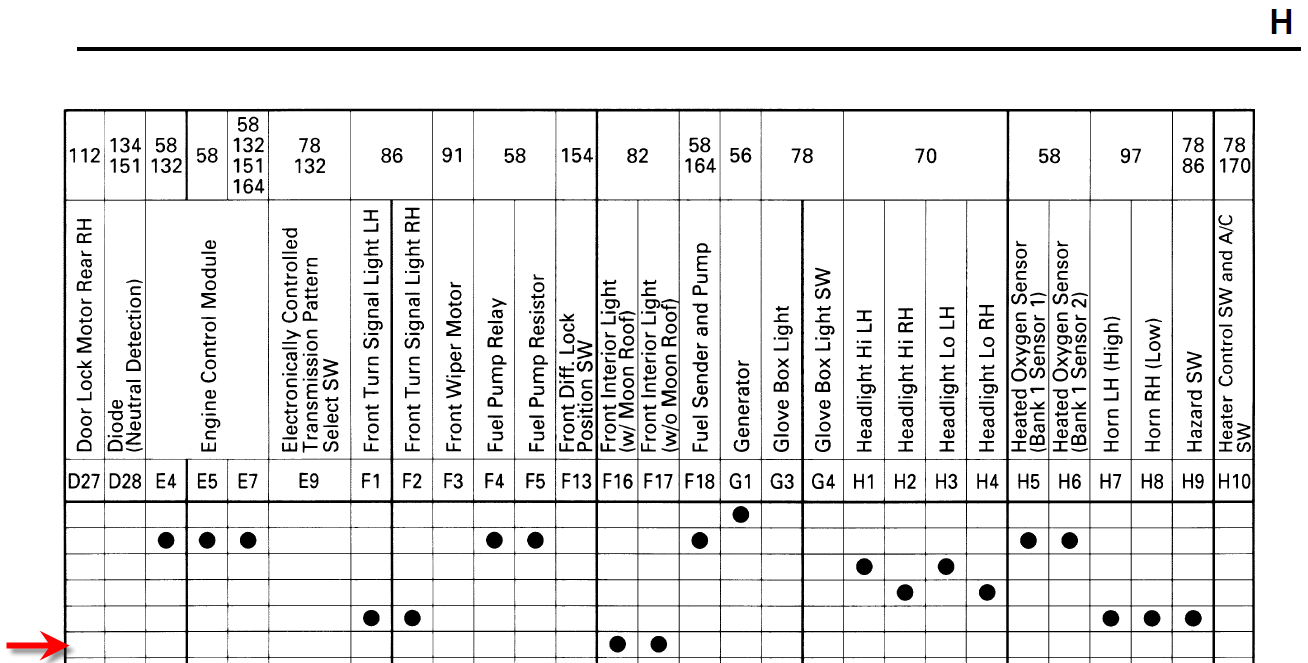

This isn't necessarily where I'd start chasing down this suspected short (I just picked the first item in the list, for convenience sake), but this is the procedure. You have to do this for each and every load in the dome fuse circuit, if you want to find the problem.
