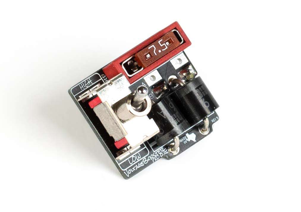

Hey Ryan, I am NOT very well versed on electrical, but am curious if what you made here is the same idea as something I added to my GX460? When I moved to an AGM on the GX I came across this voltage booster and it seems to be doing it's job, no issues over the last year or two.
Yes, same exact idea. The little device you linked just has a one or two diode option depending on the switch position. Mine is simply a single diode inline to the sense wire of the alternator. The later models like your GX actually run that sense wire through the fuse box, so you can easily add a plug and play module like that. On the older 80 series, that fuse only runs the charge warning lamp circuit, so adding a diode won't change the alternators sensed voltage and cause it to increase the charge voltage.
