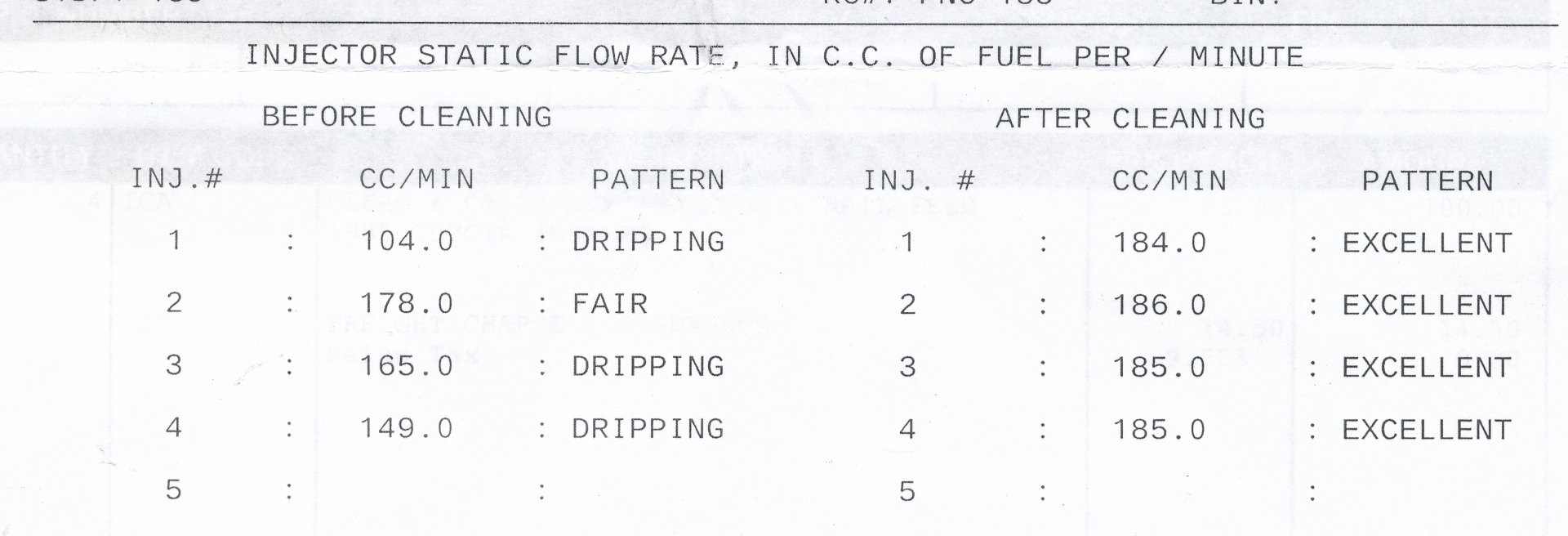

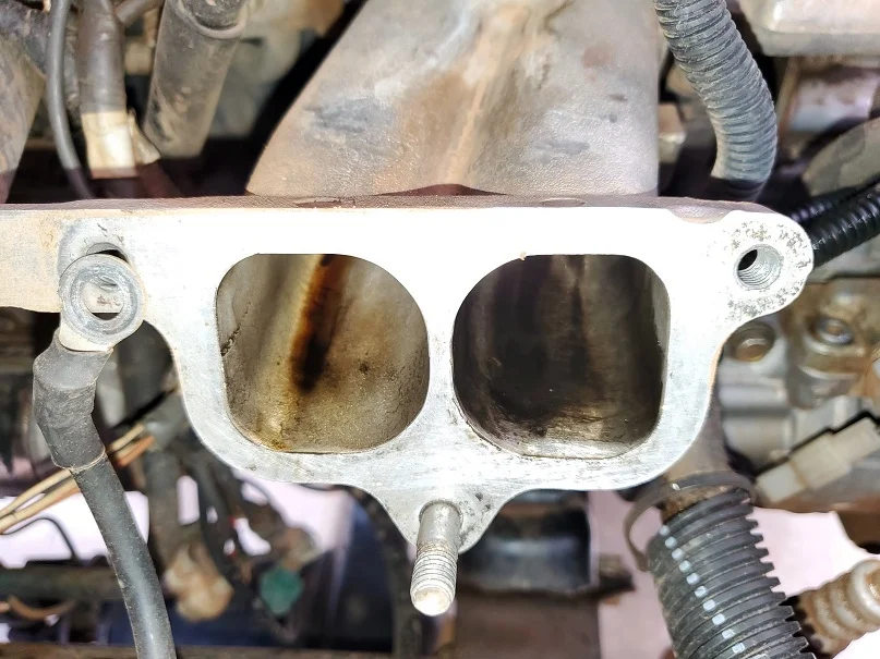

Here is a picture for you. The staining in the runners is gas. This is what lead me to get the injectors rebuilt. They would leak into the manifold over night and flood the engine making it difficult to start. Rebuilding solved the problem. I've also included the report that showed the injectors had issues.
this may not be your exact issue, but it was a game changer for me. HTH
