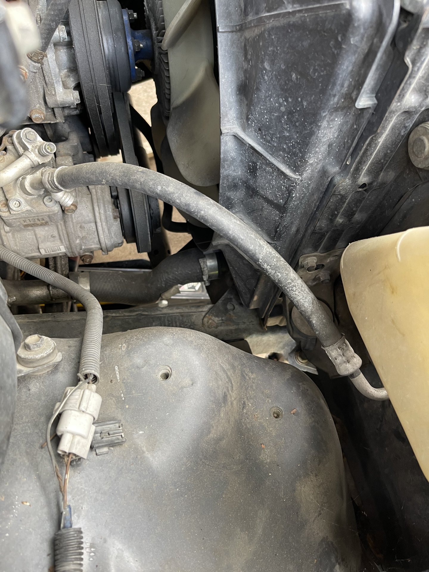

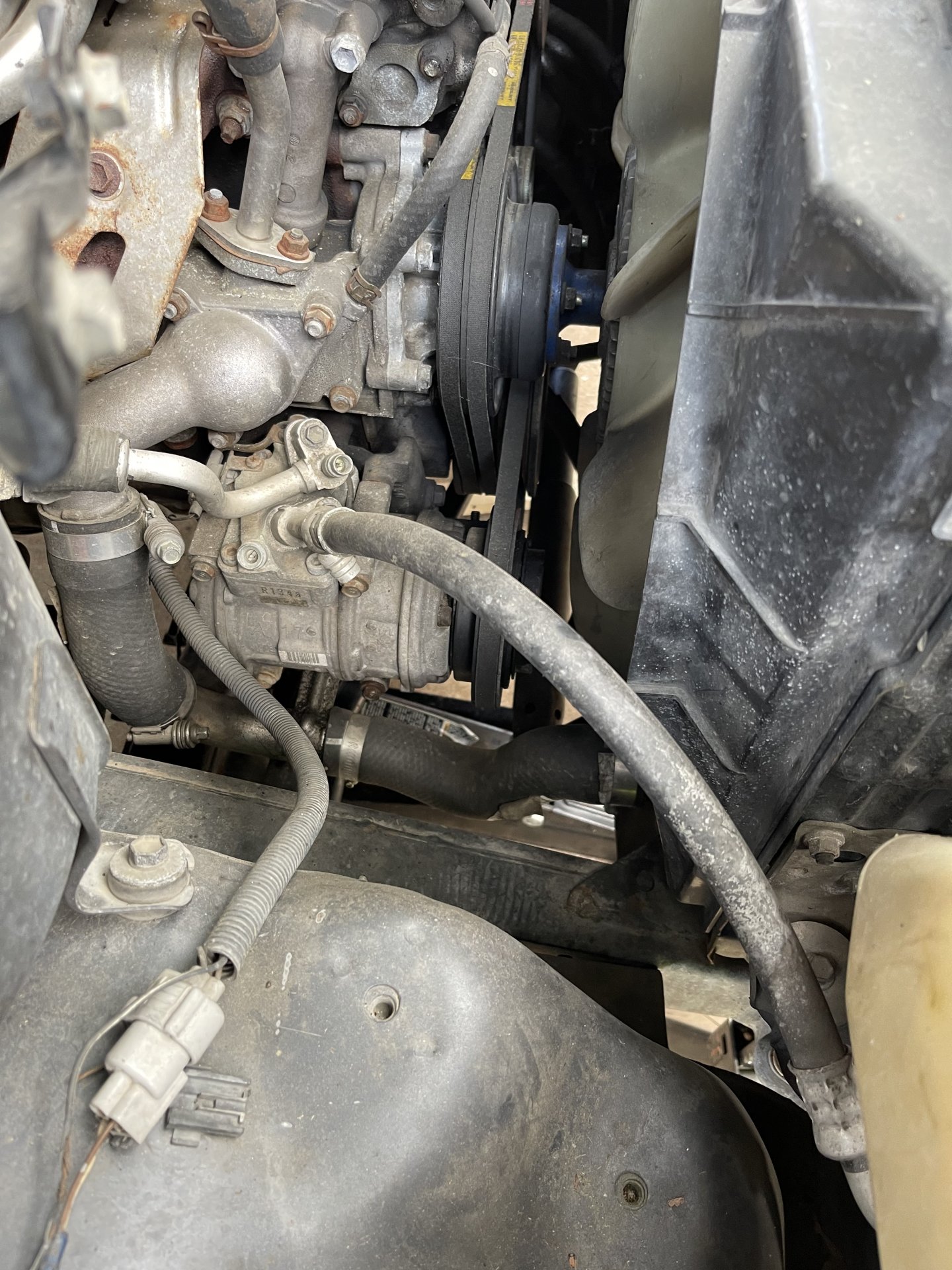

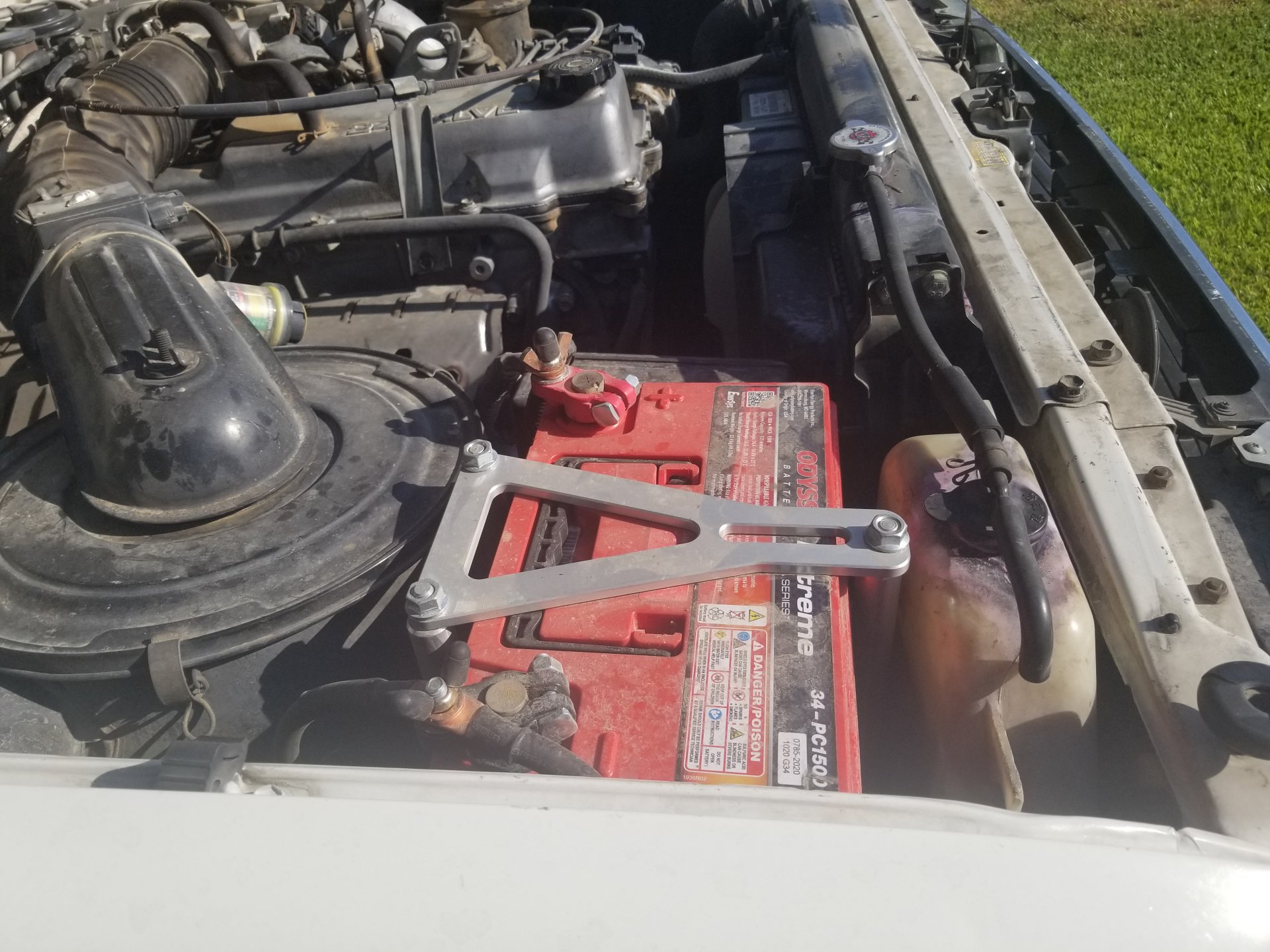

What are you kids with 1993-1994 1FZs doing with the AC hose on the passenger side? I’m pretty sure I can bend it, but I’m kinda hoping there is a more elegant solution? I’ve dealt with the resonator and PAIR hose situation with a Napa radiator hose, but this AC line is a hassle.
I’ve already searched but all I find are you speculators trying to sell your rigs overwhelming the search function with every possible keyword.
For the uninitiated, there is an AC hose that runs from the top of the compressor to the condenser on the core support. It just happens to be a touch too high for the first gen battery box to fit correctly.
pictures for visual stimulation…

it looks like they’ve just got the line pushed forward against the radiator shroud. That’s a 95 up, but the line is the same, the air box on the 1994 has a PAIR hose and resonator that get in the way as well, though there are pretty easy solutions for that part. I can live with the line pushed forward, I don’t love it, but I guess I can imagine worse. I may fiddle with it more tomorrow and see if that’s viable. Gotta do the alternator on the wife’s car first. 🙄.
I’ll post pics if I get the fit right.

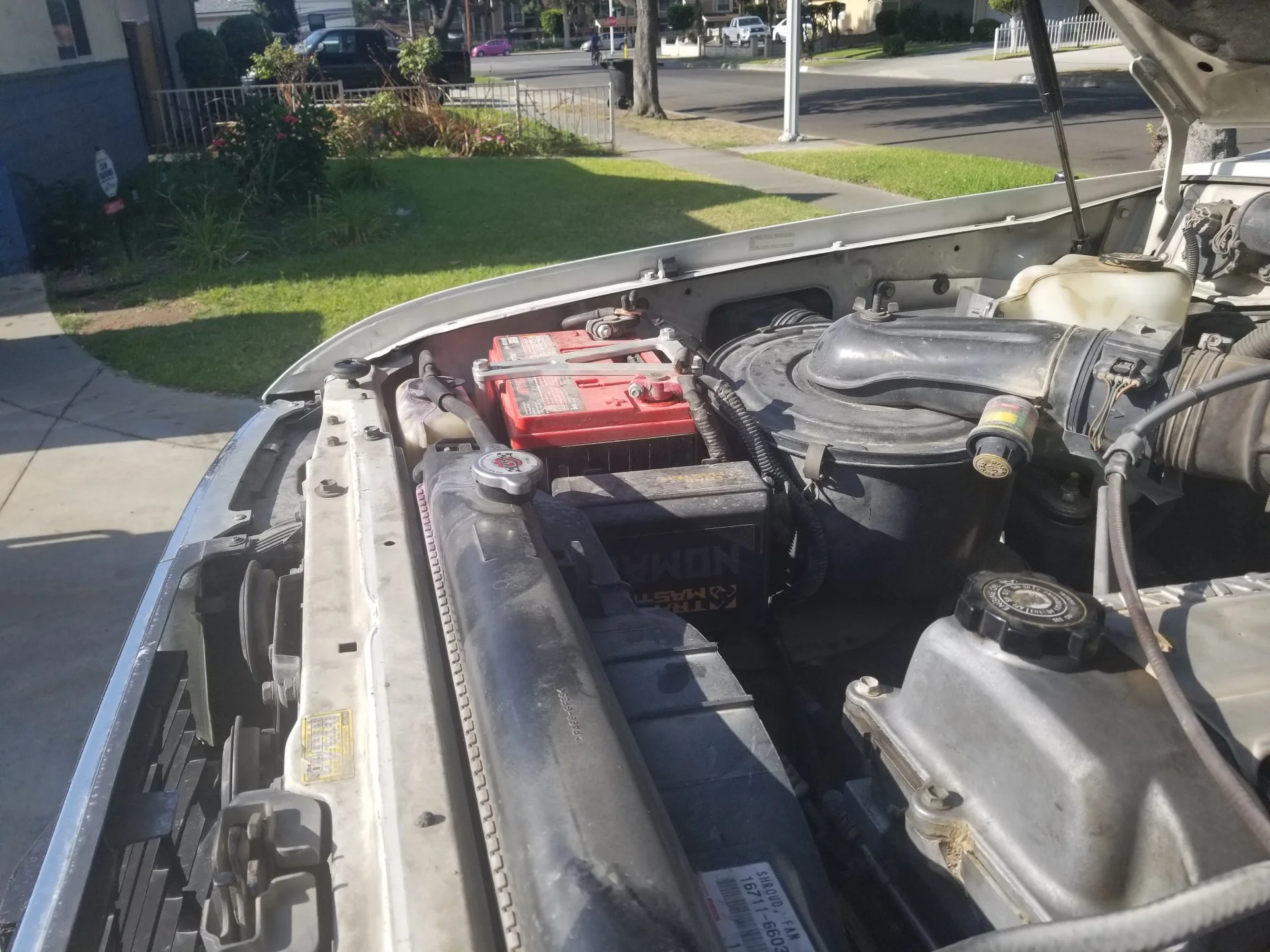

I have the Hudd Expo Kit, was the perfect solution for me.

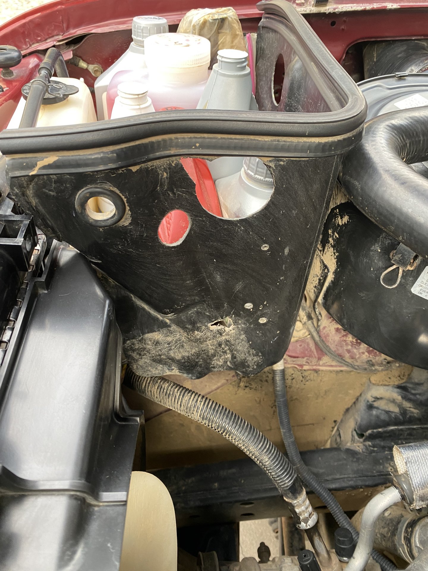

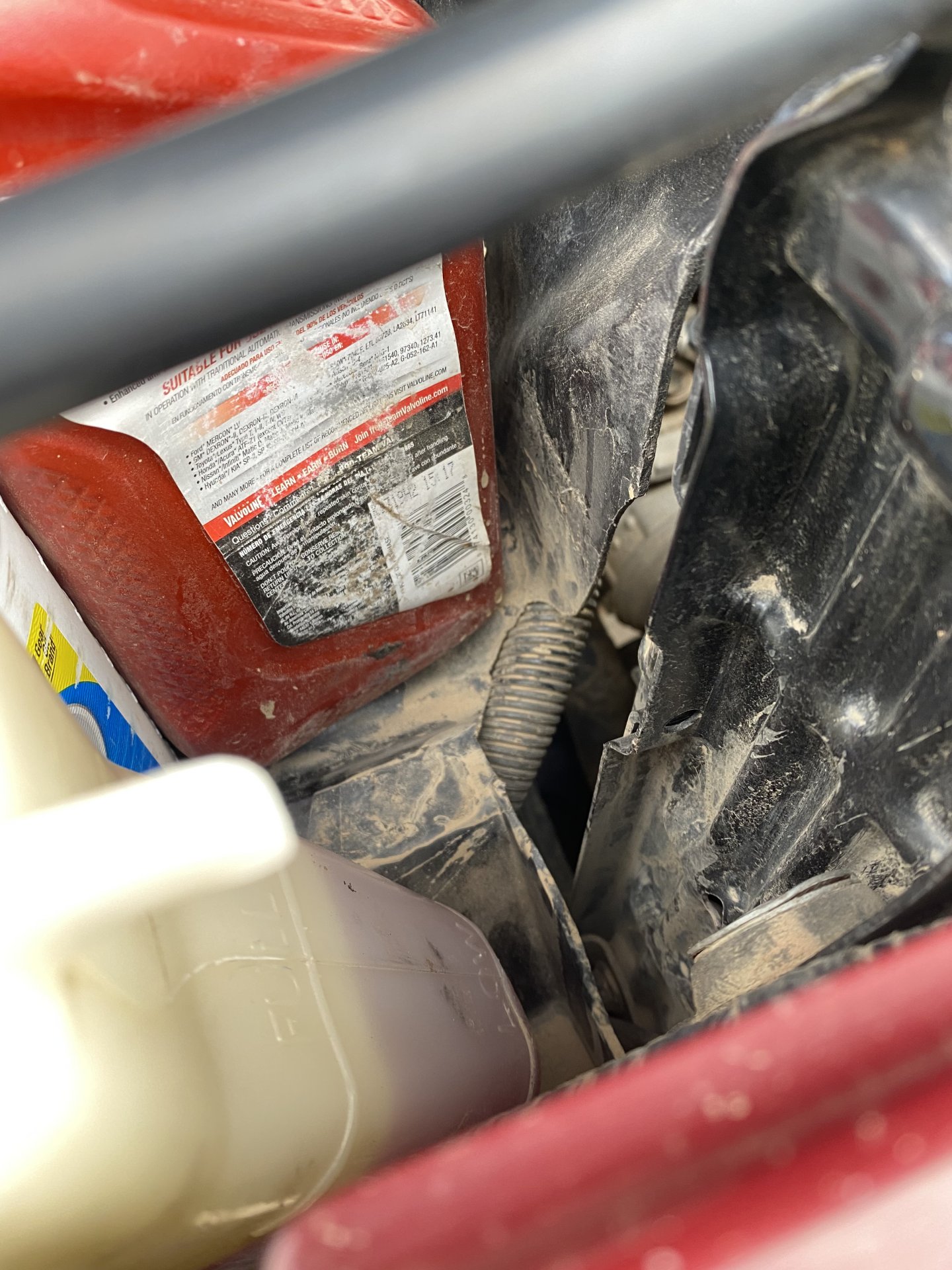

For the AC house, I pulled out the insulation behind the grill so the hose can flex.
Then just pushed it down and bolted the trimmed battery tray on top of it.
EaZy PeaZy
I have dual batteries on my '94. The AC hose wasn't an issue. I didn't even think about it.
The more difficult part was trimming the radiator fan shroud to fit without interference, like the driver's side. I cut the shroud with an oscillating tool and used epoxy and fiberglass to form the new shape. Finished with epoxy primer and it's holding up a year or two later.

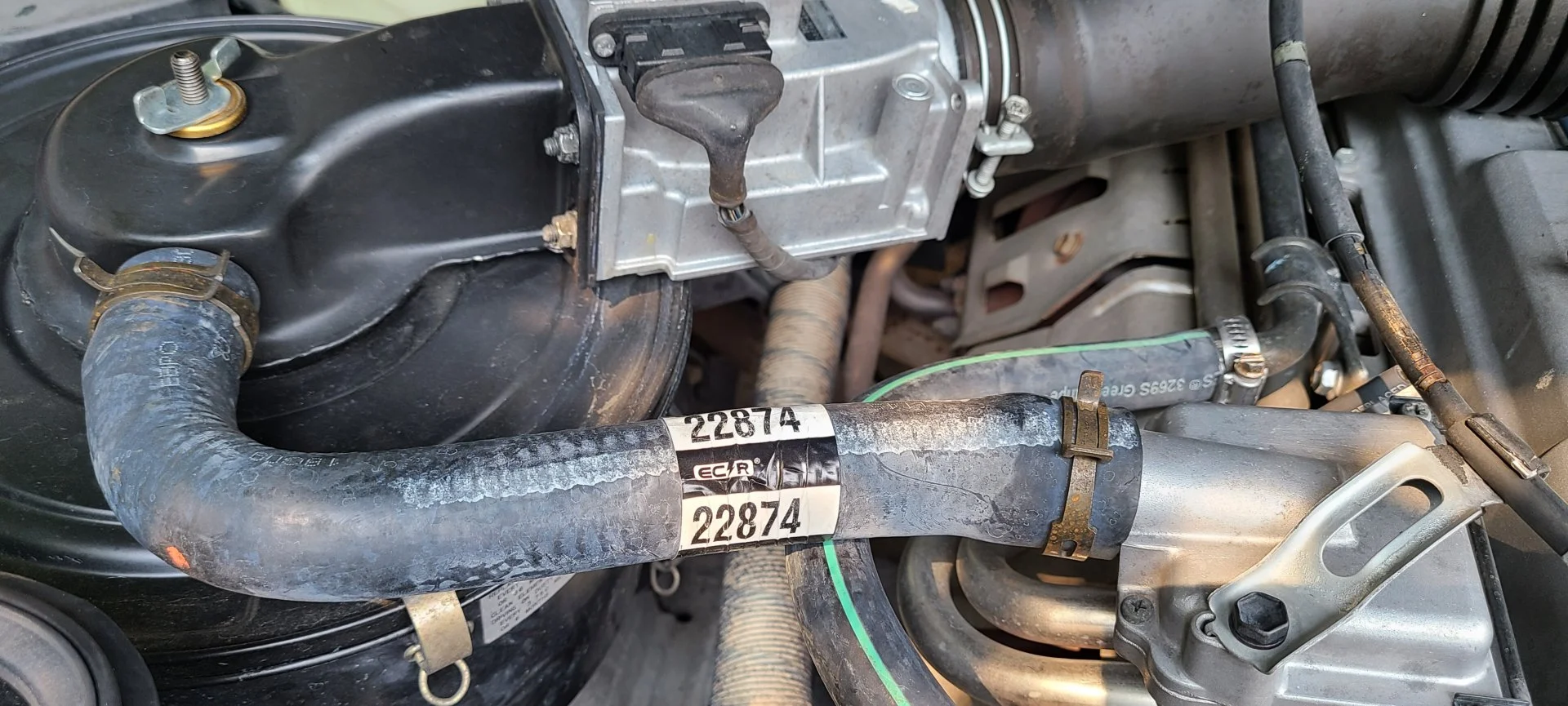

I used NAPA hose 22874 for the PAIR.
Yeah...just pushed it down out of the way. It is a stiffy, but needed only an inch or so of deflection.

Lots and lots of kits out there, and no problem with that hose that I’ve heard of. Like others have said, a little flexing and bolting down the tray and all is well.

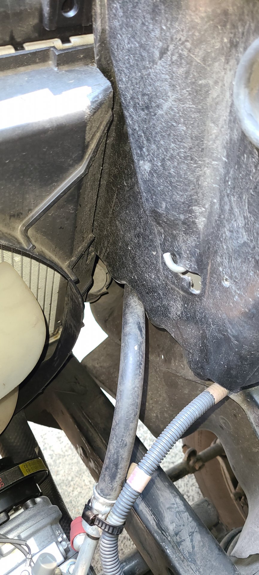

I cut a bit more out of my box and added loom around the hose. No problems
Strange. Mine was not a issue putting in the 2nd batt box. I think it just all fits on my 94.
