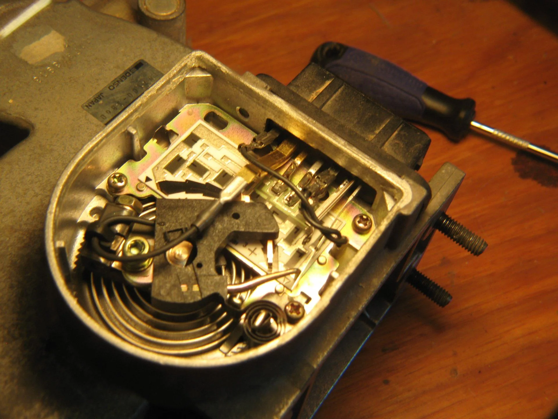

If it's rough at idle it might be the long lever that is attached to the clock type mechanism. I took the plastic cover off and resoldered what I pulled apart.and also bent the long slender metal arm so that it makes good contact. I'm showing a CEL 24 code which is the air temp sensor. Other than the light, the cruiser runs and drives better than before and idles perfect. Here's an internal pic of mine so you can see how it looks.
