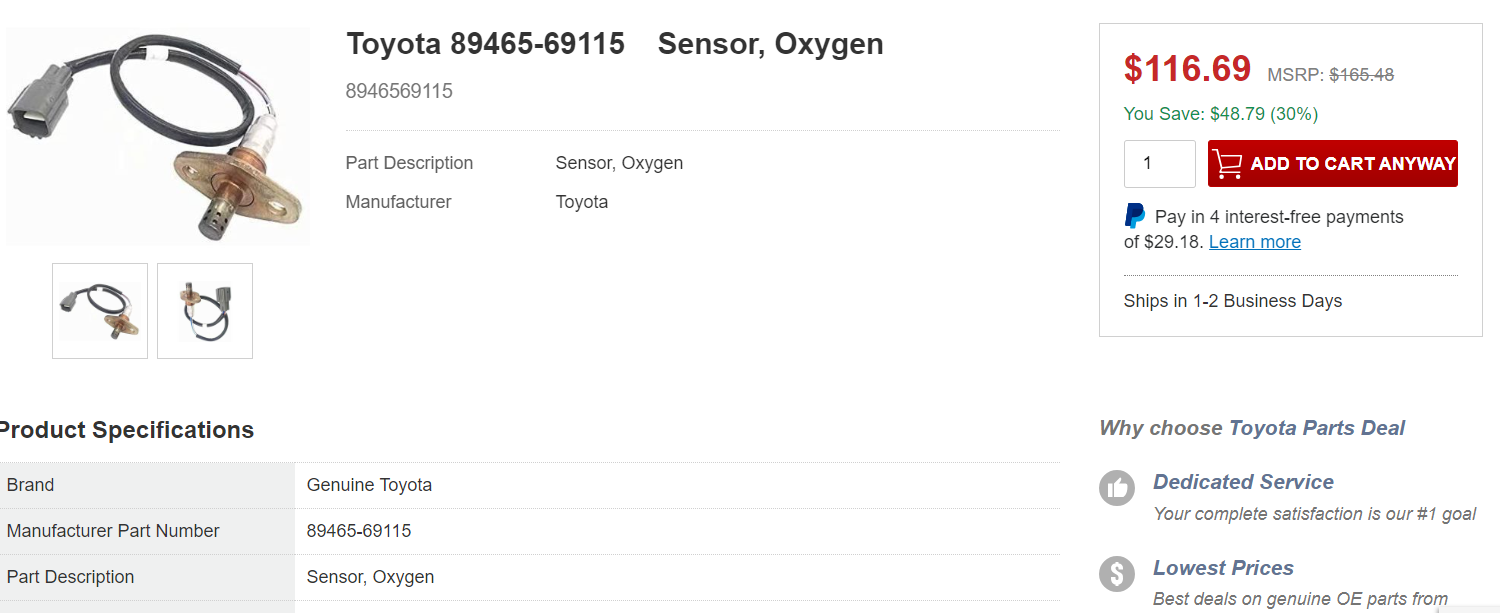

water damage to connectors I I installed two TOYODA 89465-69115 at the PAIR location works grate, left the old O2 sensors as plugs in the original place. :clap:

To clarify, 93-94 80's used two different 02 sensors, but the only difference was the length of the wiring. This one is still available from Toyota and it can be used for both ( I am guessing it has the longer wiring). So whoever told you they were NLA was only half right, and you can just get two of these if you want to stay with OEM.
At least that is my understanding. And why I now have two of these in parts collection.
