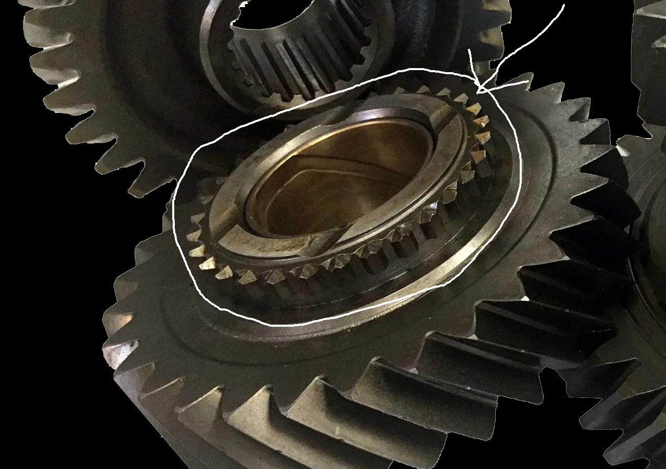

I have, I was watching OTRAAM's Terrain Tamer Gear Install video last night afterwards trying to see where the hell it was grinding. I understand (for the most part) how the T-case works. Is the locking collar what "selects" a gear? And if that collar and the teeth it meshes with are roasted, then that t-case essentially can't stay in gear, correct?

It was the sleeve trying to engage moving gears and bouncing off the tips of the teeth as well as the parking pawl trying to engage a freewheeling shaft.
They are designed to take a few hits like that, but not engage.

I also found another video of a guy showing a gear set from a Civic that had been grinding so much the base teeth were rounded and wouldn't allow the gear to be engaged. All this to say I have a decent understanding of where the grinding happened.

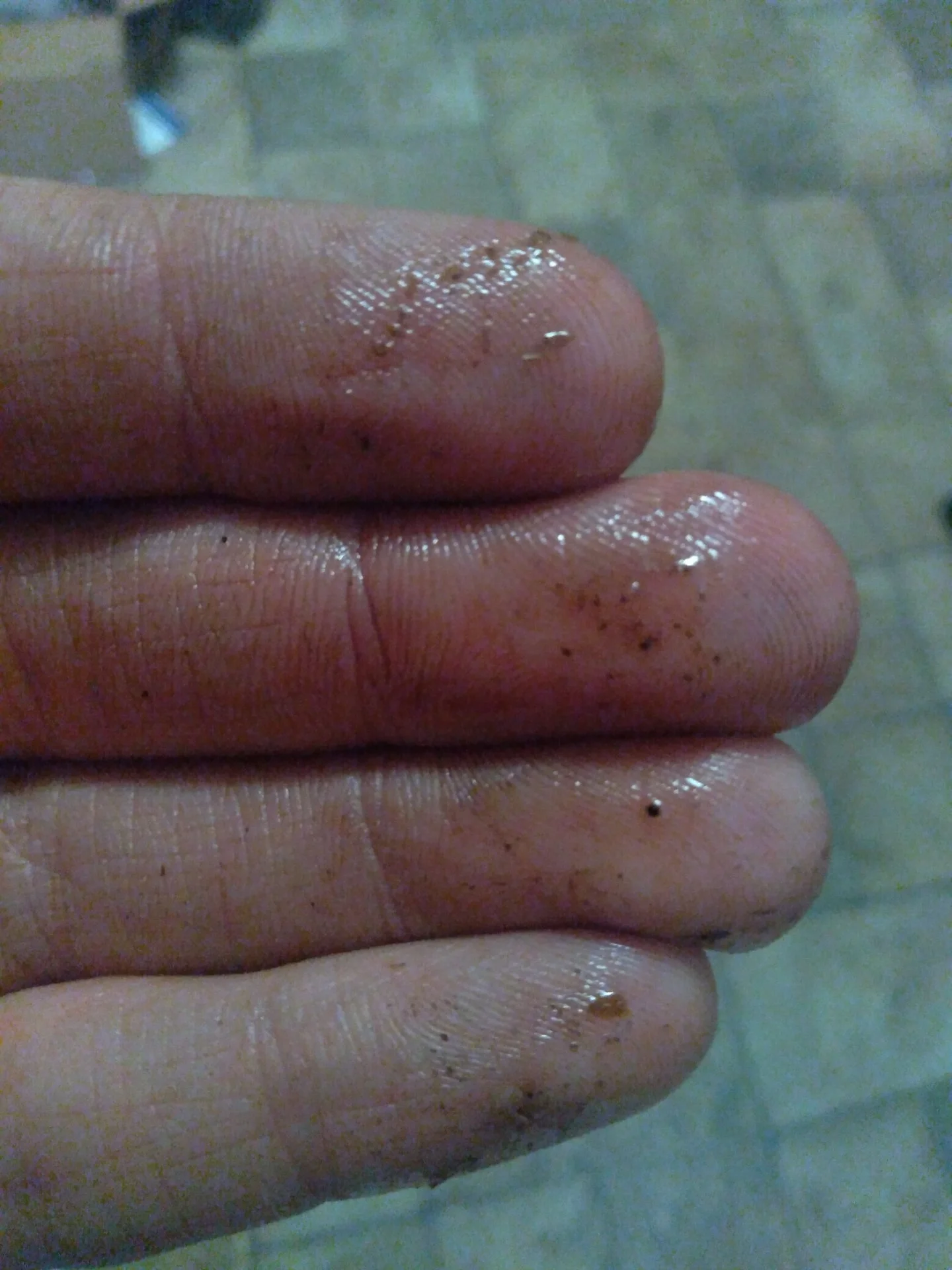

Changed and inspected the t-case oil. Clean and glitter free. Barbie would be disappointed. The drain plug magnet was unremarkable, oil in pan was clean to the eye. Did some swipes with my finger to see if I could catch anything. Even with a flashlight, nothing I could see. I wiped the last bit of oil after pouring the pan into a holding container and managed to get some debris. (See pic). The drain pan wasn't spotless before this so some of that might just be old crud. I think we're clear, no?

Looks good, no worries.
