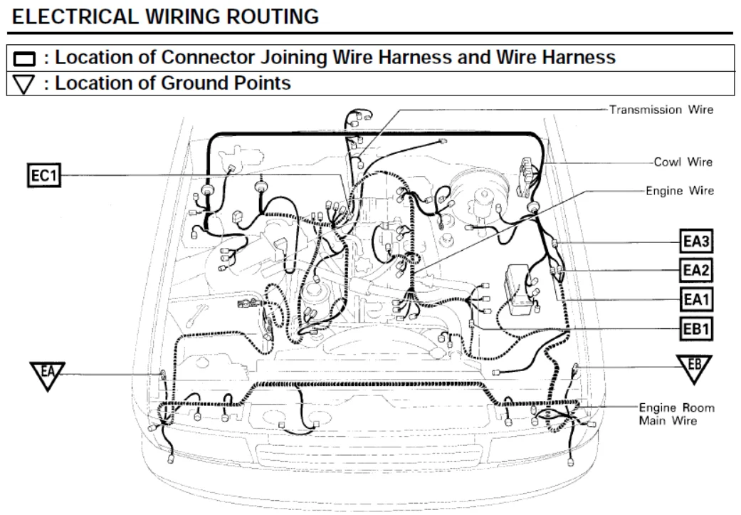

Nothing you replaced would have effected the CEL, although I wonder what ignition coil you used as the OEM one has been NLA for the last 15 years. I suggest that you retrace your steps, because clearly something is not right. I would be looking closely at connectors in the engine bay, specifically EB1 which runs the show for the ECU.
Checked over all connections and can't seem to find anything wrong but it's hard to tell when the wires are from 1992. There are some scorch marks on the plug in for the EFI relay. Makes me wonder if the wires underneath are toast. Would no EFI relay cause no CEL on start up? Also just noticed the wires going to the cold start injector sensor are bad and showing copper. I doubt that could be the source though. New ignition coil is a Delphi btw.

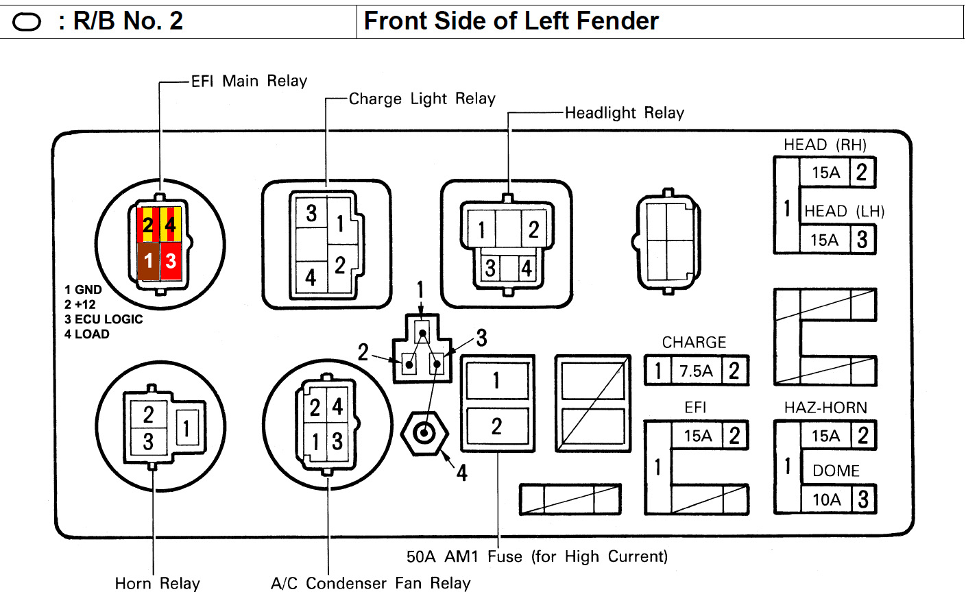

Below is a layout of the relay box on the left fender.
Sorry I haven't gotten around to trying this yet it's been super hectic at work. Should have an answer for you after. I did see that the 50amp fuse was blown. I replaced it and now I have spark but it only sputters. I checked the wires and they all go to the corresponding number on the distributor. The plugs are pre gapped at .044.
So checked slot 2 and had power and then 3 on crank and had power. Checked the EFI fuse and it was fine. So I checked the codes with a jumper. Now in the past I always got a code for O2 sensor even though it was brand new and new wiring now the check engine just flashes meaning nothing is wrong in the system.....I'm at a loss.
I'm trying to help my son-in-law who is having trouble with his EFI relay. In the fuse box the socket by connector 4 has melted slightly at some point in the past. The is batter voltage to #2 and #4 is showing .5 volts. It this normal? The relay seems to get quite hot and he finds that if he removes it while at work and re-installs it will start up. How difficult is it to replace either the EFI socket or move the connectors to one of the unused sockets, in his case the A/C condenser Fan Relay or the blank on to the right of the headlight relay? Does the yellow insert itself come out or can the individual female sockets be removed? How is the best way to access the back side of the fuse/relay box? Admin-let me know if I should start a new thread.
Edit: There is battery voltage to #2
Pins 2 and 4 are the relay closure contacts. Without the relay in place and energized you should see almost nothing on pin 4.
All pins are removable, and the Toyota part numbers are in this thread above.
EFI relays typically run very hot. However, if you have bad contacts that will exasperate the issue.
Thanks. So the .5 volts on pin 4 is a normal reading?
I checked those part numbers. It looks like they are designed to splice onto existing wires in the harness. How is the best way to access the back side of the relay/fuse box? We can get the box loose and the backing plate off but there is not enough service loop in the harness to get to the back side. It looks like either removing the bracket between the fuse box and engine and/or the washer tank will be necessary.
We are going to try electronic cleaner with the contacts and see if that helps.
