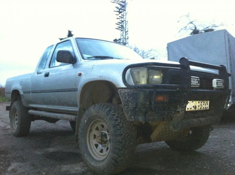

Hi guys,
i`m pascal,I`m 18 and i`m from Germany. I have a 1992 Toyota Hilux xtra Cab and i want a Flatbed. Can you tell what are the most important things when i`m going to build a Flatbed.
And can you post some pictures of your Beds that i can get some ideas.
greetings from germany
