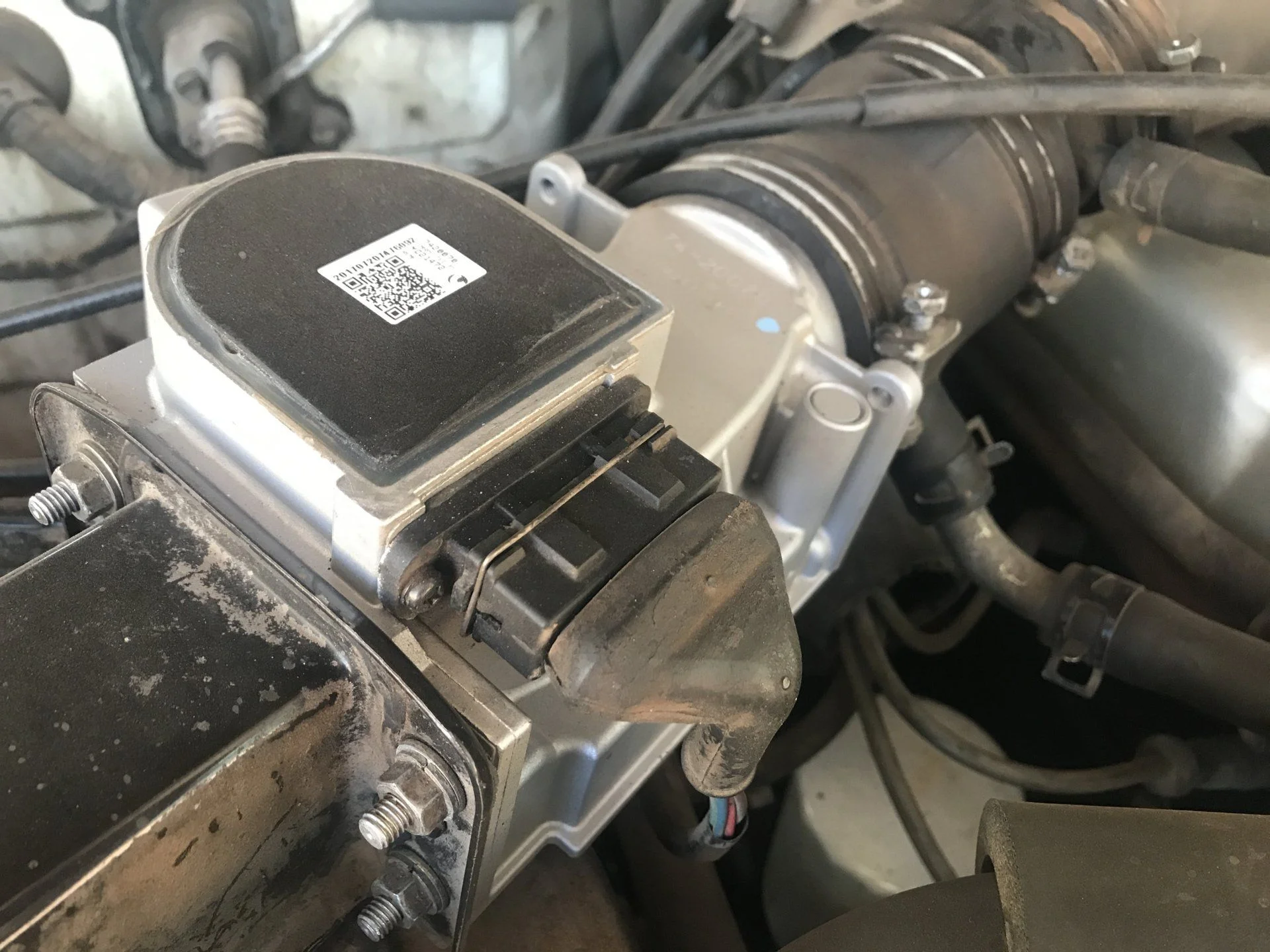

Well it showed up a day earlier so I threw it in. Holy crap it actually did make a difference! I honestly thought it would run exactly the same but it really does run noticeably (a little bit) stronger than before! Nice little boost for the money.

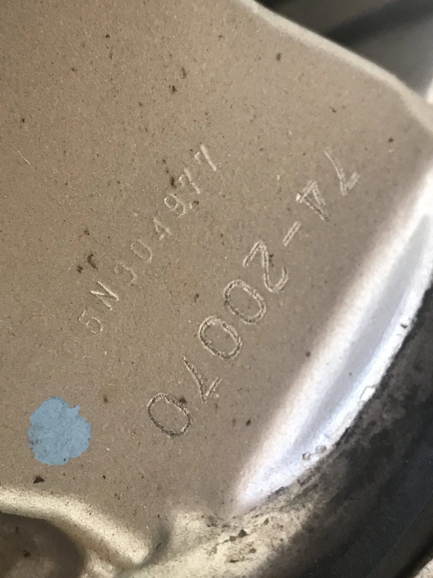

As I can see on amazon the Cardone 74-20070 fits only on these part numbers:
22250-07020, 22250-42080, 22250-62040, 22250-07020, 22250-62040
