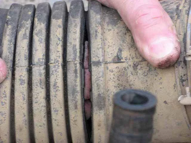

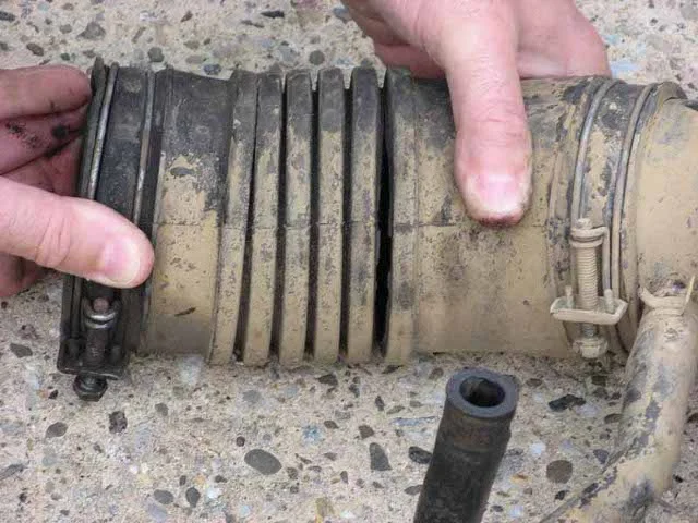

I would be checking the large rubber plenum downstream of the AFM (air flow meter as Toyota calls it). Any tear in that plenum will cause unmetered air to enter the system causing all sorts of problems.

Did you check the underside of the bellows?
