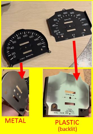

The overlay I was making was intended for metal face type (sticks on by magnetic force). A 1991 model most likely has the metal face but it appears that sometime in 1993, it went to plastic. The lighting method for the metal face is different as opposed to the plastic face also.
See example below:
See example below:

Sometimes I'm forgetful and I never checked if I still had an extra OG @FJ73Texas overlay. As previously stated, you would need the metal speedo face for it to work. The price would be significantly cheaper than the Japan Auction for the really nice OEM metal gauge... just pay shipping and it's yours, that is if I still have one. With the savings you can buy a lot of beer and become forgetful too 🤣 :beer: Mine does not have the T-Belt warning light cut out though...

Yes I would definitely be interested in the magnetic one! How would I know if mine is metal, any easy way to tell through the cover?
Not sure when the change took place from metal to plastic. One number bandied about is 1993, so you "might" be good for the overlay. Best way to tell is to take it apart, which isn't too hard to do, but probably not what you want to do until you have the overlay in hand. As I said, I don't have the TBelt feature on mine, so you will have to modify it for the light. If you don't hear from me in a day or so shoot me a PM for a reminder.
