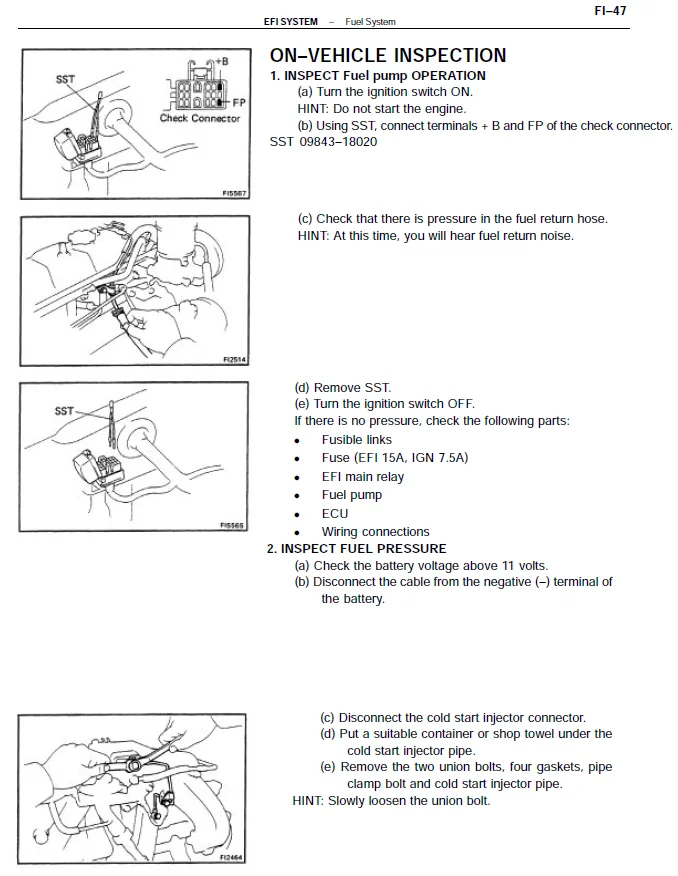

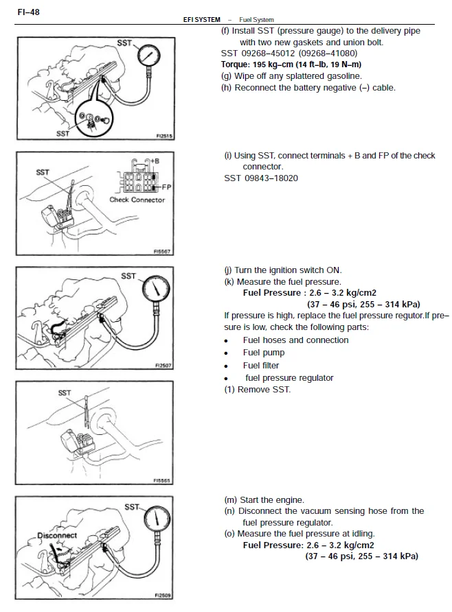

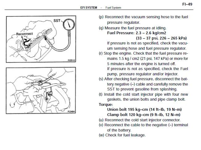

Hard to say. I would test fuel pressure. Pages FI-47 to FI-49 in the FSM. You should probably replace the inline fuel filter as it's likely original and this vehicle has an unknown history. OEM part # 23300-69035.
