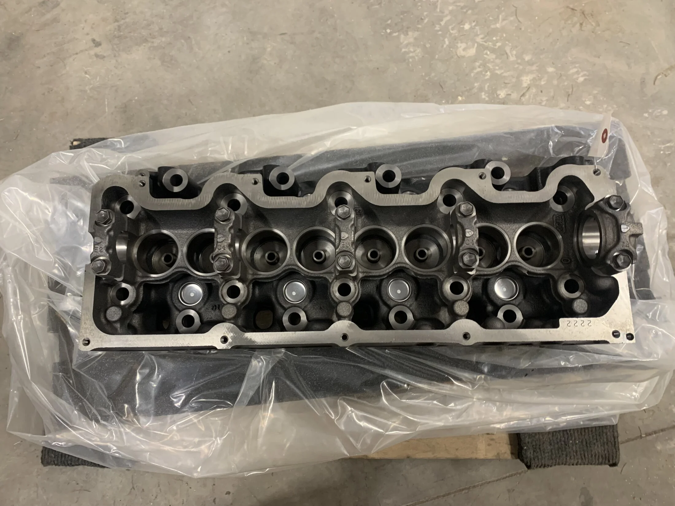

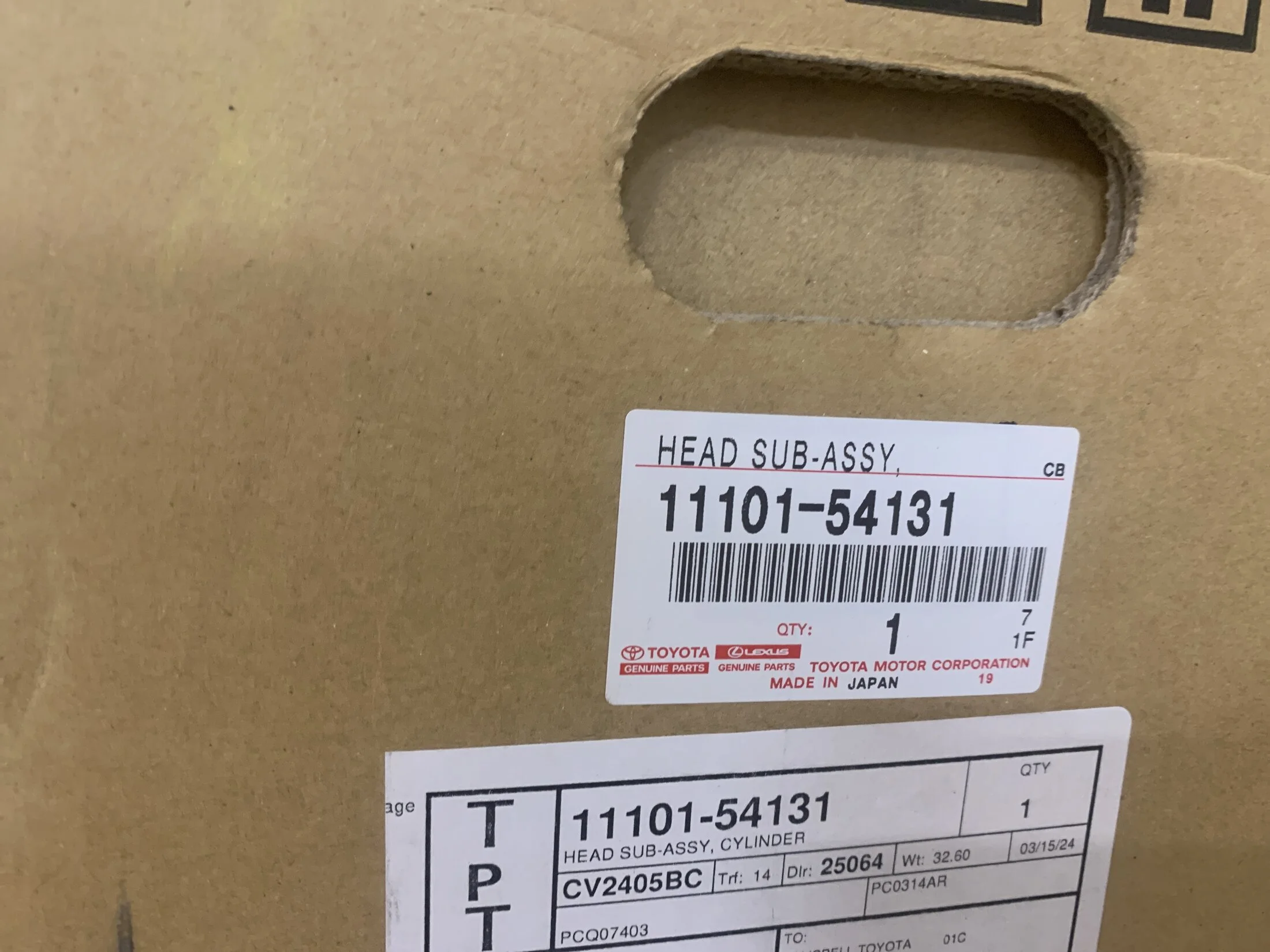

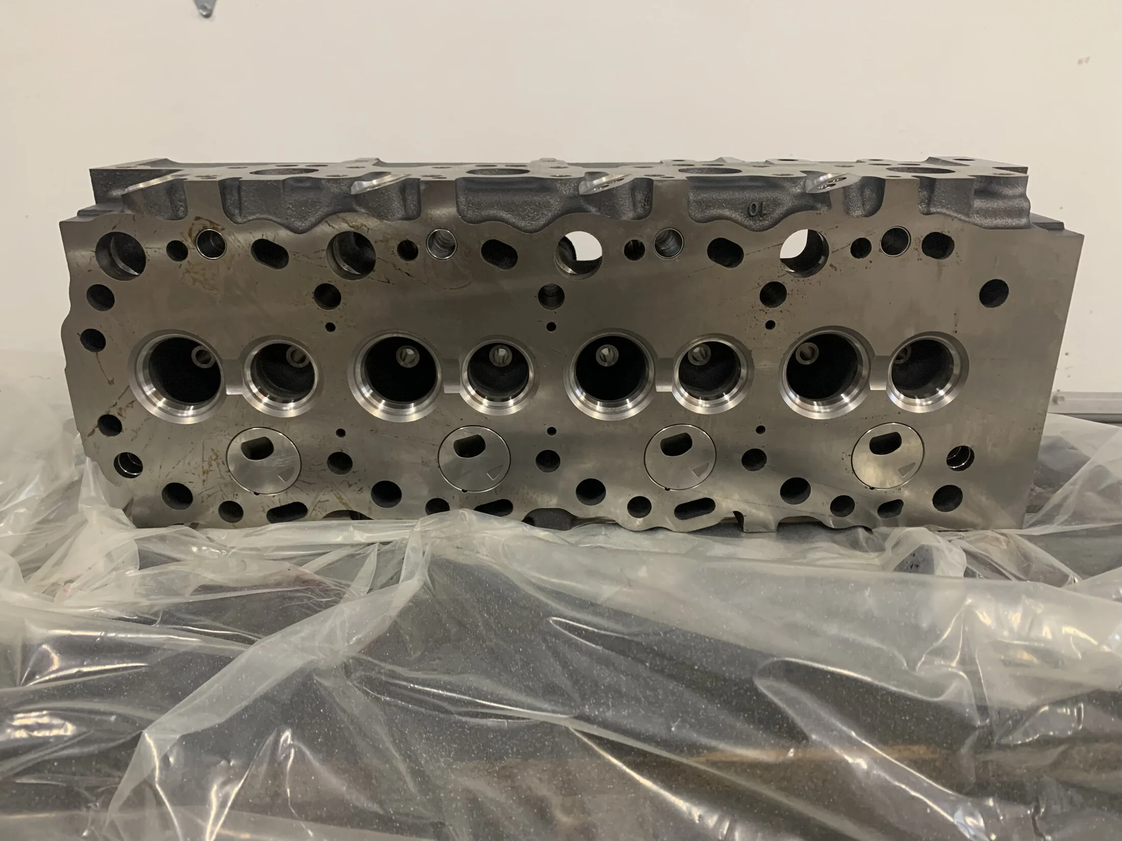

I just sold one, they’re still available
Cool! Finally get to see the real thing!
How much are you selling these heads for?
What would shipping be to NY 12919 (Champlain, N.Y.)

Hey George, Emailed you back. Thanks
