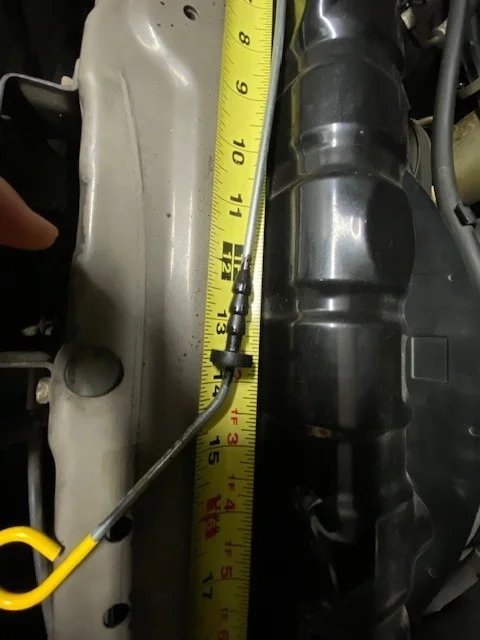

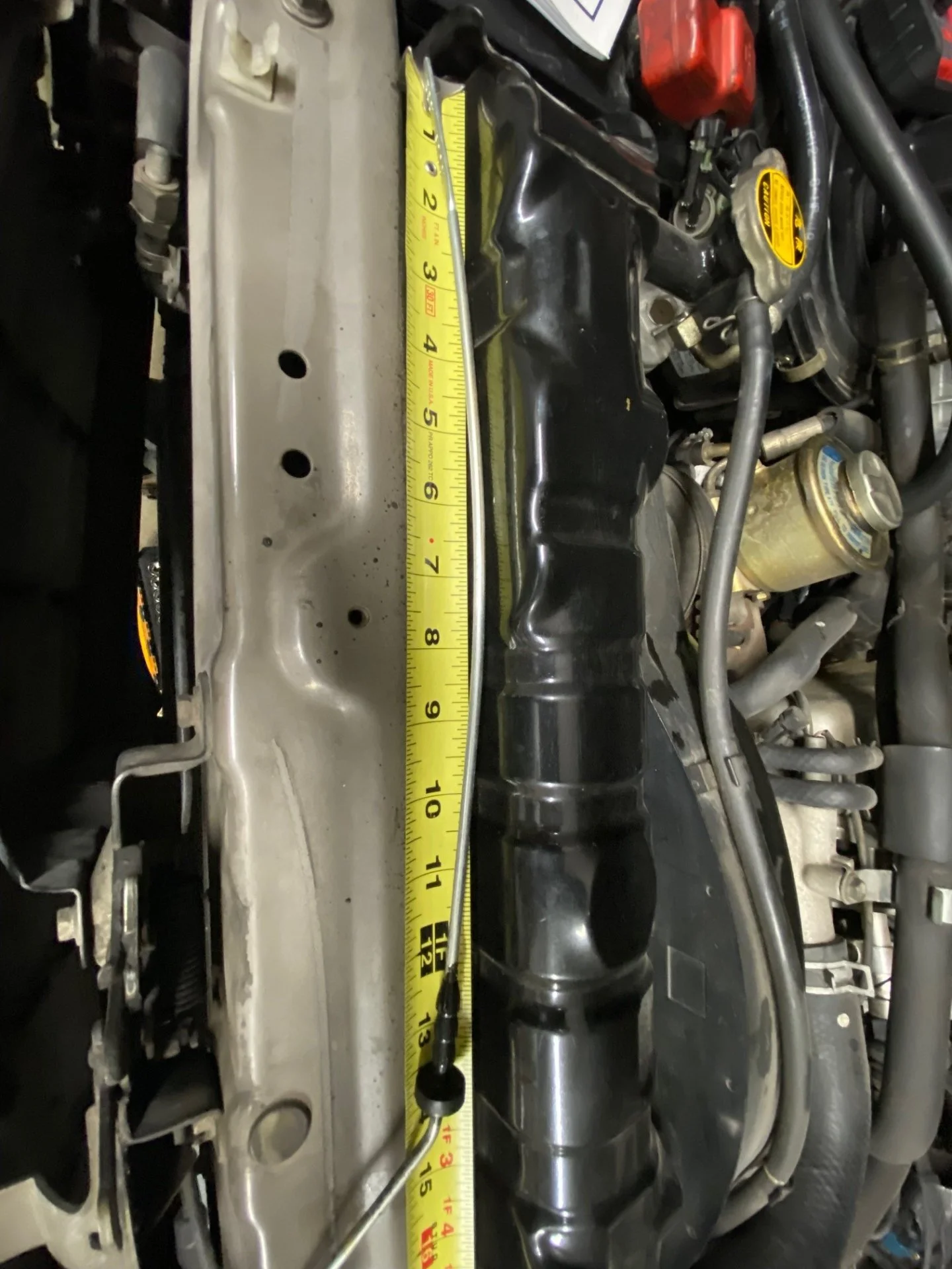

I recently inherited a FJ62. I had all the fluids changed at the dealer and it pretty much sat for the next 6 months. When I checked the oil this morning it was way past full, so I assumed they over filled it. I dumped all the oil and pulled the filter then did a refill. At 7 quarts it is just a tad over the full line. The manual shows 8.2 quarts capacity but the dipstick show full at 7 quarts... So now I am wondering if somehow the wrong dipstick got got put in it somewhere along the way. The current dipstick is 13.5" from the bottom tip of the stick to the bottom of the rubber.
Can anyone with an FJ62 verify this is the correct length dipstick?

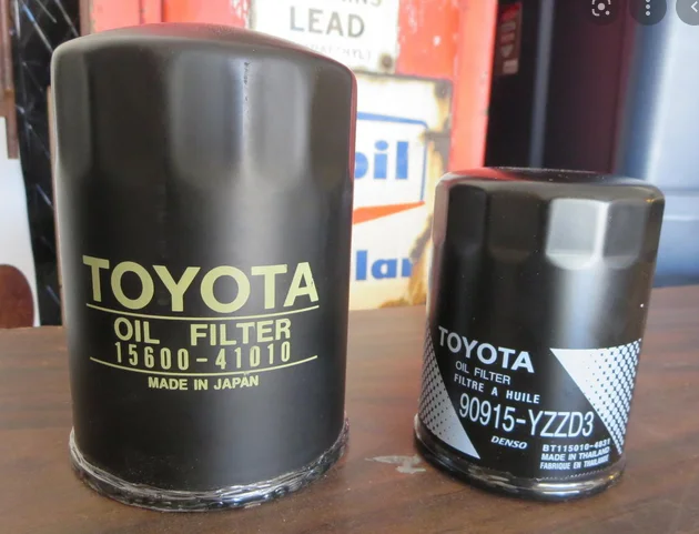

What size oil filter does it have? If you search for the 60 series forum for oil filter threads you will see there is a newer replacement filter that is much smaller (physically) than the old one. This may result in a 1/2 quart difference. I found this picture on interweb as an example. It may not be the exact same filters used by the land cruiser but is does demonstrate the difference.

@2mbb is spot on correct here about the filter topic , :) Good work brother for making folks aware of this TOYOTA debocial ...
- the
STUPID smaller OEM 90915-YZZD3 filter TOYOTA superseded to after disc. / NLA the correct larger DENSO / NipponDenso made Canister size spec.
filter 15600-41040 , will and does cause a overall capacity related issue and a mis-reading on the dipstick , all owner operators must now calculate and take
into acct.
- when regular 3000K oil replacement should occur , no matter if we are running full syntetic or conventical , its all about the service interval of
the filter media no matter the driving conditions
That would never had occurred to me… the one in there now is 3-1/2” diameter x 5” tall… Thanks for the post!!
Typically the distance between the Low and High line on the dipstick = 1 quart.
Is there a part number on the dip stick? It might be down at the "business end". The correct part number for the FJ62 is 15301-60031.

the difference in capacity between the 41010 and the YZZD3 is .68 qts ......... :cool:
- the YZZD3 has a 1 piece Block of Porus Media FOAM type mystery substance as a filter
- the 41010 has single layer special sheet of special type of paper type 1 piece traditional media , that has served the entire Land Cruiser community WELL since
it's introduction im 3/63 till the 1FZ-FE days when the 2UZ-FE was introduced and spec'd the YZZD3 here in the USA ..........
