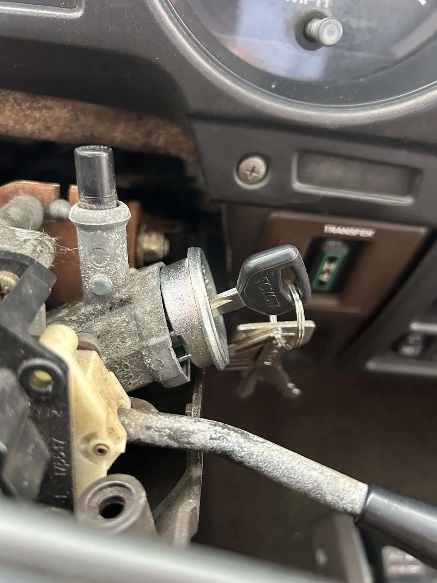

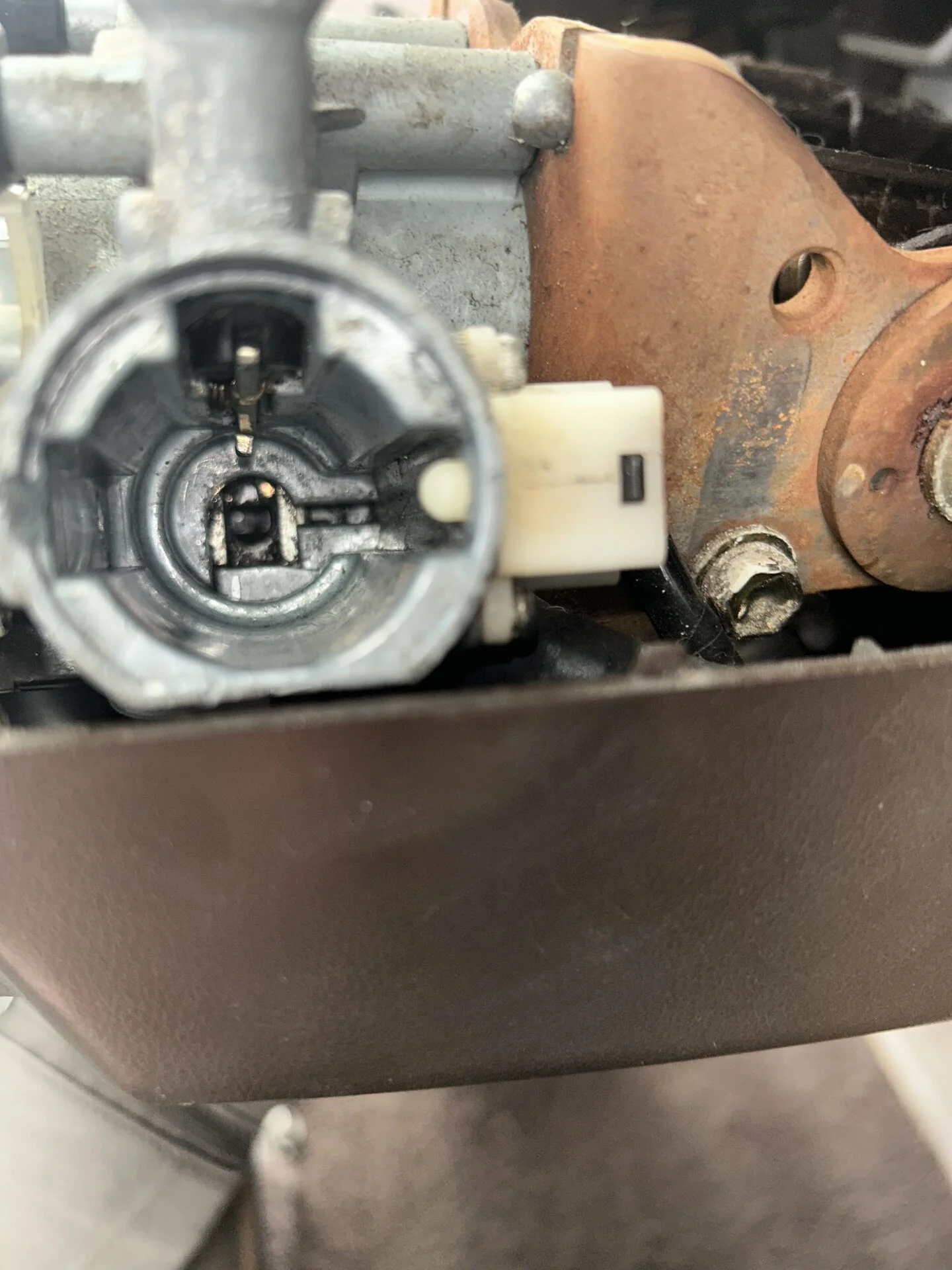

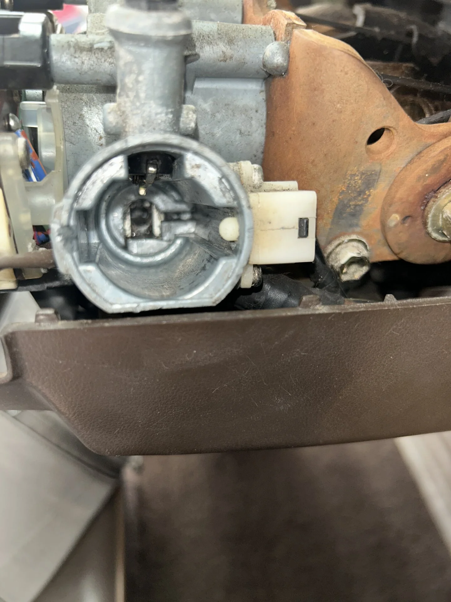

Trying to replace the key ignition switch but for some reason the new switch will not go in the last like inch….very frustrating. May have to just replace the barrel but would love to exhaust all other options before that. Thank you in advance.

Yes I have the turned to the ACC position so the little button on the side will go in but the switch gets stuck about an inch from being fully installed….very unsure what could be blocking it.
View attachment 3461457Trying to replace the key ignition switch but for some reason the new switch will not go in the last like inch….very frustrating. May have to just replace the barrel but would love to exhaust all other options before that. Thank you in advance.

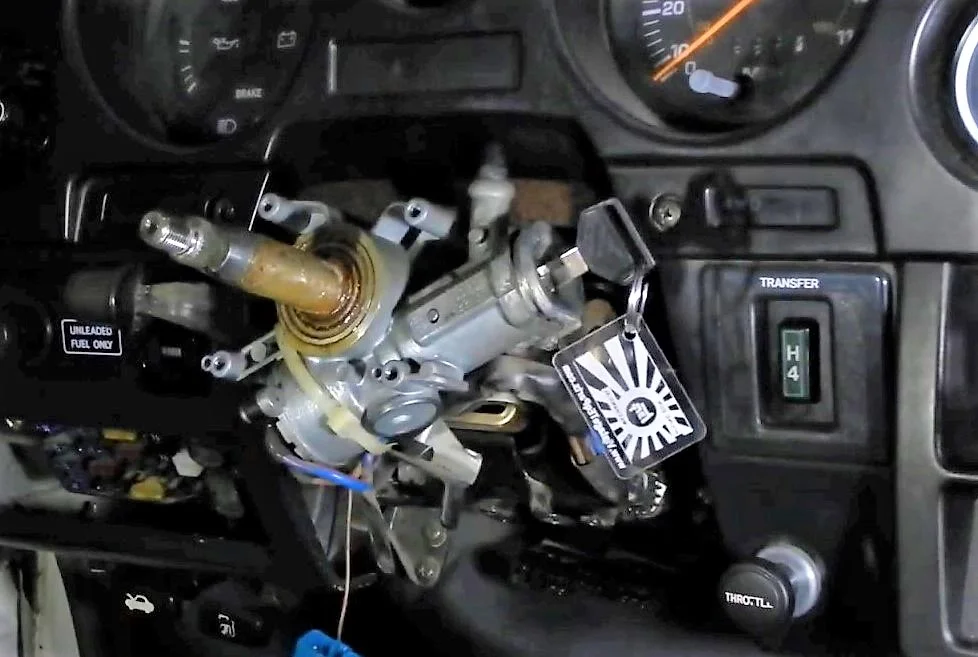

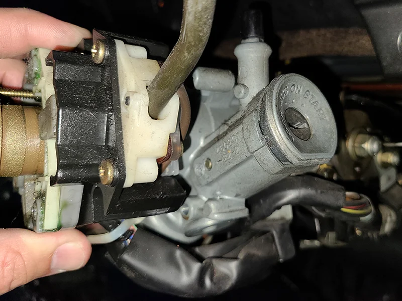

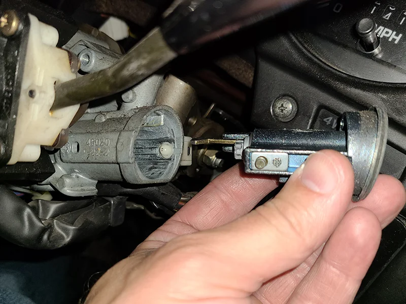

- combo switch has to come off and swing out of the way on a FJ62

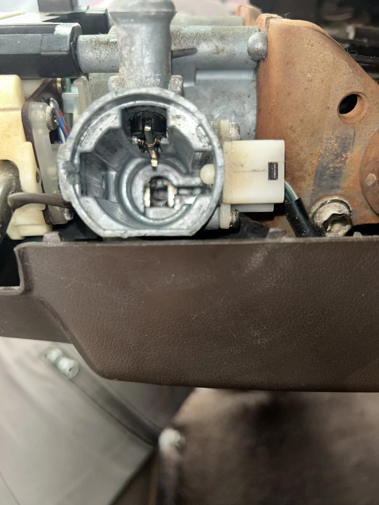

- you have cracked the cylinder body and receiver too a bit

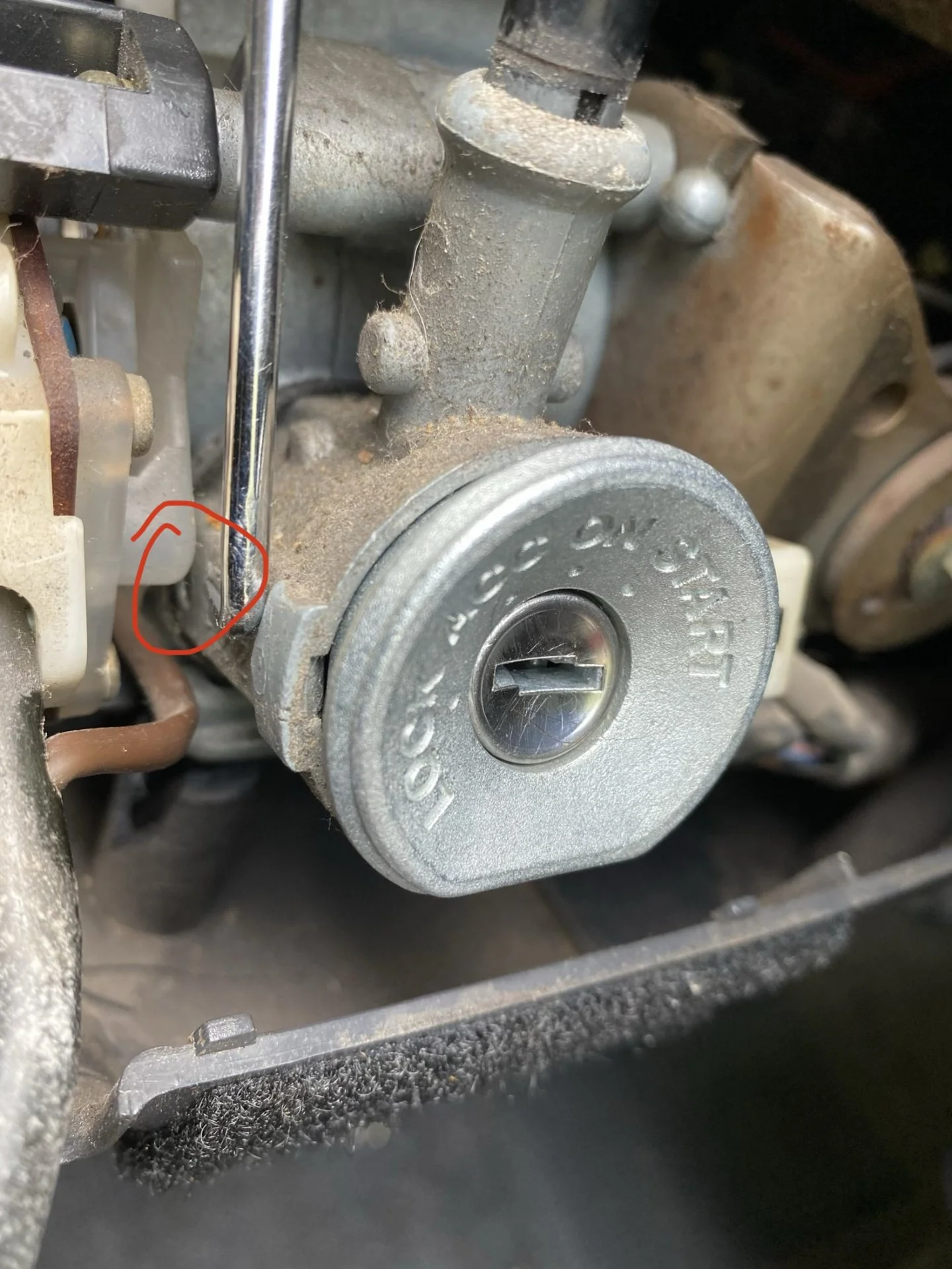

- KEY MUST BE IN the ACC position to extract it or INSTALL it .....fyi
- see my TECH. PICS below :
