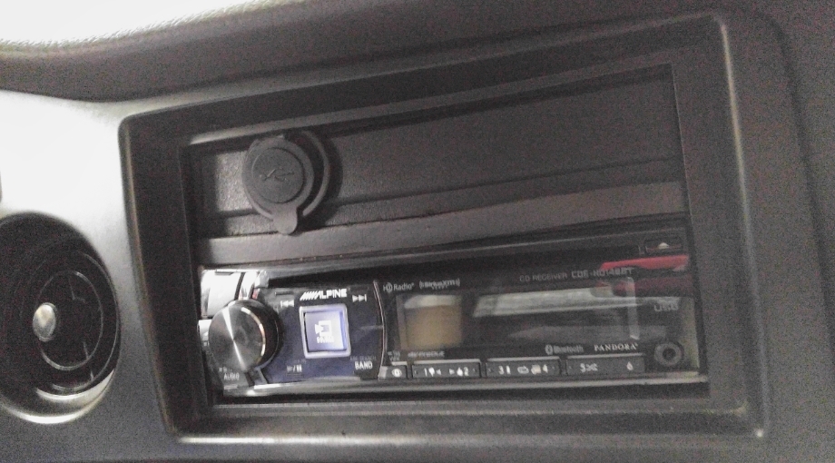

The head unit is Alpine, with a usb input above and an aux in the glove box.
