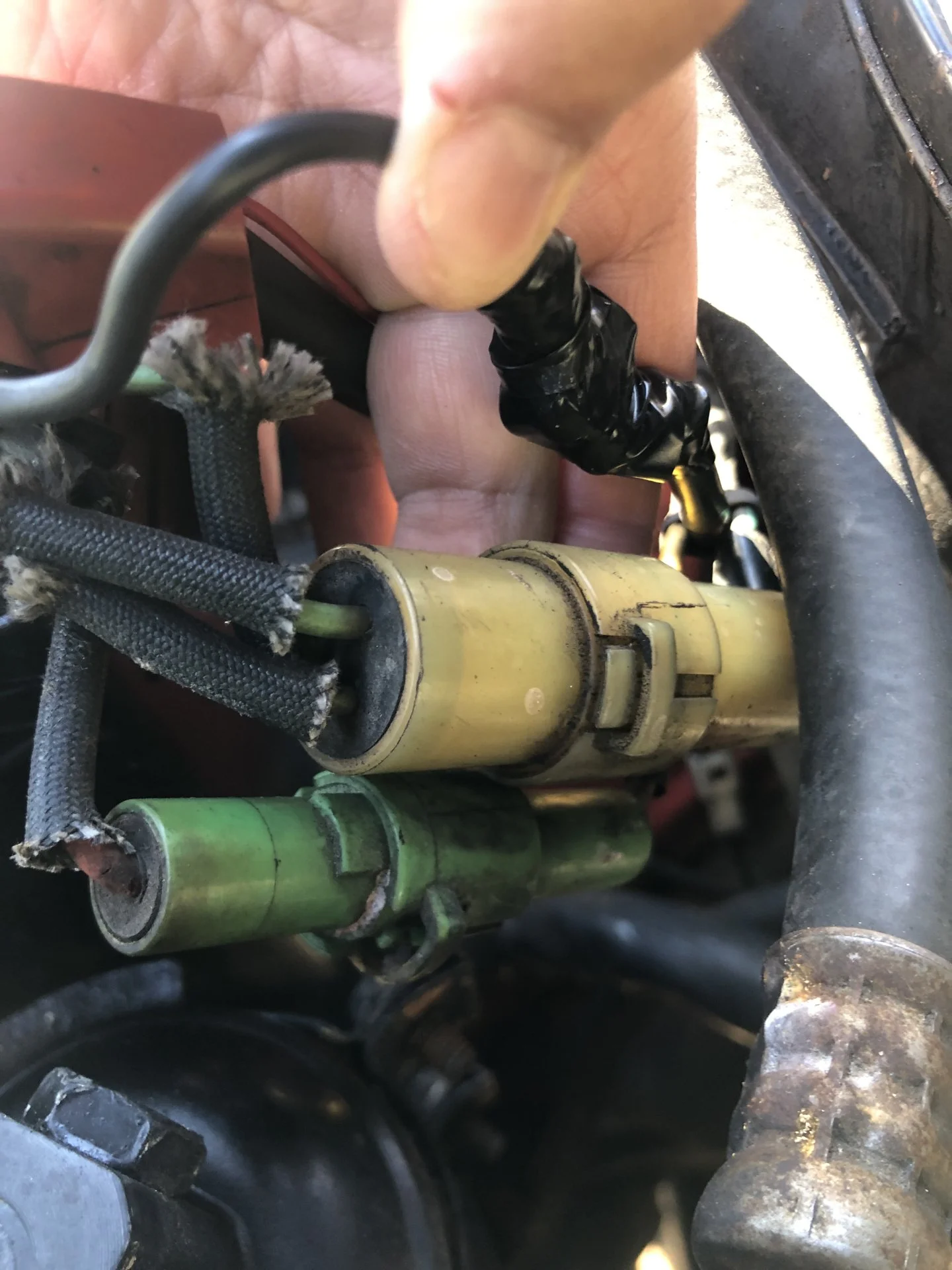

I would check your fusible link at the battery to see if it got cooked. After that I’d check the fuses to see if any popped. Then check to see if any of your bulbs got fried.
fusible link
Hi Seth,
What should I be looking for on the fusible link at the battery? Is the the fusible link?
Hi Seth,
Yes those connectors are the fusible link. Inspect the wires and make sure they are not burned up. Pop the connectors and look there too. The wires are designed to fail in a high load scenario so it’s possible yours got damaged with the over voltage.
