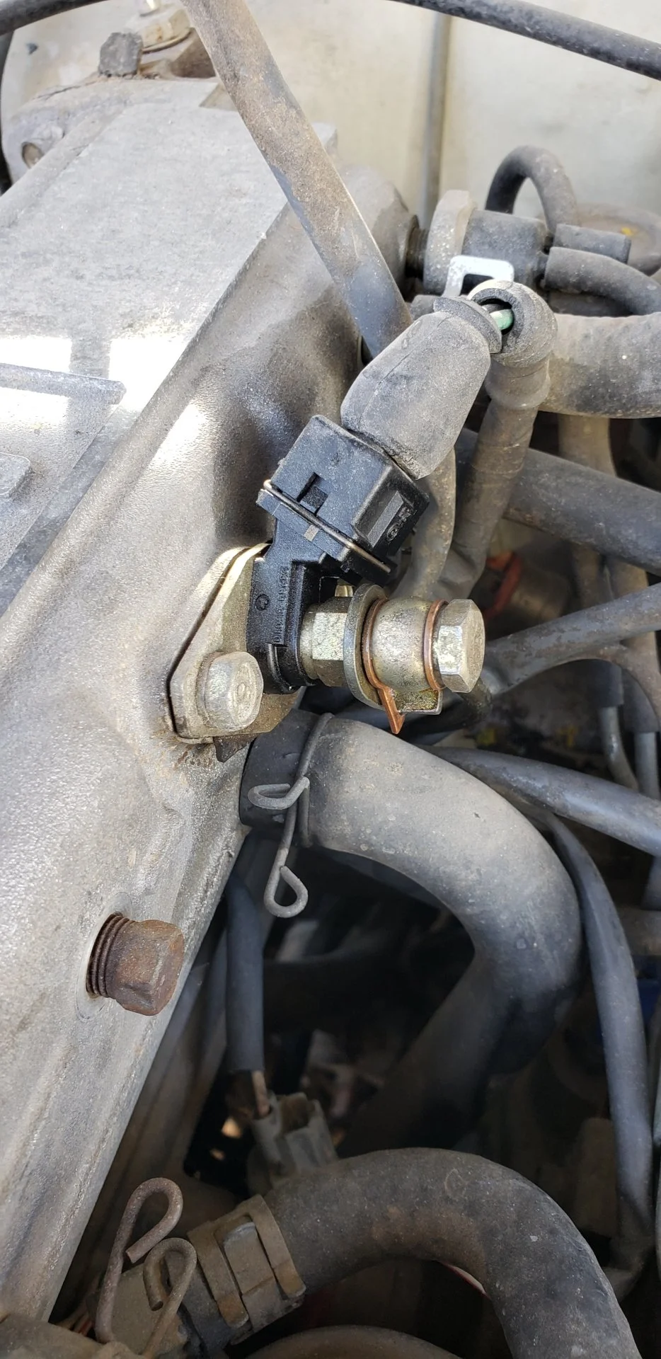

1988 22RE cold start injector fuel leak
Feb 9, 2004
265
3,626
Cool Comfy AZ
Like the title says, I have a fuel leak at my CSI. I disassembled the fuel pipe when I was tracking down what turned out to be a bad fuel pump. Now when the truck is running it leaks at the pipe. Did I put it back together wrong or do I just need to get new washers? Also what's up with the washer with the little square piece?
Looks hooked up right to me. Try giving the banjo bolt a tweek tighter. Otherwise, replace the washers. Or, at least make sure they were clean, and no junk on them, when you put it back together.
Yeah I just wasn't thinking about the washers. I found the right ones (at the dealer) replaced them, no leaks. D'oh! Pro tip: don't try to get copper washers at O'Reillys.
