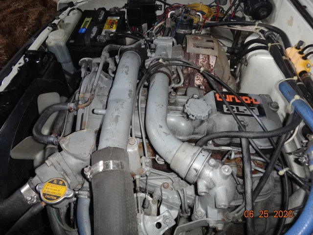

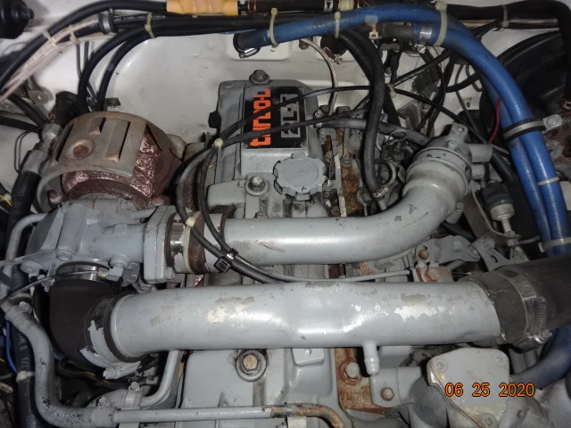

Hi, I was told by moderator to consider posting here. I am new to this site or for that matter, any site, so I don't know my way around. Anyway, I have an incredibly immaculate 1987 Toyota Mastercraft RV that the former owner, now departed, installed a 1985 "old style" diesel motor mated to a 5 speed trans. Rv has 80k and not sure about motor. On the way home from getting inspected, I must have cracked the head as I have significant blow by. It did not overheat, but maybe will now. This is my first diesel and do not really feel confident with doing the job. I am concerned about some specific tools and swapping valve train etc. I am looking for a mechanic that knows these engines? I live in Allentown pa. I have some pics posted on the 95 and older mini truck thread. They don't do justice and you can only post 5. This unit is really clean and I would hate to see this be the demise of it. When I bought it I thought the engine would be the one thing I wouldn't have to worry about. Thanks in advance for any helpful input.

Hey @intune2u , Can you share a view of the engine bay?
Toyota had many diesels in many forms. Some with Electronic injection and some with not.
A pic will help us determine, if not narrow down thr options.

here are some pics. I do have the service manual for 85 truck

Looks like its the rarer, mechanical version of the 2LT-E, which is known to have head gasket issues and cracking of the heads due to this.
Also, it's actually a 2.4 Liter engine if I recall correctly.
