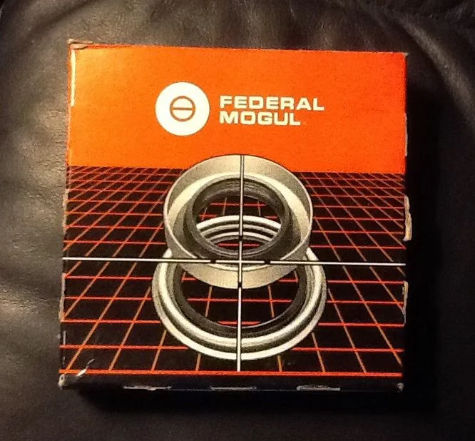

The 1989 60 Series fortunately had a full floater option and the parts house actually knows what a 60 Series is. : )
??? HMMMMMMM I have been told (repeatedly) that FF was not an option in NA for 60/62. If so, we're talkin' unicorns and hen's teeth :)
Having never owned one, i will readily admit I don't know squat about a 60 Series however the parts house clearly showed that a 1989 60 Series had a full floater option and that was the seals we ordered. The dimensions clearly matched the current (bad) seal. It appears the dust cover is available from local Toyota.

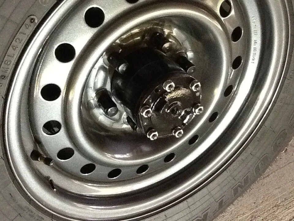

I've been looking for an excuse to sand blast and repaint the rear hubs for quite a while. This issue creates the perfect opportunity. :)
Wow
Brakes are once again normal.
No oil leaks.
All shiny.

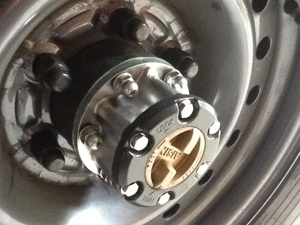

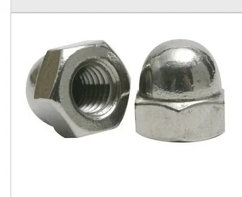

The matching acorn nuts were not available locally and had to be ordered. :)
Modifications are now complete and the ole truck is back home.
That Tom better be glad season's not in ;)
My freshly painted rear hubs will look spiffy when my stainless steel acorn nuts show up.
The aerodynamic aspects alone will add a couple of mph.
