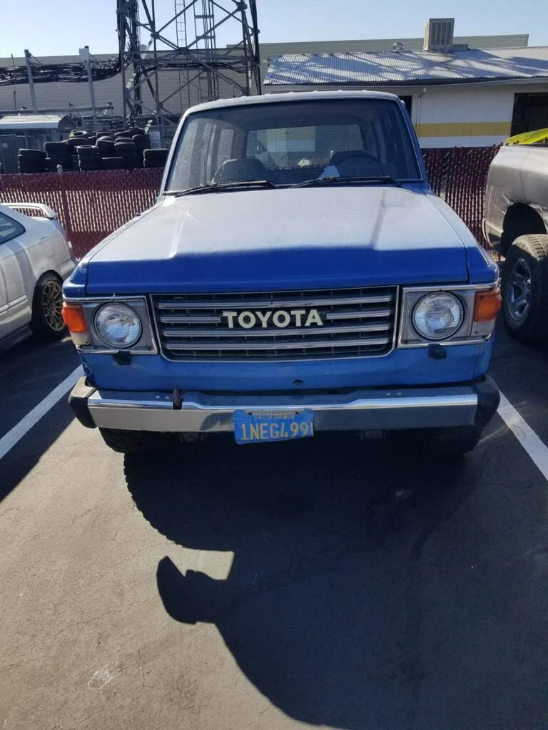

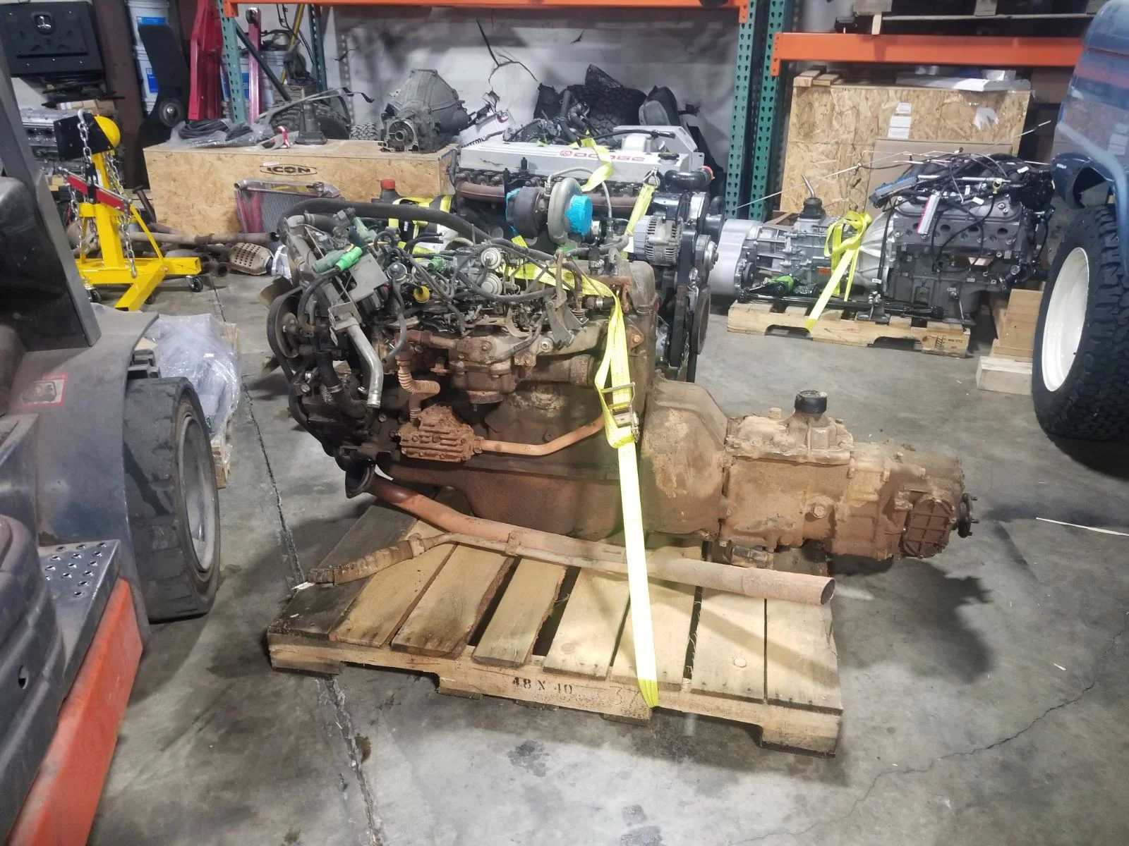

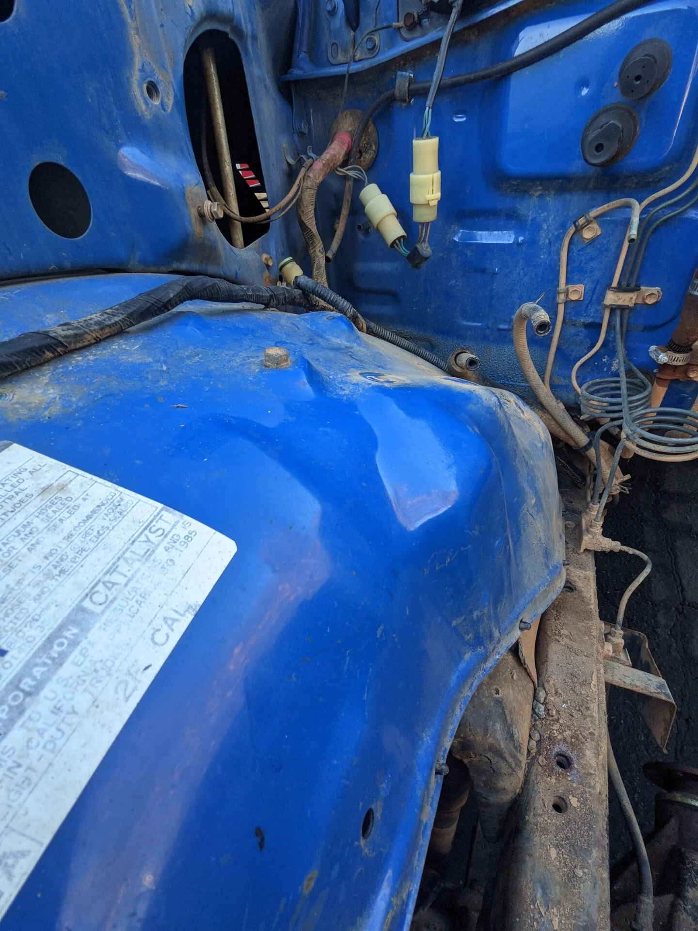

8/1985 build date- Northern California vehicle all its life. 99% rust free

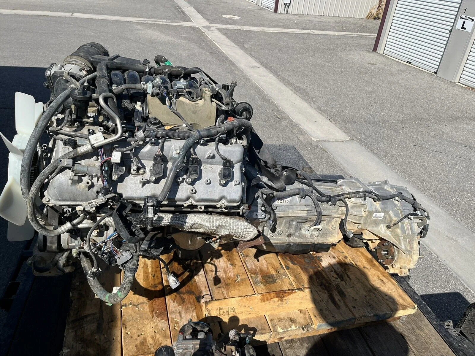

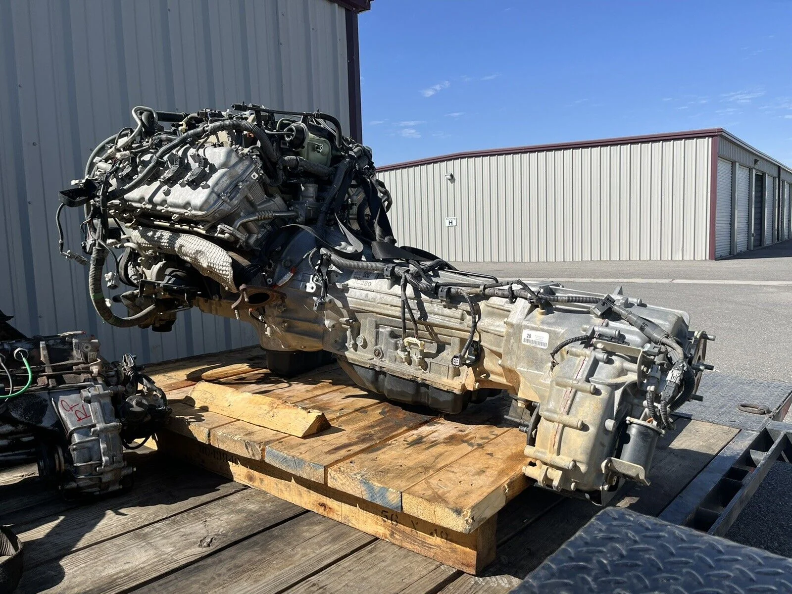

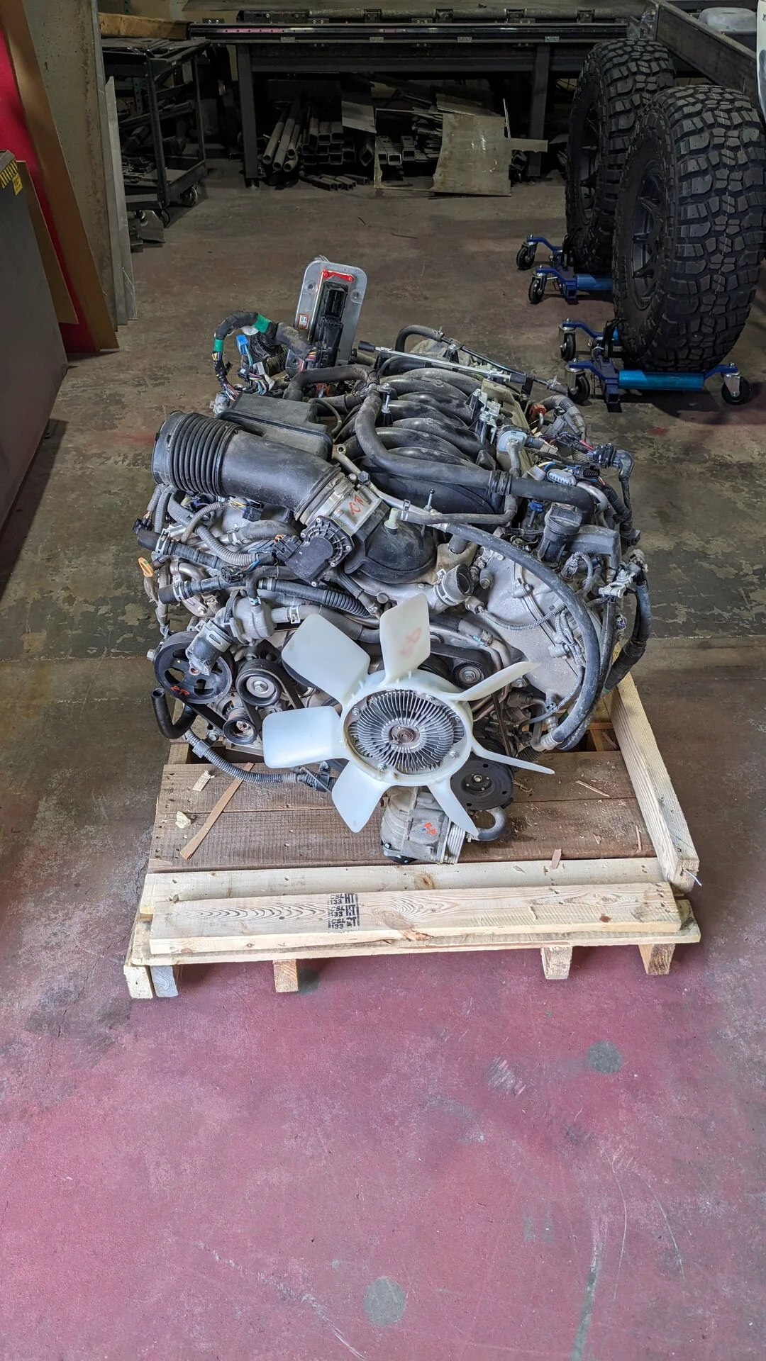

Drivetrain donor- 2021 Tundra 4x4 Platinum Crewmax 4x4 with 21K on the ticker

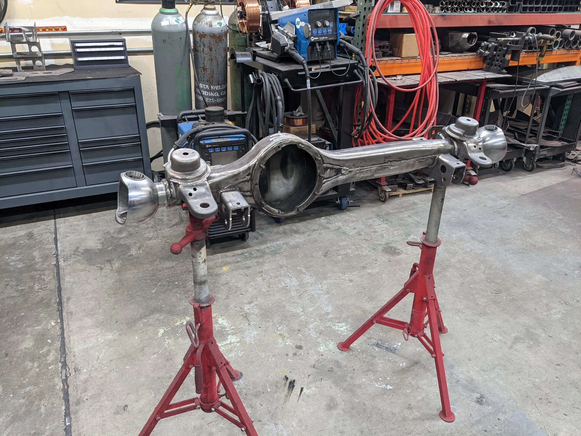

Will convert to coils up front and 80 axles.

Custom front 80 axle (done)
4.10 gears with e-lockers

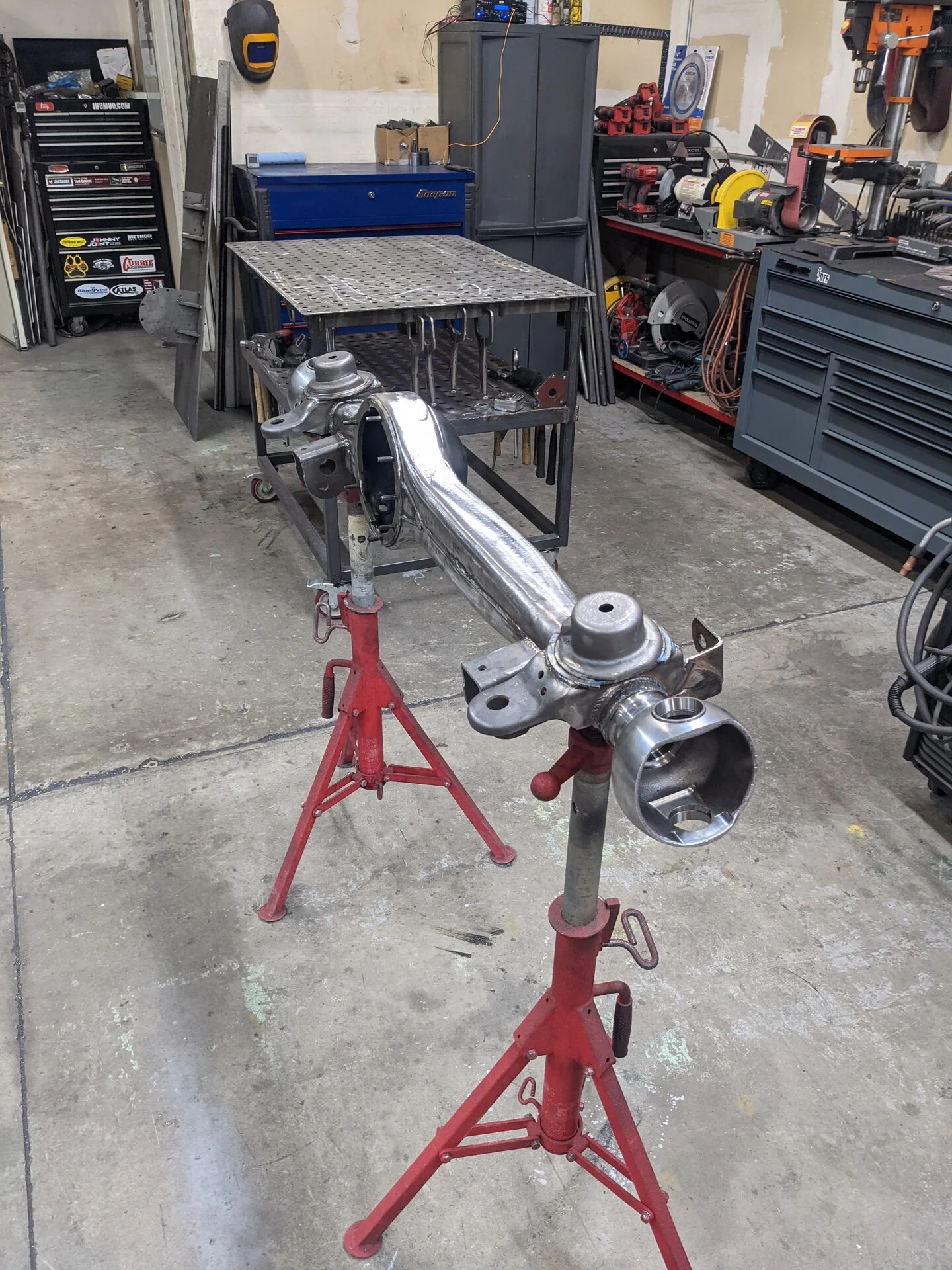

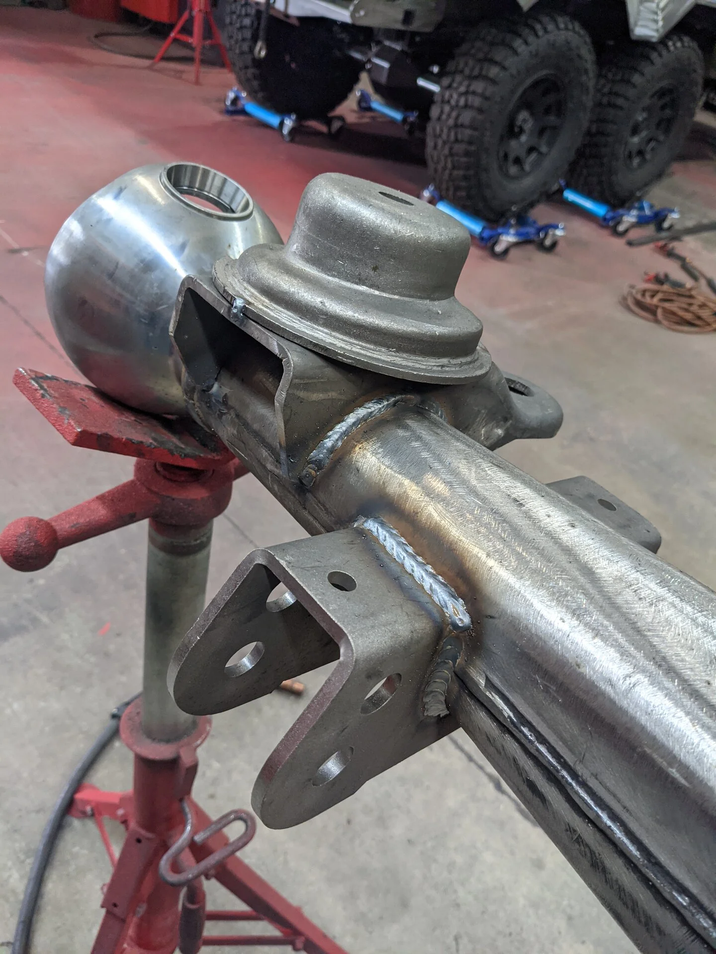

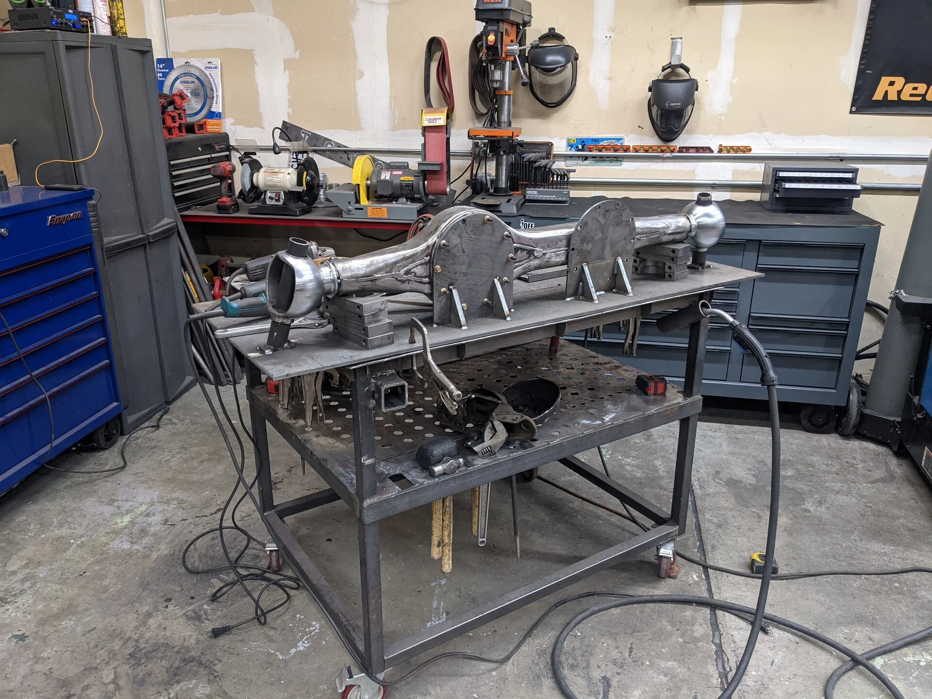

New 4130 CrMo knuckle balls, new stamped coil buckets, shock mounts and radius arm brackets.
Welded up the drain and vents and made new.
Reused the panhard bar bracket.
All welded out and ready for @orangefj45 to deliver the rebuilt Eaton E-locked front and rear 3rds for the build.

This is gonna be good. The first thing I thought in my head was that the front output was on the wrong side and you already done fixed that. Silly of me to think you hadn’t thought of that. I know better J. I promise. Subscribed.
What, if anything, will need to be done regarding ECU: theft deterrent, etc? Subscribed, this will be very cool.
Delete immobilizer, ABS, TRAC, VSC plus any systems that piggyback onto the engine side that is Tundra ECM programmed.
In other words about 75% of the ECM systems will be deleted or bypassed to make it as standalone as possible.
This is something that a standard tuning software can not do. It takes multiple professional softwares to achieve the level of WIPEDNESS as I like to call it. Full design with ECM and complete wiring harness in progress during bench build. One system at a time until it is achieved and a function test after each system and then progressive testing as systems are removed collectively.
Several points of this are above my paygrade and well above the capabilities of our tuners, softwares, scanners and diagnostic tools.
