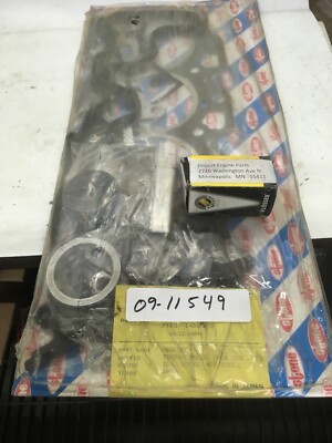

i see you said yours is the NA diesel corolla version i think this is a gasket kit for that car i found it on ebay
Thanks, I actually have a few new gaskets including the exhaust manifold gasket that came with the car and are now sitting in my parts box. The turbo swap will be way down the line, currently I'm still diagnosing the turn signal issue, then I'd like to finish fixing some other small stuff like upgrading the headlights and replacing a broken glow plug along with the other 3. I definitely need to do the timing belt at some point as well and want to upgrade the cooling system while I have everything apart with the coolant drained since that's a known weak link on these cars and engines. I'm going to see if I can fit a GS400 fan in like I did on my SC400, and if so the GS400 radiator looks to have the same hose locations as the CE80 so I'd love to see if I can jam that amalgamation in for a massive cooling upgrade. I also still need to clean up the new wheels I bought for the car and get new tires to go on them. The last thing on the list is going to be fixing up the suspension since it has some garbage Monroe shocks that are clearly already blown, not to mention the dry rotted suspension bushings and probably needing new brakes while I'm in there.
