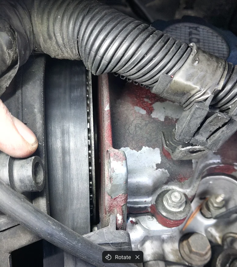

OK all is well in the world of the old Camry but timing belt paranoia has been haunting me again.....I did find one local mechanic who was like sort of semi-willing to work on this lol.
This is as close of a look as I could get and I can only see the backside of belt....Should I let the fear take over or just ignore this and keep driving
Engine was said to have been rebuilt less than 10k miles ago, but it was seemingly 10-15 years ago. Sticker on engine last shows timing belt being done in 1995 lol no other signs of it being done.
If you can find a competent mechanic who is willing and able to work on it then I’d say just get it done. Just make sure they know the factory process and have the equipment to do the job properly, I’ve just been reading about a person who took their TDI to a mechanic for a timing belt job and it was returned to them not running and in pieces. The mechanic didn’t have the proper tools to set everything to TDC or to adjust injection timing afterwards.
Roger that. I'm going to go through the steps in the service manual and bring it in to his shop along with the box of parts I have to see what he thinks.

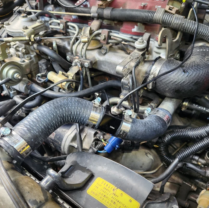

Adding coolant temp sensor to Toyota 1C-T
  • Ordered upper hose from Napa and saved current hose just in case this fails
  • Cut hose at the half way point. I ended up also cutting a bit of length off each end of the hose. Needed like a razor blade chopper cutter tool thingy
  • Install temp sensor of your choice, I used one from Amazon seen below that came with wiring and gauge with audible temp alarm
  • The hose clamps that came with sensor were way too small and I couldn't tighten em' down enough to keep fluid in. Replace with full size clamps
  • Keep everything loose during the install so the hose can settle in to the right angle...I started with clamping the sensor down then moved to the engine side of the hose.

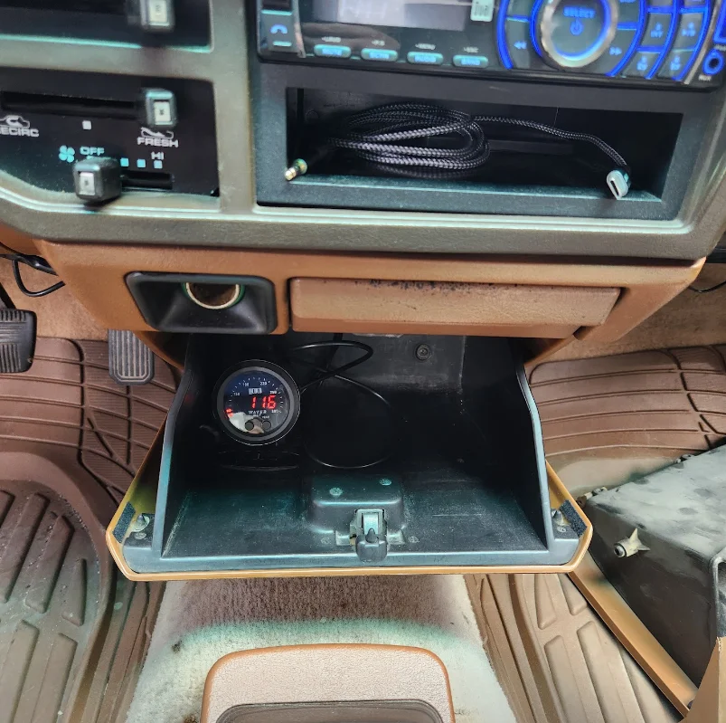

  • Run wires through boot on passenger side. Install gauge somewhere, I went in the center cubby so I can close it up and not look at it too much, otherwise you may get temp monitoring madness

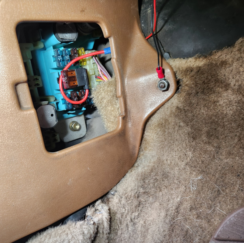

  • I got power from the turn signal fuse which is hot with the key on and then grounded out on the post nearby. Seems to work fine for now

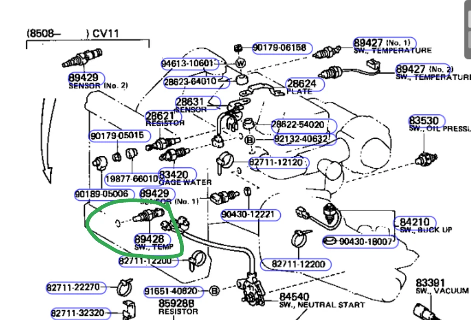

Electric Fan
  • Service manual says they should turn on at 194F. Mine are not but I need to troubleshoot further. Was running 210F + cruising at 60mph
  • I removed the connector at the bottom of the radiator and the fan runs with key on.... According to the service manual this might mean that I need to replace the "temperature switch"
  • Partsouq shows the diagram below, I think this is the correct switch but not in stock. Amayama shows out of production
  • Part #89428-15030
- I'll need to troubleshoot more but would like to find a proper fix instead of running fans full time / rigging a switch

  • The cheapy Amazon temperature thing works well but started leaking from the sensor threads after one heat cycle. I removed it and put some of that Permatex PTFE thread goop on. Hope that fixes it , otherwise may need to get a better quality part
